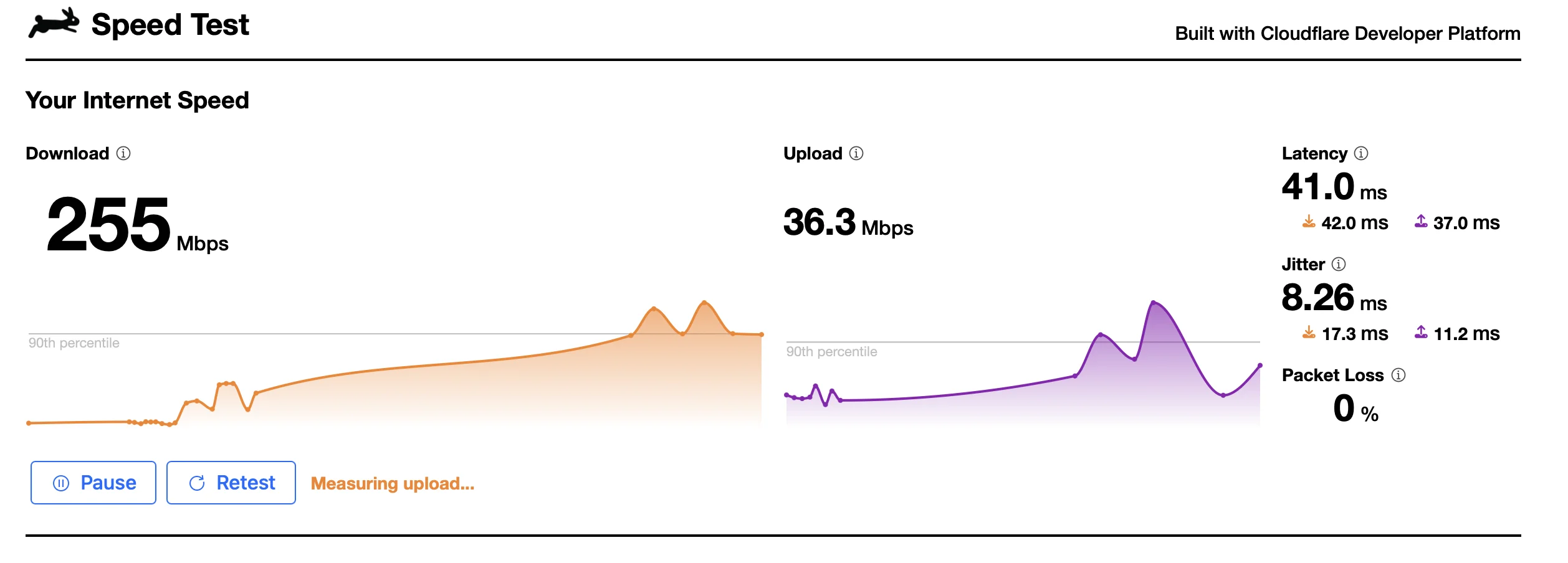

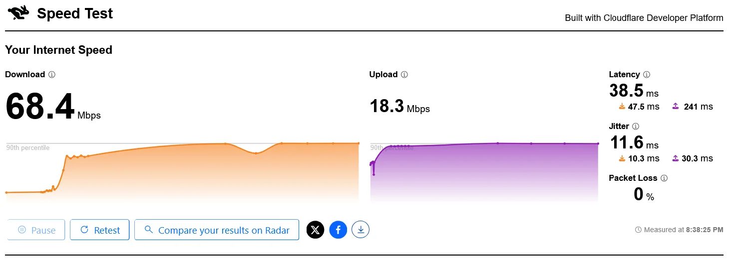

Can you guys on BT / EE run this cloudflare test (who the forum uses)
AND
Post the cloudflare here, and copy paste the other test (you can delete your IP if you want to)

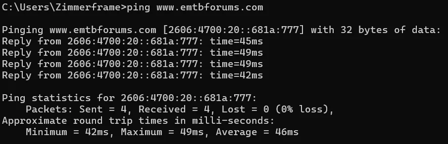

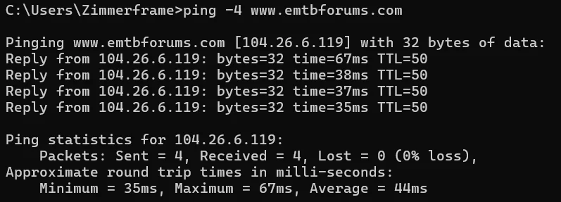

not sure why that shows ipv4 address ?! as ping gives :
Unless I force ipv4 :
