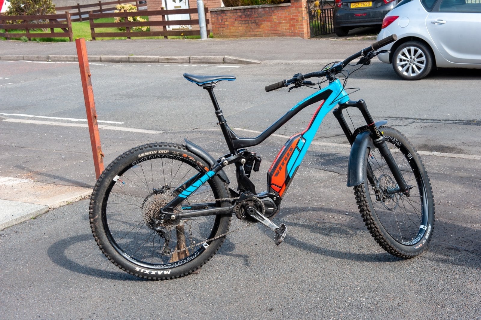

Just put the bike together , e-sommet VRS 2020
Nice! Check the chain device doesn't hit the swing arm when the suspension is compressed, can rip off the hiansty protection if it does. easy to rotate forwards, you can access the chain device bolts though the chain ring
hiansty protection
I actually pondered this for a moment wondering if it was some Chinese invisiframe, or some cunning part of a vitus suspension I'd never heard of ... until I realised it was your auto correct and you meant chainstay protection.
Thanks for the tip , i am defently gonna check that.
I checked mine today on a 2020 VRS and the chain guide was hitting the chain stay. i took the guide off and put it back on the lower screw hole on the mount and now it clears it
