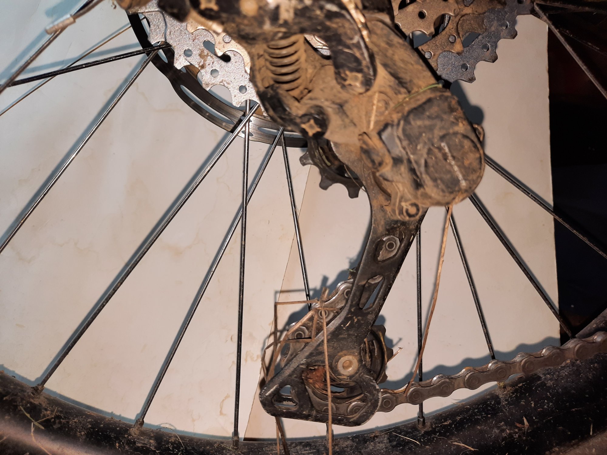

As someone who has had rides ended from having the vulnerable rear derailleur destroyed, I would like to see gearboxes happen on e bikes even if they are a little heavier, bigger, and slightly less efficient. It also seems like with the higher speed of e bikes riders are more likely to go slightly off-trail and get sticks and grass in the rear derailleur, causing damage or the shifting to skip around.
I also like the idea of not having to lube or replace the chain so frequently, and bikes look better without derailleurs.

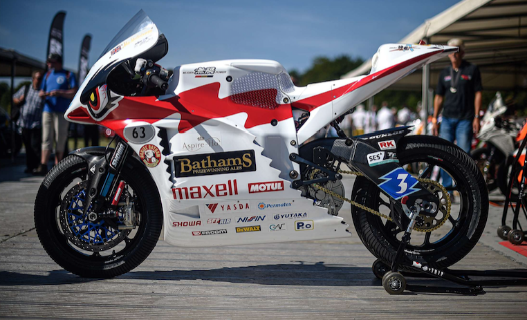

I voted NO... that's no to gearboxes... but that doesn't mean I voted to keep the derailleur either.
Below is the 2019 (Honda?) Mugen Shinden... developed and raced specifically for the Isle of Man ZeroTT format.
“It averaged 121mph over the flying TT Zero lap. It did 176mph through the speed trap, which was 3mph hour quicker than the 600cc SuperSport bikes. The performance is up there. You take a little bit of a weight penalty with the electric powertrain, but with continued development, we'd think that would come down over the years.”
"The bikes have no clutch and no gears, meaning it’s a twist and go experience, and not at all comparable to combustion powered super bikes."
(Full article, here: The Mugen Shinden is an all-electric Isle of Man TT conqueror)
It is my understanding that electric motors are highly efficient with FULL torque available from 1rpm all the way up to a bazzilion rpm , attainable because there no reciprocal moving parts and hardly any friction losses (with the exception of the drive train itself).
I don't believe the technology is quite here yet to do away with the derailleur (AND gearbox)... but it also doesn't help that the bicycle industry by enlarge is a deeply traditional if not a highly political domain. I wouldn't be surprised if it had never occurred to them yet that an electric motor doesn't actually need a gearbox to micro-manage torque output - IF (and that's a big if) the new-gen pedal assist motors are designed to be run that way. The main issue for a bicycle is "cadence-management" hence the set-ups we have currently... but there might be a way to achieve this by software programming without utilising mechanical means.
I can imagine that an eMTB without a derailleur would have a bigger battery and bigger motor. At this point in time, the weight savings by removing the complexity of a shifting drivetrain may not be enough to offset the added weight of a bigger motor and battery... but, who knows given time. I'm curious which brand will be the first to give it a shot... it might be a complete outsider to get in there and give the old-guard a wake up call.
