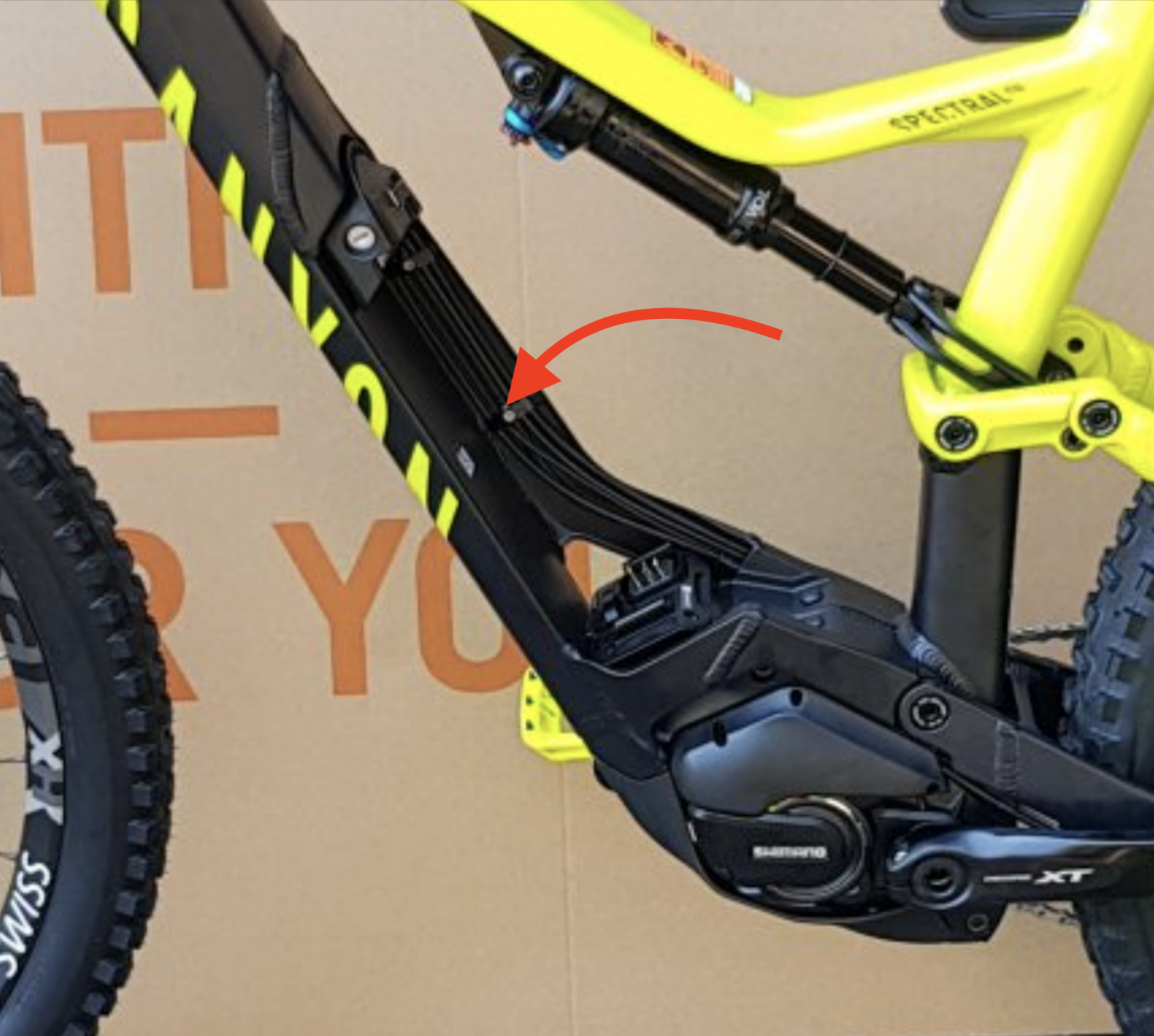

4 year old design though - the only issue with the Canyon would be clearance between the top of the bigger battery (its taller) and the shock, though that may be only an issue on smaller sizes. I think the new battery is slightly wider too, so would it fit given the side rail of the frame?. Might also effect fitting the dedicated water bottle cage, but that's a minor issue

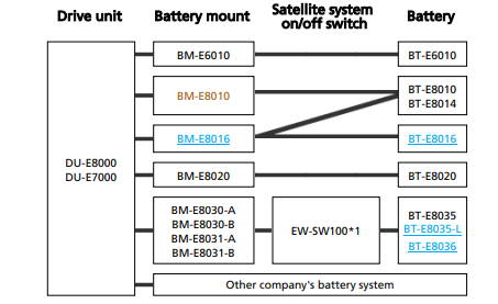

I had a reply off shimano Uk today via Facebook,it took a bit of explaining but I got there in the end?yes the 8036 has the same mounts as 8035 but it’s longer and will not fit into an existing 8035 aperture?
The SHIMANO battery holder BM-E8016 is used to attach the external battery BT-E8016 or its smaller siblings to the down tube or seat tube.

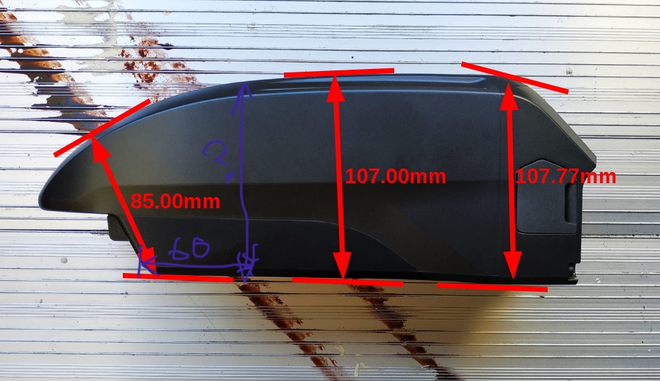

Same 504Wh charger works with the 630Wh and with one fin missing, the 504Wh battery still mounted as securely as before.
It looks like you could even epoxy the fin into the cavity on the 504 Wh battery if needed as well to make it fit the same as the bigger battery. I’m not sure why they didn’t go for a more open architecture with a common mount, I think there’s a market for different sizes of battery which can be swapped.

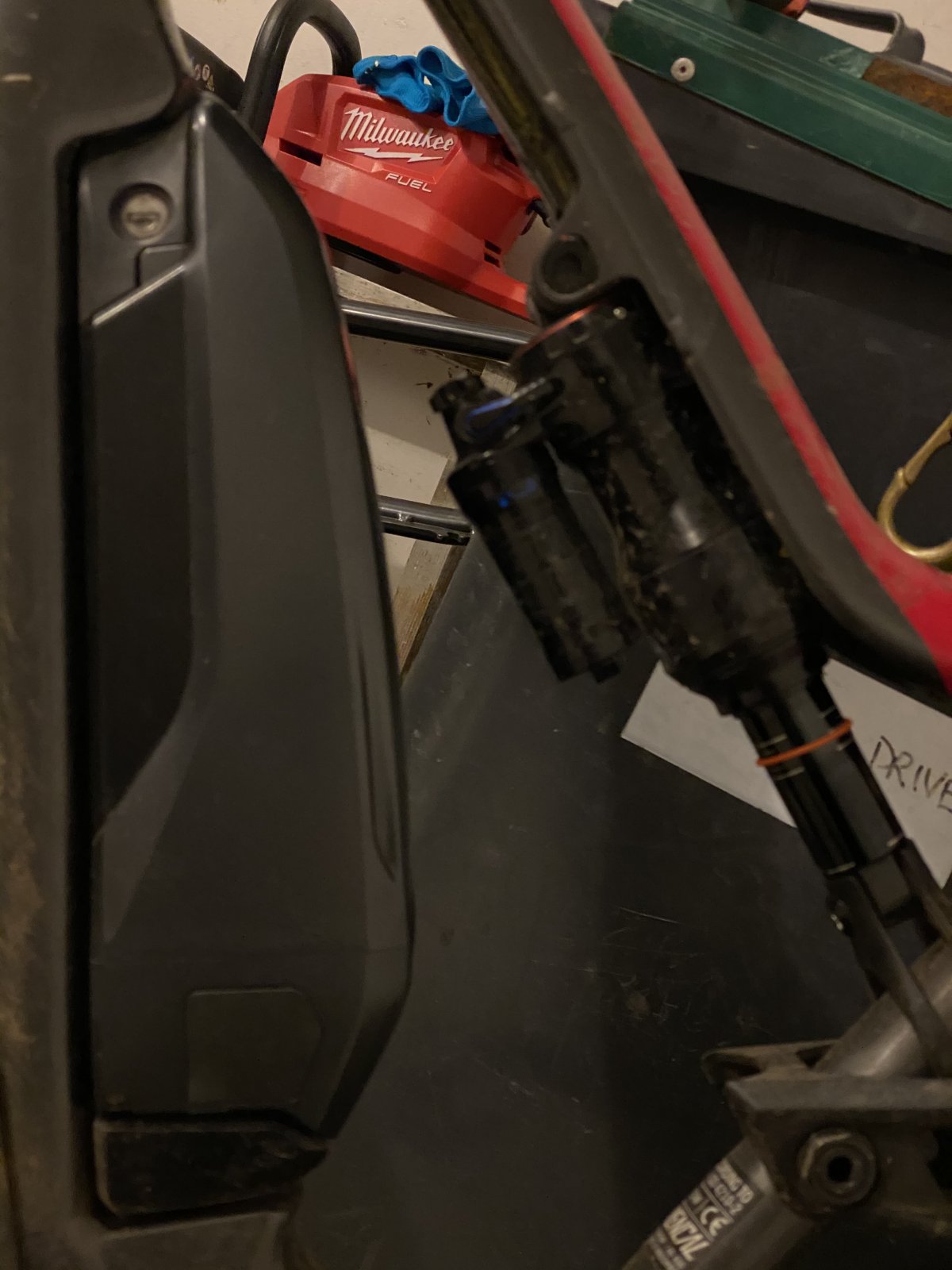

Also any chance you can tell me how tall the battery is 60mm below the upper mount flange? My shock reservoir is perhaps too close for this battery.

Scale it from the photo, it's good enough to do that. My eye says 100mm, there or there abouts. ?
I did scale it on the photos and it’s down to the millimetre now! Really close! I know I didn’t want to ask...
I think in the end I have to buy one and cross my fingers. I suppose I could swap shock to non-reservoir version.
