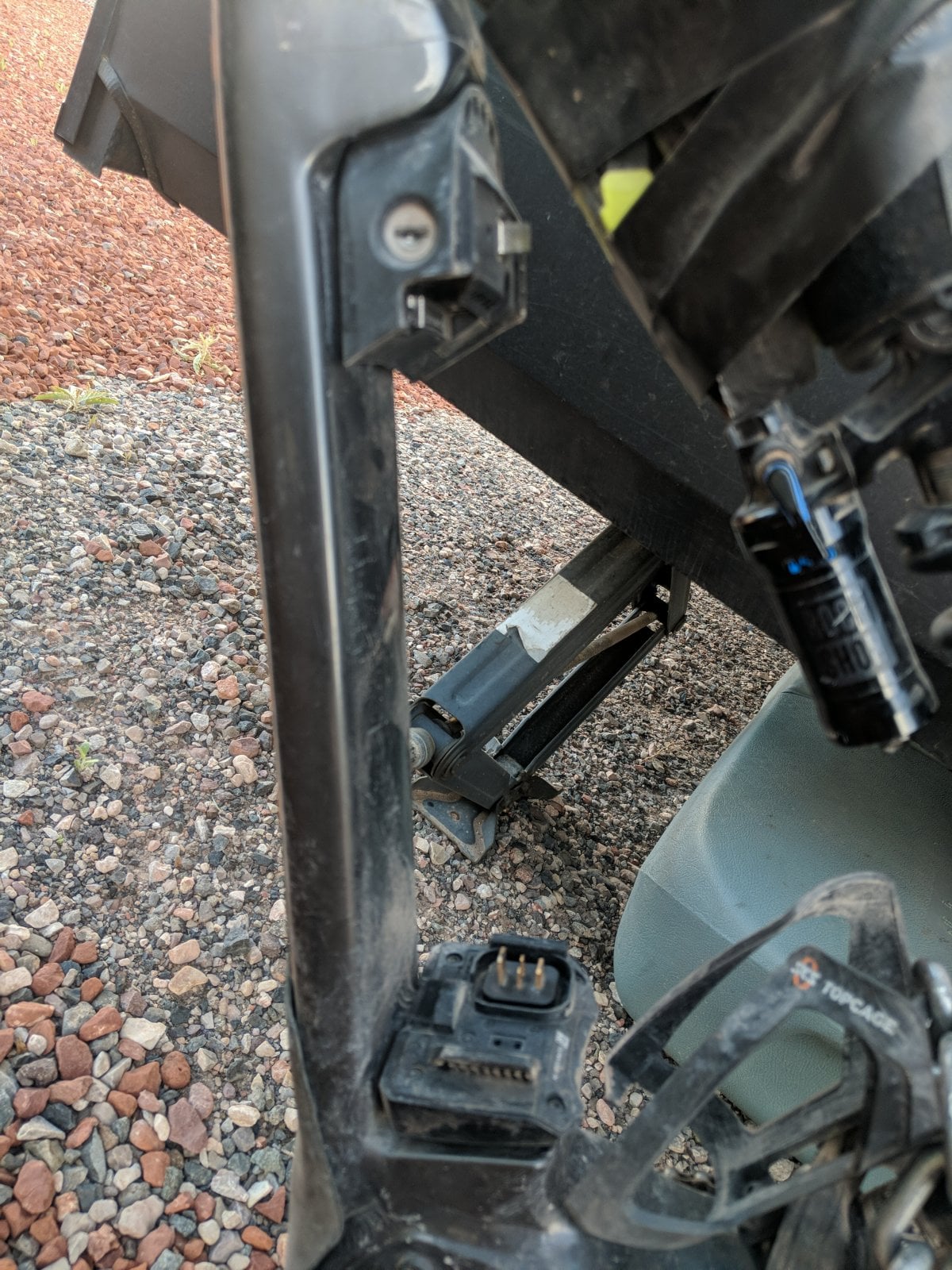

not that it matters all that much when you've bought a daft 'hidden' external battery frame bike designed by a californian stoner.
TBH I'd be more interested in how much weed you can stuff in that hidden compartment than worrying about sticking 900g more battery in there.
Yup to me it looks like the external can be retrofitted if you swap out the bottom mount, the battery is clearly a bit wider and taller than the existing 504wh but doesn’t look longer. What not clear if that is the case, is if you fit the new mount can you still slot in a 504 back in? If you can I will definitely upgrade.
And whose to say some of the current bikes with internal batteries can’t be retrofitted? Manufacturers will have had a heads up on this quite a while ago, wouldn’t surprise me if a few had future proofed their designs to allow for the new batteries.
The Pivot and the Intense have unusual battery Soloutions as they where designed before Shimano bought out any form of Internal Battery that wasn’t a hulking monstrosity in your down tube.

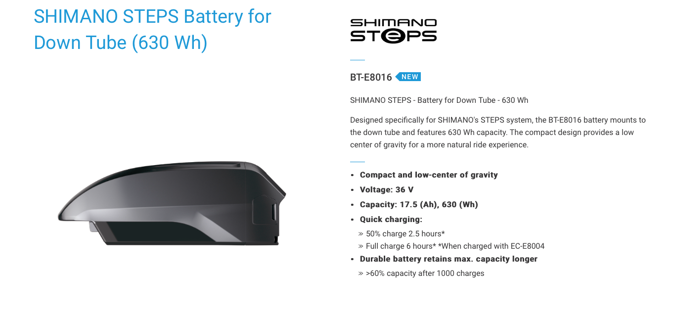

Just the press release pics so don't go full columbo just yet...
shimano BT-E8016 (630wh)
and the current BT-E8010 (504wh) battery
These guys think it is longer and can't be retrofitted More range: New 630 Wh Shimano battery and new display for all Shimano-STEPS motors | E-MOUNTAINBIKE Magazine

They are now on Shimano website - you can clearly see the external is taller, but doesn't look longer IMO.
BT-E8016

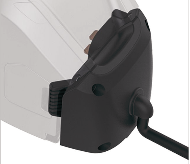

To me the 630wh mouth looks the same form factor as the 504wh, just taller, the one thing that is not clear is if the catch tab for the battery (the bit that hold the battery to the mount) is taller too, meaning it wouldn't work with the 504wh
This is the existing mount for my commencal 650 meta power ..if the new battery has different dimensions it's not going to retrofit this bike. If both the 500 and now the 600 aren't interchangeable then these new items are for new bikes...seeing I own two old Batts, it seems like a non issue for me. This is progress so I'm not complaining but my current e-bike is flawless for my needs and/
