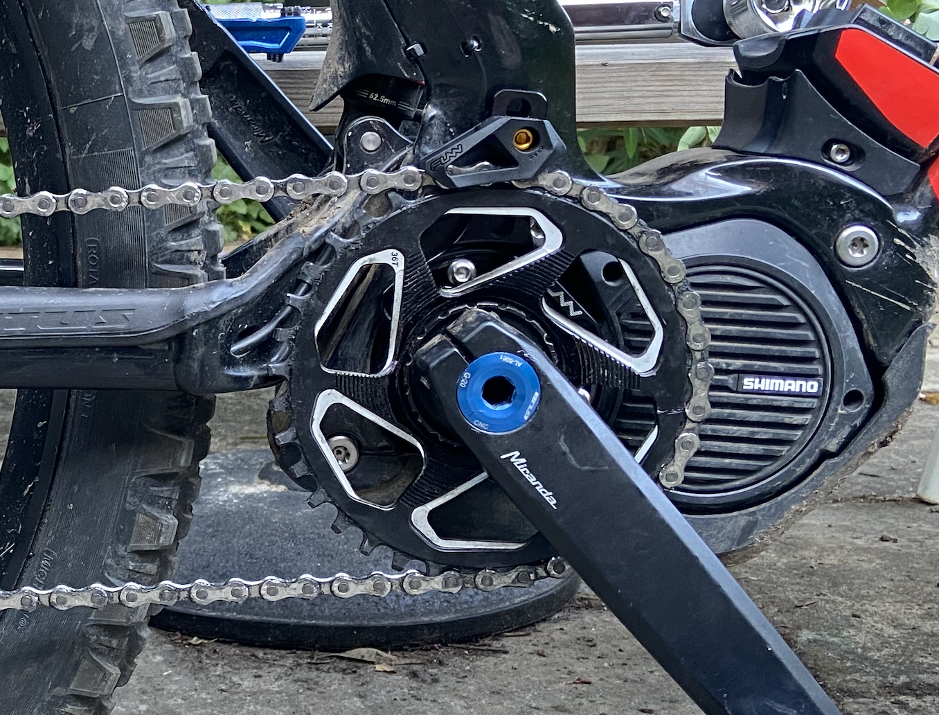

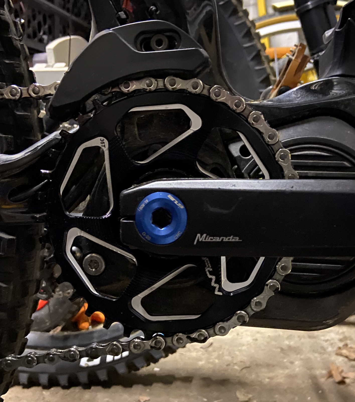

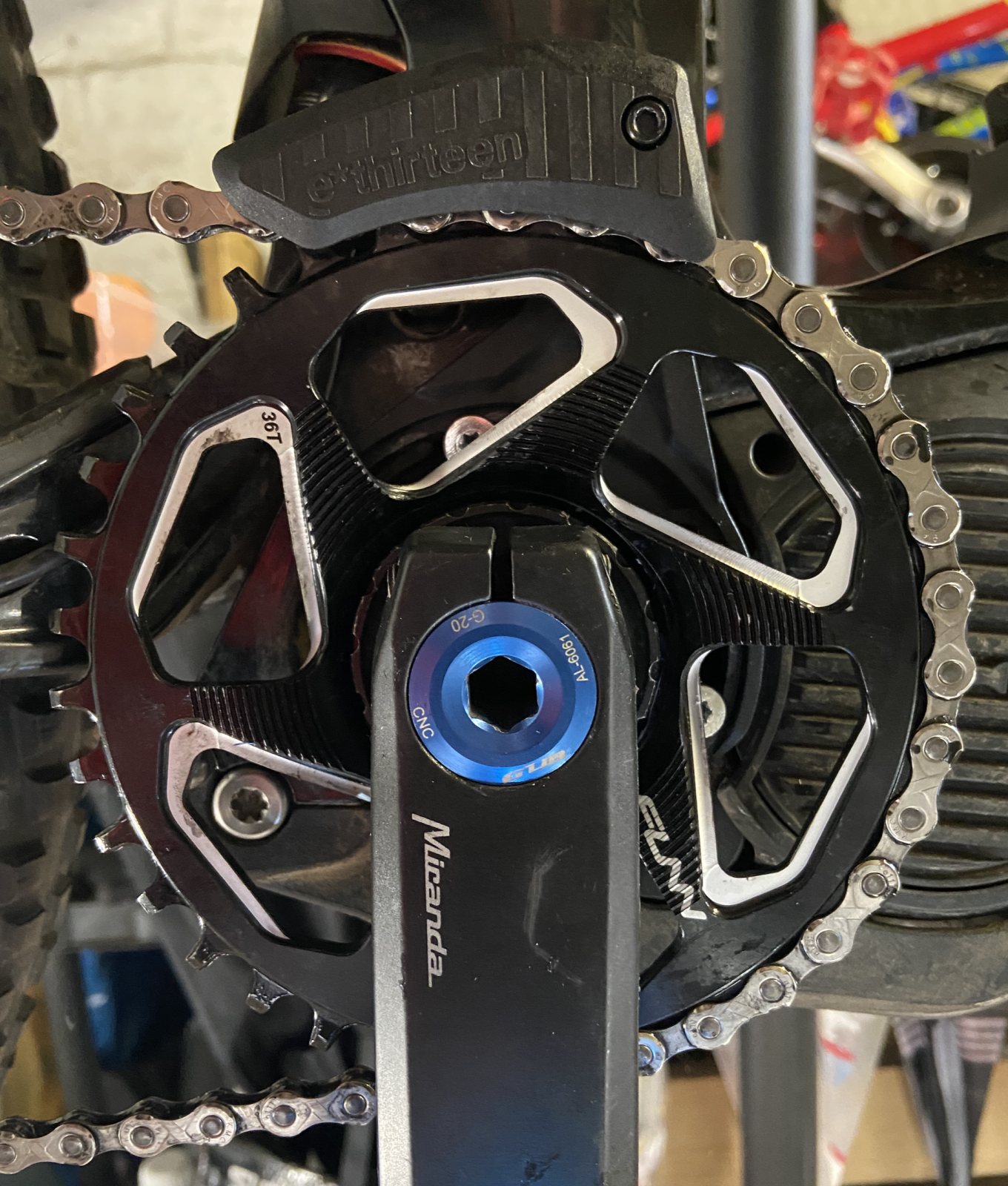

I've been using this:
e*thirteen TRS 2-bolt Chain Guide
Works well. Easy to install and light.

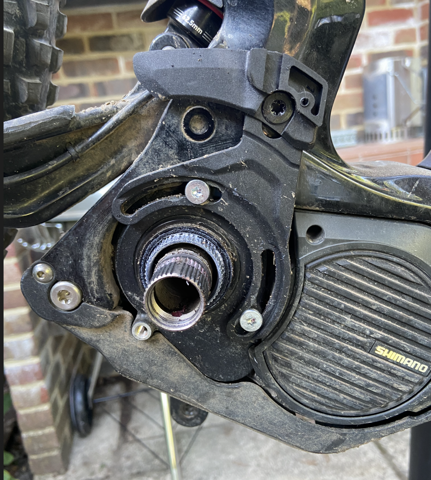

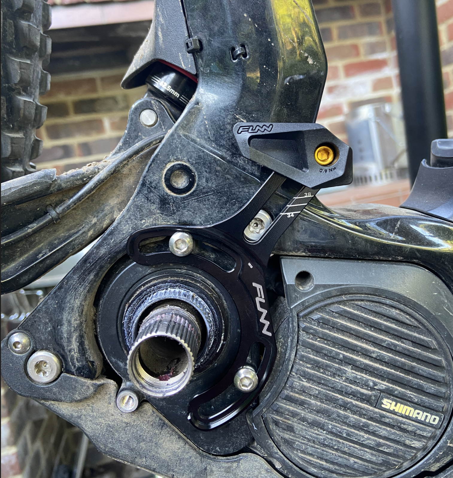

I now have the Funn one installed, I had the E13 Steps specific one on before, and the Funn is night and day better bit of kit in terms of quality of materials and installation/adjustment. Its different to the e13 one you have which is more like the Funn and looks to be better quality.
Been vey impressed with the Funn EMTB stuff so far
