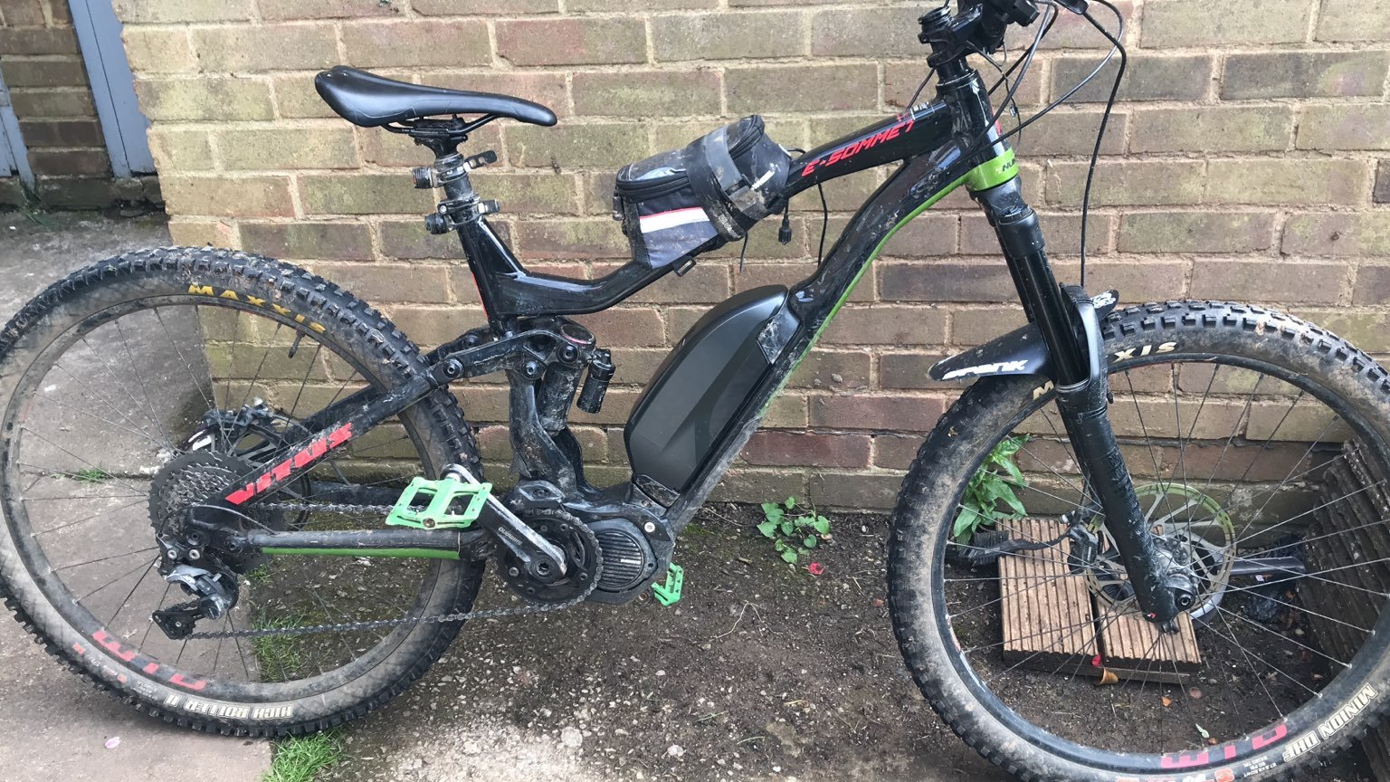

I bought the 630wh external from ridewill.it for my 2019 Vitus E-Sommet and despite getting stung with the Brexit bonus of £124 import duty before DHL would release it, it still worked out OK. I followed the tip here to hacksaw the first tiny fin from the existing battery mount and both the 630wh and the 504wh now fit tight with no further modification needed. My worries about the extra height of the new battery and the rear shock were put to rest as theres no way they come close, even with my ample weight and a 6 way aluminium hydration pack in the backpack. All in all very pleased with the bigger battery, Epic rides here we come, (probably need a better saddle now) - Thanks for the pioneers with the mounting tips who took the plunge and shared their advice. :-D
Just to echo PsyMan2000's comments, followed all the tips in this thread when the new 630 battery came and all of them worked. Especially whipping the charging lead out to get the battery to link up as mine absolutely refused to play ball. Panic then relax!
Big thanks to all who contributed.(y)
