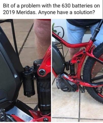

I'm sure that i have seen a thread showing that it doesn't fit due to rubbing on the shock reservoir.
I almost bought one from the Netherlands but then saw the picture.

I guess that rules that out then, it maybe looks with a different shock but that would be an extra cost as well as the battery
Probably cheaper upgrading the bike
Hi Stanczech, I don't have any details I'm afraid. Looking at the picture and seeing that it almost fits I had wondered if simply sanding a few mm off the battery case at the contact point would do the trick....

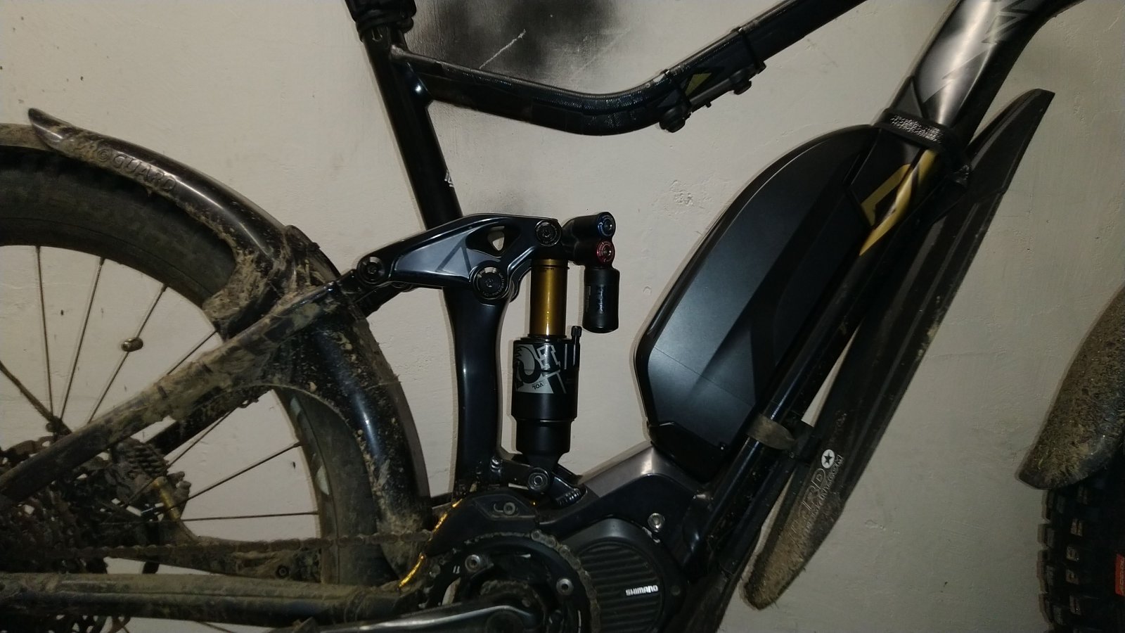

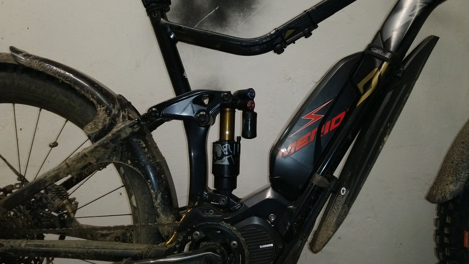

... so I made some measurements to see if the battery, which is about 17 mm higher, fits in front of the muffler. It looked tight, but I ordered the battery, and it arrived yesterday.
And it turned out well, the 630Wh external battery fits into the XL Merida eONE SIXTY 2019 frame even with a spare.
Enjoy!
View attachment 60196View attachment 60197

Yes, it works flawlessly, and it's as I described in a previous post: the Shimano 630Wh external battery fits in the XL frame of my Merida eONE SIXTY 2019, and does not come into contact with the shock absorber air chamber at any point along the entire stroke path, but there will always be enough space left. The photo is above.

I was wondering if anyone with a frame size S has installed the (external) 630Wh battery? (eOne-Sixty 900 2018, the red one :) ).
With the OEM Rock Shox Deluxe shock this will cause interference when fully compressed, but are there any piggyback shocks that don't interfere? Or is the only option to solve this problem the RS Ultimate without piggy back reservoir?
I also heard about someone moulding the battery housing a bit but that kills the warranty also... not what I would like.

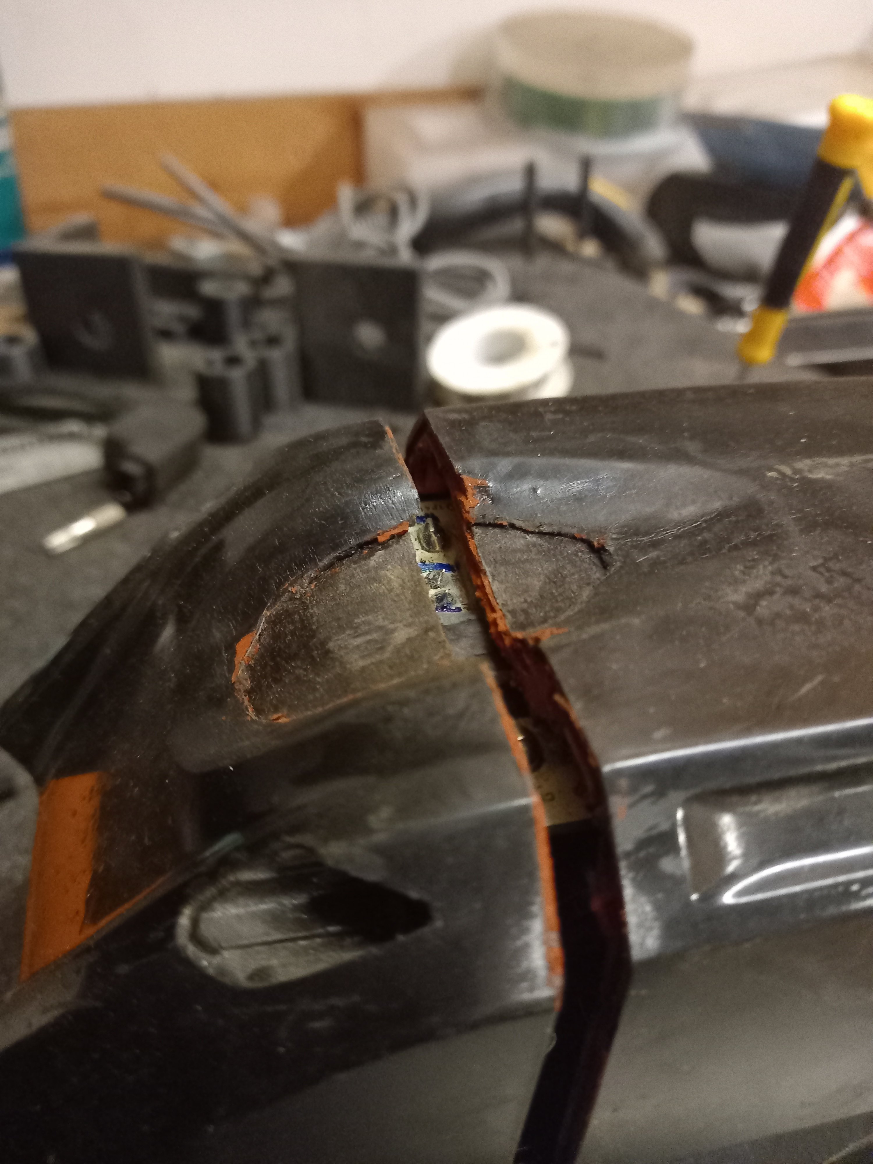

I have merida eonesixty 900e M size. I take a risk to order 630wh battery. It wont fit without modification. It is pretty hard Job to make room to it. After 2 years use ,my battery dropped to floor and it blinks error now. Lights claims that battery is too Hot. I open it and there was little bit water drops also. I dont know how i could get this error off.
I'm facing the same problem. I've got a size M 2019 Merida and thinking about upgrading to the 630 battery since the old one is not working. How did you manage to get it working? Would you do it again or simply stick with a new 500 battery?
