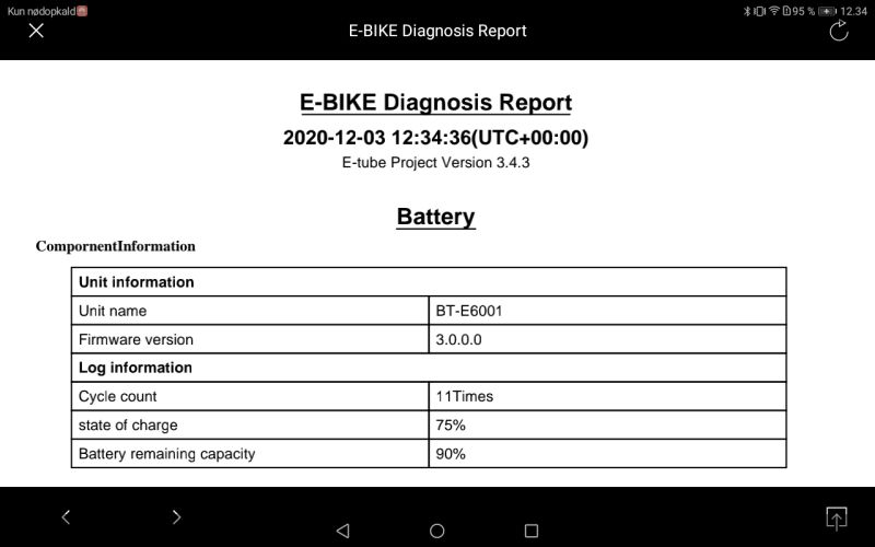

Here are the resuls for my battery:
1) # of charging cycles = 11
2) remaining capacity = 90%
3) charger = E6000 (fast charger)
4) age = ~3 months
My battery also suddenly jumped from 100% to 90% when charging cycle went from 10 to 11.

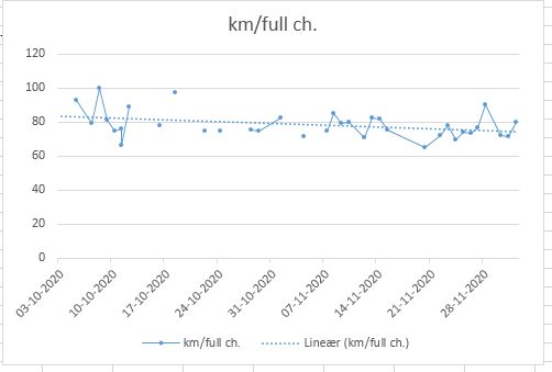

As I've always been measuring things due to my former work in the calibration world, I've made an Excel chart of the calculated range as a function of "(kmTravelled * 100)/ (ChargeBeforeRide - ChargeAfterRide)".
This chart is attached and it show a slight decrease in the linear trend (dottet curve) from app. 82 km to app. 75 km/full charge.
The range decrease can be caused by colder weather, more windy and/or me using higher assist level as ohters have mentioned in earlier posts. If it flattens out in the spring, I'll be pleased. If the indicated battery health decreases again after 20 charge cycles I'll make a claim to the bicycle dealer.
After I saw the sudden decrease in capacity I've measured the energy (Wh) going into the battery during charge with a cheap energy meter and will follow this closely in my spreadsheet too. It is not a precise figure as there are several uncertainties (loss in charger / battery, phase error etc), but it gives a good relative picture if the battery charges up with less Wh over time.
