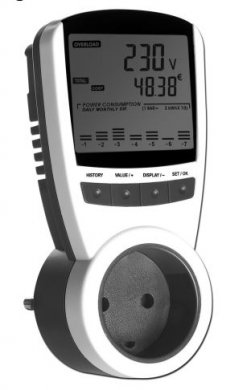

I measure in the same Wh range as Jimbob ( 470 - 500 Wh) and use a cheap energy meter that I have compared with the 'official' meter, installed in my house by the electricity compagny and found it relatively accurate (<5% difference). It compensate for the 'Power Factor' (Cos. phi).
Example link to AliExpress: energy meter – Buy energy meter with free shipping on AliExpress
Probably also deliverable from eBay and Amazon. I just bought mine at a local hardware store some years ago.

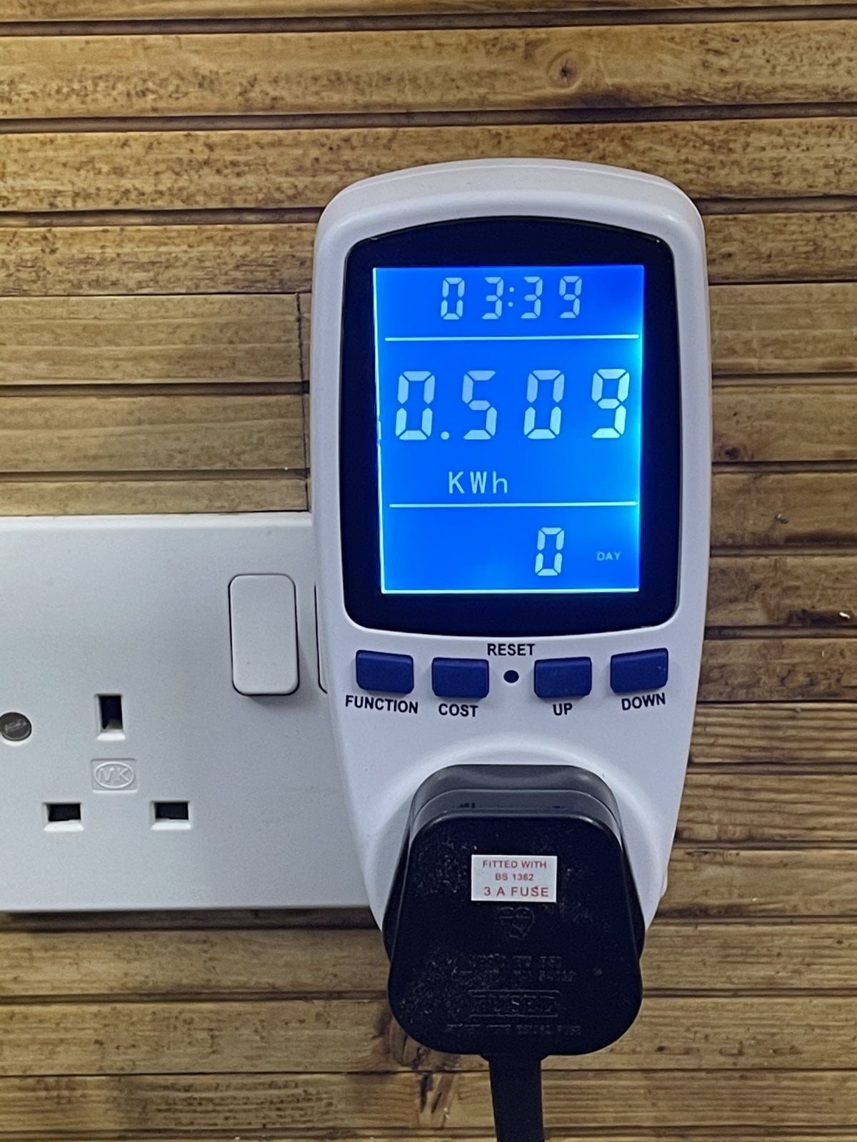

So I bought a meter and this is the result from a fully depleted battery
I’ve no idea mate to be honest? Would there be 15% losses through the charger?
View attachment 48431View attachment 48432

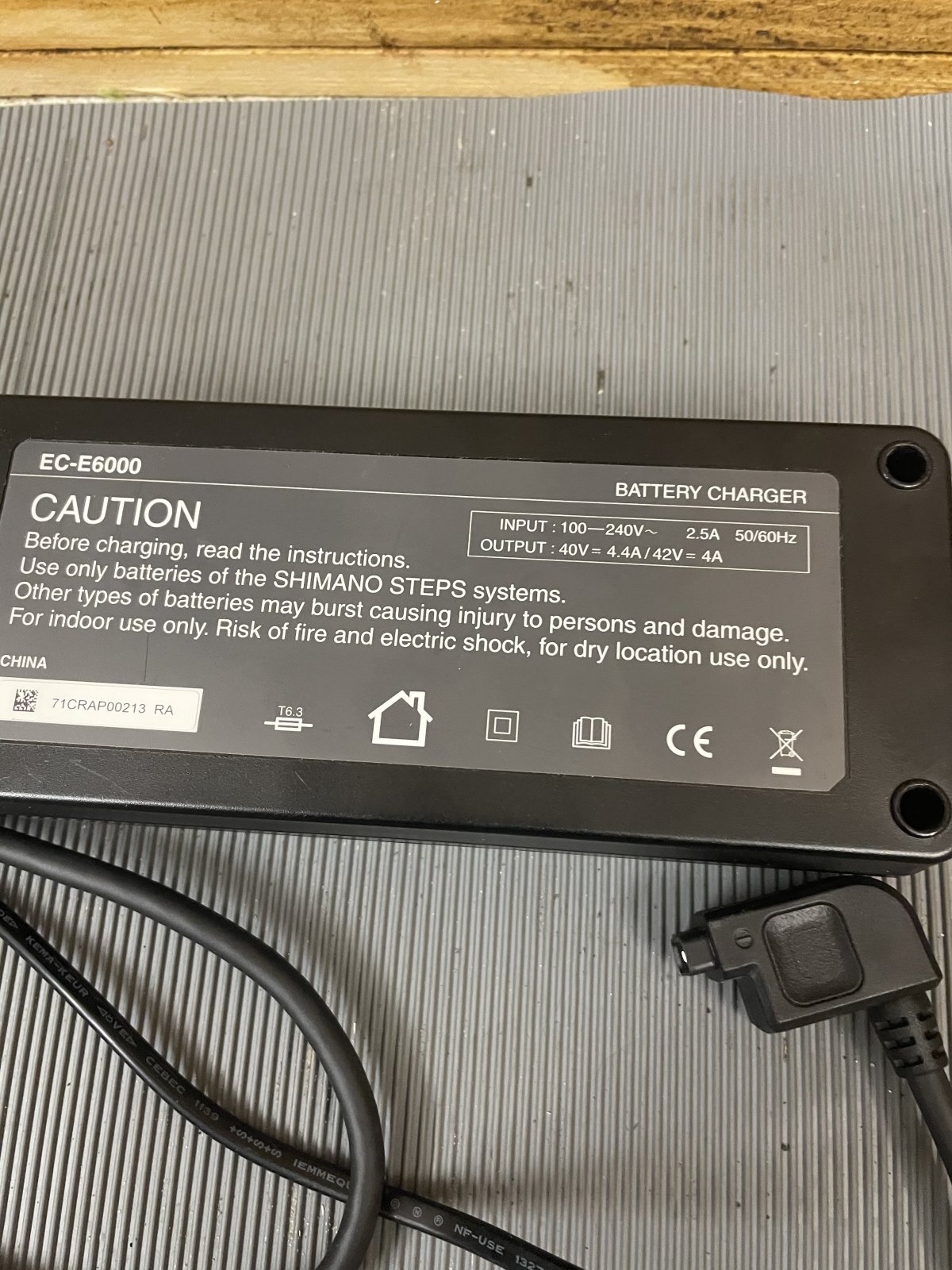

Interesting. What charger were you using? Seems to have been quite a fast charge at just over 3.5hrs?
Just done the test with the brand new battery and measured 516wh, so lower than I would have thought still. I have been assuming 5% loss from the charger and 5% from the battery, but no way to tell.
Given the above values, and asuming both batteries had the same initial capacity, it would show my one battery has degraded by 9% giving 91% relative to new (470wh/516wh). Battery is showing 82% in STunlocker, so in theory better than reported. 9% at 40 cycles seems more like what I'd expect to see.
All charges were done at 20C on a E6002 charger once the batteries had normalised. The meter wont be that accurate, but will give relative changes.
Thanks. That may explain why yours readings are slightly higher than mine as thats an older charger and so probably less efficient.
I ran the test with both the E6002 (1.8A) and E6004 (newer 4A charger) and got readings 5wh apart which is good.

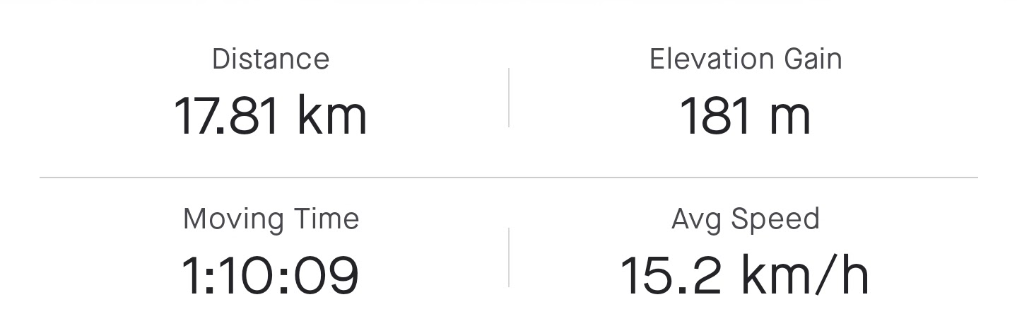

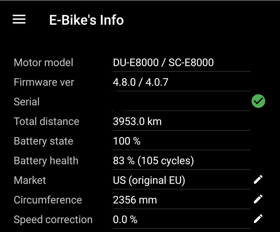

Normal or not?
2018 bike, external E8010 battery. Factory settings exc. EU-->US.
Not sure how fast battery health drops 83%.

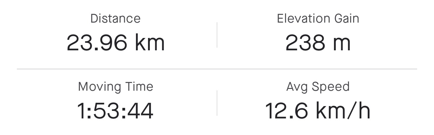

Two of my latest rides:
Super easy trails, aggressive riding, trail mode 100%, temp. +5c = Empty battery
Easy trails, normal riding, eco mode 90% + trail 10%, temp. -1c = Empty battery
Edit: Rider weight 90kg. Both rides autopause OFF.
are you saying you used up a fully charged 504wh battery in just 17.8km and 181m of ascent in trail?
when your average speed wasn't even 10mph?
If so that's terrible range.
What do you weigh? What tyres were you using? and what were the riding conditions?

Yes
Weight 90kg. Tyres DHF+DHR. Cold and wet but very fast rolling trails.
Yeah. that's terrible. Even with those tyres. are they both DH casing and Maxxgrip compound? and what pressures do you run?

Any FACTS about Shimano warranty after STUnlocker use? Found only one motor case:
"I didn't go crazy with my motor, I just used STUnlocker, or Stepsunlocker as it was at the time, to change the market and a few power levels. Changed everything back to stock before returning it to LBS and the motor was replaced without issues."
I´m ready to buy a new battery but sure I use warranty if possible. And who knows if this is motor problem:unsure:

What? You're just mentioning now that you're using STunlocker?
You do realise the motor uses more battery when motor assistance no longer stops at 15mph? and ANY climbing above 15mph uses tons more battery. This combined with a super draggy rear tyre is probably contributing far more to your range issues than you realise.
Stick a fast rolling rear tyre on, inflate it to 30psi and reset your settings to limit it to 15mph and then do a similar ride.
