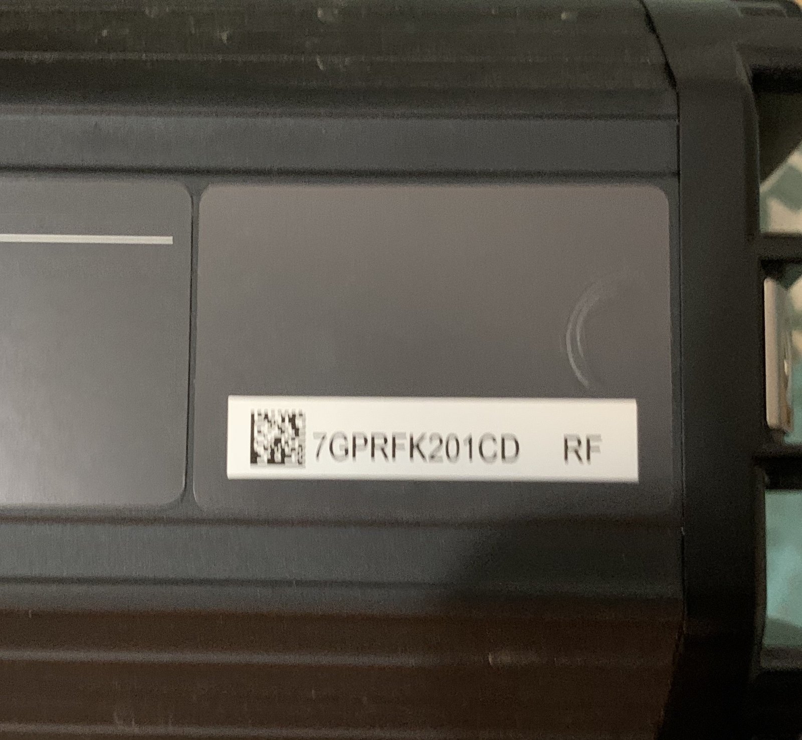

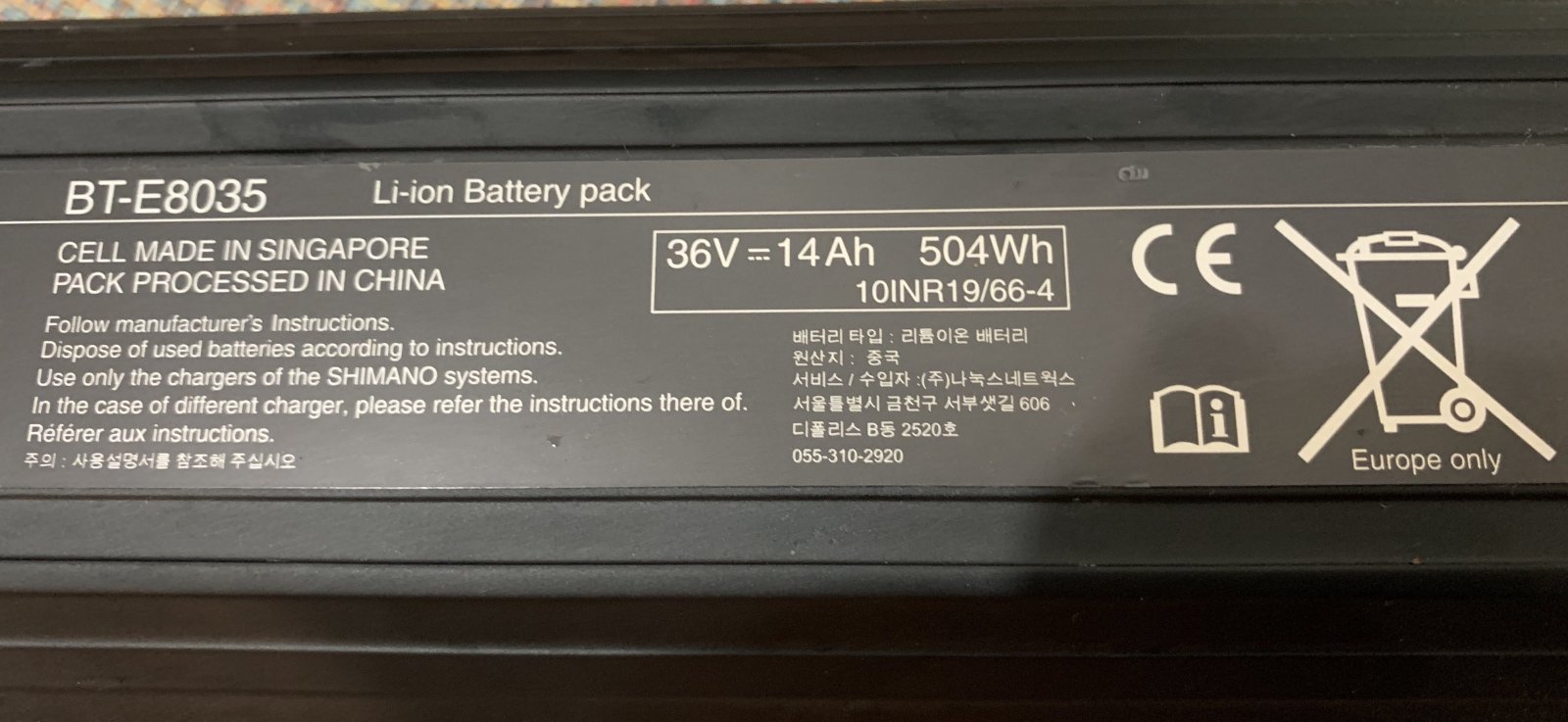

Not sure which model, it's a 504w external one.
No special battery yoga, charge it until it's full, ride it until it's flat.
It's my second/spare battery, purchased July '19.

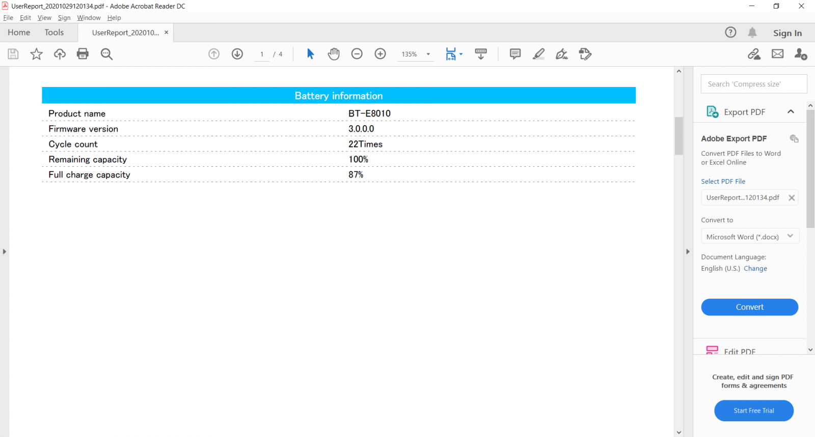

This is just horrible. 22 charging cycles and the battery is down to 87% capacity. I'm going to get medieval on Shimano about this one. Second battery that exhibited this behavior.

My 8035 battery passed 20 charge cycles the other week and also dropped to 87%. While it's difficult to know if the degradatiin is real or not based on riding, i'm now of the beleif it's real and not just a software glitch.

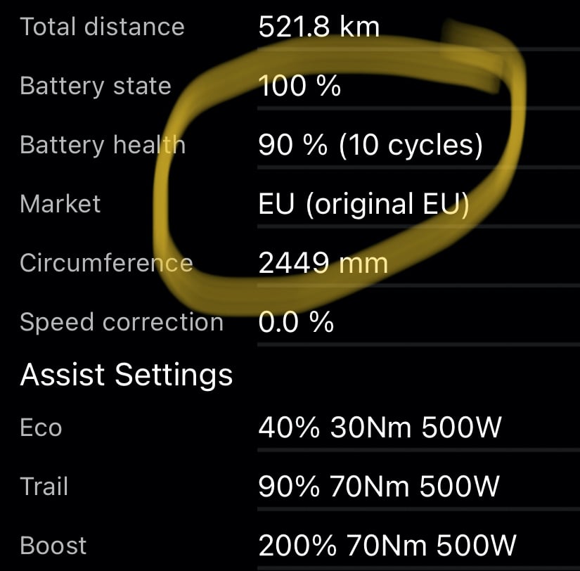

Same here.... 10 cycle and than 90%. 520km 2month
The difference here is , that I have slow charger and I stored my bike 100% after charge. 2-3 ride per week
I always charged up after a ride.
I had 50-50 mixed 100-0% discharge and 100-50 than back 100 charge.
I did not used much boost.
IMO it must be something different, because some of us have faster charger, some of us charge before ride usage . but same outcome.
What I have got here, is that yesterday I have read out my bike data. It was 9 cycle and 100% today I made a ride and charged and it showed the 10 cycle 90%. This pattern we all have.
That can not be coincident , and that show a software issue to me, but maybe I am wrong.
I have added my details, and you can see that my bike power settings are lowered too.
Hope that helps.

Which battery do you have? The issues seen seem to be limited to the 8035 internal battery.
