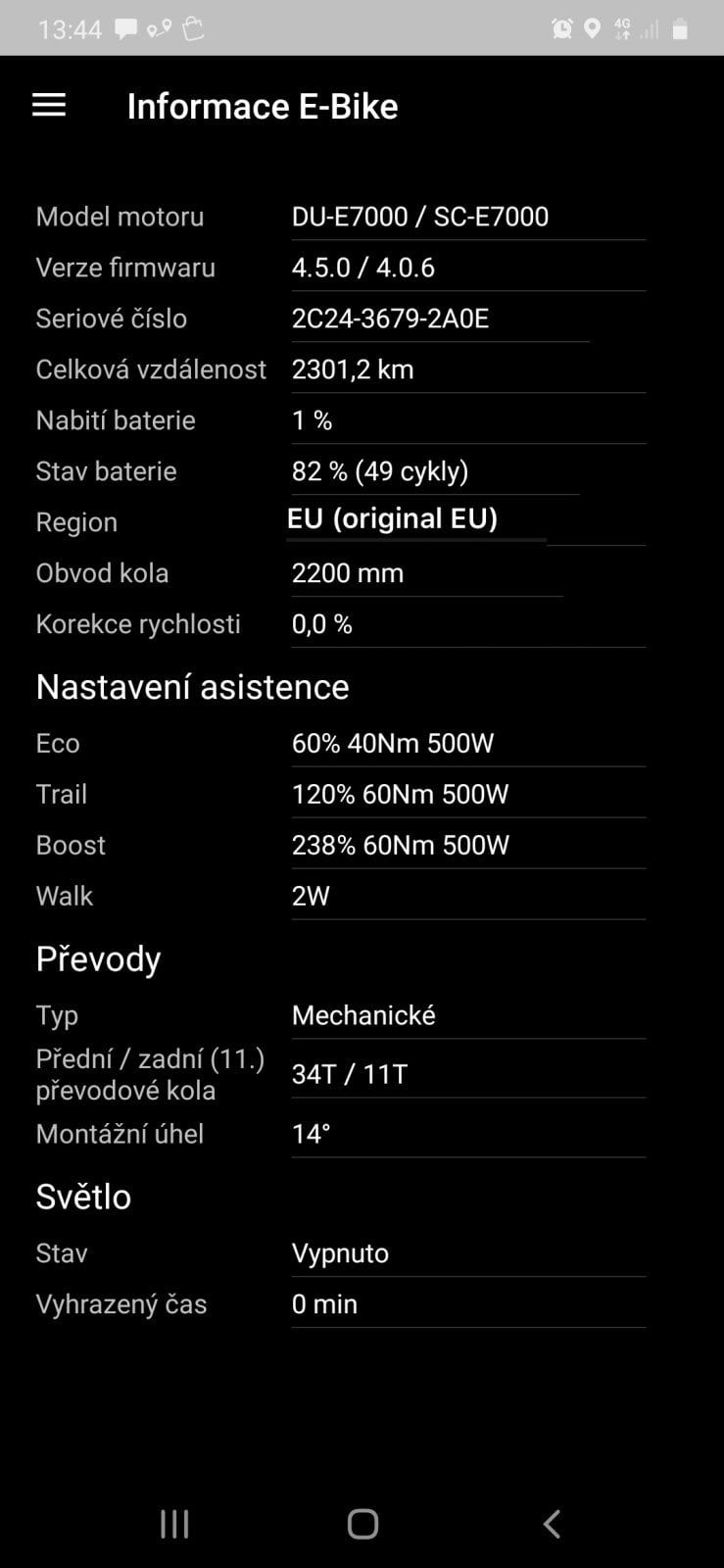

Hi all,
just filed a warranty claim with Shimano.
1) # of charging cycles 46
2) remaining capacity 81%
3) E6002 charger
4) Battery BT-E8035 504wh
5) 2190 km
Basically, I currently loose 1% of battery capacity on every 100 km. A Shimano tech said it was ok and closed the claim. I will reopen this claim next week as all my friends run the same shimano 7000 or 8000 and their battery health is 97 to 99% with more or less the same mileage. After reading all comments here and contacting all sorts of dealers, I am more than certain that there is something fishy about BT-E8035 504 wh!!! It is simple: some pieces are fine, some are not. Whatever the charger or conditions. I wish I was the lucky one to win the right piece if I ever get to win this battle! My customer expectation is that I should be now having a battery with the health of 98% to min. 93%. This would also be in line with what Shimano claims and advertizes.

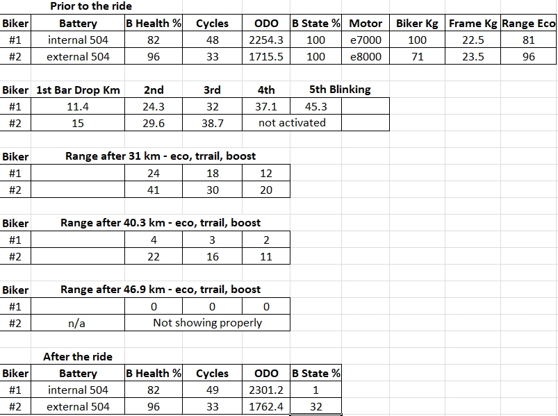

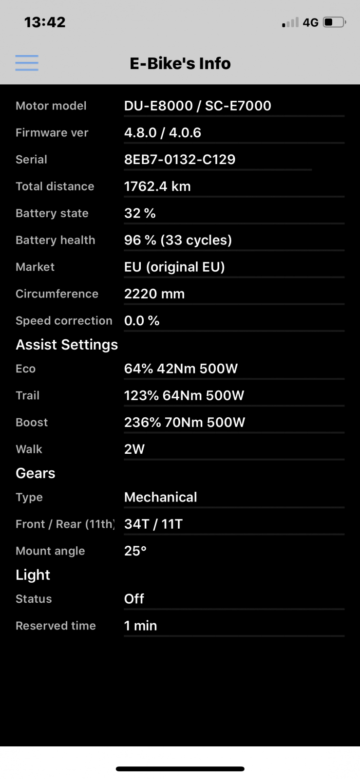

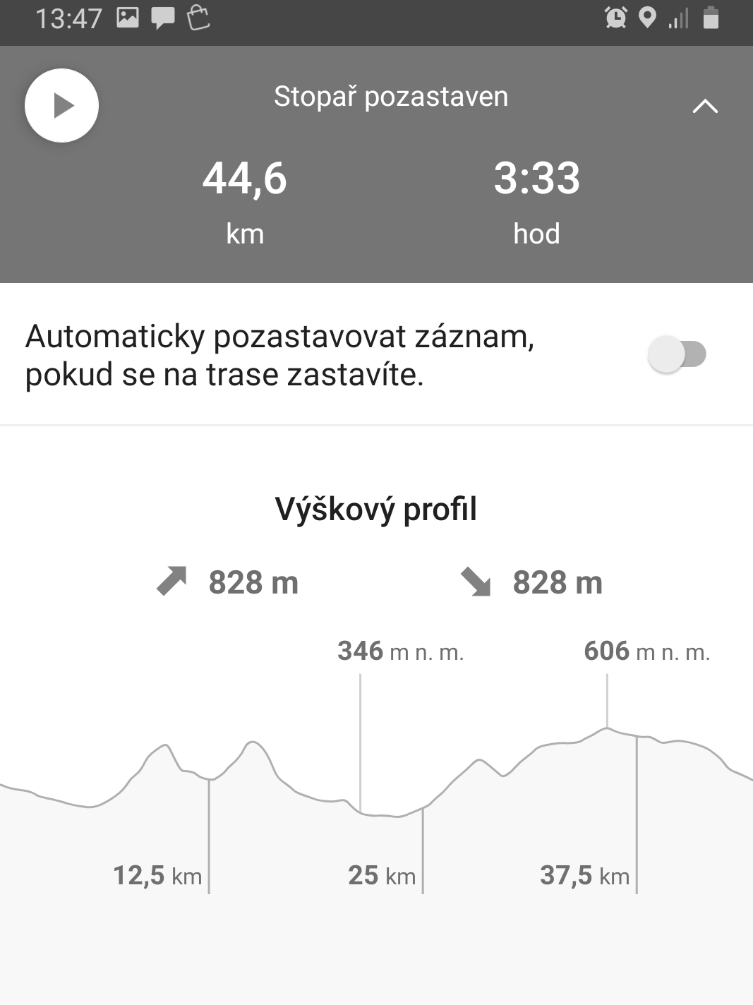

Just finished the comparison of the two 504 wh Shimano batteries, one being external, mine internal BT-E8035. As I reached the end of the readings, I learnt that the silly Biker #2 had changed the parameters of assistance but forgot to also save them! Nonetheless, it is now very clear that the drop in capacity is not a software bug. We went biking side by side and employed simultaneously all modes available including OFF too. While Bob (Biker #2) was at the end left with two bars and 33% Battery State (had stronger motor and was a little more consuming power with assistance), I had 1% and could go only for another 3 kms or so in ECO blinking mode (with a weaker motor and less favourable assistance). It is clear that I am some 30 kgs heavier and it could create an estimated difference of 15 km in the range. It is a pity we did not have the same model of battery to make it even more accurate. But such are our bikes.
The conclusion is: I consider my battery faulty and will have to send it to be diagnosed after the season is over. If your warranty is close to the end, hurry to file your claim. Let me know what you think. Thanks.
Unfortunately there are so many variables there it makes it difficult to confirm either way I'd suggest.
I do find it hard to understand how shimano have managed to make batteries which are dropping capacity quite so much if it is real.
I am the Silly Biker Nr.2 who rode with Milan. I think the test was a good comparison of batteries. The assistence level on my Ghost was set exactly to the same values as his. The screenprint was done before setting assistence levels to show battery health. We rode together, using exactly the same modes. When his battery died , I still had 32% left. The range in Eco shown was 41 km ( I do know it is a very rough estimate only) Our weight difference is 29 kg but I think I had cca 4 kg worth of weight in the backpack. So all up 25 kg difference. I do think his battery is not that "healthy" considering how young the battery is. I guess he does get cca 15-20 less range than he should.

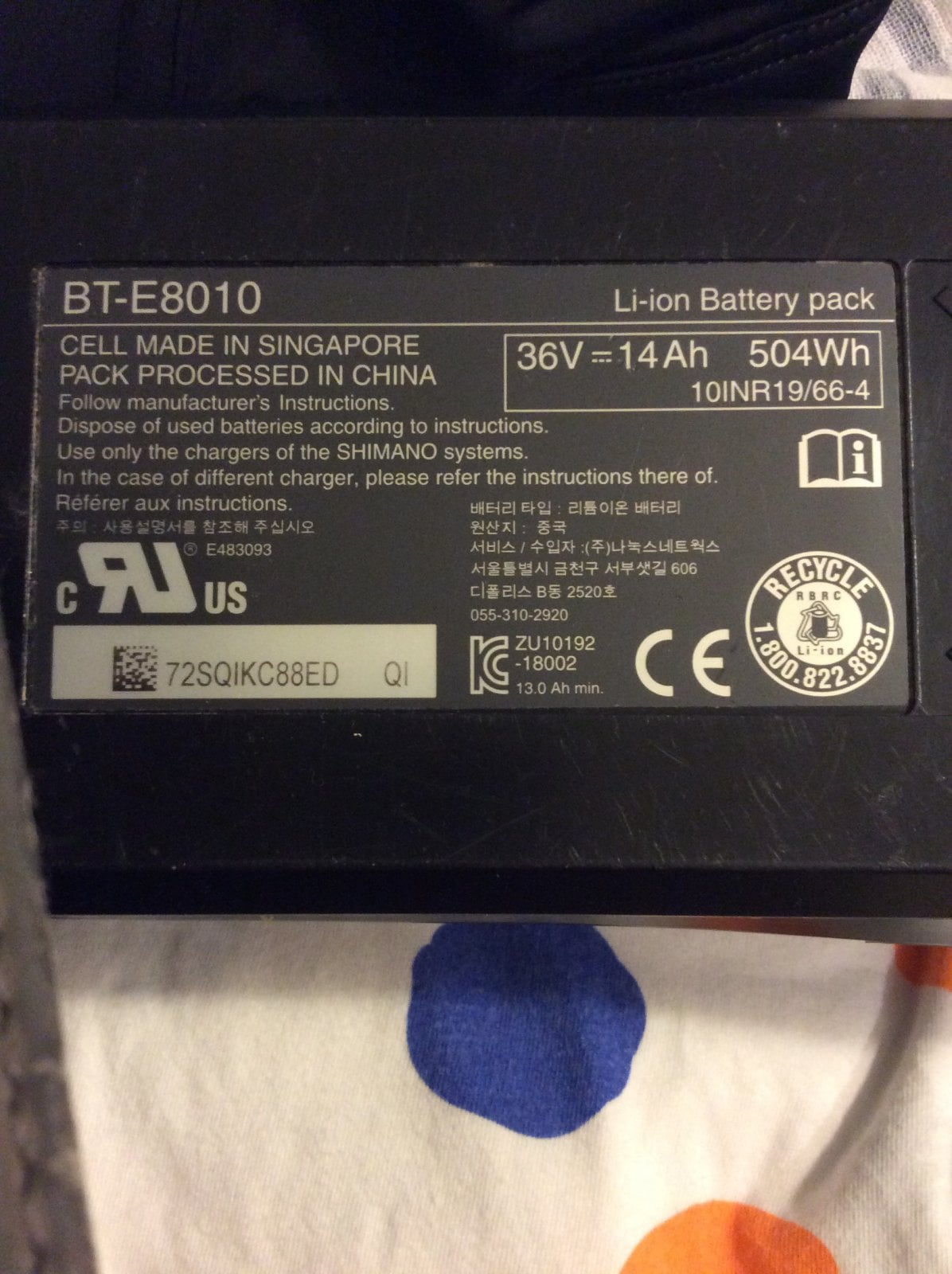

I believe that the bad battery health is related to the battery "version", which is the letter at the end of the battery type.
My battery is two years old and its health is 98% and it has no version letter, I mean, it is BT-E8010. But I know that newer batteries are revisions B and C, ie, BT-E8010C.
I suggest we complement the battery data that we have provided by adding the battery version letter. And may be we can relate the bad battery health to one of the versions, that may have cells from a different supplier that are more prone to fail.

May I ask how many charge cycles do you have on it?
Mine has got no letter too.... probably sequence interested is another. See attachment

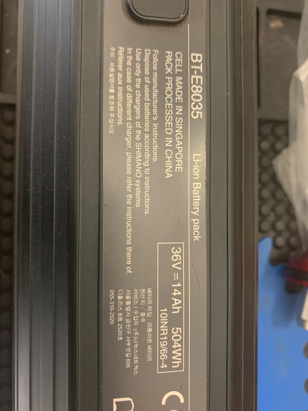

My set of warranty batteries (e8035) are declining in health in the same fashion as my original batteries.
Such a low cycle count and rapid degradation in health is not normal and to me indicates a defective design.

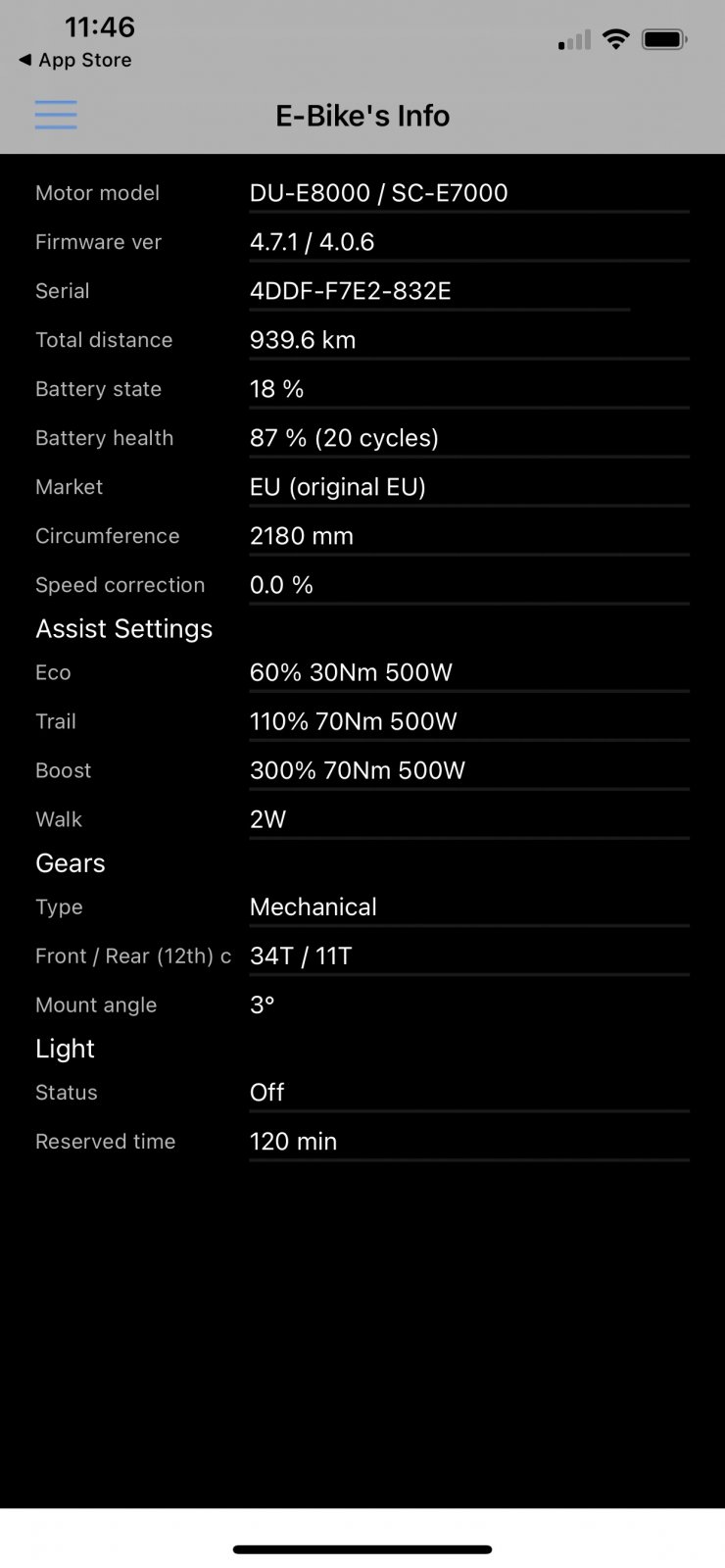

I tried to warranty my previously warrantied batteries and now Shimano is saying they need to be at 60% health or lower to qualify for a replacement.
I am disappointed with Shimano's response given this type of rapid decline falls far outside the norm. I expect my batteries to age, but not this fast. I'm hoping that Shimano acknowledges that its e8035 model batteries are defective.
Original Battery that came with bike:
90% health; 10 cycles
87% heath; 23 cycles (at 87% Shimano agreed to warranty)
85% health; 32 cycles
84% health; 38 cycles
82% health; 40 cycles (exchanged for new warranty battery, took about two months as back ordered)
Original Battery Purchased from LBS:
87% health; 20 cycles (either at 90% or 87% Shimano agreed to warranty)
85% health; 30 cycles (exchanged for new warranty battery, took about two months as back ordered)
Warranty Battery 1
91% health; 4 cycles and - only 20 days old! (Shimano said they wanted more degradation)
89% health; 11 cycles
87% health; 20 cycles (Shimano refused to warranty said it has to be at 60% health)
Warranty Battery 2
90% health; 11 cycles (Shimano said they wanted more degradation)
90% health; 14 cycles
87% health; 21 cycles (Shimano refused to warranty said it has to be at 60% health)
