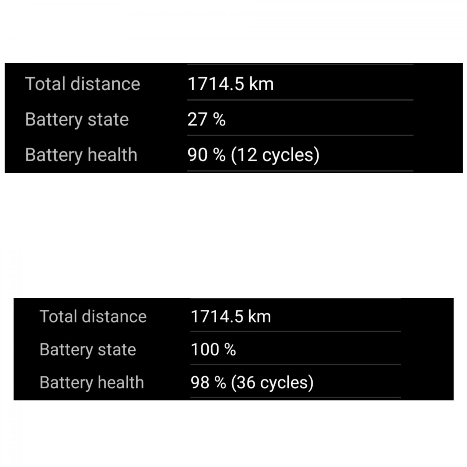

Shimano Battery Life Poll
1) # of charging cycles See below
2) remaining capacity See below
3) which charger you use (fast (E6000) or slow (E6002) charger) Fast
4) Battery BT-E8010 504wh
5) 1065 miles
6) Original battery is 10 months old/ 2nd battery is 3 months old
7) Always stored inside the house
Confused by my data. My original battery, the one that shows 98% health and has the most cycles is the battery that dies when its on 2 bars and I would say I get less distance out of.
It seems that there is something wrong with BT-E8035 batteries. So far I've had 2 of these batteries and both have dropped capacity exactly the same way: 100%>90% at 10 cycles and 90%>87% at 20 cycles. Currently I'm at 24 cycles so let's see what happens at 30 cycles...
I had the same degradation at about 10 cycles (100% > 90%) and 20 cycles (90% > 87%) on my two e8035 batteries.
At about 30 cycles both batteries dropped 87% > 85%.
At around 36 cycles my older battery went up to 85% > 87% then dropped from 87% > 84% at 38 cycles. It then dropped further 84% > 82% at 40 cycles. The eco reserve time on that battery is now basically non existent and it goes basically straight to off.
My newer battery dropped from 87% > 85% health at around 33 cycles.

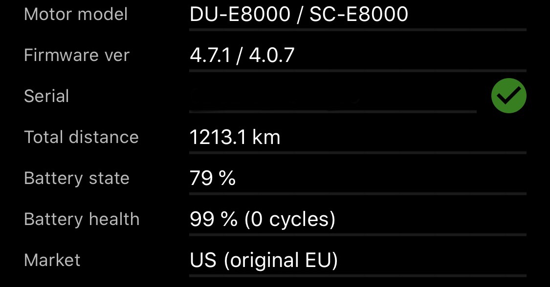

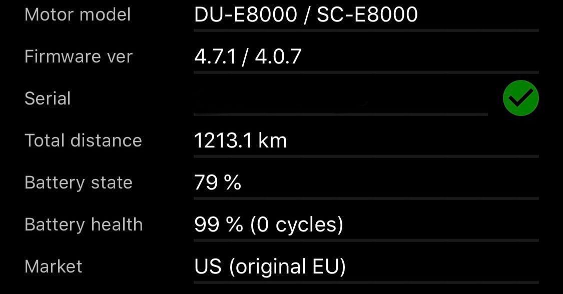

I have no idea how but iv done 1200 plus km in 5 months on my decoy and my battery reads 99% (0 cycles)
Im using the default TY charger (slow) and generally charge when i get down to 2 bars.
That just seems wrong, at the number of cycles is basicly a measure of how much energy has been transferred into the battery divided by the capacity of the battery. In other words, if charged from 0 to 100 ten times that's 10 cycles. charged form 50 to 100 four times is 2 cycles. It shouldn't say 0 cycles unless it hadn't been charged.
