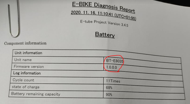

Hi Gents, I would like to ask a small favor from those , who have 8035 battery and NO DEGRADATION with more than 10 cycles !
Could you please check with your dealer readout the FW version of the battery ?
Mine has been read out today by my dealer&service, and I have catched this part that battery has a FW inside.
If you check that with Etube app or STunlocker , than this info is hidden. Ergo you can not upgrade the fw on the battery by yourself.
That made my theory that i believe there is a bug in the Battery Management System (BMS) and if we can find a battery which has 100% health and 10 or more cycles and higher FW version. Than that is it. :cool:

STunlocker does not see the FW. Only Shimano cable version can read that out. As you see in my post yes they do have FW inside. Can be seen and has been validated by the factory shimano device.
IMO if we can somehow prove that , it can help to others to make their warranty claims. To be honest it is very rare that people are reading these info out, or they can really experience this degradation. I am sure 80% of the riders have no info about that. Thats why I would like to ask your help on that, if I am right we all winning. Worst to try right?

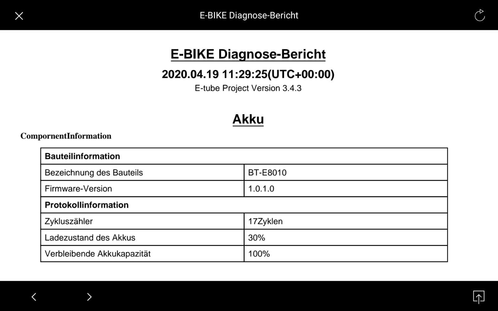

Hi! Mine bike fork has been produced in 2019. The entire bike was produced in 2020 summer. Could be that the battery is older maybe also 2019. I did not have any clue to track that back...
The tablet version of etube does it read out too:
Vielen Dank ! I know that must be difference here. :) No we have a proof ! Thanks

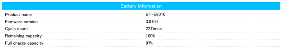

So, I checked mine, and I actually have firmware 3.0.0.0, but as you can see, I have serious battery degradation...so apparently the firmware doesn't address the issue (whether an actual battery issue or a software issue)
