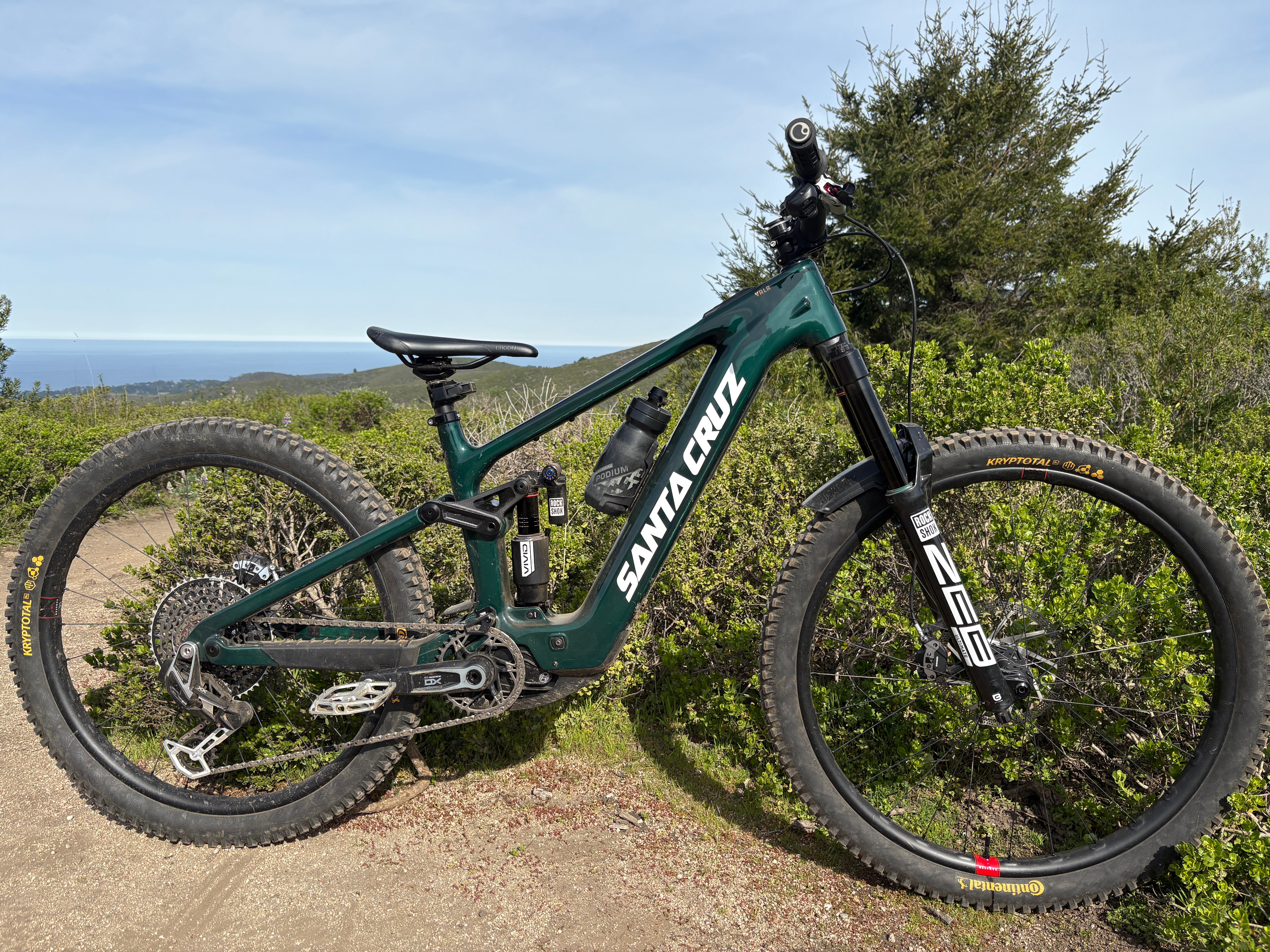

I got my Vala built up and a first ride in. This is a damn fine bike, and yup, it rides like a Santa Cruz. Stiff and precise but not harsh. Goes where you want it to, happy to get airborne. The rear end does seem to get out of the way / swallow holes/square hits better than their VPP bikes. The one thing that feels most different compared to my other SC bikes is the stack is pretty high - 120mm HT on my size medium. I deliberately didn't weigh my build until after I rode it, and I was thinking, this doesn't feel much heavier than my Heckler SL. Sure enough, when I weighed afterwards, my Vala build is 47lbs 2oz, my HSL is 43lbs 11oz (both with pedals and bottle cages).
For the Vala, I started with the XX build but swapped out the suspension for a 160mm Zeb & 65mm Vivid Air, swapped the HD/DH Hydra wheelset for Reserve 30HD/DT350, and OneUp dropper for AXS 170mm. Pedals are Hope F22s. Tires are Conti DH. Ergon SM Enduro Comp saddle & GDH Team grips. OneUp 35 e-Bar. I'll try to get some photos once we have some decent weather.

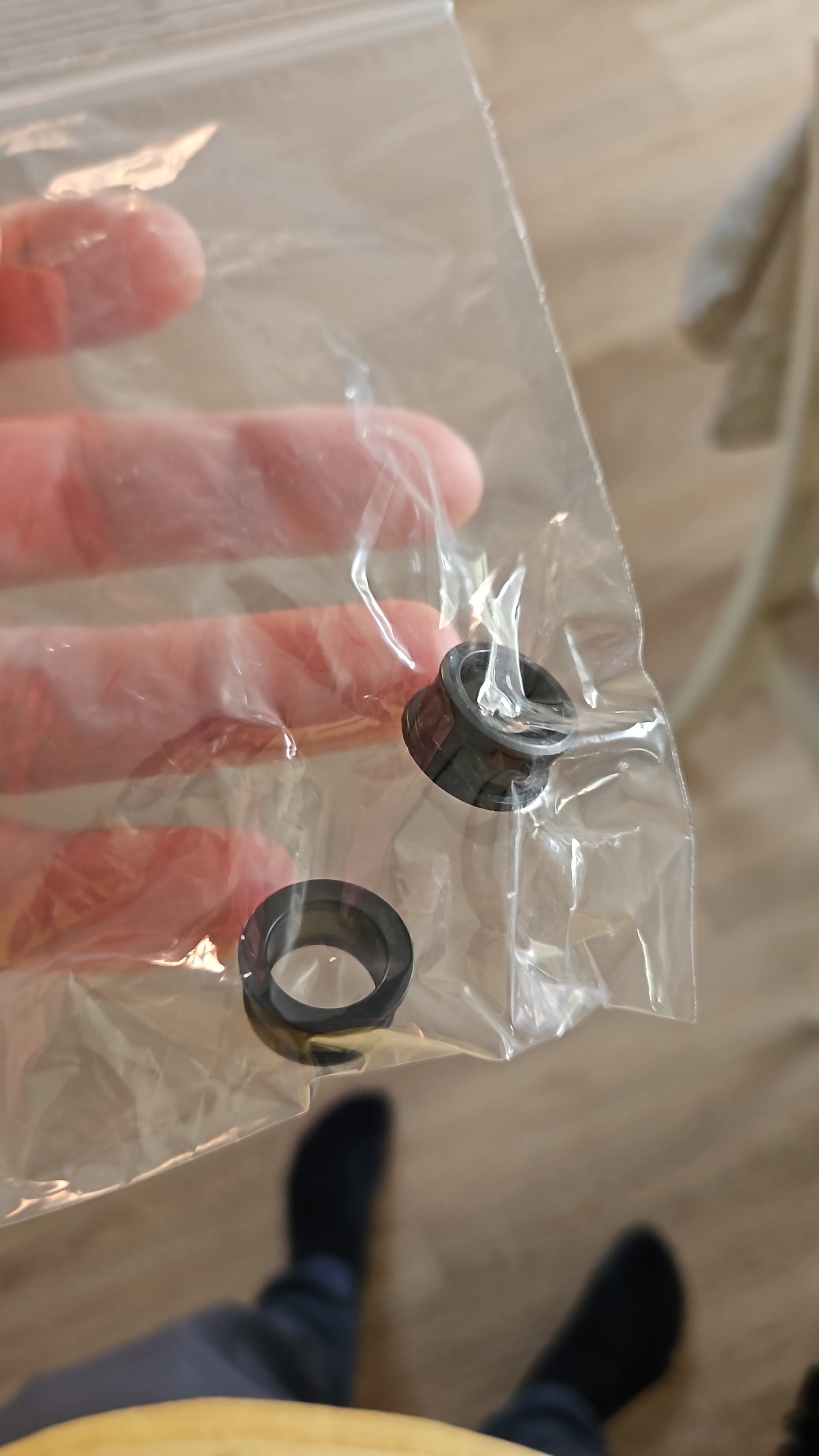

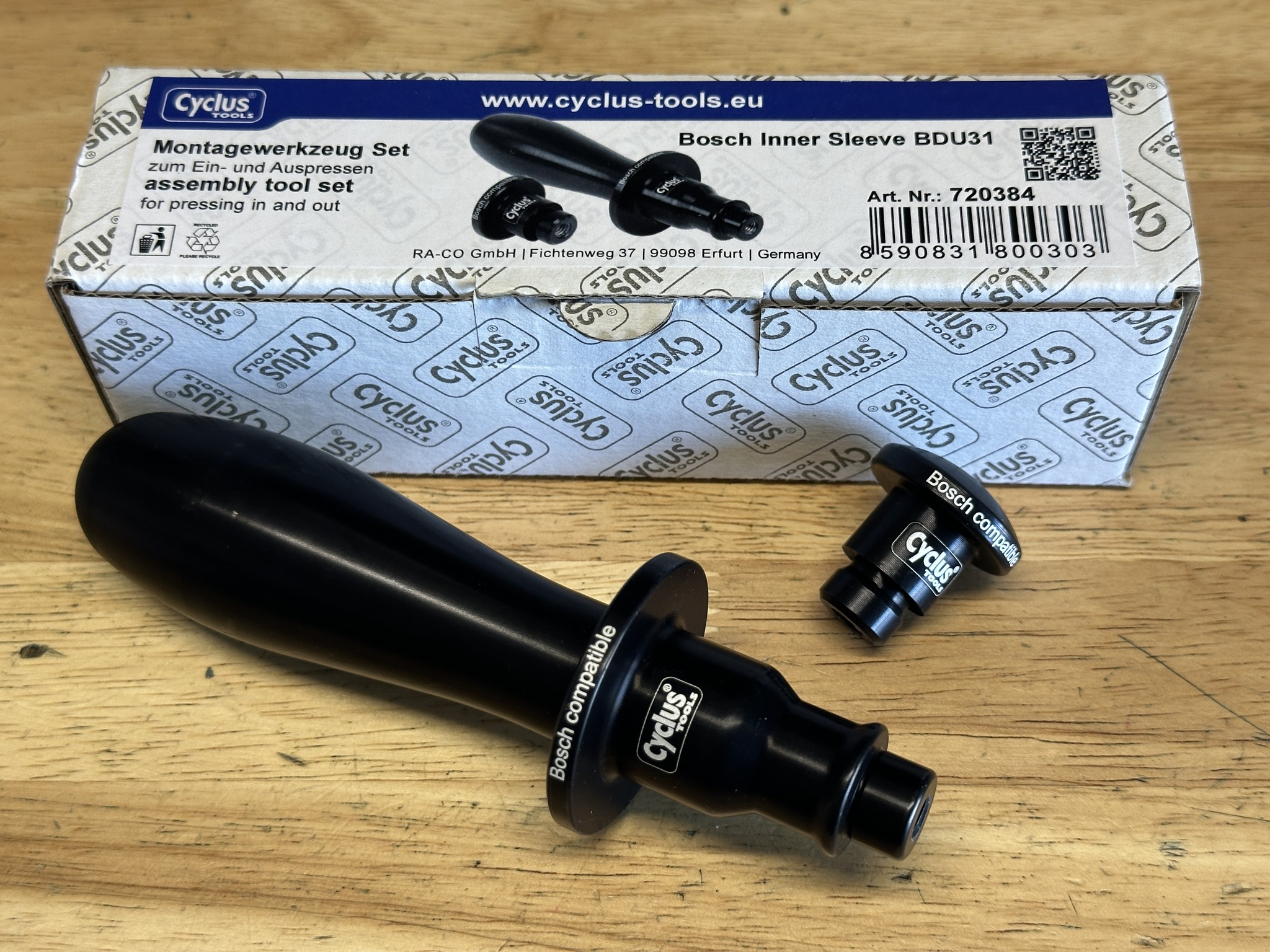

So who's fitted these then, do they press out or do you pull them out ?? Is it a drop the motor job ??
Remove the bolt, press in the new bushing ( I used a tool designed for the job but I imagine it could be done without it ) torque up bolt then repeat for the other motor mount.

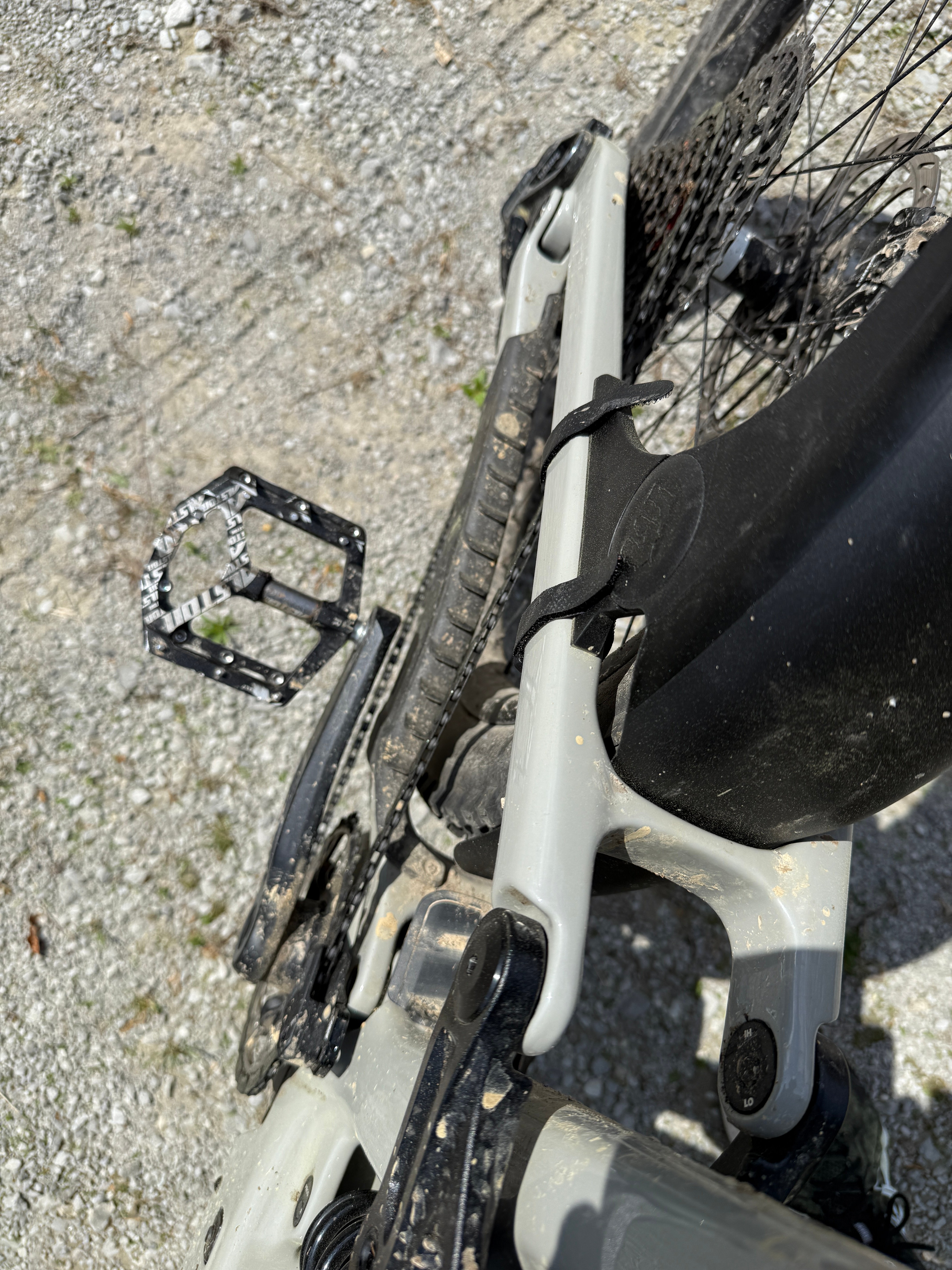

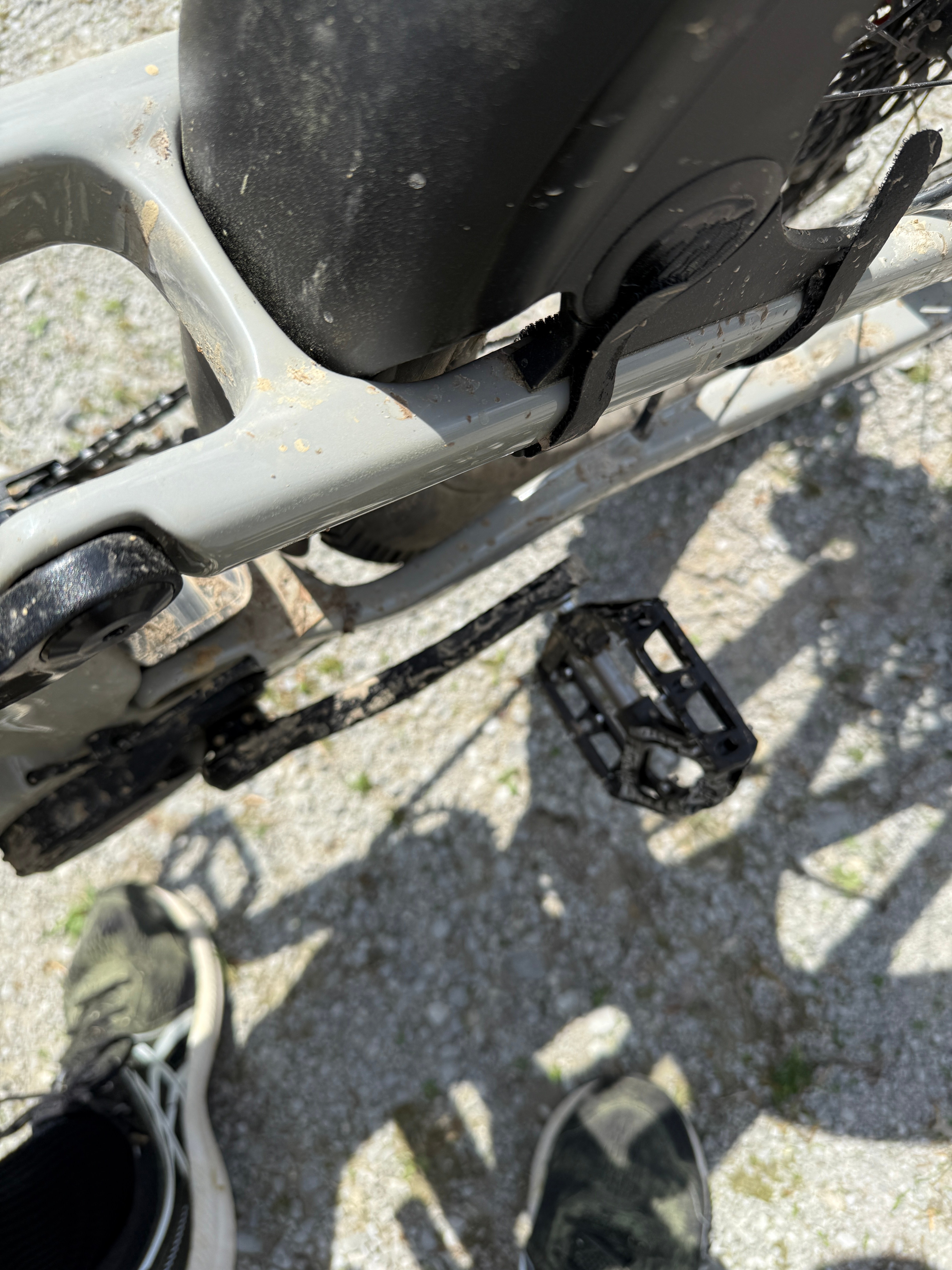

Me again - can anyone with a Vala take a photo of the crank arm / chainstay clearance? Trying to decide on pedals and unsure whether to go for burgtecs which sit flush to the crank or ones with a protruding axle.
Previously haven’t been able to run burgtecs because of heel rub on the chainstay but conscious that e-bikes have a wider Q-factor than normal with the motor, so don’t want to end up with it feeling like my feet feel too far apart, but also want to make sure if I go for some burgtecs then I won’t be rubbing the chainstay.

Almost done with my build - waiting on the Kryptotal Fr Enduro SS to be available for purchase, and 165mm crank arms to arrive
