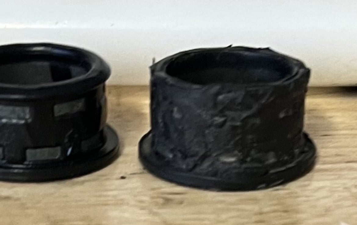

The old bush looks like it has the remains of adhesive or something on it?
I’ve had this exact thing happen on my new cube I wonder if they were never pushed in fully from the factory? I’ve just refitted my old one for now but will try and get some new ones asap.
Funny though o finished my ride without the bush and it was silent with no issues at all for 20 miles. Makes me wonder if it is more of a dust seal than a structural mount?
What did you torque the bolts up to?
