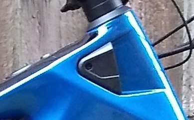

Hi,
I'm looking to re-route the cables from this stupid c.i.s stem to going through the holes in the frame which are covered by plastic covers on my Sam2.
I believe there's rubber/plastic surrounds which are from a jam2 ( I'm not 100% which bike ) but there's certainly something out there which is designed to produce a clean and neat finish for when you choose to use the holes in the downtube.
Can anyone point me in the right direction for these please ?

I answered this before (maybe not to you). I'm pretty sure that the standard vented ports that were fitted to my 2019 Jam2 will fit. You will be able to order them from any Focus dealer.
The vent has a grill facing to the right. All my cables go into the vent on the other side of the bike.

Yes you did reply before but your frame is a completely different style mate so those covers won't work on the 2021 sam2

Again though you're going to have to contact your dealer for the custom grommets to fit in the frame and allow the cables to pass through. I'm unsure but possibly they even came with the bike new (extras in the bike box) but weren't fitted. Don't hold me to that and get upset at your local bike shop for not giving them to you, but I'm just saying that perhaps they even have them in the shop to just give to you.

OK. This is what is needed - KD325920029 x2
I don't see why I cant re-route cables, then just change the bearings in the headset. should be replacements without needing to replace the whole headset. Also, the cable bungs have a slot in so can be added later after all the routing has been done. I'm just going to strip it down and have a look.
