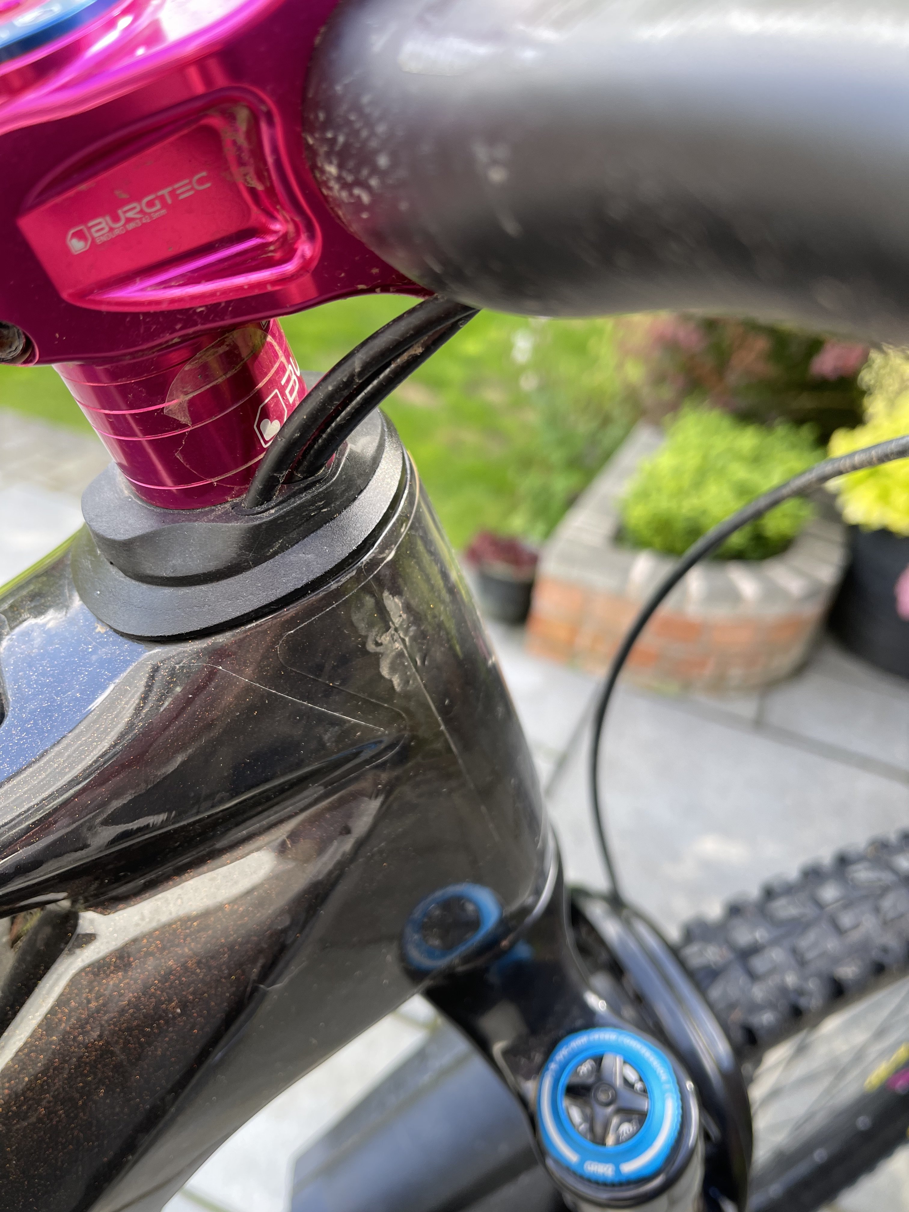

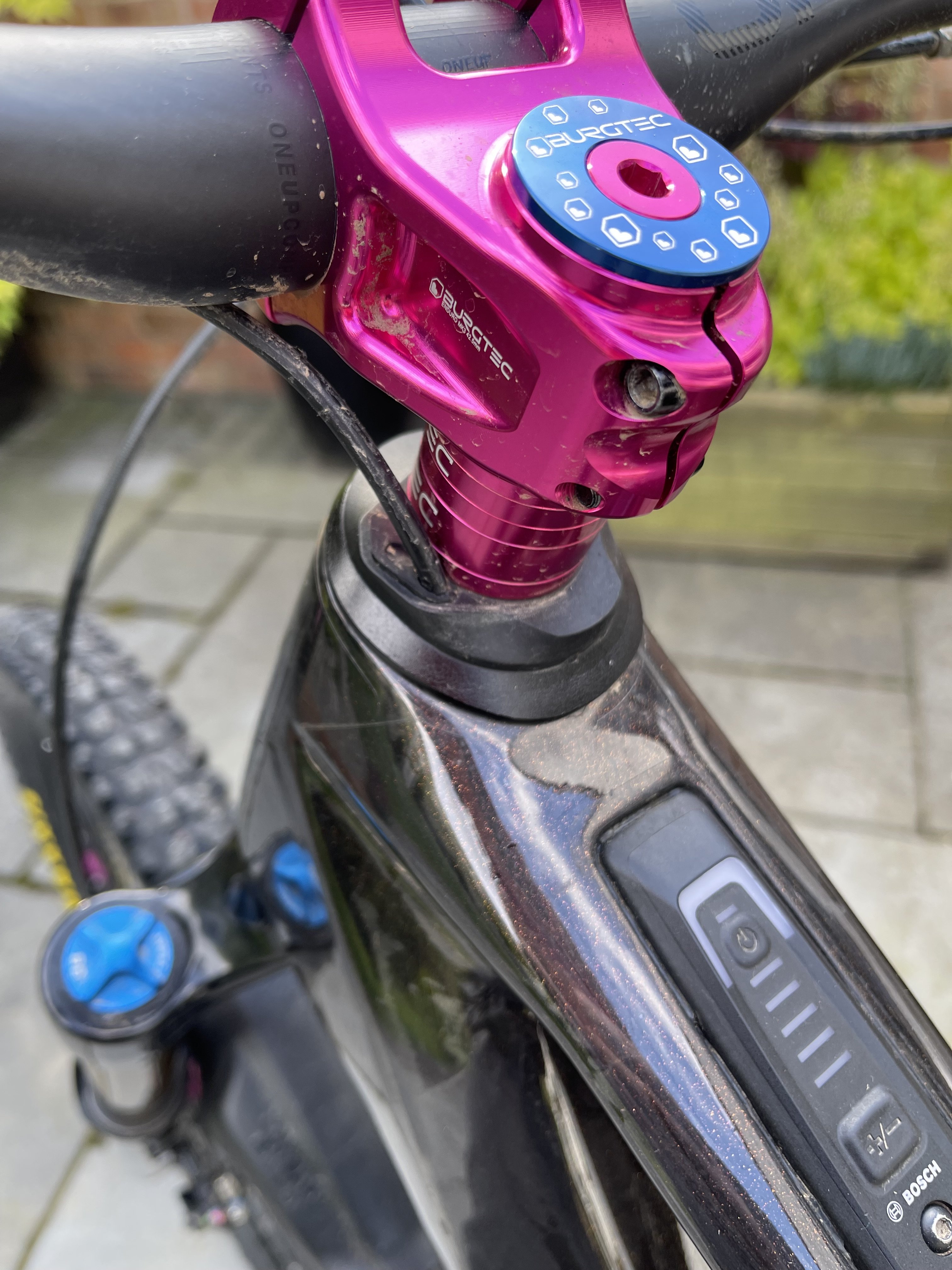

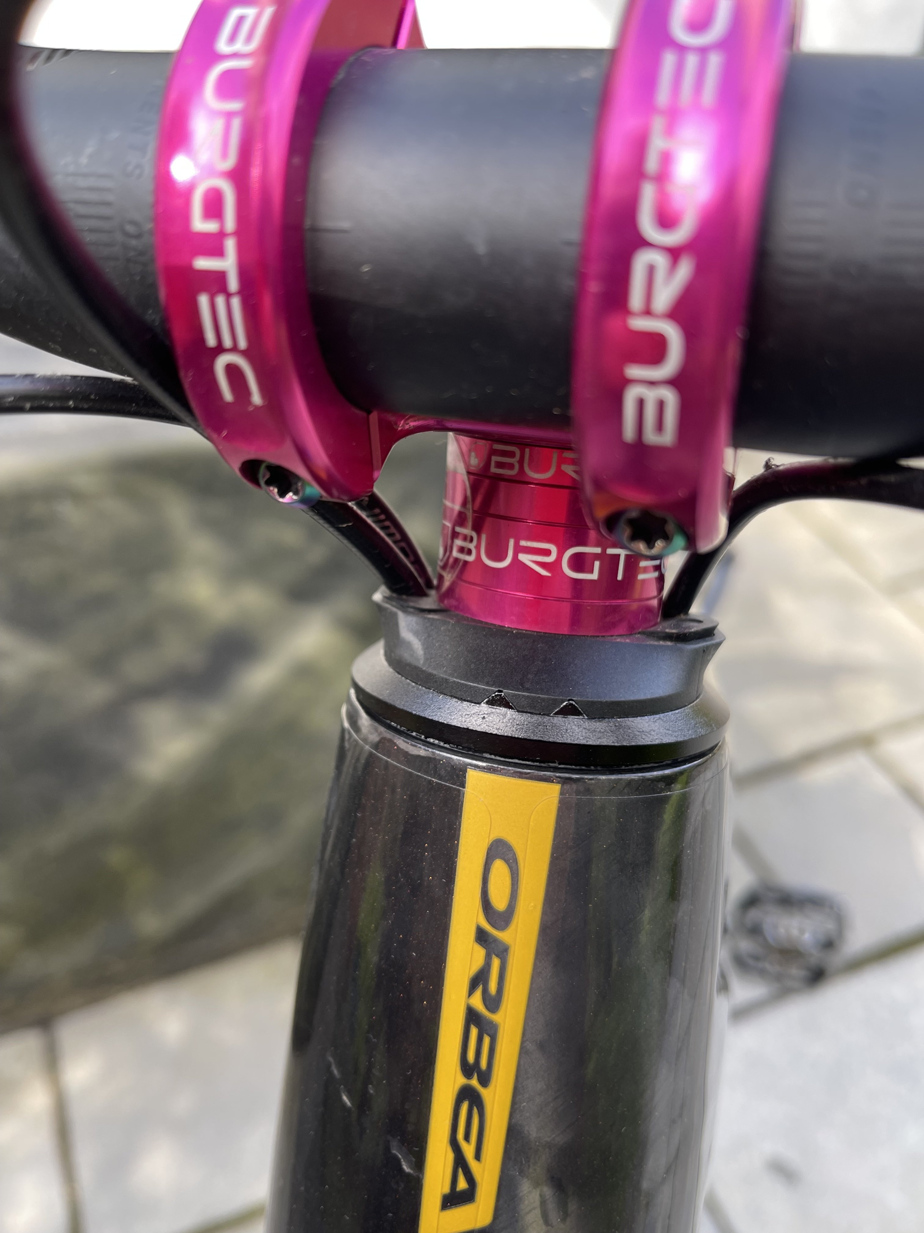

I have done it, will post a close up pic tomorrow if you wanted. My frame is XL so the knock block is void anyway. Disconnecting brakes, dropper and gears is a faff but once done it’s done! Way better options than the horrific split standard spacers and mandatory stem!

Thanks. Looks pretty clean and presumably less a PITA that the stock puzzle set. Where’s the wire from the thumb switch?
Have you ever pulled a cable through downtube? My Urrun doesn’t a dropper; I’ve got one in hand to install, wondering if the space between the top of the battery and the downtube is adequate to pull an outer cable through (with the aid of a cable-pulling kit) and then up the seat tube. I read of complaints about cable rattle in the downtube so I’m thinking maybe there’s room. Or just bite the bullet and pull the motor and battery (as I’ve done several times on my Rail).
Far far less hassle than the dreadful split lunacy it comes with. The bike should come like this as standard. The remote is bluetooth so no cable. Dropper cable runs in the down tube but I have yet to replace one on the bike.. I have zero rattles, in fact it’s virtually silent!
