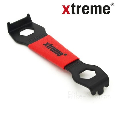

Went to change it last Saturday to do a comparison ride the following day, but failed due to not having the correct tool for the Chainring Bolts. Is this a simple task with the correct tool/spanner?

The 4 chainring bolts are Allen-key 5mm. That's all you need. Maybe a small rubber hammer or very small wood block.

The issue I had with the Chainring Bolts was the captive nut on the rear. Basically, when putting the Allen key in the bolt, the rear was spinning. This is a circular captive nut on mine with two small cutouts.
I guess I need to buy a small spanner or tool for this.

Indeed the back on mine were somewhat spinning too. But touching them with a finger held them while rotating the front, not much space in there !

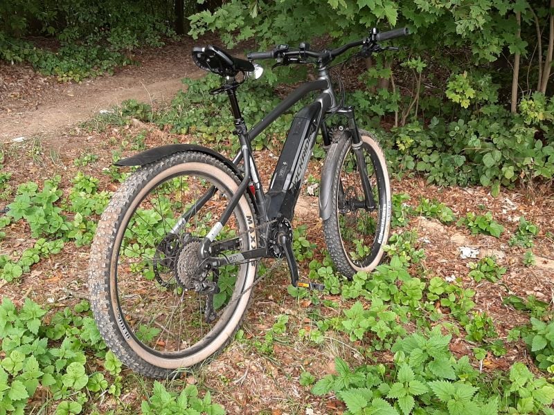

This Winter I’ve swapped my tyres over to Continental Cross Kings, still kept 2.8 width as I often ride up and down the beach.
I’ve had my first attempt at going tubeless which, 30 miles later, seems to be working well.
I’ve swapped the chainring over to 38t. This has made a noticeable difference.
Adding a beavertail rear mudguard and a crud XL front fender has afforded me and my bike some protection!
Maxxis Rekon+ 27.5+ 2.8 Skinwall

Think most of my little tweaks/mods are now done. List to date is: Ergon Saddle, Raceface Ride Pedals, Deathgrips, 38t Chain Ring, Maxxis Ardent Tubeless Tyres and finally a RockShoxs QR Front Maxle.
I can now fit the bike in the back of the car much easier that the front wheel will quickly come off. Previously I had to loosen the handlebars and put a blanket up against my front seats for the wheel to sit on. That's in a VW Tiguan which is fairly roomy with the seats down.
Also, the tyres are smaller at 27.5 x 2.40 and now fit better in my wall mount. The bracket was fairly tight before, but plenty of room now. Not taken them up the top of the Valley and forest trail yet, but they seem to roll nice on the road, albeit ever so slightly louder than the Hutchinsons.
38t Chain Ring is also so much better when riding on open roads, as it does not max out at 22mph anymore.
I'll report back on the tyres soon, as the snow and ice seems to be behind us now and hopefully get out this weekend with the Wife on her shiny new E_ST520. Hopefully I'll be able to keep up with her... :)

You are right about those 2.8 but be careful with too narrow tyres because the lowest limit width for the rim is about 60 ERTRO. I really regret that the swing arm is about 1cm too short because two narrower 29 rims would have been perfect for more rolling terrain.
29" would have been nice, but 27,5 with smaller tyres will also lower the bike a little.
In my case the upper bar is a little above ball-height, every millimeter counts :-)
