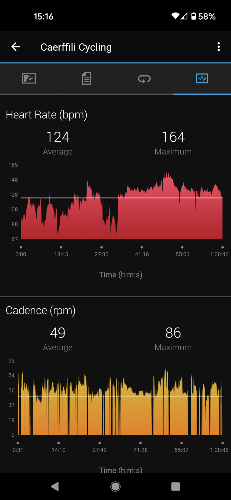

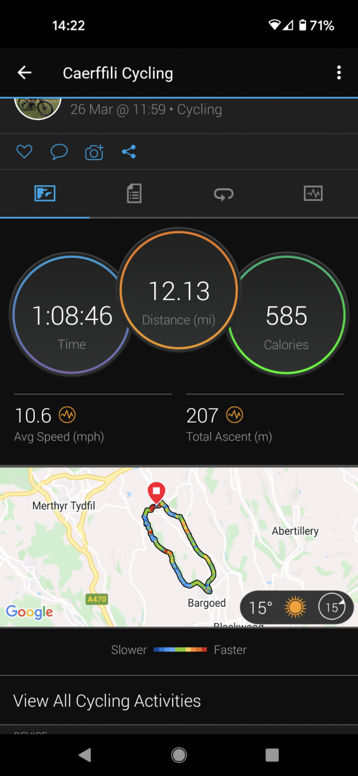

Also trying out a Cadence Sensor on my crank arm, just to see how it logs rides on my Garmin app to help me stay in a sensible heart rate for my old age 😁

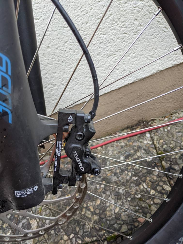

For me: 180 to 203 didn't change a lot. It doesn't brake better, just keeps on braking a littlebit longer.
The right adapters are on sale everywhere, no need to experiment with thermoplastics.
How does it feel compared to original - given same caliper? Love the innovation.
Compared to the original, the braking is obviously more powerful. could be better. unfortunately the whole is penalized by a not so high performance caliper. it was worth a try, given the low cost of the disc (amazon 25 €). I am evaluating the possibility of mounting a double piston caliper.

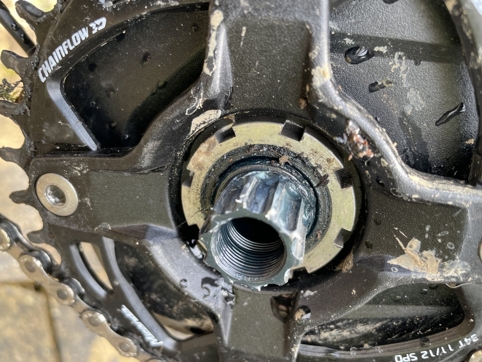

How do you get the chainring off when at this stage?
Do I need a special tool? I can’t tell how the “spider” is attached
You’ll need a SuperB TB1069 tool to remove your chainring.
There are several thoughts on this:-
1. buy the tool, albeit not cheap.
2. pay a bike shop to do it.
3. use brute force on the original chainring.
You don't have to.
Remove the 4 bolts of the chainring.
Turn the chainring around and force somewhat, till it's over the 4-leg cross.

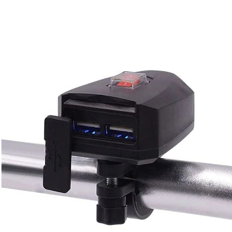

Today I finally installed the 10-80V -> double usb adapter.
Connected directly to the 36v battery cables.
My night spots draw >1A per piece. Works fine, both.
When the bike automatically shuts down, this 36v is shut down also.
So there is no standby battery draining.

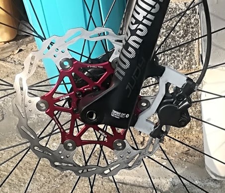

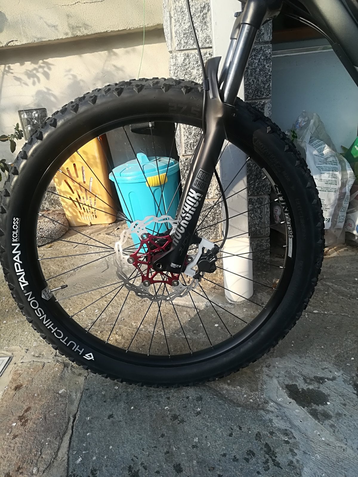

upgrade front disk 203 mm with original caliper.
adapter printed in PETG wit 3D printer.
available free 3D files. STL - STEP
Hi,
Sorry to reply a bit late but aren't you afraid using a PETG adapter instead of a aluminium one ? I mounted 4 pistons shimano calipers with 203mm formula rotors and the braking power is quite high.
Hi,
166 / 5.000
Risultati della traduzione
Hello, for a 4-piston caliper I also advise against using the petg. for the original it seems to be fine. by now I have tried it on all types of terrain and slopes

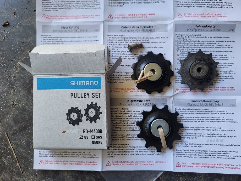

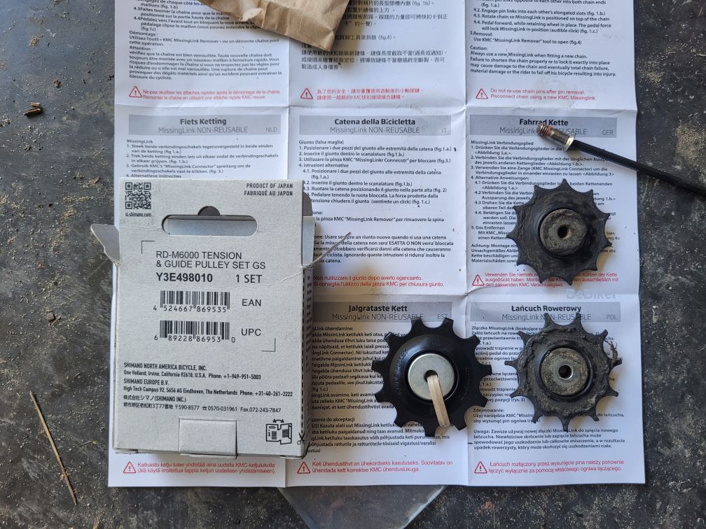

Time for a new chain again, and a new pulley set for the derailleur.
Rear derailleur version: medium (GS)
Big difference there between old and new. Think I'd best check mine.

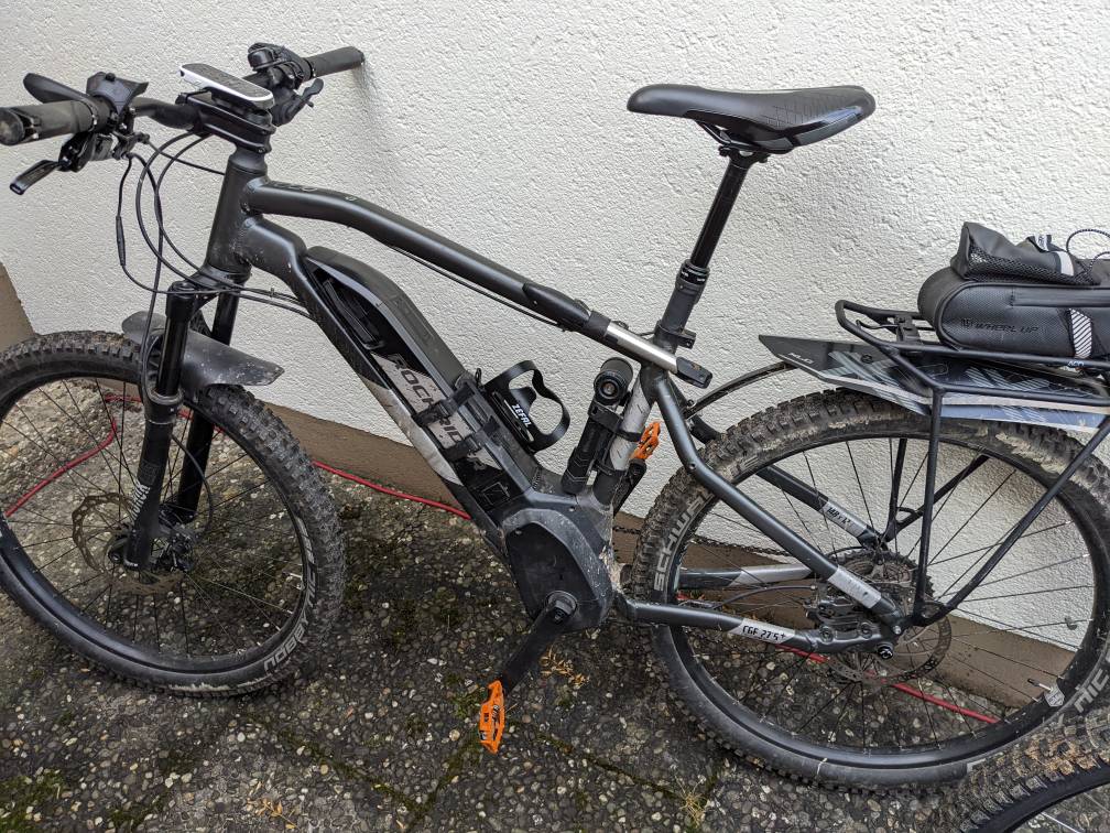

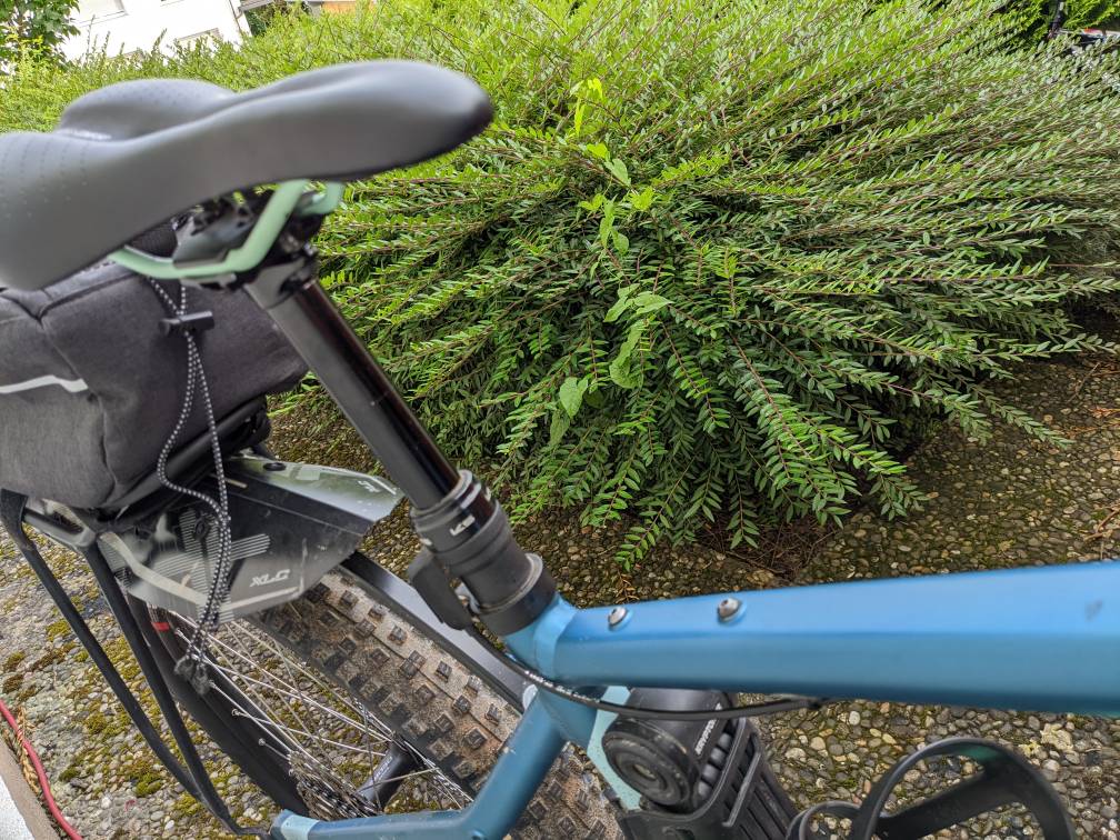

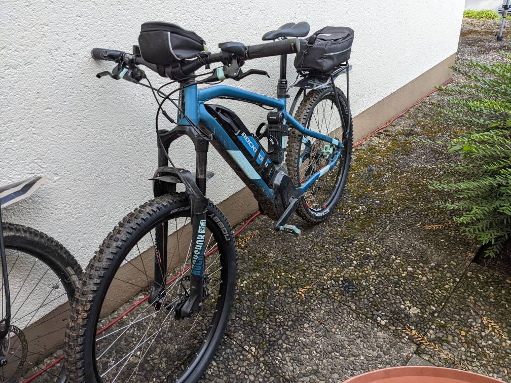

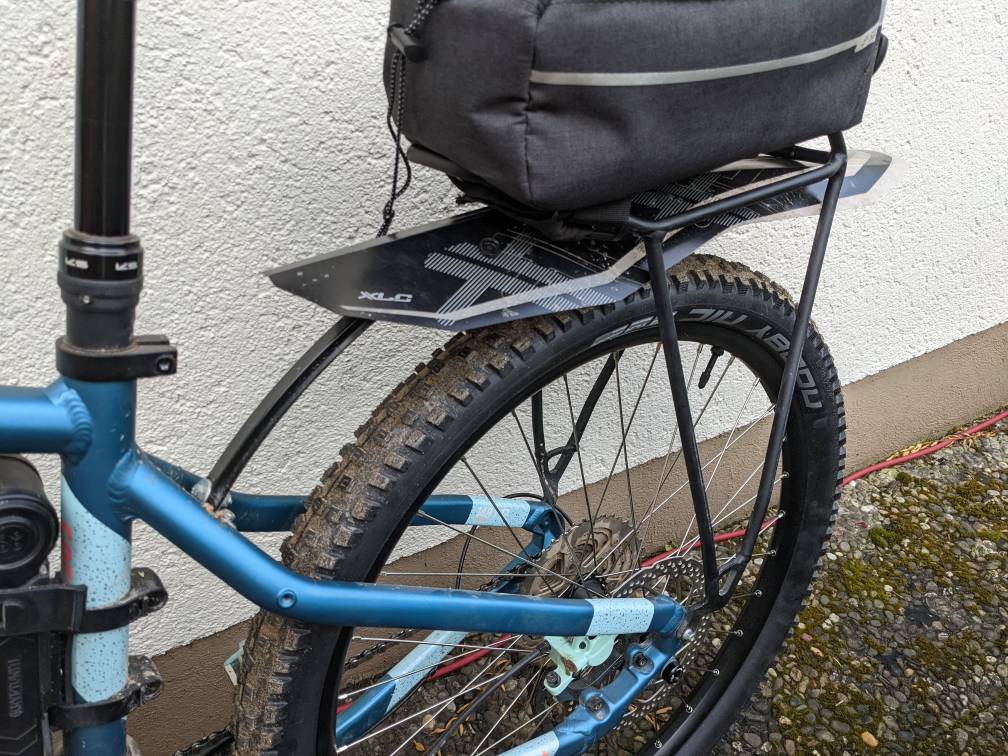

Here are some mods my wife and I made to our E-ST 900s. We live in southern Germany at the base of the Black Forest. A lot of steep forest roads with loose gravel.
Wife's:
-I built up a set of 26 inch wheels, she's short & didn't enjoy the lack of clearance. Running 26x2.4" Nobby Nics tubeless. I'm on the same tire in 27.5". Much better than the stock tires!
Both:
-Cube brand rear racks, slight mod for the bridge mount, just a little L bracket. There are probably better track solutions, but these work ok.
-XLC rear mud guards mounted to the bottom of the rack.

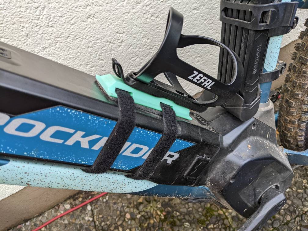

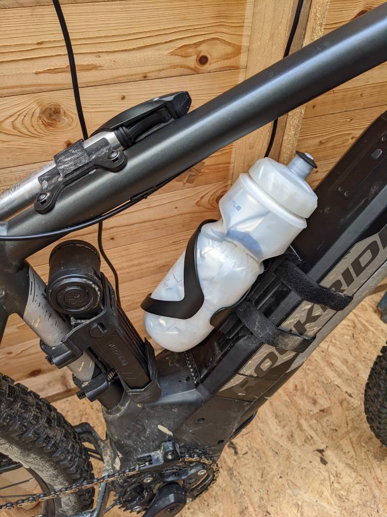

-3d printed bottle cage holders on the battery pack.
-KS Dropper posts with external cable routing (internal routing won't quite work past the motor).
-Ergo grips.
-4 piston Tektro Orion front calipers.
-203mm front rotors.
-Hidden Apple airtags for anti-theft.
-Kyptonite brand folding locks.
-Katana V-Grip Bar Ends mounted inboard of the grips for more hand positions.
-Simple front mud guards, may switch to something bigger.
We also each have another full wheelset with Schwable Ben Ben 27.5x2.0" touring tires (with cassettes & rotors mounted for quick swaps). The range is well over 120km on eco and mostly flat roads with these wheels/tires.
