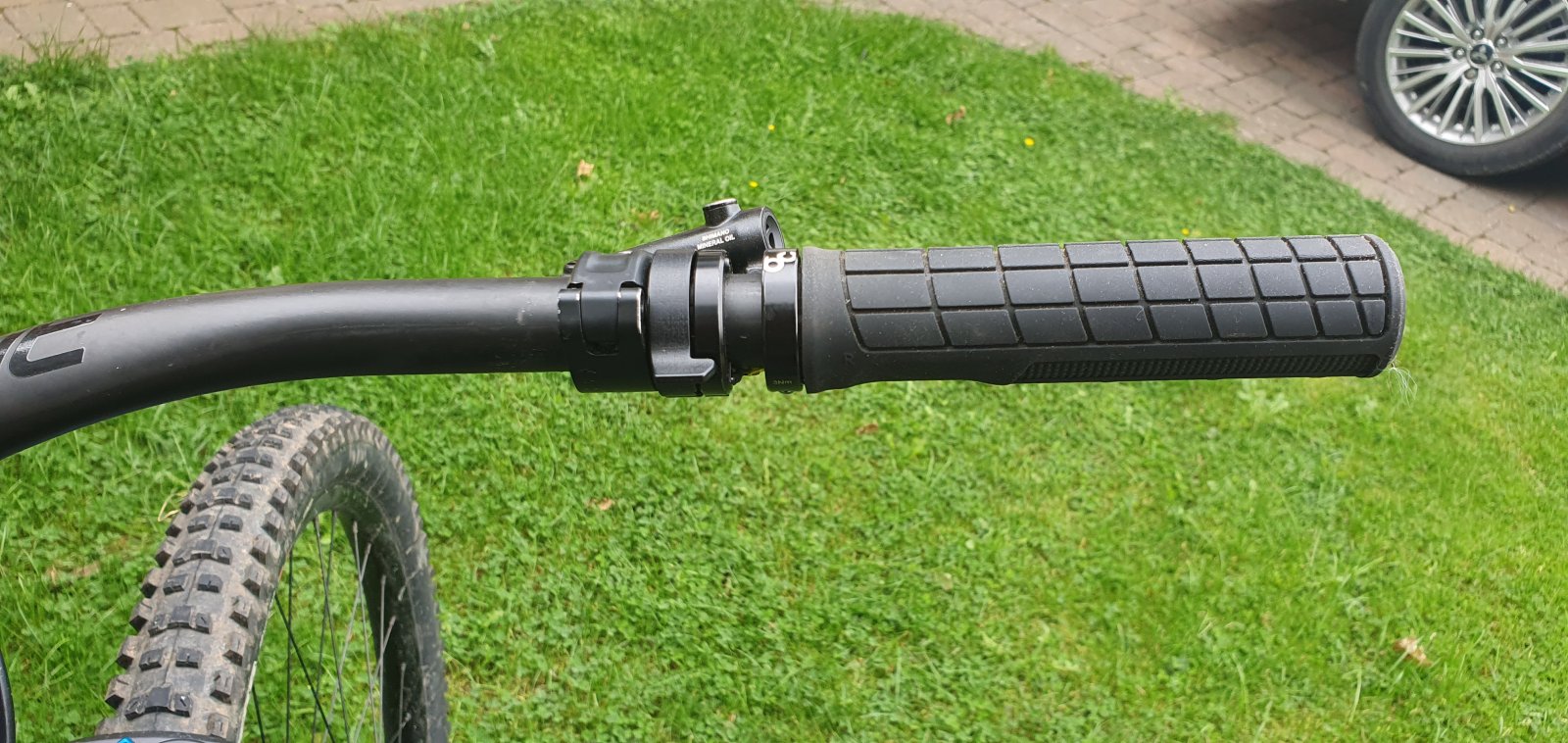

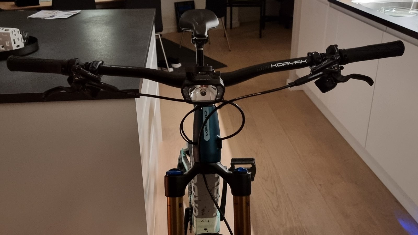

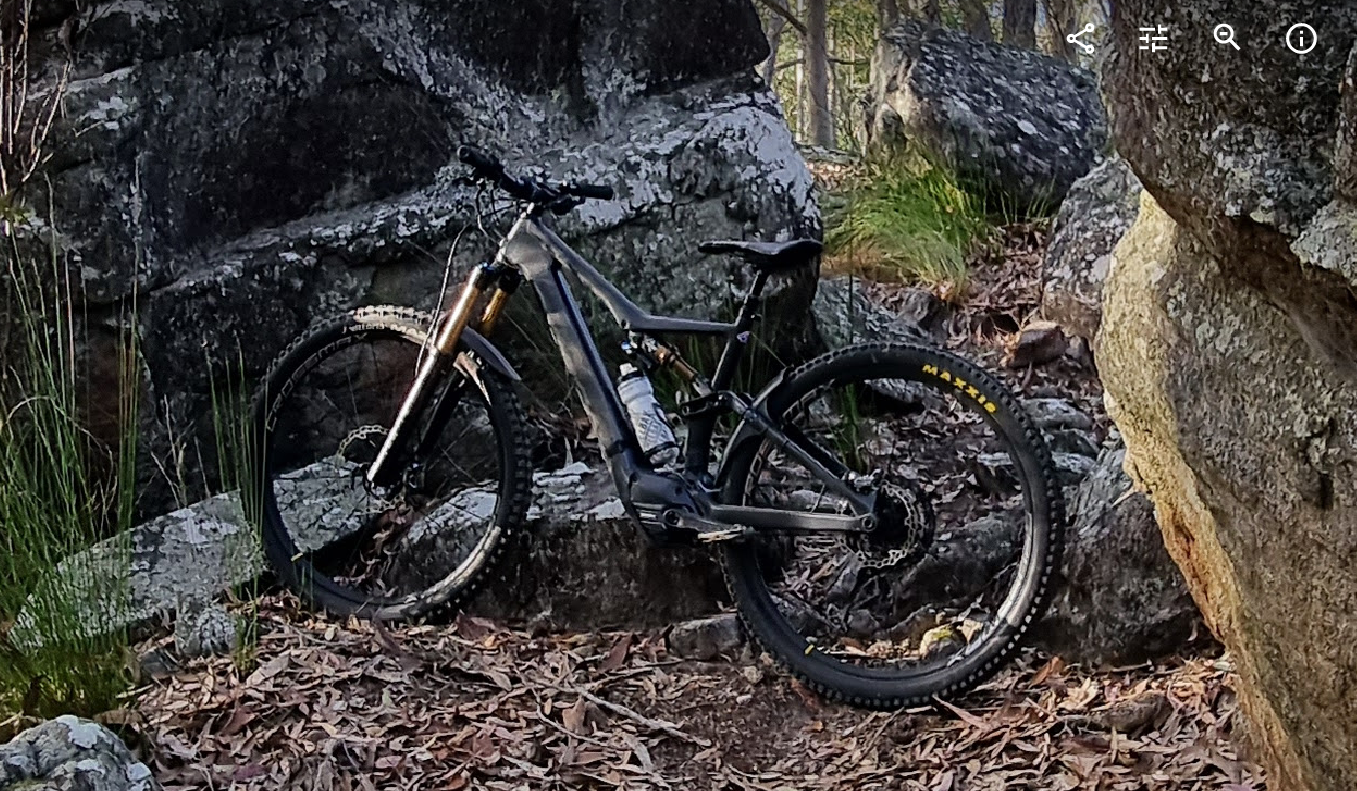

A photo of a mod I did last winter with PRO Koryak Di2 bar/stem combo, Lupine SL X, AXS dropper/shifting. The EW-EN100 junction box is hidden inside the bar along with wires to remotes on both sides (power mode, lights). Pleased with the clean look. The Lupine is not terribly impressive but I guess is as good as it gets with the Shimano power output for lights.

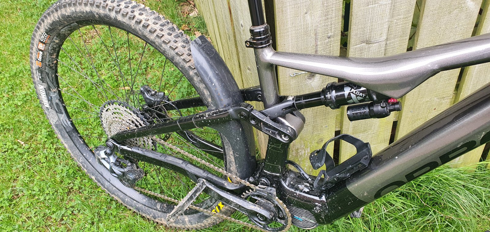

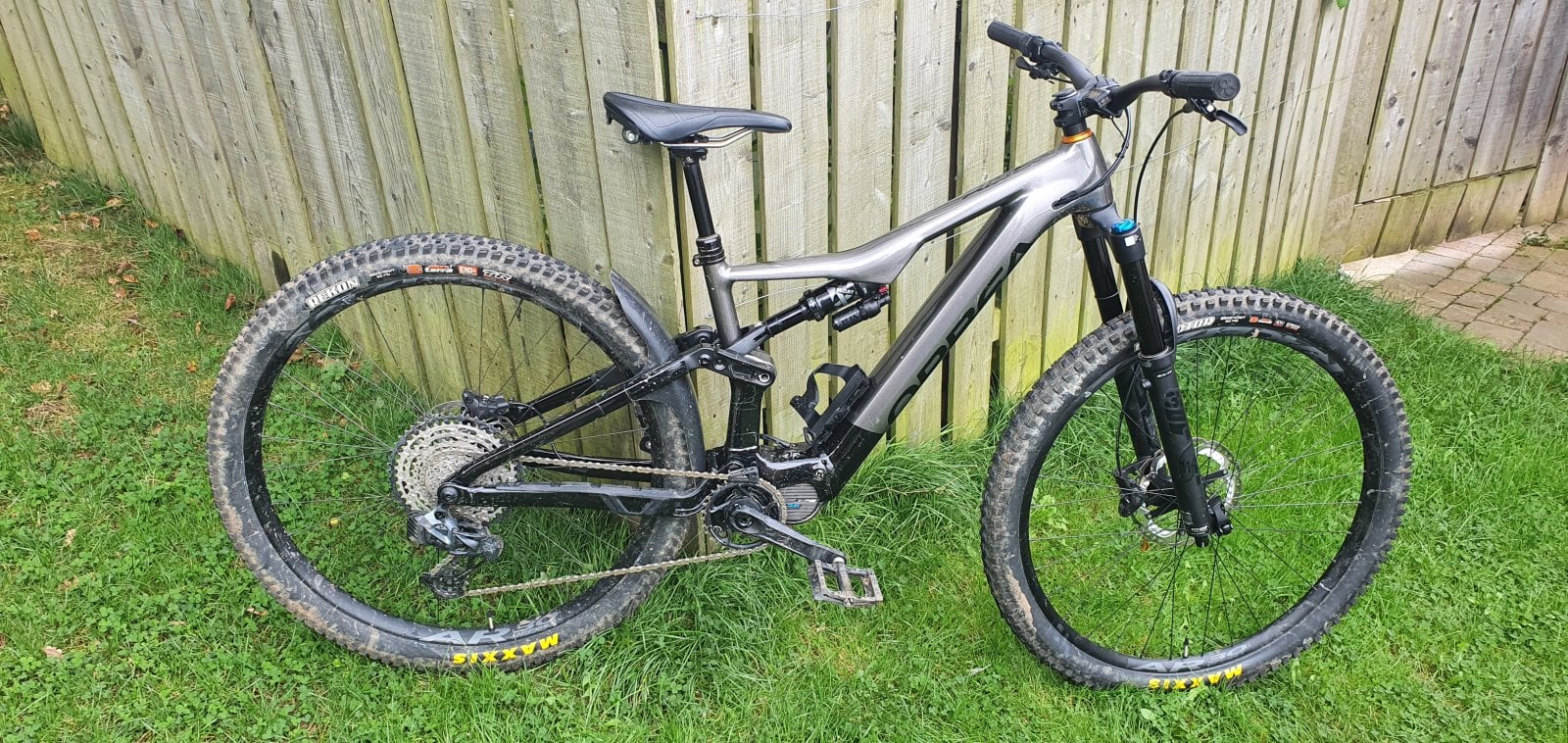

After giving up on the 8mth wait for my Orange H15 order I picked up a grey one 3weeks/ 250 miles ago from a dealer 60miles away. I'd had plenty of time to collect parts including a matching orange hope headset which now doesn't match the grey bike😁
Here's what I've changed so far....
• Std M6100 brakes with 203 Icetech front disc. Brakes are performing great so far despite all the negative reviews I've read.
• AXS wireless shifting with zirbel shifter for incredibly quick and effortless shifting. Would like AXS dropper with Zirbel actuator to clean up the cockpit even further but the dropper post cost is a bit too much for my liking.
• Oneup carbon ebars with Shimano cables and AXS wireless sender fitted internally.
• Oneup edc toolkit in the stem with headset threaded to give more room for the tubeless tyre stabber & bacon strips.
• Original tyres but tubeless. I thought I might get away with these, at least in the summer, but I had a couple of major slides at the local bike park where I lost the front and back together in dry high banked turns. I managed to just hang on to the broadside/ drifts but will be switching tyres soon, I'm used to 2x Magic Mary on my previous emtbs.
• I re-used my Specialized Henge comp seat from my previous bike because its so comfortable and also for the SWAT mounts so I can carry C02 & adapter plus light under my seat when I go without backpack.
• Hope headset changed after reading about how short lived the original Acros headset can be.
• 3d printed some plugs to plug the holes left by gear cable removal.
• Invisiframe self fitted before 1st ride. Takes time and patience to fit to a reasonable standard. Mine came out on the good side of OK but I would think twice before doing another bike myself.
• Mudhugger FR fitted backwards on rear wheel. This works really well. I trimmed what was the curved front of the mudguard to a straighter shape.
• Range Extender has been essential on a couple of occasions so far where I've used about 500Wh in 35miles/ 4500ft of a 45 mile ride.
Next on my list is a 30T front sprocket for the more technical/ brutal climbs I've been struggling with, but I haven't been able to find one yet.

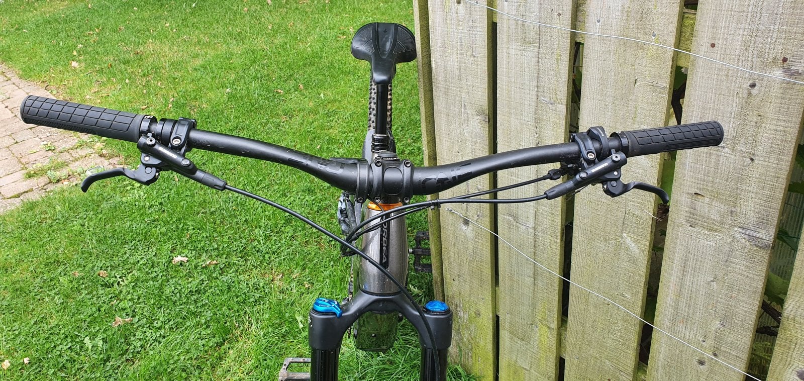

• Oneup edc with headset threaded.
Needs more orange.
Seat post clamp and some grips with orange collars. Maybe some orange valves on the wheels.
I say that, my bike is orange and I'm not keen on it lol I wish I could have found a grey one locally.

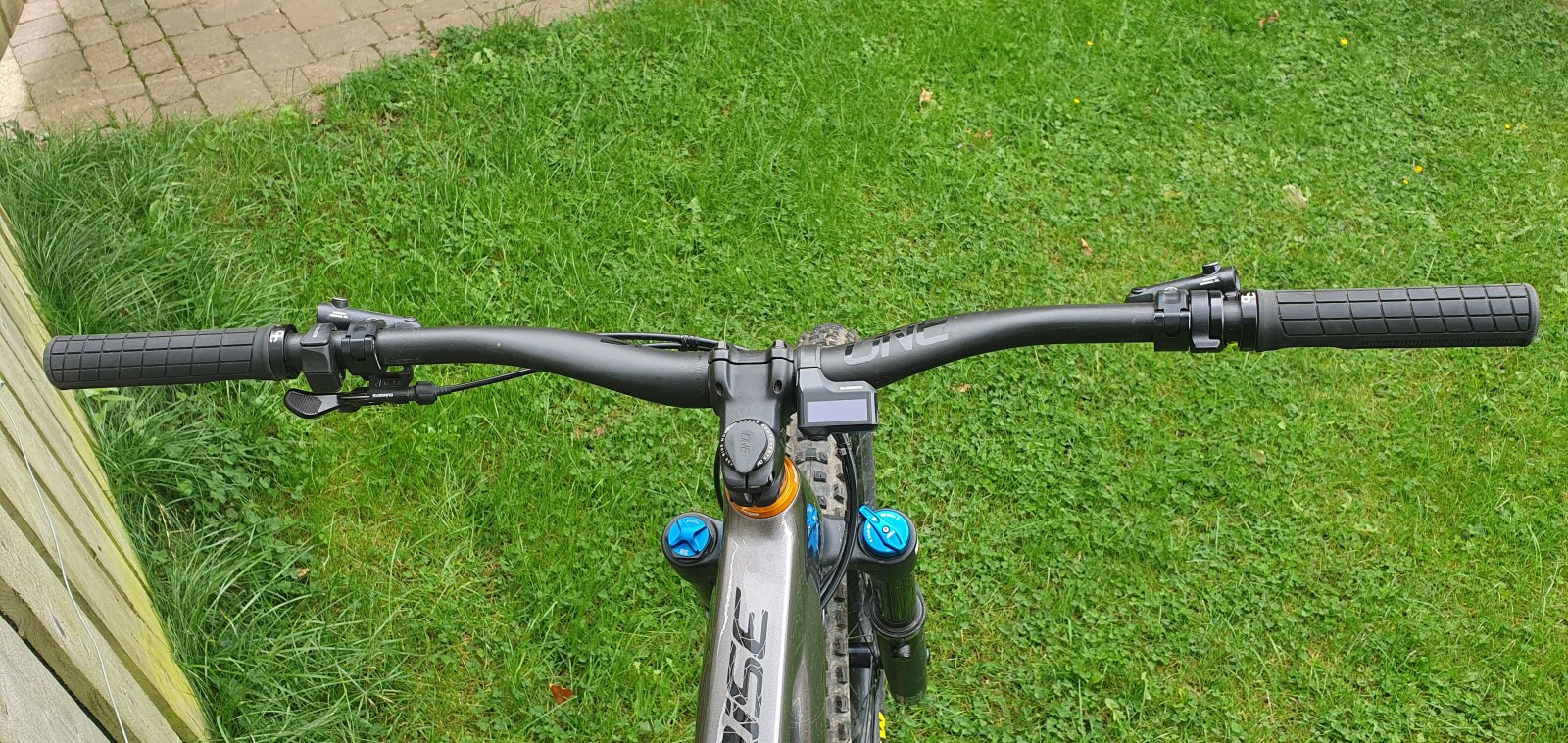

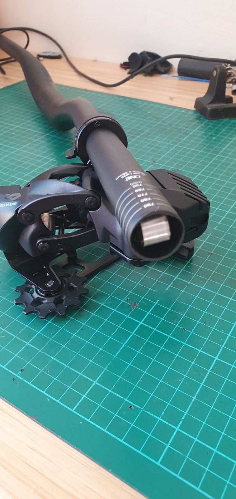

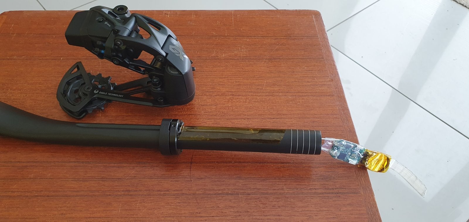

looks really good, where is the controller box thingy for the shifter?
I have been contemplating AXS shifter but the longer I have this bike the more I see the drivetrain as a consumable that will need regular replacement. I'm already on 2nd chain/derailleur. Maybe AXS will be less finicky where it comes to little knocks and hits that make shifting performance poor.
Ive got the WiFi sender shrink wrapped & slid inside the end of the bar. It's a bit finniky to fit 1st time but easy to get at now, as I'll eventually need to change the battery in a couple of years time.
The AXS conversion kit is very reasonably priced if you shop around. The derailleur also folds out of the way if it takes a hit. Not sure how much that would save it but it should help it survive. :unsure:
Nice work! love that clean cockpit. If you don't mind me asking which part did you pull apart for the wireless signal transmitter to be broken down to that size? Any further images?

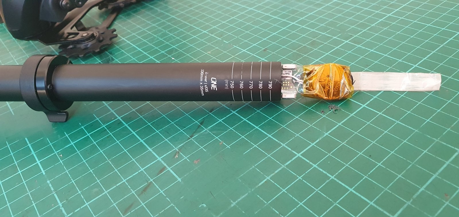

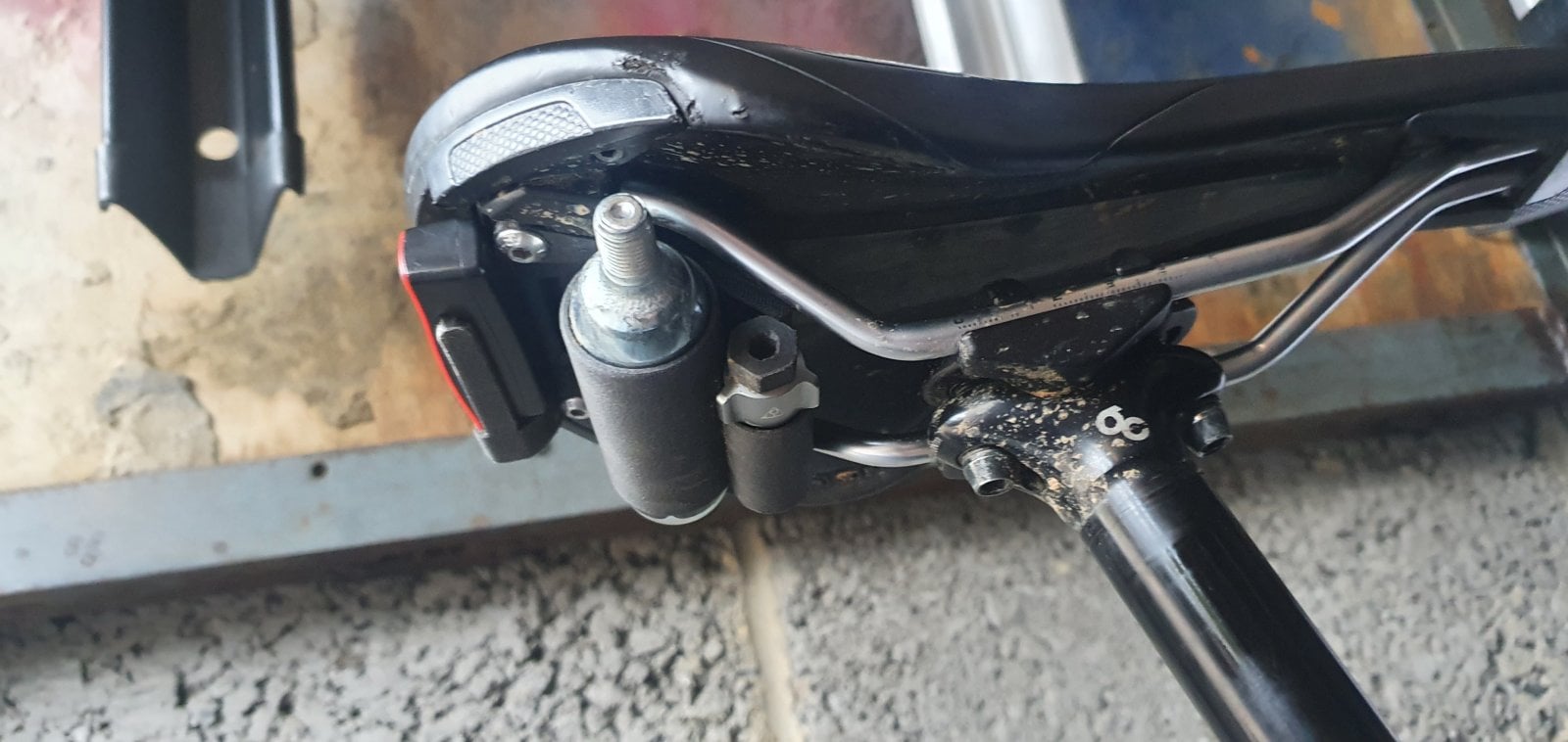

I screwed the board and battery holder from a standard AXS shifter to a strip of fibreglass board. The Zirbel link on the following page will give an idea of what's involved. Technical | BERG

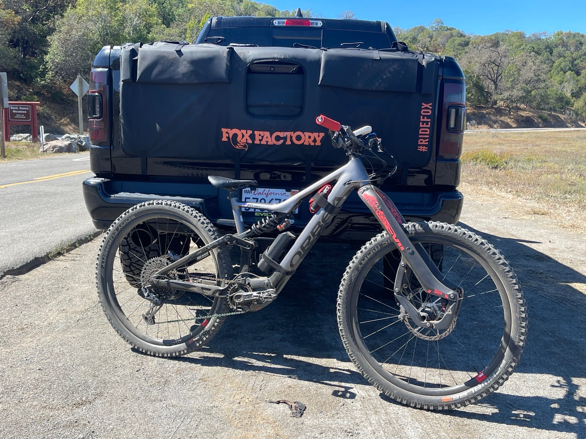

Here is my Rise in it's final form.....for now. I tried a 2022 Fox 38 Grip2. and a 2023 RS Zeb Ultimate before deciding that neither feels as good as my Trust Performance Linkage fork. 178mm travel up front, 160 rear w/a DHX2 216x63. The Rest of the specs in my Signature. The Trust linkage travel fork rolls through rocks so well that all other forks feel harsh to me. The action is similar to what High Pivots do to the rear suspension. I'll soon know that well as I'm building a Deviate Claymore soon. It'll have a High Pivot rear and a Trust out front.
Does the fork linkage give a linear compression? Same as a telescoping fork?
What's the effective head angle? The main part of the fork looks mega slack but I'm guessing the wheel travel is not parallel to the chunky bit (technical term, obvs)
Yes, and has tokens to change ramp up like telescopic forks do as well. Head angle is exactly the same, axle is behind the stanchion so slackness is an illusion. Travel path is a rearward arc
Is the DHX2 216x63 a direct fit, or do you have to put offset bushings?
Offset bushings are not required but I did test all 3 variations, 1 bushing/2bushings/no bushings and settled with 1 offset bushing as feeling was most balanced.
Offset bushings are not required but I did test all 3 variations, 1 bushing/2bushings/no bushings and settled with 1 offset bushing as feeling most balanced.

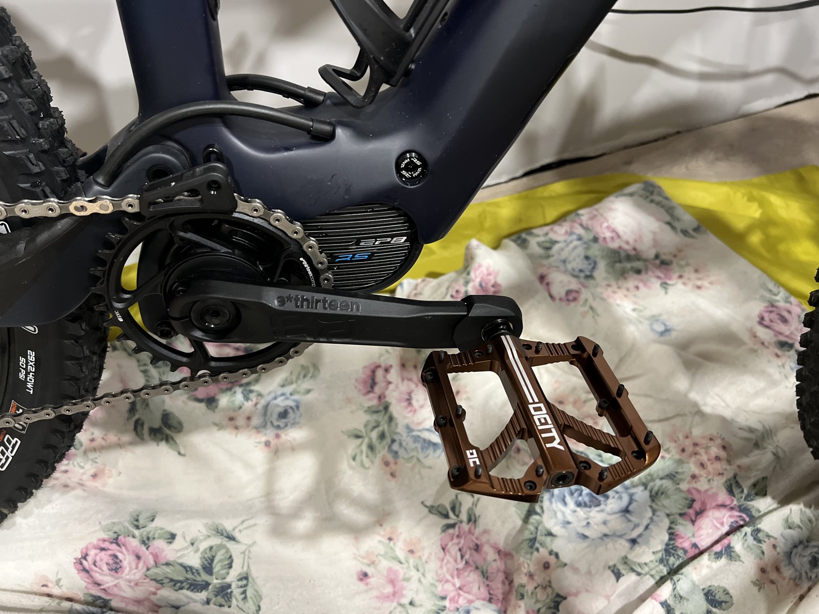

Upgrades from MyO M10:
- Deity grips, handlebar, stem, saddle, pedals
- 5DEV 160mm cranks
- BERD TR30 wheels with Assegai EXO+ front / DHRII EXO rear with Cushcore XC
- Offset bushing hardware on shock (front)
- 160mm air spring on Fox 36 Grip2

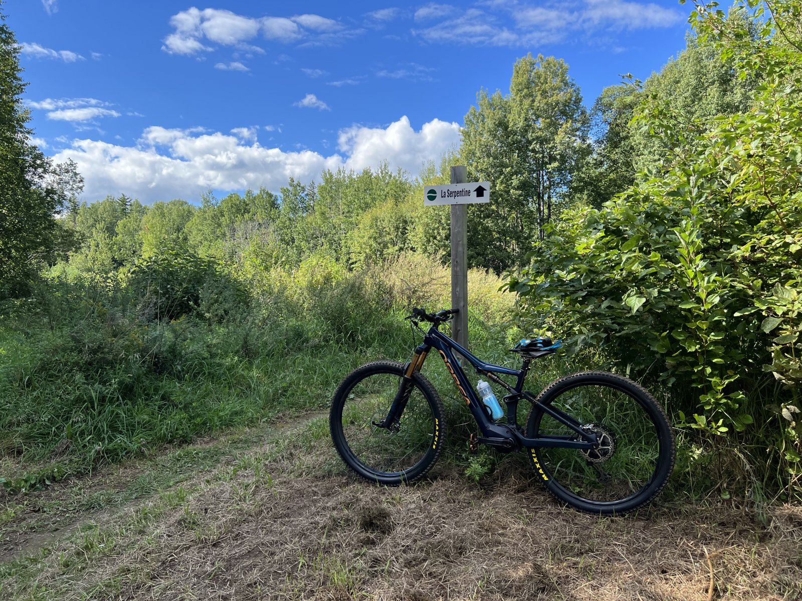

Popped in a 160mm airshaft in the fox 36 fork. They were starting to get noisy so I was keen to do a lower leg service, the airshaft side was bone dry! Also the lower headset bearing is cactus, so repacked it and ordering a replacement.
Quick ride with bike and liking the 10mm extra travel. Fork feels so much better and quiet with some oil in it! :)

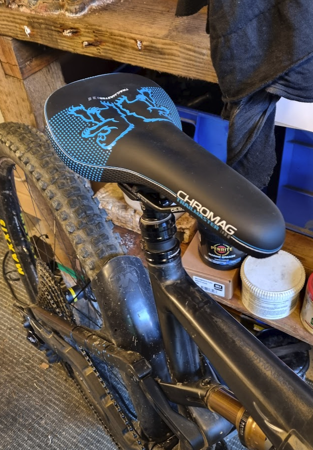

New saddle from chromag, big improvement on the previous saddle that was better then the OEM one :)
Having some issues with the dropper, getting a bit loose and alot of movement. Think I need to start looking at a new one. Any suggestions? I think this standard one is 150mm
