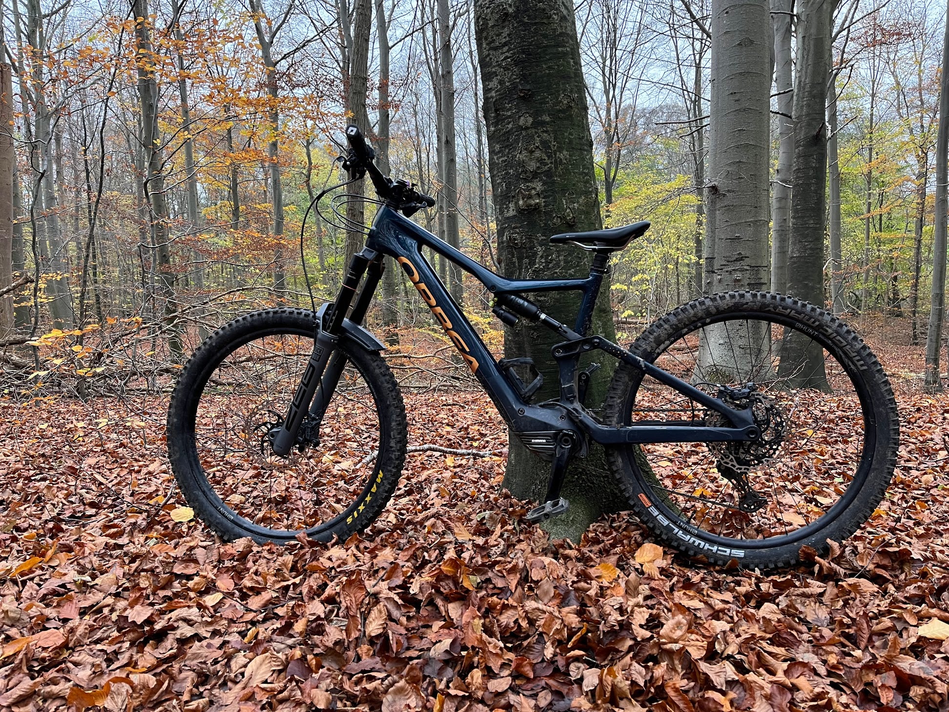

Hi guys,
Finally, i can say that i have the bike just as i want it, still thinking about upgrading to carbon wheels, but the turbines are giving a good service, so let see.
It´s a M10 with the following upgrades:
- Magura MT7 Pro with Hope 220/203 rotors
- Fork with Vorsprung luftkappe air piston, oem mudguard, kabolt axle and Slik Graphics custom decals.
- SRAM X01 AXS with wireless blipers
- Fox Transfer factory 175mm
- Raceface Turbine R stem
- Shimano FC-M8150 crancks
Feel free to ask if you want any opinion with the components
