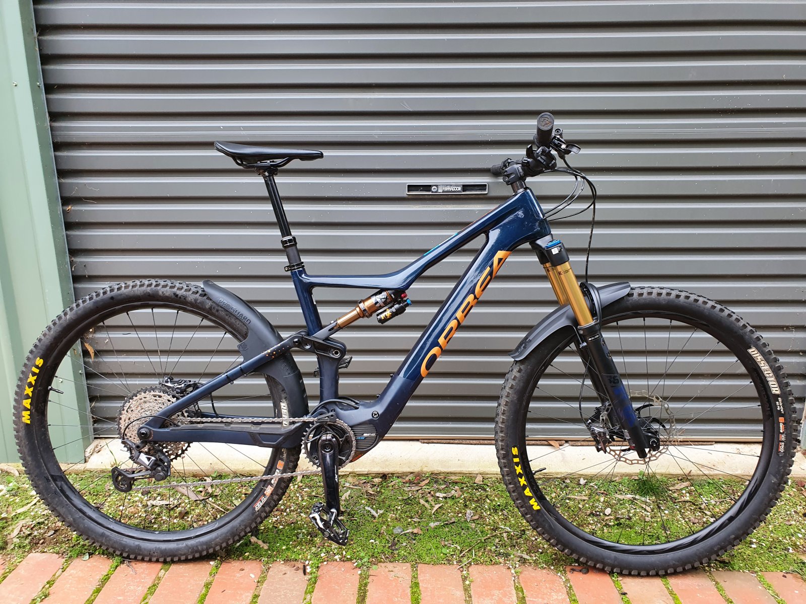

Finally got the little beast ready for winter.
Mods:
Cushcore pro rear and rimpact front.
HT supreme pedals
Shimano xt 160 cranks
Galfer 203 front rotor (used the galfer 180 to 200 adapter with washers but will change that to a proper 203 adapter)
Fox XL front mudguard
RRP rear guard
  • Tires: 2.4 Rekon rear, 2.6 Rekon Front. Also built up a second wheelset and purchased Forekasters for mud days
  • Range Extender - Ordered but canceling - won't need it
  • Front Brake Disc - Swapped out front for 203mm Shimano XT and rear for 180mm Shimano XT
  • Grips: Ergon GE1
  • Display : Added SC-EM800 display
  • Mode Switch : Updated to SW-EM800-L
  • Tubeless conversion : Done
  • Seatpost :I don't like droppers, so replaced it with a Next SL carbon post. Removed dropper lever/cable
  • Saddle : replaced with WTB Rocket V Team, medium width
  • Pedals : XTR PD-9120
  • Front Mudguard : Fox basic flexible mud guard initially. I've 3D printed a custom mudguard for the Fox 36 that I will be installing shortly
  • Other : Custom orange cable retainers

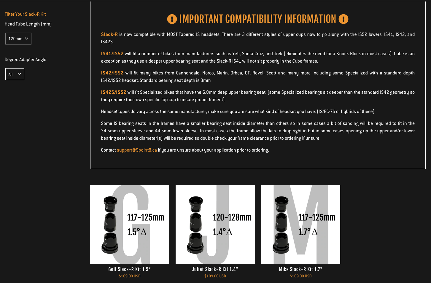

Please let us know how that works out. I have a Large Hydro so my HT length is 120mm so the lowest degree Slack-R angle headset I can get is the 1.4 degree.
The XL hydro has a 140mm HT length so the smallest available from Slack R is 1.3 Degrees (LIMA) - IS42.
The L hydro has a 120mm HT length so the smallest available from Slack R is 1.4 Degrees (JULIET) - IS42
The M hydro has a 105mm HT length so the smallest available from Slack R is 1.4 Degrees (BRAVO) - IS42
The S hydro has a 95mm HT length so the smallest available from Slack R is 1.5 Degrees (ALPHA) - IS42
What size rise you got and how did you get a 1.2 degree? 9point8 doesn't show one with 1.2 degrees for any of the hydro frames based on HT length.

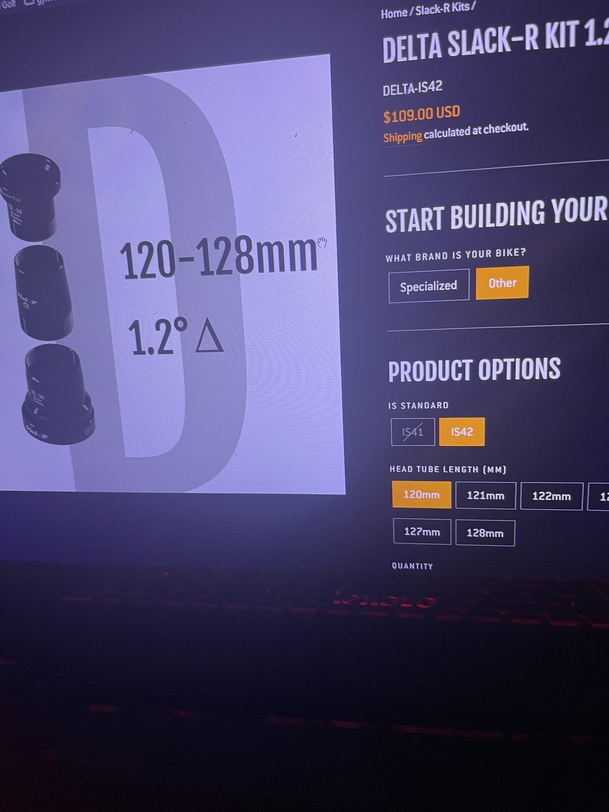

Interesting, maybe their website sucks (or decision table not updated to include the DELTA?)
If one puts in 120mm and selects 1.2 - nothing shows up. Only the Juliet (1.4), Golf (1.5) and the Mike (1.7) shows up. If you pick 120mm and 1.2 degrees explicitly, it says nothing found. Anyways, please post a full review once you get to ride it.
Looking forward to receiving mine as well, it should drop the HTA on mine from 66 -> 64.6 degrees and lengthen the wheel base slightly (by 18.1mm)

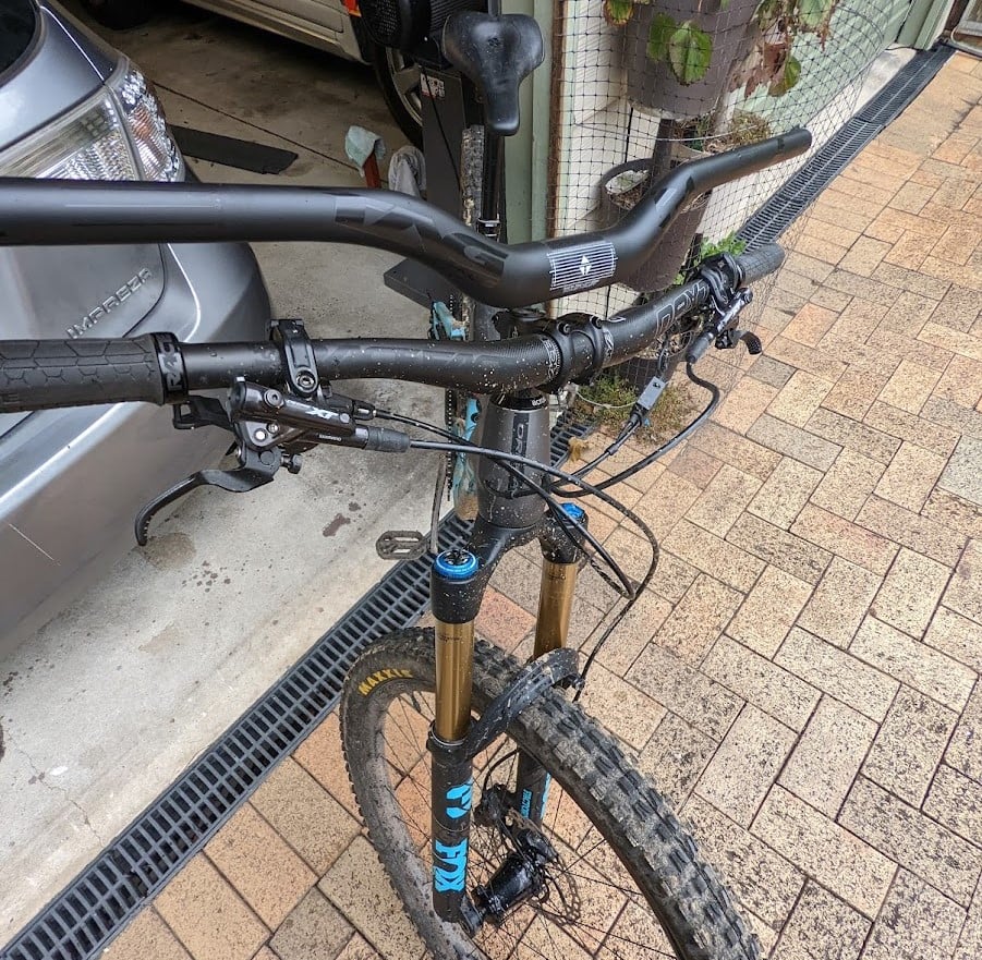

I just put a 40mm riser bar on my Rise M10.
Being a shorter guy 170cm (5'7") on a Medium frame I found the front end a little difficult to lift compared to my old bike and it has caught me out a few times. For example, say you are going off a small drop at lower speed and normally I would just kind of manual off the drop. Well with this bike I have had the front end come down too soon and ended up almost crashing several times. I don't know if its just the longer chainstay you get with a 29er or maybe its just a 29er thing, this is my first one. Anyway I hoped the riser bar would give me the extra reach I needed to get my weight further back in this situation and it has. Normally I prefer a lower front end for cornering but I haven't found the riser bar to be a problem here and it also feels really nice when dropping into steep technical sections of trail with the slightly higher front end.

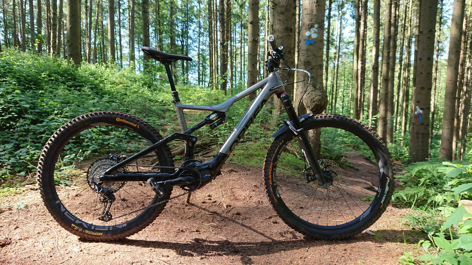

Hello guys,
due to various inspirations, also from this thread, here is a picture of my Rise H30, size L.
What I have changed so far or moved from the predecessor:
Stem/handlebar: Newmen Evolution
Grips: Ergon GE1 Evo Factory Slim handlebar grips frozen stealth
Pedals: OneUp Composite
Saddle: SqLab 60X Ergowave
Fork: Manitou Mezzer on 160mm w/ Manitou Mudguard
Shock: Manitou Mara Pro 216x63 mm w/ one offset bushing
Rims/tires:
Newmen Evolution w/ Continenal Krypototal FR/RE in 29/27.5, the Baron on the picture has been changed after that tour.
Brakes:
Shimano MT410 Hydraulic Disc, 180mm Front /180mm Rear Disc - Here I risked an experiment, due to the unavailability of an XT but also out of curiosity: levers remained, but calipers and discs were changed to Magura MT5 and/or Galfer 203mm w/ Galfer Advanced and E-Bike pads.
Frame: RideWrap
Crank arms: Shimano XT 165mm
What I'm thinking about:
Handlebars: For more tidiness in the cockpit - the cable routing for the display still irritates me.
Dropper: OneUp Dropper 180mm / 210 mm - With 180 cm height and 81 cm inseam I have a seat height of 23 cm (seat tube to centre of saddle rails) and I'm not sure yet if the 210 mm really fits because it would have to be completely slammed into the frame...
Rear Mudguar: Still looking for a good deal here.
Have a nice weekend 🤟
