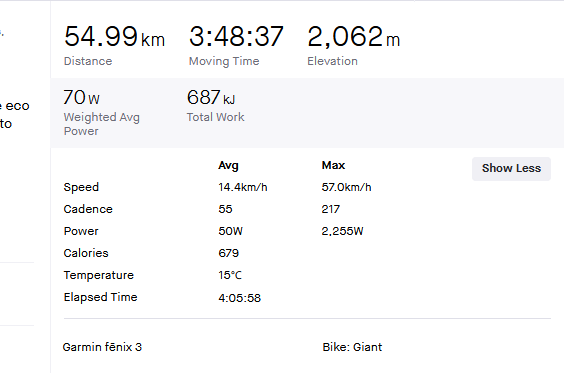

Here below are 2 similar rides, 1st with Power meter, 2nd without.
The results are very different but actual effort was the same.
With the Giant power meter connected I get very low Calorie/Power "weighted" readings
With the Giant power meter disconnected readings are "estimated"

I think Giant's power readings are ok, it's the way Garmin is reading that data...I was tinkering with some setups in the Garmin App, but till now no luck. ✌ Will dig deeper 🤟

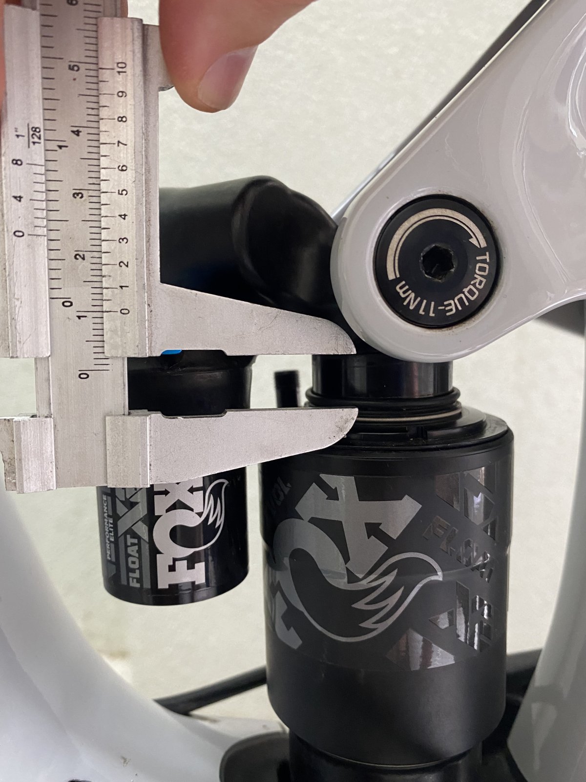

Is anyone struggling with the bottom bracket height? This is turning out to be a bit of an issue for me. My last bike an evil wrecking was 339mm in lowest setting , at 330 in the high setting the reign can be hard to manage. I’m ok on the cranks but fined I hit the motor on steep roll ins if I don’t float the back up…
may be related to how I’ve measured the sag? At full compression (no air) there is 10mm of shaft left over. I didn’t have hash bottom outs, but did noticed o-ring never went further than this…. Probably need to use this smaller measurement for sag = higher pressure.
can anyone confirm is they have seen similar shaft travel? I gotta warn you it’s a pain to pump the shock from zero pressure as the Linkage gets in the way of the valve.
Same here on the fox dps shock. I just set the sag and read your comment. The total shaft length ist about 71mm. I think the fox shocks are not supposed to compress all the way.
Not sure though if this has to do with the shock itself. Because the x2 shock is only available in one size for 205mm length. The travel can be lengthened and shortened internally from I think 57.5mm up to 65mm with a spacer in 2.5mm increments.
I would just calculate for 62.5mm and measure from there
"I think the fox shocks are not supposed to compress all the way."
You think ;)
Well 😂 then I think was the right expression 😂 on my forbidden dreadnought the x2 does not compress like that.
That's what happens when you do a forecast of reality based on a small sample. Now you have no other choice than to change your world view 180° after seeing just one more evidence. Science at it's finest :cool:.
I am perfectly fine with learning new stuff and reflecting my fails 😊 but as I said. I am not sure if this is maybe because of the possibility to change travel within the shock. I only know this can be done with trunnion mounted shocks. Not sure about regular mounting.
I can see with the dps shock that the shaft is almost 10mm longer than the 62.5mm that is written in the stats sheet.
Yeah thank you, that’s what I have done now.

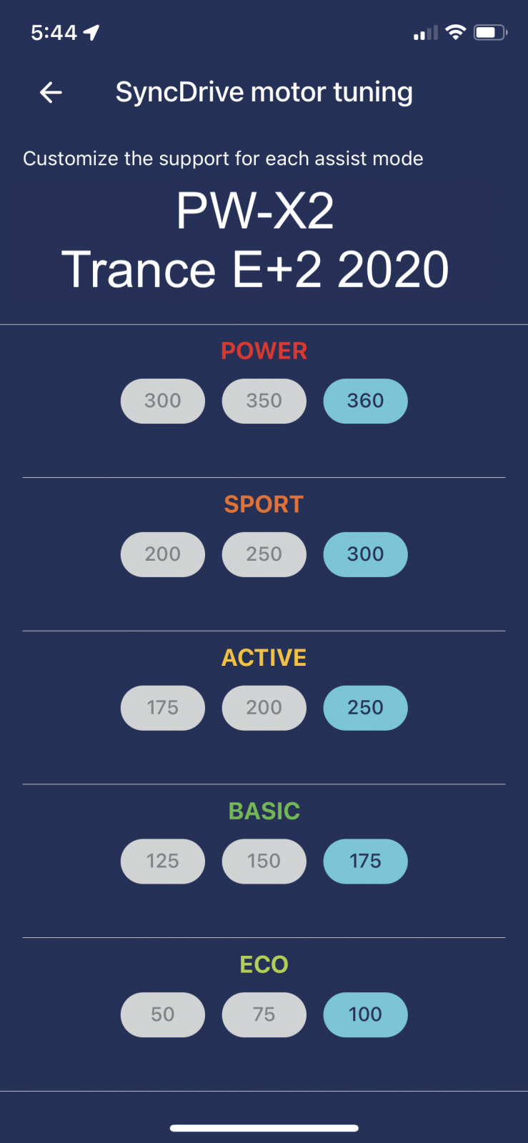

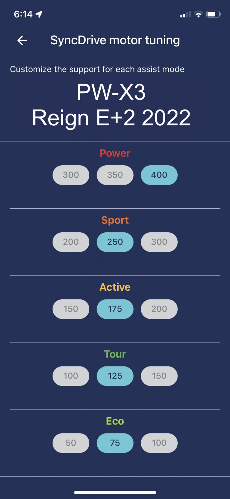

Reign E+ Motor Power.
I may have found why in some cases the the new PWX-3 motor doesn’t feel as powerful as the old PWX-2… Factory settings (pictures) are lower for the first 4 levels of power on the new motor 😳 Screenshots taken yesterday Trance 2020 (PW-X2) vs Reign 2022 (PW-X3).
