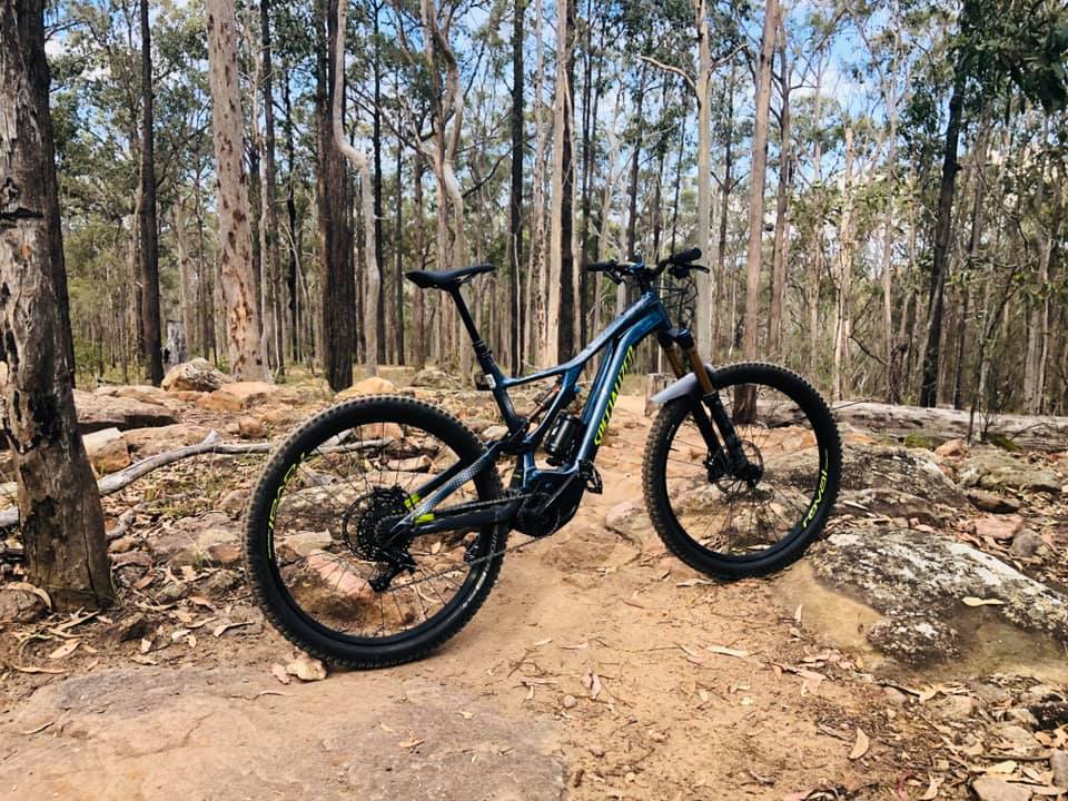

That is what I’m running
2019,
160 front
210 x 55 rear
