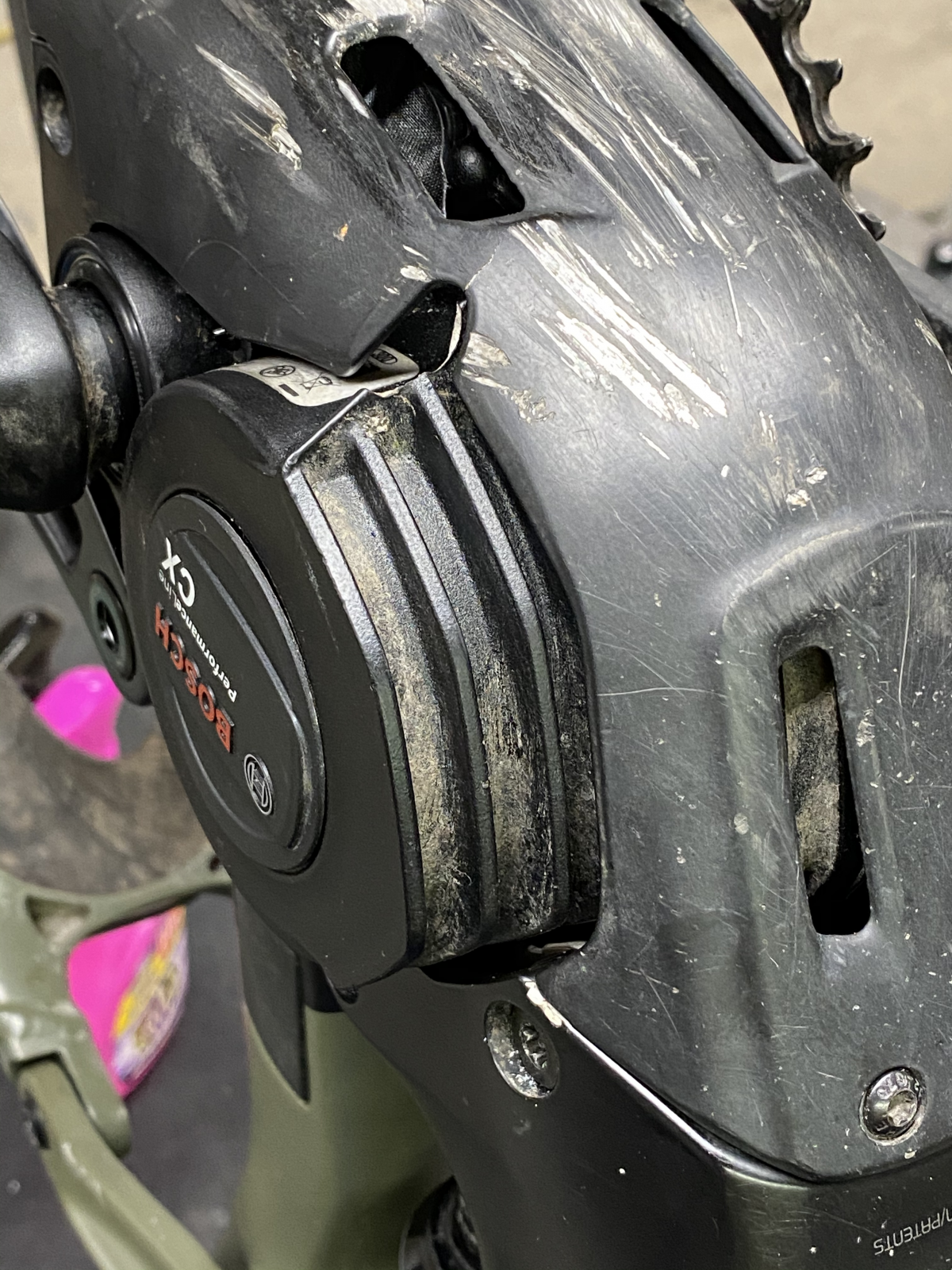

I’m not sure if I would want to have smaller vent holes. I’d be worried about cooling but if the bash-guard area is jammed with debris …then there’s no cooling. Keeping the temperature down seems to be important on the Bosch gen4 but is very important or difficult on other motors (Brose).

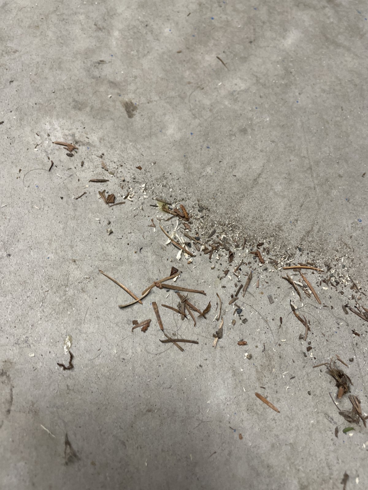

I suppose your ground debris is different than mine. I have to contend with rocks , loam and coniferous needles. The latter seems to find its way into everything and eventually builds up in the motor area during a ride. Mud? Sometimes but nothing too worry about.
After every ride I must rinse the motor area with water. Sometimes I wish the vent holes were larger, especially towards the rear of the bash guard so the crap/debris could exit. If it can get in there, I want it to get out of there. The design of the bash guard nicely traps stuff around the motor then prevents proper cooling.
Here’s another method I use for cleanup.
……and here’s the culprit. They don’t look like much, but if you multiply them by a thousand, they will pack into the motor area and hold water or stop any cooling. But these won’t stop a wheel from turning like that gross clayey-mudd you might have. I could use that stuff to glue handles back onto coffee cups. Yuk.
I would like a carbon bashguard if it had enough rigidity, vented properly and allowed debris to exit easier. Maybe a specific type of guard for our specific type of debris. But I want to protect the motor. Especially the cooling fins.

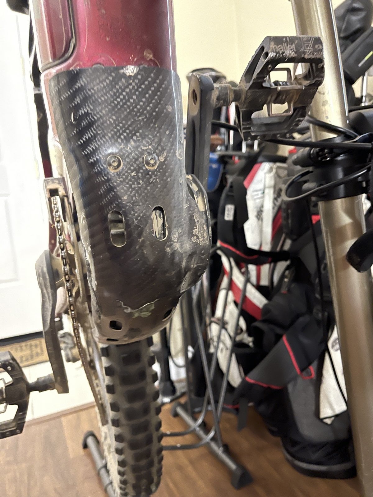

Yeah, this was for me no go.
My first guard:
Yeah looks typical. I got a few of those. Definitely a weak-spot there. A ridged carbon might have some better protection but those mounting screws aren’t enough. One of my screws was stripped. Maybe some clip-in method on the side of the bash guard along with the screws could lessen my anxiety of a carbon bash guard.

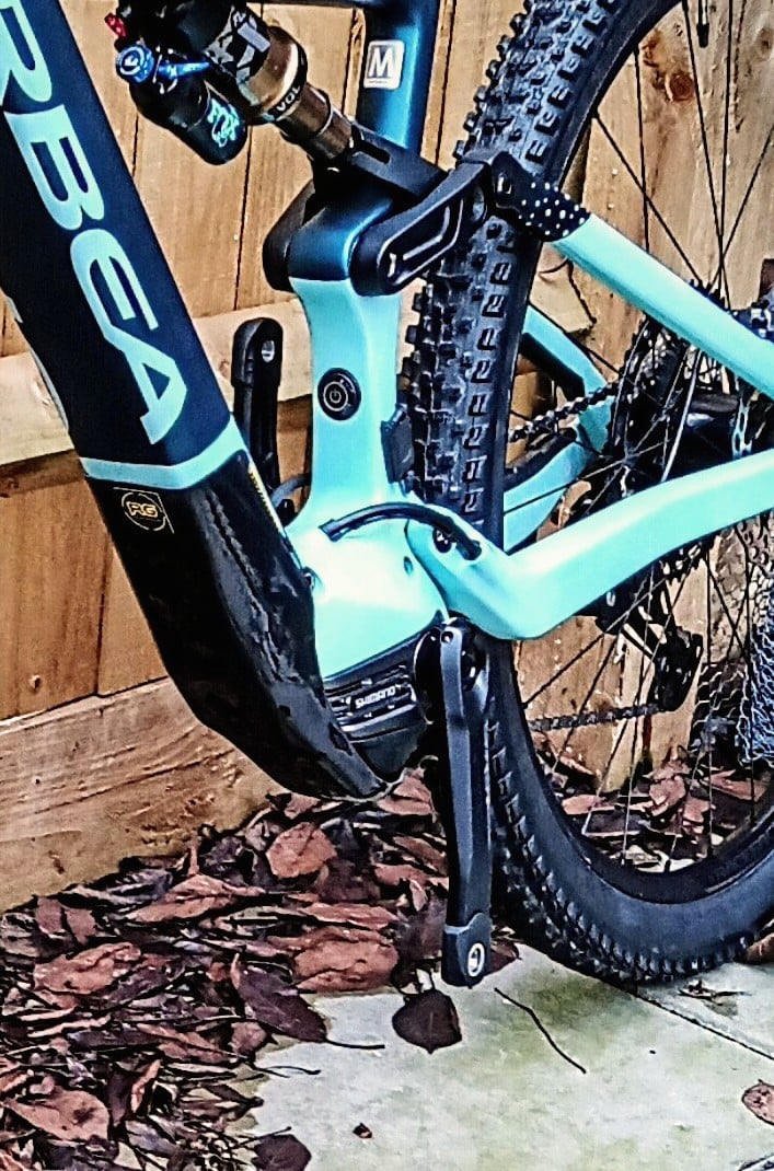

I’m awaiting the call from my lbs to confirm my 250 mile/3 month old motor has been replaced. It’s been a wet few months since I started riding the bike. I haven’t over cleaned the thing. It’s just water ingress from riding off piste during some shocking weather. I don’t believe closing those vent holes would cause any problem for U.K. winter riding. In fact my mates Orbea doesn’t have anything like the amount of motor on show as the rail. I think as the rockguardz offers little benefit I’ll buy one of the metal skid plates (forget the companies name) as that has much smaller vent holes from what I have seen

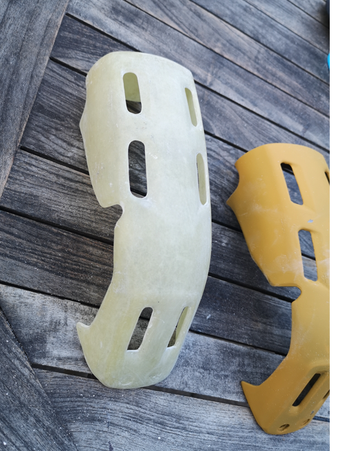

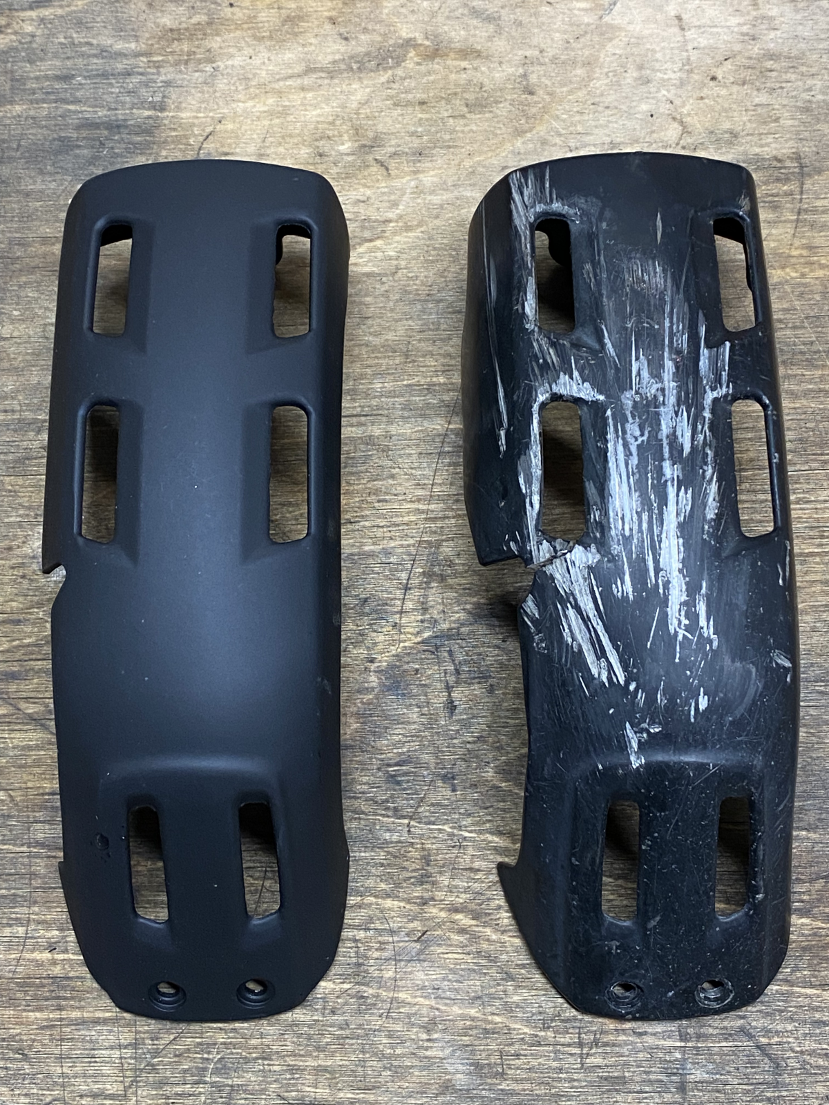

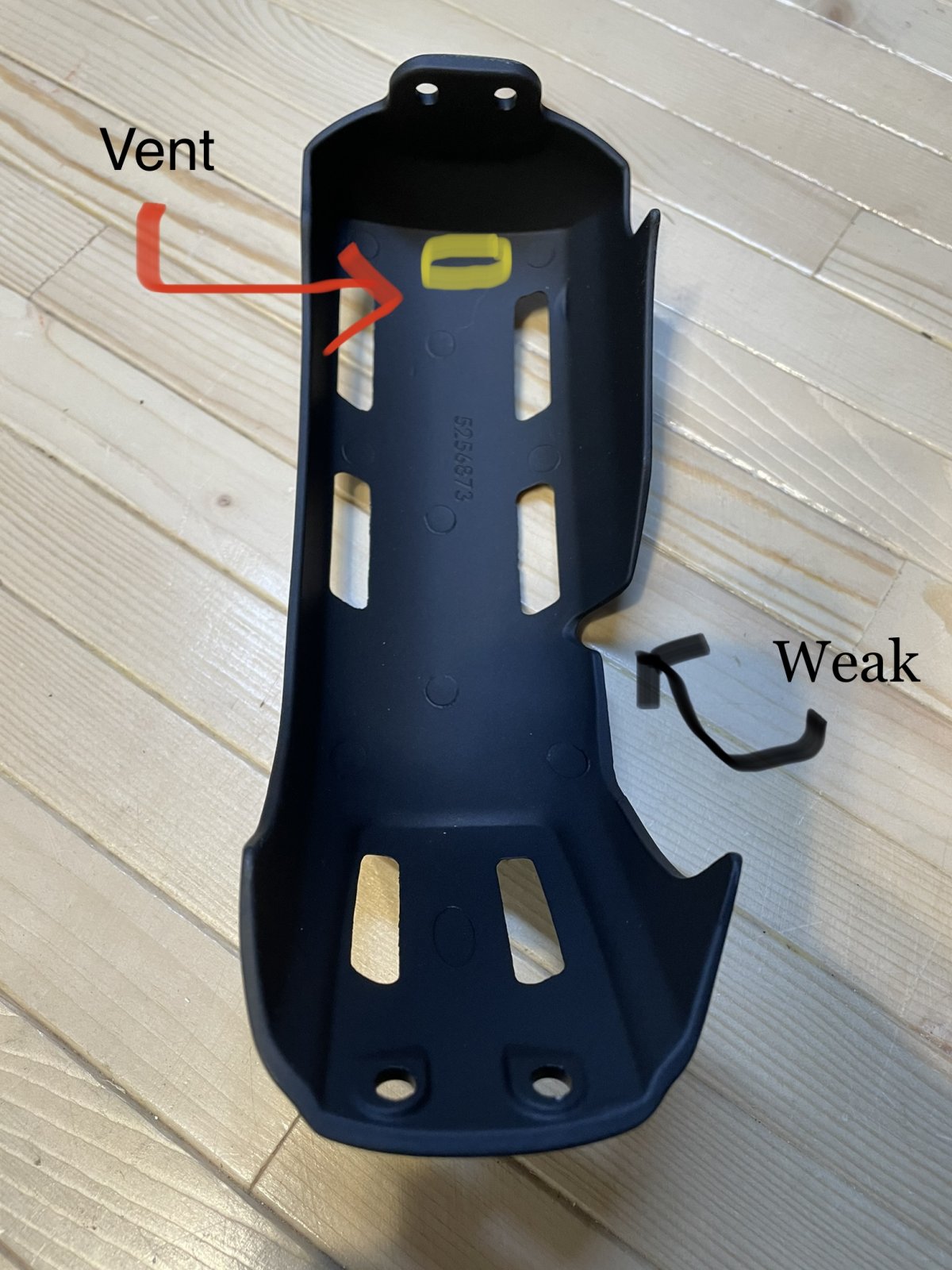

So here’s my spare aluminum bash guard.
There’s a weak notch in the guard which makes room for a cooling fin in the motor. Most of the failures begin here and radiate to the centre. Not too much you can do about this unless the cooling fin is snapped off.
I might try a drain hole(or another vent hole) in the yellowish area. I’m more worried about water getting out during rides or after ride washing. Could let some debris out too. If I cut it properly it might not affect the structural integrity. I hope.

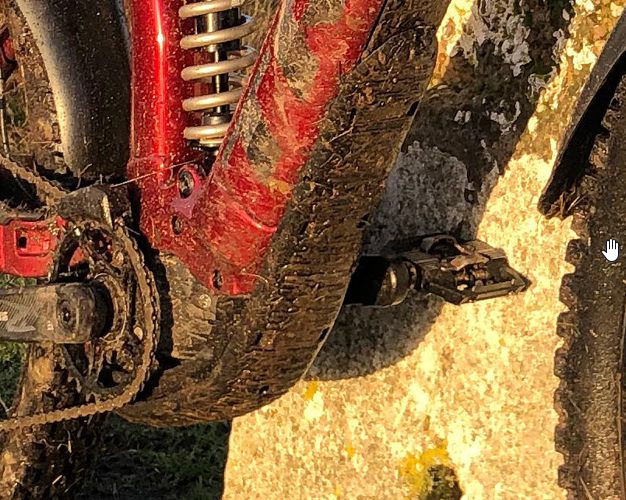

Sorry if this isn't relevant but I have been using one of these for a few months and seem pretty good.
It has some ali strips inside that you can bend and shape to the frame.
I think its saved my frame from a little bit of hammer.

…It has some ali strips inside that you can bend and shape to the frame.
So if I see this right, the adhesive strips attach to your frame, then the protective piece snaps onto those??
Btw, I have a similar rear fender which extends to protect the pivot. My small front fender would Jam up with snow. I removed it.
IanCran76
Apr 11, 2022
41
104
Derbyshire
Yeah kind of, those ali strips stick to the frame and then the procetive part velcros onto those.
I've been riding it through the UK winter slop and it doesn't get too clogged up.
