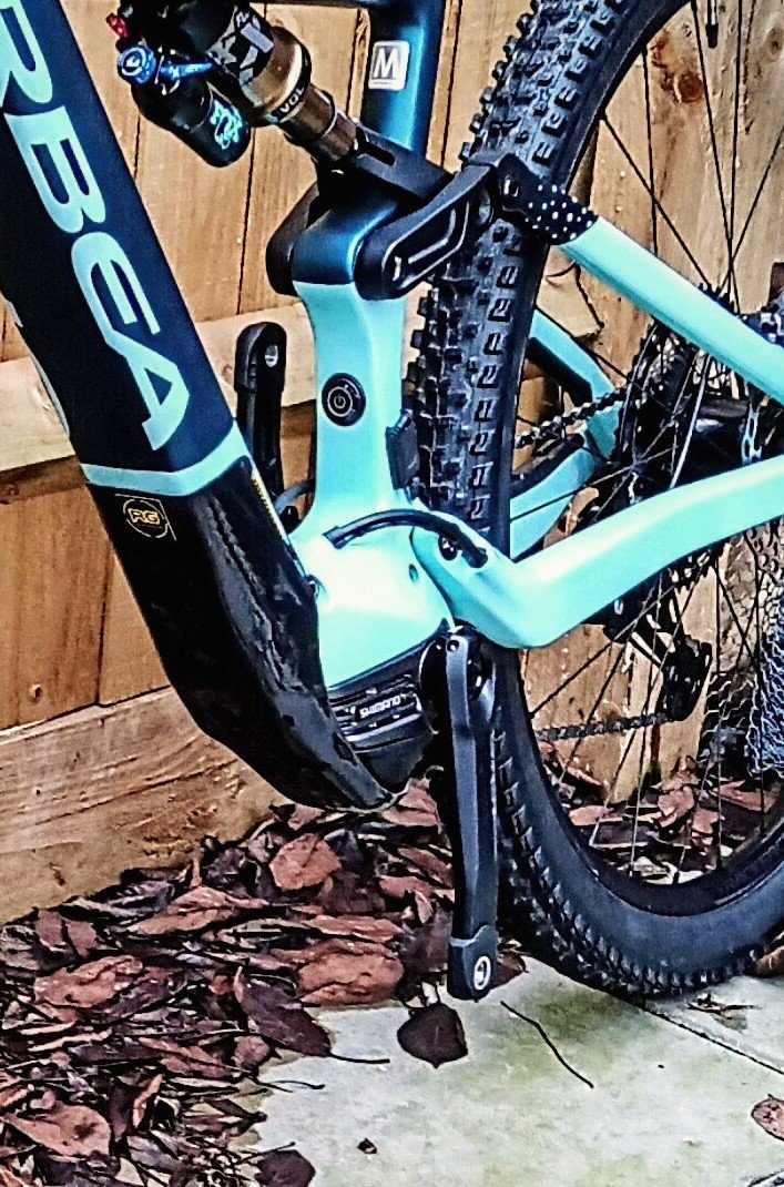

Sorry if this isn't relevant but I have been using one of these for a few months and seem pretty good.
It has some ali strips inside that you can bend and shape to the frame.
I think its saved my frame from a little bit of hammer.
Cheers,
Ian.

…It has some ali strips inside that you can bend and shape to the frame.
So if I see this right, the adhesive strips attach to your frame, then the protective piece snaps onto those??
Btw, I have a similar rear fender which extends to protect the pivot. My small front fender would Jam up with snow. I removed it.
IanCran76
Apr 11, 2022
41
104
Derbyshire
Yeah kind of, those ali strips stick to the frame and then the procetive part velcros onto those.
I've been riding it through the UK winter slop and it doesn't get too clogged up.
