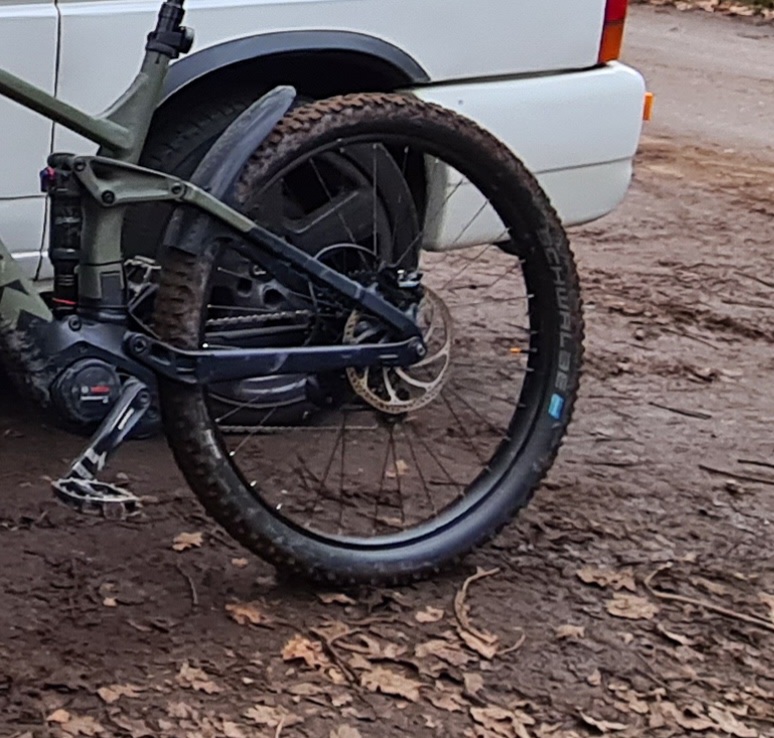

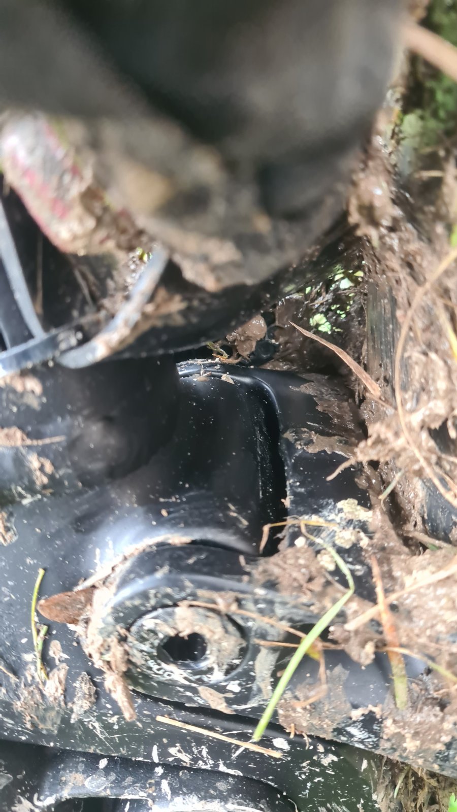

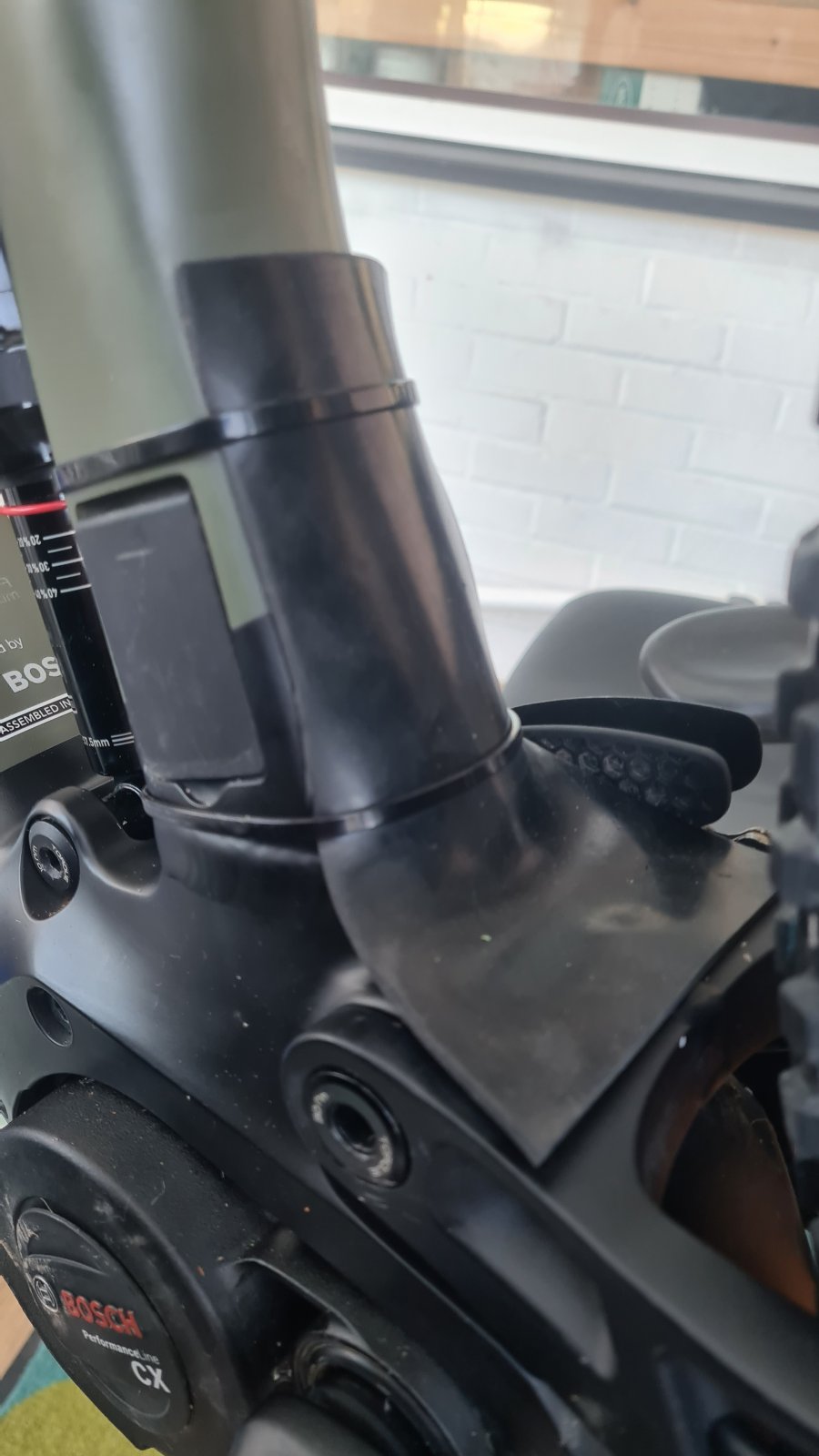

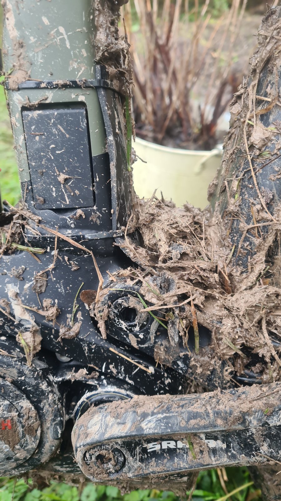

I use mud hugger shorty on front and mud hugger standard on rear inverted and cut back. I then have designed and produced a pivot protection flap which stops debris getting caught up in pivot link area on muddy and dusty runs... see pics - availablenon ebay £7.50... Trek rail pivot protection flap

Protect the rear pivot link area. Whether you use a rear mud guard or a small home-made flap thingy, keep the rocks, sticks or mud debris out of this area.
