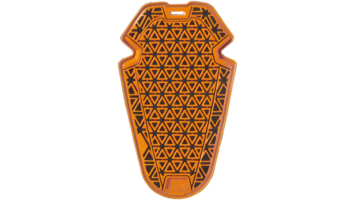

The Demon v3 SAS-tech option comes with SAS-tech chest protection & d3o back, shoulder & elbow/arm. They can all be removed, upgraded, replaced etc. It's the most protective thing I've found. When I feel max protection is necessary, I wear it under a large shirt. With it on, I've been asked how I managed to bulk up so much just riding to the pub & back. The pub is actually on the way to the gym.
Nice could I trouble you for the parts I can order to upgrade as the vendors seem clueless, I’ve even aske Demon but nothing back. I’m aware they seem to be T5 on the pade but would be nice to know if youve already sorted it cheers

I just selected the Demon SAS-tec option & I already had a back plate.

The new SAS-TEK triple flex limb armour looks quite impressive on paper :
The elbow is a good size and only 9mm thick for CE2 and only 65g ! Would be a good swapout for the Forcefield elbow maybe ? or and upgrade for the D3O in the Racer Motion Top 2.

I've never seen these guys before :
Quite impressive ! 7mm thick for CE2. VERY breathable and flexible.
EDIT : looks like the A-XOC armour is actually manufactured by SAS-TEC, hence the similar specifications - though different design.
