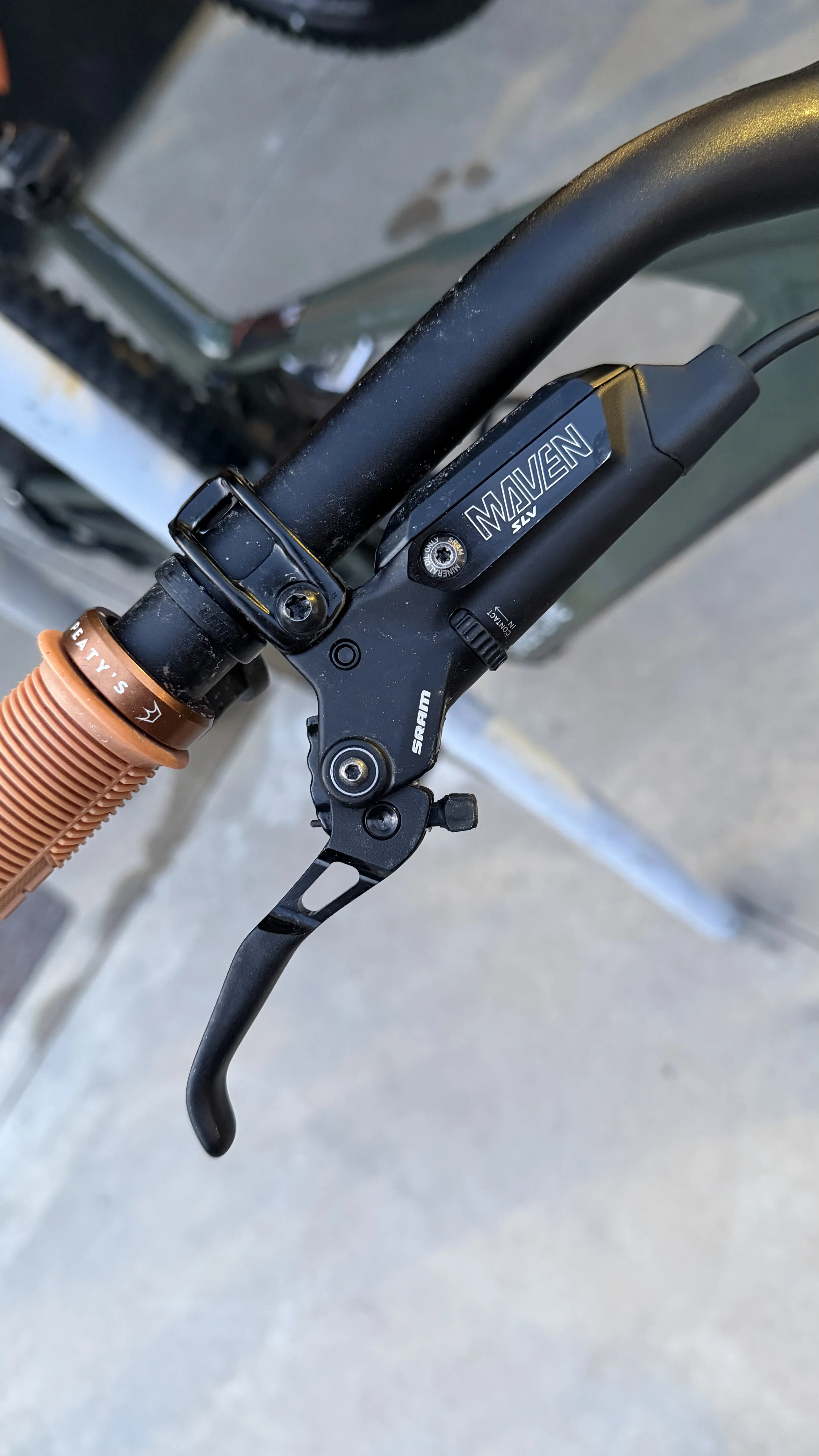

Hey @Rob Rides EMTB were these the b1 mavens? Or have you had a chance to try the b1s yet and have an opinion on them vs the OG mavens?
I have the new B1 mavens. Reduced effort needed to pull, maybe less power than the OG mavens, due to moving down to 4 x 18mm pistons from 2 x 19.5 & 2 x 18mm on the originals.
Decent brakes for sure. Helped in finale Ligure trails, Little Champery, Pino Morto & Men’s DH today 👍

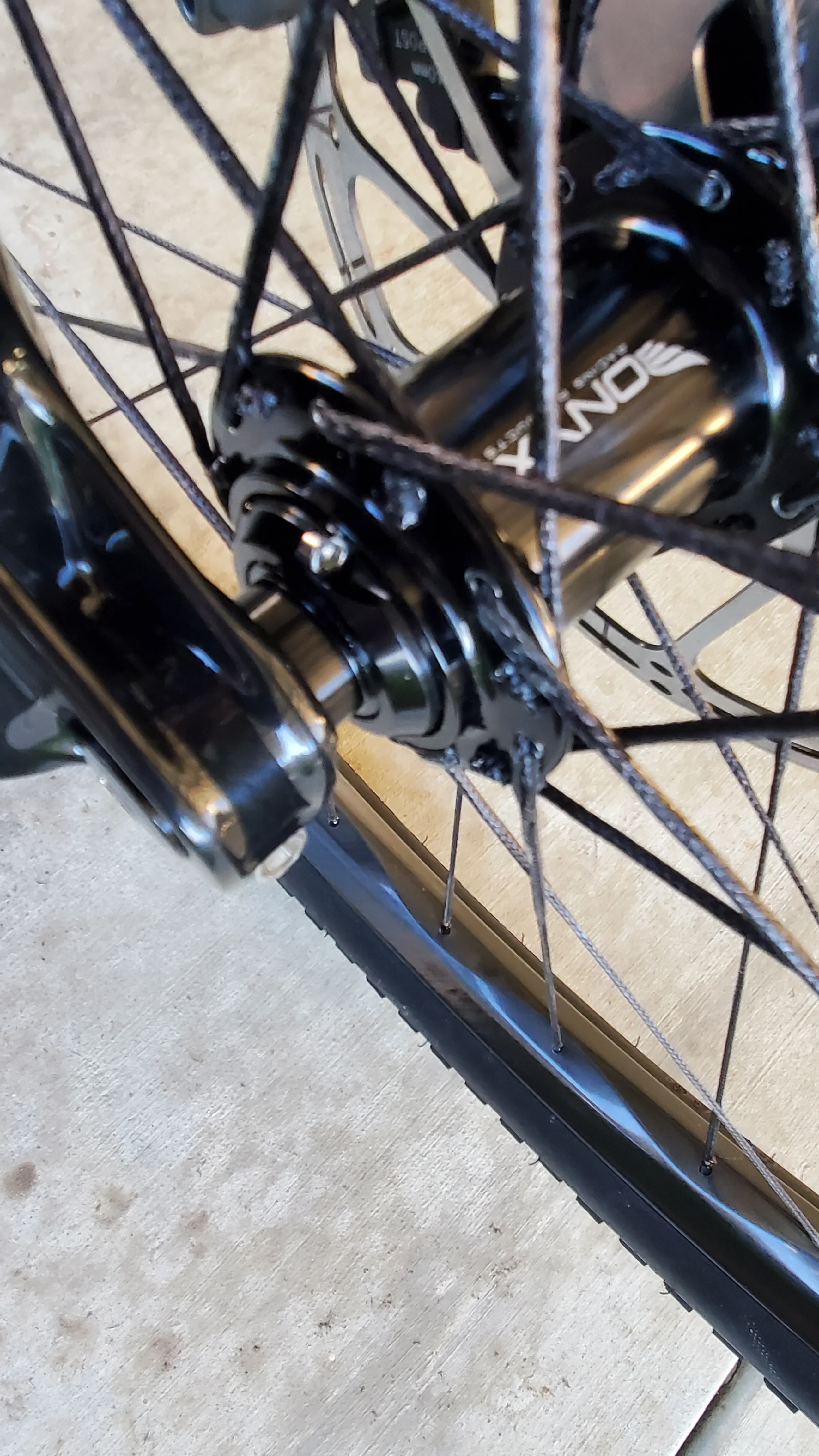

Far more of wheel compliance is based on the rim than the spokes. I'd even put spoke tension above spoke material. My understanding with Berd is their benefits are more vibration dampening and lighter weight compared to double butted.
I've bought 3 sets of Berd spokes and they are amazing on my ex-wife's bike, as she is a novice and weighs 110#s and the bike is a 27.5" anyways. I actually stuck her previous Knight CF rear wheel on to my own bike to test mullet and it was an unbelievably harsh wheel, and I'm much heavier and faster than she is.
The Berds are also really awesome on my weight weenie trail bike, a 28# Smuggler (I weigh 180#s btw).
But when I blew up my rear DH rim on my e-bike I put in service some old Berd wheels I had on to my Relay, and honestly, I don't love them. It's not a big deal most of the time but they struggle to hold a line when truly pinned. They just move too much. Like if you are going 15+ mph through a fast turn, it feels like the wheel is flexing and moving under you and causes me to slow down.
Now I will tell you that these are older, well used, and the spokes almost certainly need to be retensioned. But the rims they were built on are in fact heavy duty and appropriate for the application.
I once sent a Berd wheel in for relacing when I killed a hub, in fact it's the rear wheel that's on my Relay currently, and Charlie and the guys at Berd said it was the most stretched and frayed Berds they had ever come across. At the time I was riding a lot and aggressively and these were on my '21 SJEvo. They were excited to see them and then they warrantied them at no cost (amazing service from those guys). The ride feel is amazing, but I don't know that you notice that really on a 50# e-bike with DH tires. I mean, I don't even like the compliance of a radial tire in this application, too squishy. Berds are super reliable btw, more reliable than steel spokes ime.
I still believe in the product and might order their new super light wheel set for my gf's XC bike. But once again, she weighs 105#s and is a novice. Perfect for her.
So, I am a big fan of the Berd product, and I also know that they have a new thicker spoke as well, but for me I went back to normal spokes for next e-bike wheel build.
IMO, the 2 best wheelsets made when you are not super weight sensitive so ideal for an e-bike are the Enve M7/ 9s & the Crankbrothers Synthesis DH rims (which I have bought). These are wheels that are known to provide a particularly consistent ride feel when ridden at a high pace on a heavy bike.
Also, I wouldn't touch Onyx hubs. The front hub has a poor interface and leads to excessive front-end flex and definitely rules out any USD fork. The rear is unreliable, heavy, and just increases pedal kickpack. Just no.
Sorry, I'm not trying to rain on anyone's parade but just providing my own experiences. If you are a lot lighter, have new product, ride differently than I, re-tension your spokes more often, your experience will be wildly different.

I've got an onyx hub and Berd spokes mated to Reserve Rims on my Ripmo.
The vibration damping CAN NOT BE UNDERSTATED. Its the quietest smoothest ridding wheel I've ever experienced. The spoke juju is real. I'll never ride another wheel as far as I'm concerned.
