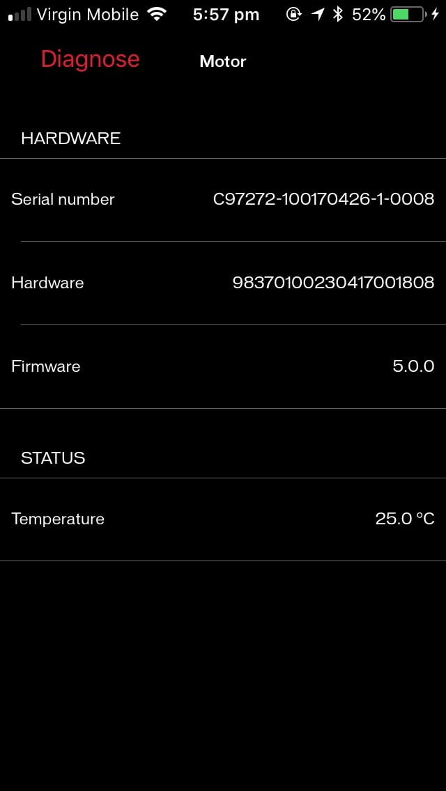

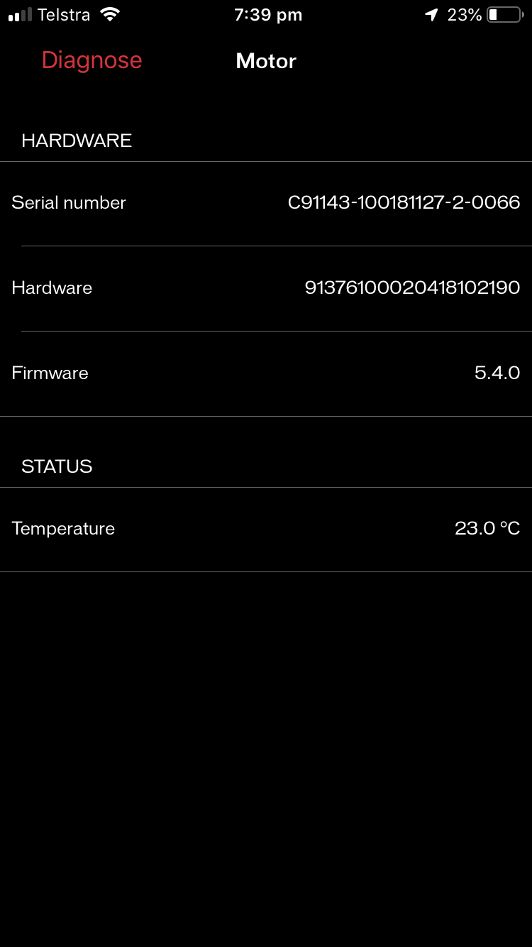

I believe I may of had my 1.3 motor replaced with a 1.2e motor under warranty. I noticed a difference in power After the swap. Thoughts?
Here is the screen shot of my old motor serial number vs the new one below it.
This is what I thought. Hopefully @Specialized Rider Care can shed some light on this.

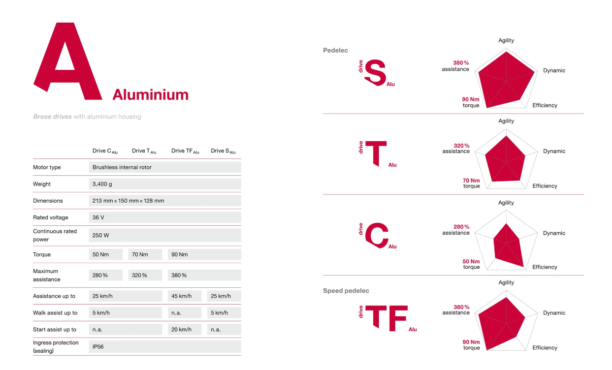

Hi @outerlimits - C91143 is a 1.2 (Drive T) motor which is more powerful than the 1.2e but less powerful than the 1.3 (Drive S) I'm afraid (A 1.2e motor serial number will begin with E22243). Sorry to hear - suggest you speak to your retailer to see what happened here, it is almost certainly an administrative error.
See below for more insight (taken from the Brose website)
Thanks heaps

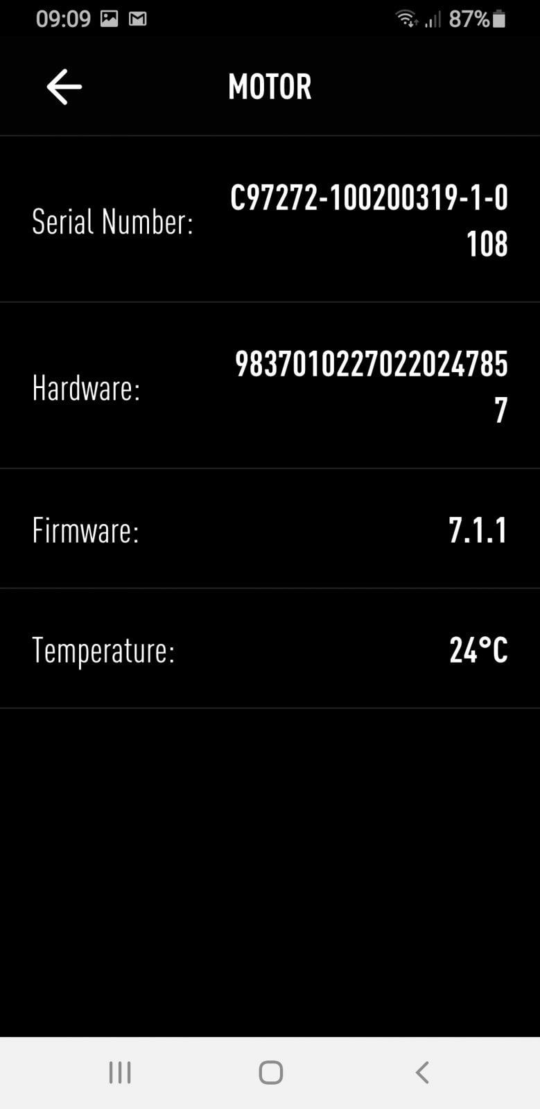

Hi, just got my 2nd motor replacement (3 motors now in total) for my 2018 Kenevo last week. As I was out of warranty, I got a new 1.3 motor for less money from Specialized.
The new motor (C97272) has firmware 7.1.1, the motor before (also C97272) had 5.0.0.
Rode it the last 3 days on very well known climbs on Turbo 100/100 and the bike feels massively underpowered. It uses around 20-30% less battery but, also lost top power and it's punchy behaviour.
As the motor came brand new from Spesh to my local bike shop, I wonder what might be the problem here?
My 2 batteries have A.17.1 and 2.17.1 firmware.
Already contacted my dealer but he hasn't heard of such a problem yet.
@Specialized Rider Care maybe you can give me and my dealer some hints what is going wrong here?
PS: Put in a spare 1.2 motor 1 week ago while waiting for the 1.3 replacement and it felt much better than the new replacement (not as good as my old 5.0.0 1.3 though)
Any hints from anyone? Will check max current today and give feedback
Update:
Pedalled as hard as I could for 50m uphill and did get up to a max of 17.8A current. Tried with both batteries, exactly same result.
Update 2:
just returned from the shop. Updated the motor with the same version, 2 batteries were not upgraded ( up to date) and went straight on the parking lot to give it a test with jammed on brakes. Got over 20.4A so it worked!
Cheers everyone and especially @Specialized Rider Care for the great and fast help. I think I got my old Kenevo back!

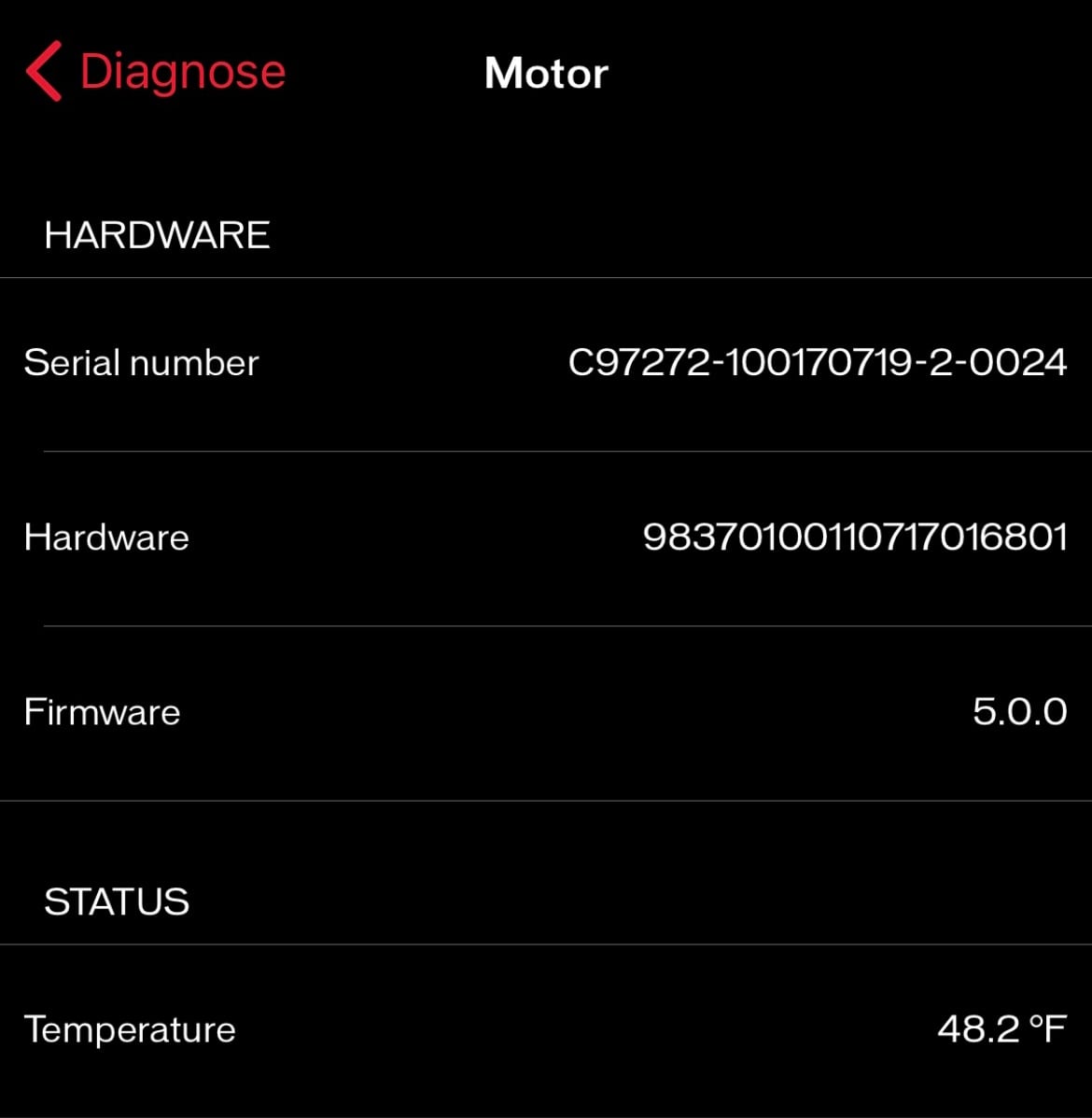

Hi all. Sorry to bump this old thread.
My 2018 Levo Carbon Expert has the 5.0.0 firmware and can only pull ~15A (on the Mission Control App) and ~566W (on the Blevo app).
Tried to have the dealer update it and it won’t update to anything newer than 5.0.0. Won’t show or load 7.1.1 or 5.0.4 even. They had the “force motor update” checked as well, but still no love.
I double checked and it does have the C97272 motor (1.3 Drive S).
@Specialized Rider Care any tips that I could pass onto the dealer to try? Are the newer firmware revisions still available somehow?
