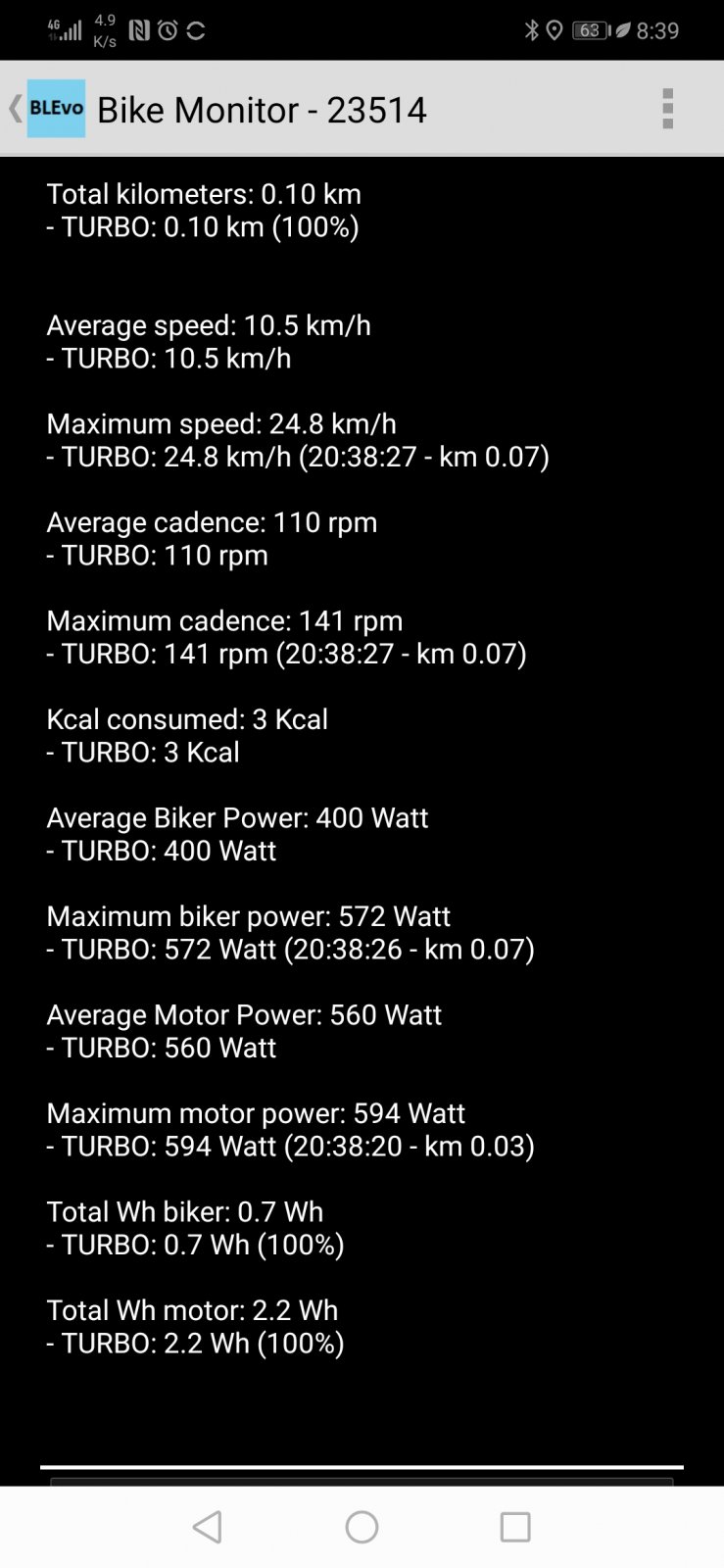

Well the Levo HT is back. LBS had problems flashing the motor firmware so they called specialized and after a couple of days managed to force the firmware to the bike.
Feels much the same as before. Maybe a smidge better. But blevo shows 594w max output. Still happy with that on my "poverty" model.
