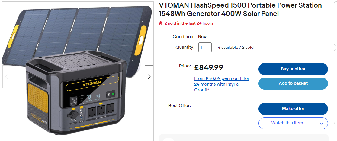

Trigger pulled. Cracking deal that appears to be ebay specific with £75 off. TAKE20 code. 20% max £75 off.
I got the bundle with the 400w panel for £775 all in.
The 400w panel alone is £450. There is a deal that appears invalid, that being the flashman with a 220w panel. This is described as the non-pro panel at 19v which wouldnt work with the flashman. Ive contacted them to confirm.
Unit on its own would be £564.
Arrived today. The panels are frikkin massive and heavy! I think any hope of draping them over my van roof has gone out the window.

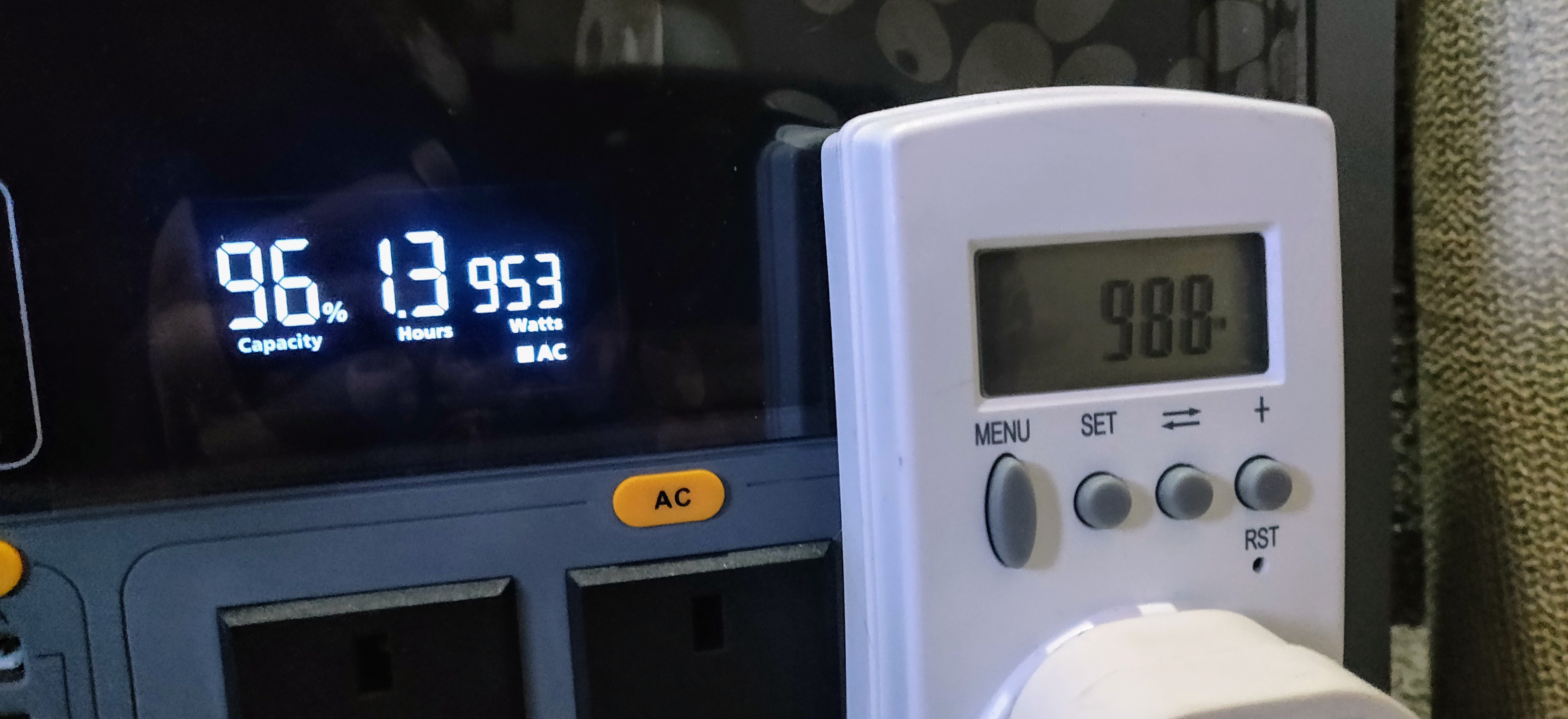

Have you done a load capacity test yet with one of them plugin mains watt meters?
I expected to get around 1200wh useable from the rated 1548wh.
It's only done 800wh before switching off, so about 50% down.
I'm repeating the test tomorrow then will be getting hold of them.
I've put the meter on the input socket for charging tonight so will see how many wh have gone into it.

Interesting results so far.
Charging the unit from flat took 1.75kw.
Running a 1kw heater.
Ran for 76mins and supplied 1.33kw before going flat.
The previous test was running the TV for 13 hours which used drew 60 -100w and ran out after supplying .8kw.
So I guess they are super inefficient at low power draw over a long time period.
I think my secondary use of running the TV will have to be shelved as it costs pretty much the same whether I run it from the mains or the vtoman.
Plus I'm wearing the batteries out quicker by charging them each day.
1.75kw @ 15p/kw nighttime rate = 26p
.8kw @ 35p/kw daytime rate = 28p

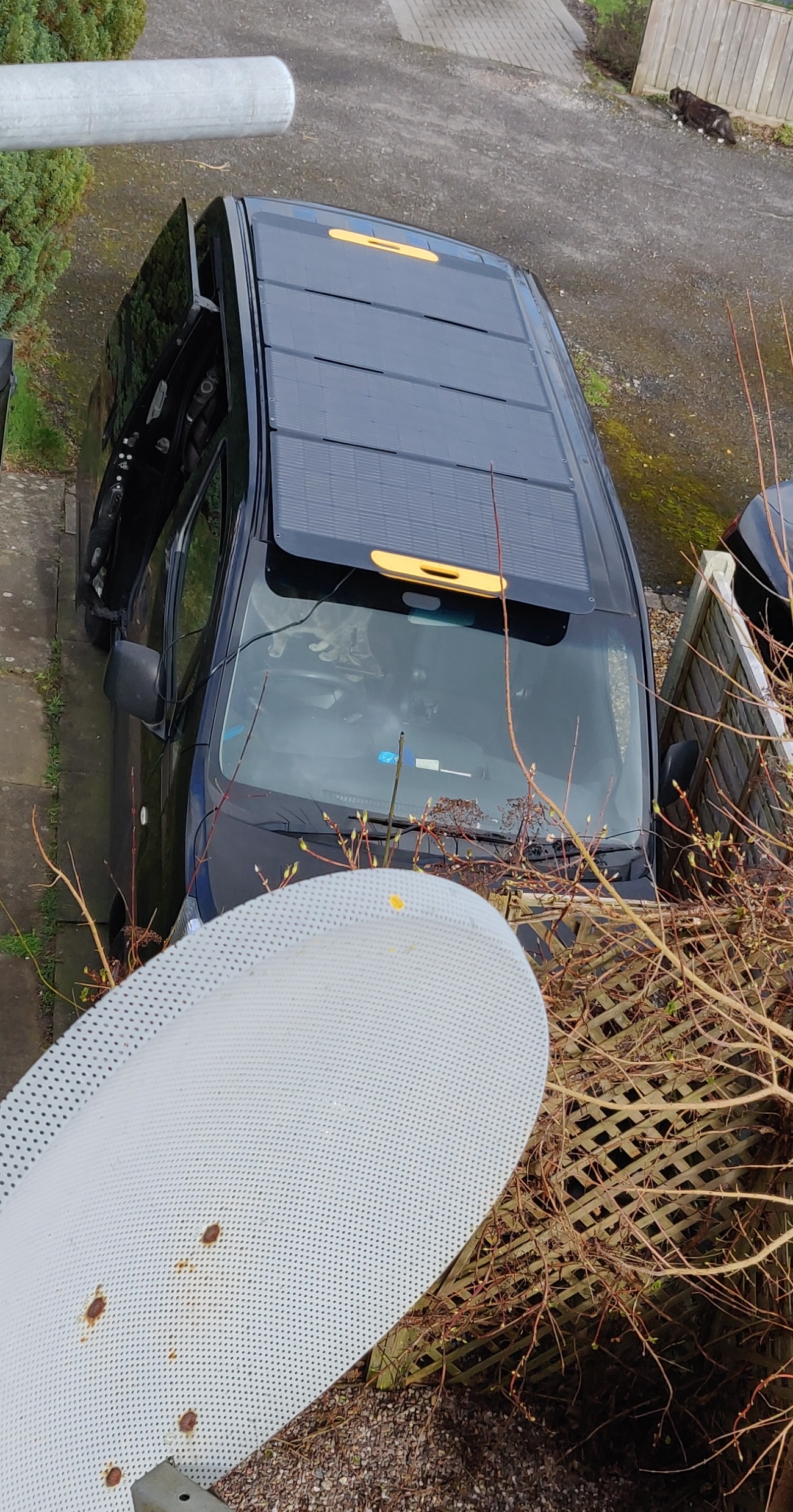

I thought I would try the solar panels seeing as the sun has briefly come out, although very weak.
Fit on the roof fine. I would lock them if leaving the van, but I would like to think they wouldn't get stolen from dirt farms carpark or similar.
Currently outputting 155w. I'm sure in the summer they should do at least double.
How many cats in the photo? 😁
