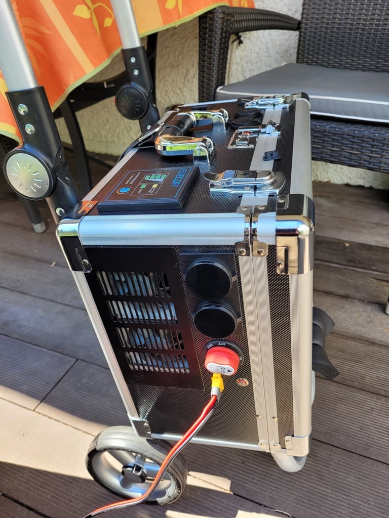

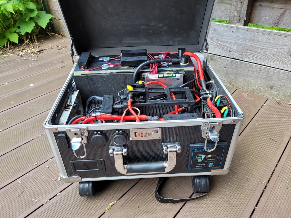

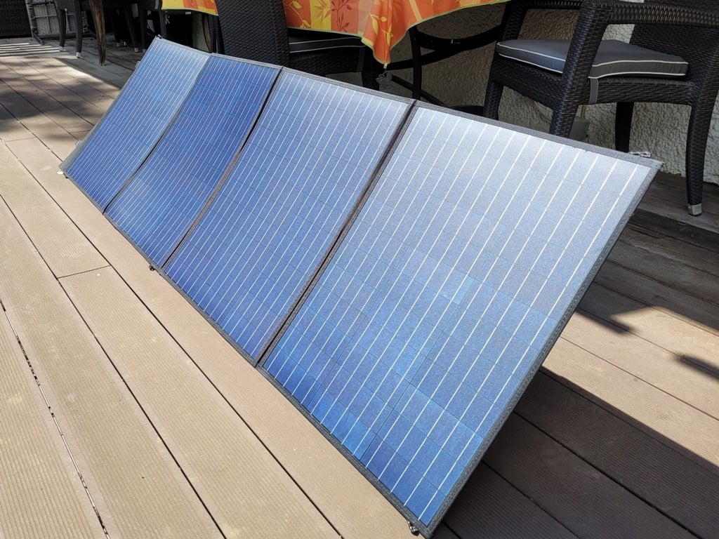

Hi all friends,
I made my portable energy station myself based on 4 high quality LFP4 cells (> 3000Wh), the cost price is around €1500 not including my work.
Maybe this will give other people some ideas.
Technical description
Prismatic LFP4 cells 240A CALB A+ > 3072Wh under 12.8V
BMS Jikong BT 4S 200A
BusBars 300A in-house manufacturing (3mm copper + each 3 x M8 + 4x M4, brass screws)
400A Hall Effect LV Coulombmeter (WLS-MVA400)
Edecoa pure sine converter 2500/5000W
Output 2x 230V 16A schuko
USB 3.0 + Type C
outputs 12V cigarette lighter
output 15A XT90 8awg
50A charging port (50A 12V output possible)
Antarion BT 30A MPPT solar regulator
XT60 12awg solar charging port (mppt > 8awg battery)
200W folding solar panel (ALLPOWERS 4 panel version)
Ventilation: 4x 80mm Noctua NF-R8 + 1 triple 40mm on converter
Ventilation is automated with 4 temperature sensors
Internal temperature is controlled with 3 sensors
General circuit breaker 200A (max 300A)
Alucase Berwall SW 043 suitcase
External protective cover
External charger 230V LFP4 50A
Total weight: 27 kg
Cheers, Pascal
