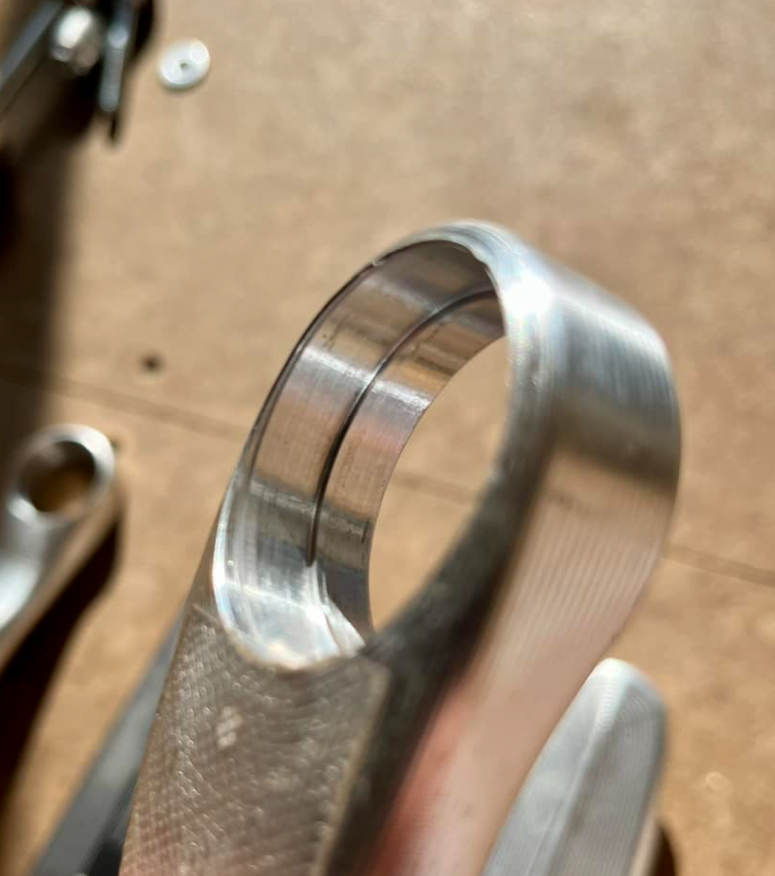

I’m talking about the link arms that connect swing arm to axels. X4. Each has a double bearing pressed in. Simple to install - there are videos for that. But nothing for how to remove. Seems it would be very easy to damage link arms to me.

If you are not already on the pole riders facebook group. Join up and ask the same question. I think the linkages have a step in middle and need to pulled with a blind bearing puller. Or tapped out with a punch from the inside out.
Ah. Glad you showed that pic.
Could have done some damage there.
I have blind pullers - just trying to think how to hold the link arm to support it without interfering with the bearing. There’s not much land to support on.

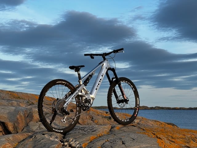

Also, here is a pic from the coast of Norway, really enjoying the bike and need to keep it alive for as long as possible now and be extra aware.
