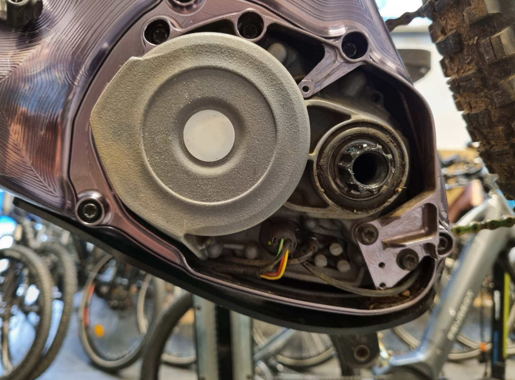

Anyone install the Bosch ConnectModule inside their Vioma with the Race motor?
I have the connect module, but havent installed it yet :). You need to remove the crank to remove the plastic protection and after that you need to have the BDU37 module. That is for my race.
#Update :
Just installed the ConnectModule. You do not need to remove the crank to take the plastic protection off. After an update on the bike, activated the Alarm + GPS. Now I need to ask Pole for the invoice and update all the bike details, so if the bike is stolen you can send a report directly to the police.

Its a bit fiddly to remove the plastic cover. You need to turn the crank around to find the exact spot where the gap is the largest so it fits. Then the cover will sit around your pedal untill you install the module. Personally, I didn't find the user manual handy and used the good old Youtube(link to actual video I used).

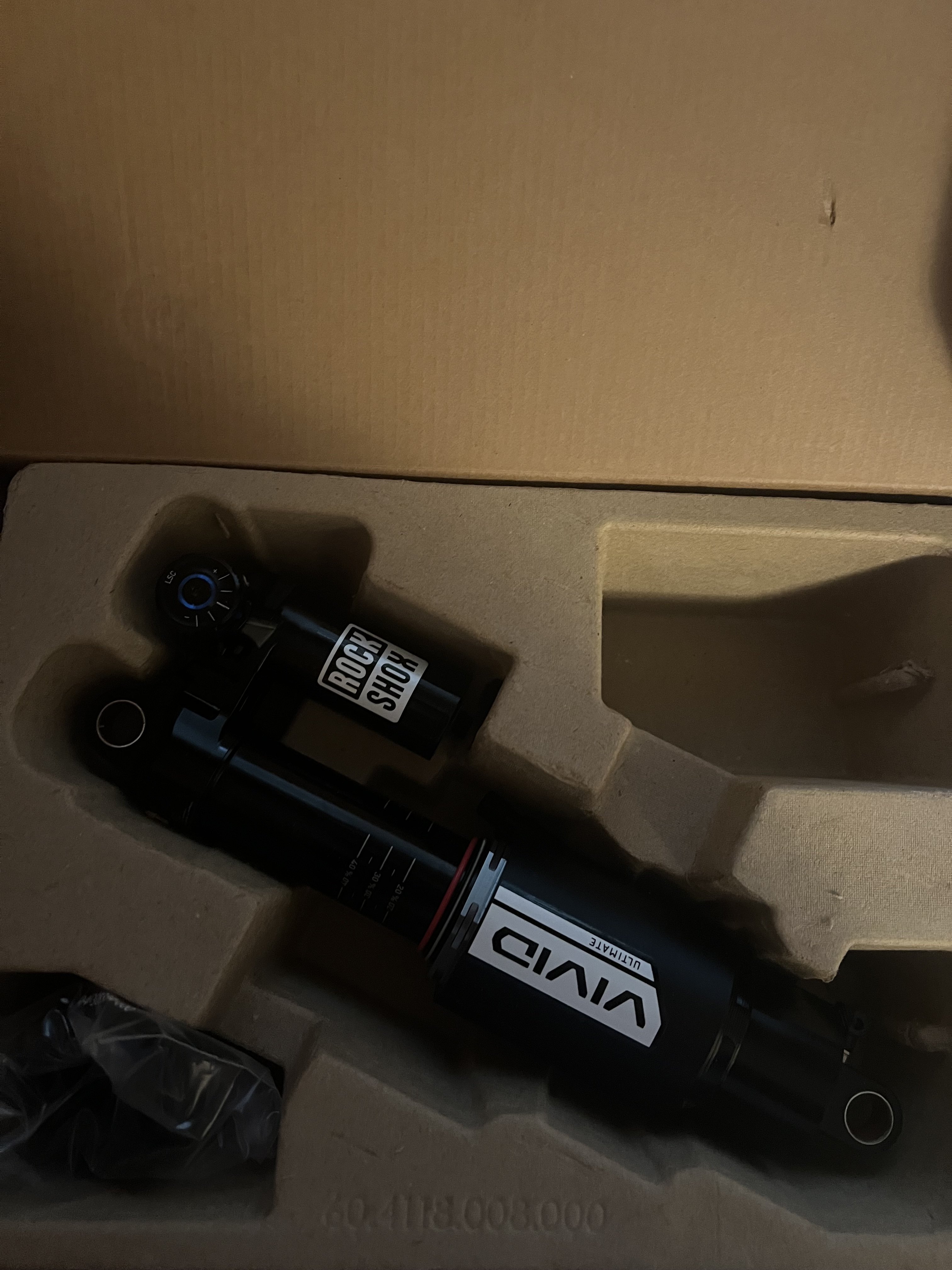

Has anyone tried the new Vivid Utimate Air RC2T on their Vioma?
I wish I would have had that option, I would have spent $383 to get it instead of the SDU with HBO.
I’m also curious although I still want an EXT Arma at some point
I have one on order, but it’s back ordered.
Chris @ Pole told me the tune for the Vioma is R25 C30…did you order one with a Vioma, or from somewhere else?
The retail shock I found was tune R25 C34 X2…not sure how much different this would be than the Vioma tune or what the differences are for the X0 - X4 lock out.
I haven’t tried to order a custom tune Rockshox shock from anywhere.
No, I just ordered one from my supplier. There's a few suspension tuners close by if I wanted to change something.
Does it matter which way the Vivid is mounted?
Is it best to mount it with the piggy back in the same position as the SDU?

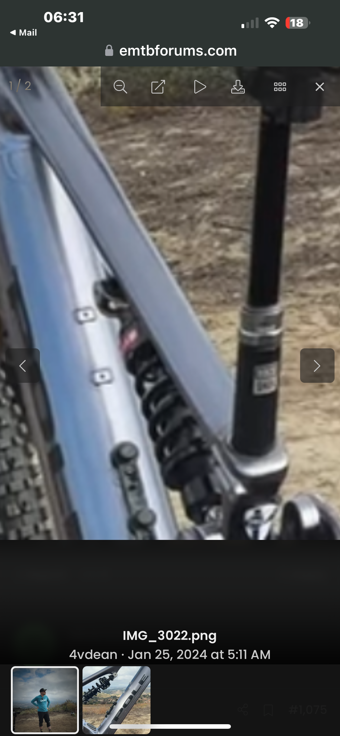

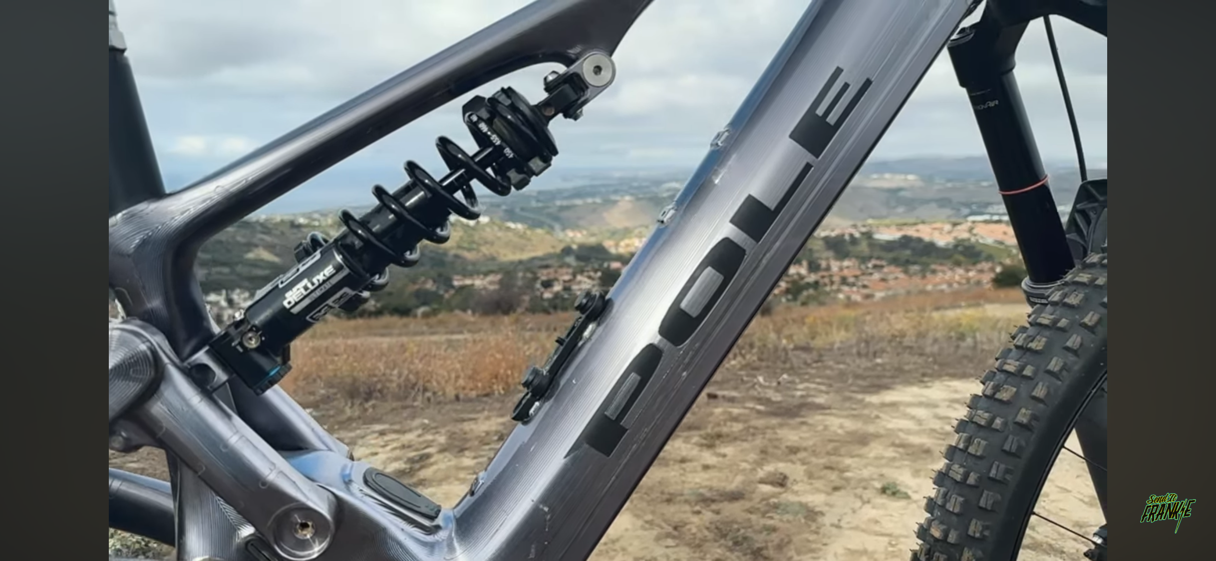

Just don’t mount your shock like this guy, it’s sort of crossed over, not sure if you can tell from the pics, watch the YouTube vid and you can see it, maybe it actually doesn’t matter, his bike so he can do what he wants I suppose……..

No, what I referring to is only one of the shock yokes is around the wrong way. The shock is not parallel to the top tube
It can be mounted whichever way you want, as long as the reservoir is on the longer side of both yokes. Like in the pic Below. P.s., excuse the dirt, it hasn’t been cleaned since before the last ride. 😃👍🏼
What if the reservoir is on the long side of only 1 yoke.
To put it another way, flip around just one of your yokes so the shock is then on a slight angle.
Thats what I’m seeing in the pics I posted
With the Super Deluxe the piggyback is mounted to the housing, whereas with the vivid its mounted on the shaft. My sense would be the shaft side mounted toward the seat tube with the piggyback on left side. Try that for starters.
That’s a big no no. I’m pretty sure Leo has said it too. The offset yokes need to be the same offset on both ends.
