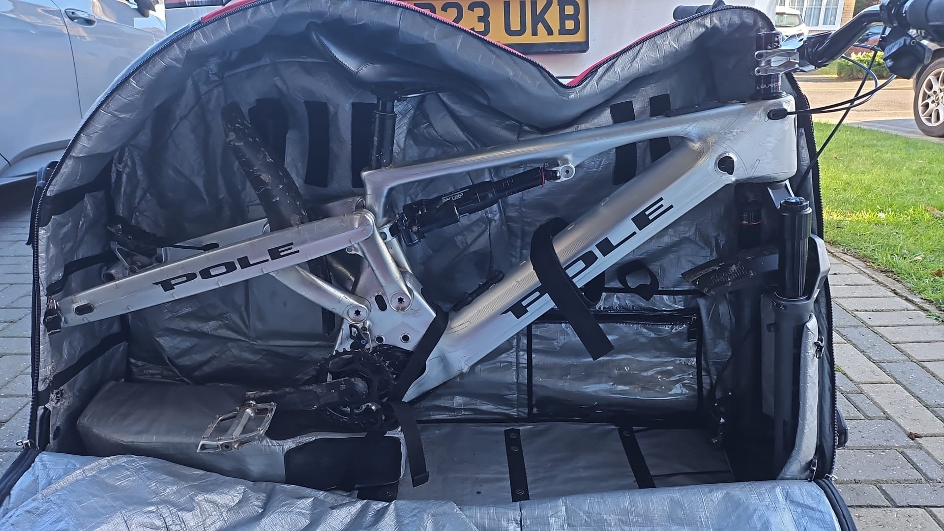

I've got a Voima K1 and a standard EVOC bike bag.
It's tight, but goes in if you let the air out of front and rear suspension.
And total weight bag and bike w no battery ?
It was a balancing act keeping below the 32kg limit.
In the end I put the AXS derailleur and pedals in my carry on and put my riding boots, jacket and trousers with the bike.
Ended up weighing 31.4kg.
The bag on its own was nearly 9kg.

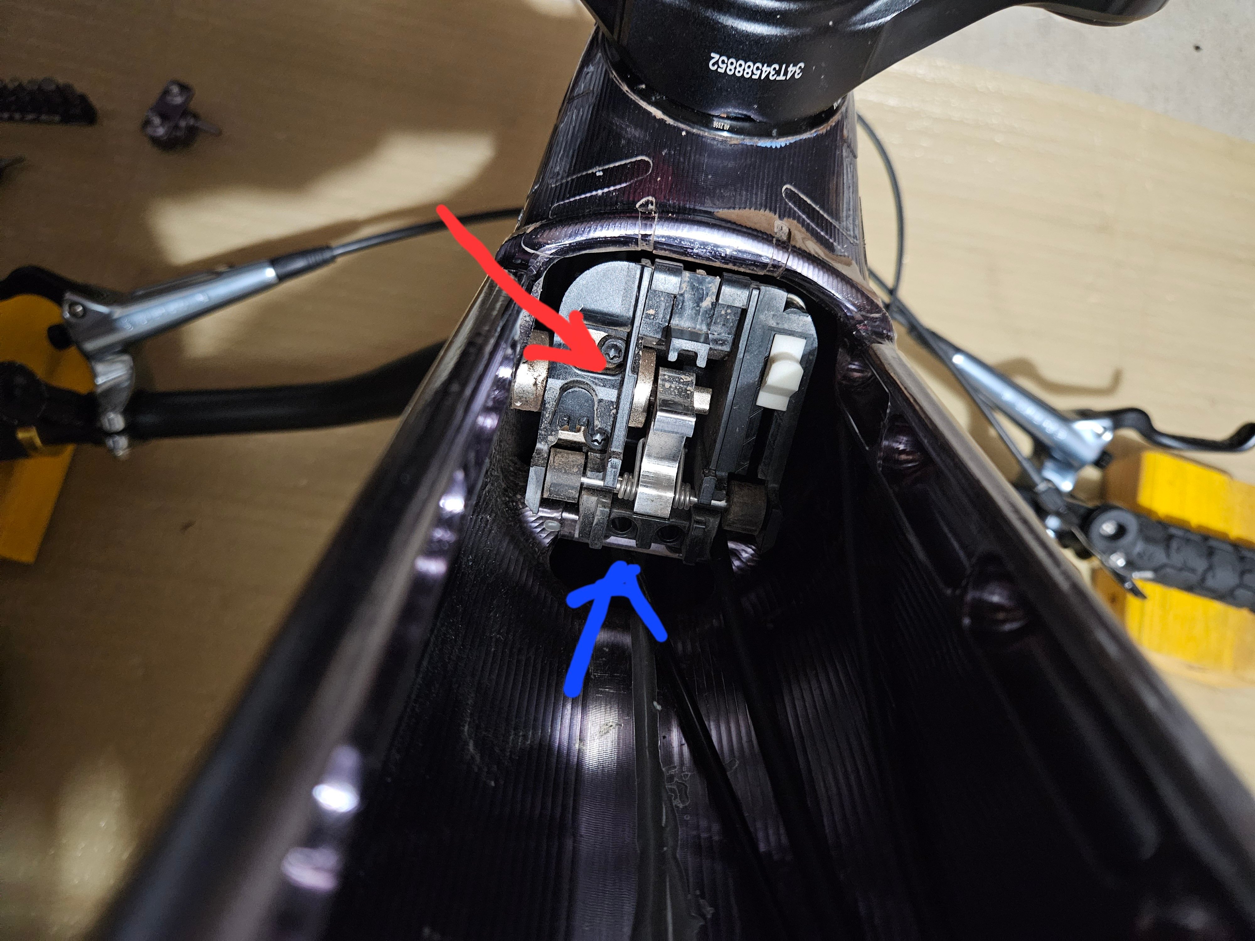

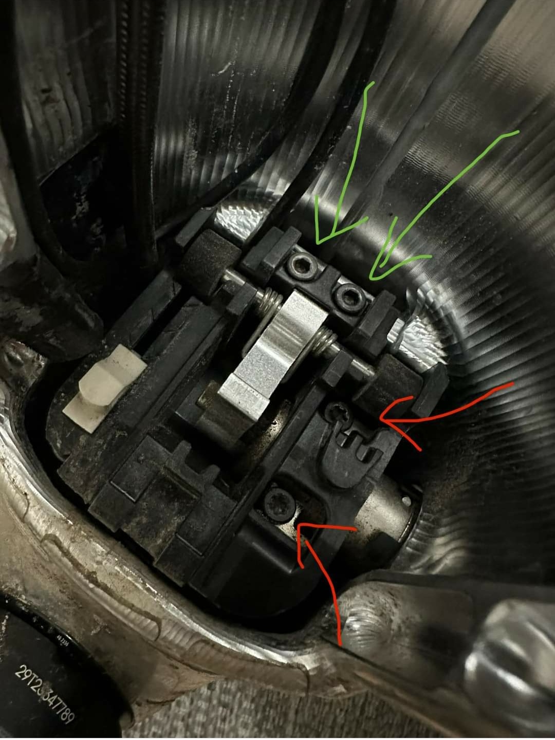

Anyone installed the keyless system on Voima LED frame? It looks like I need to take off the mounting bracket to change the lock with keyless system. I unscrewed the two bolts by the blue arrow in the picture but bracket won't come off. Anyone done it? Do we need to undo some bolts from the fork side?

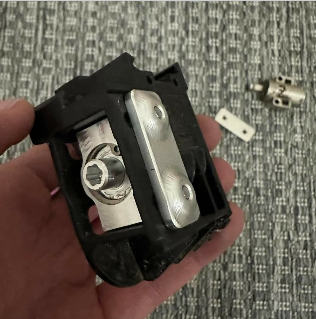

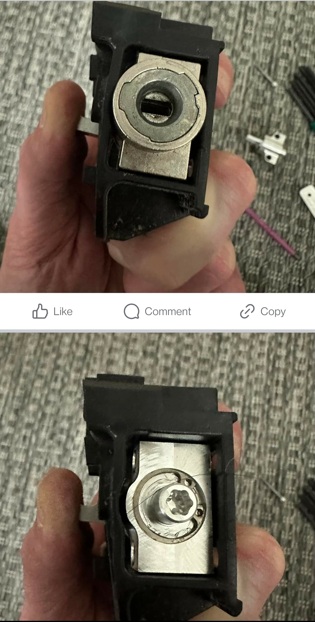

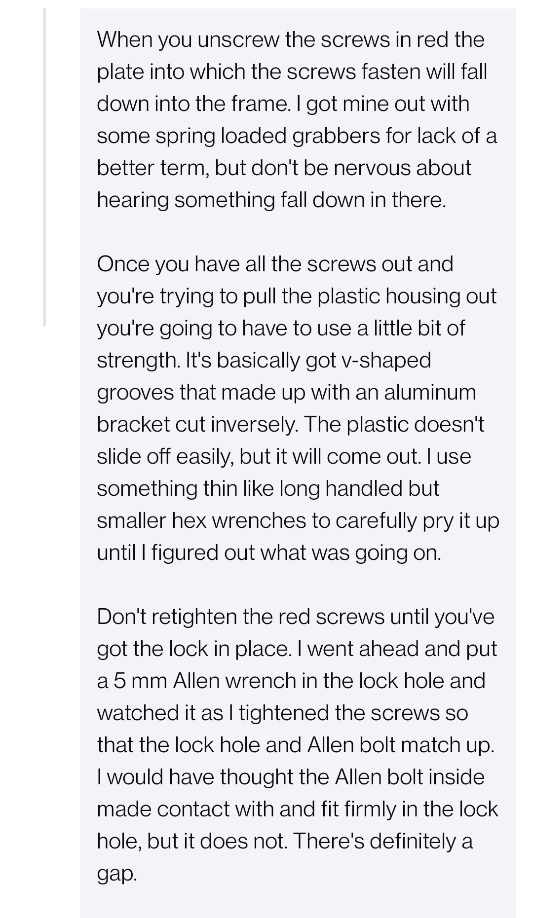

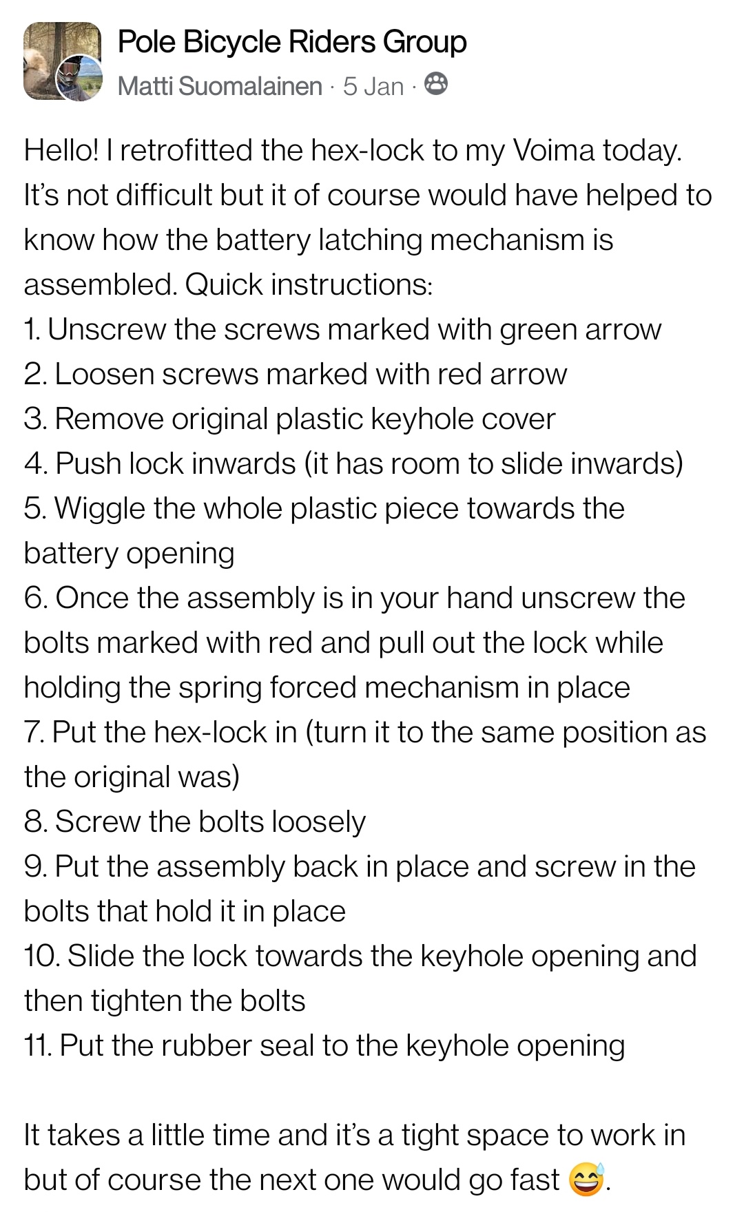

Stolen from the pole FB group if it's any help ?
It is difficult to get off. The bracket slides on a zig-zag set of rails. I got mine off by gently prying it up and backwards while pulling on it. You need to wiggle and pull away, towards the bottom of the down tube. It will come off.
Thank you everyone for the tips on how to get the keyless system installed. I ended up dismantling the fork and stem and pushed the mounting bracket out from behind. It was annoying but got the job done. I feel silly personalizing the keyless system to storm gray color. Whole contraption is housed inside. I will take that as a donation to Pole. Afterall, it is a killer bike!
