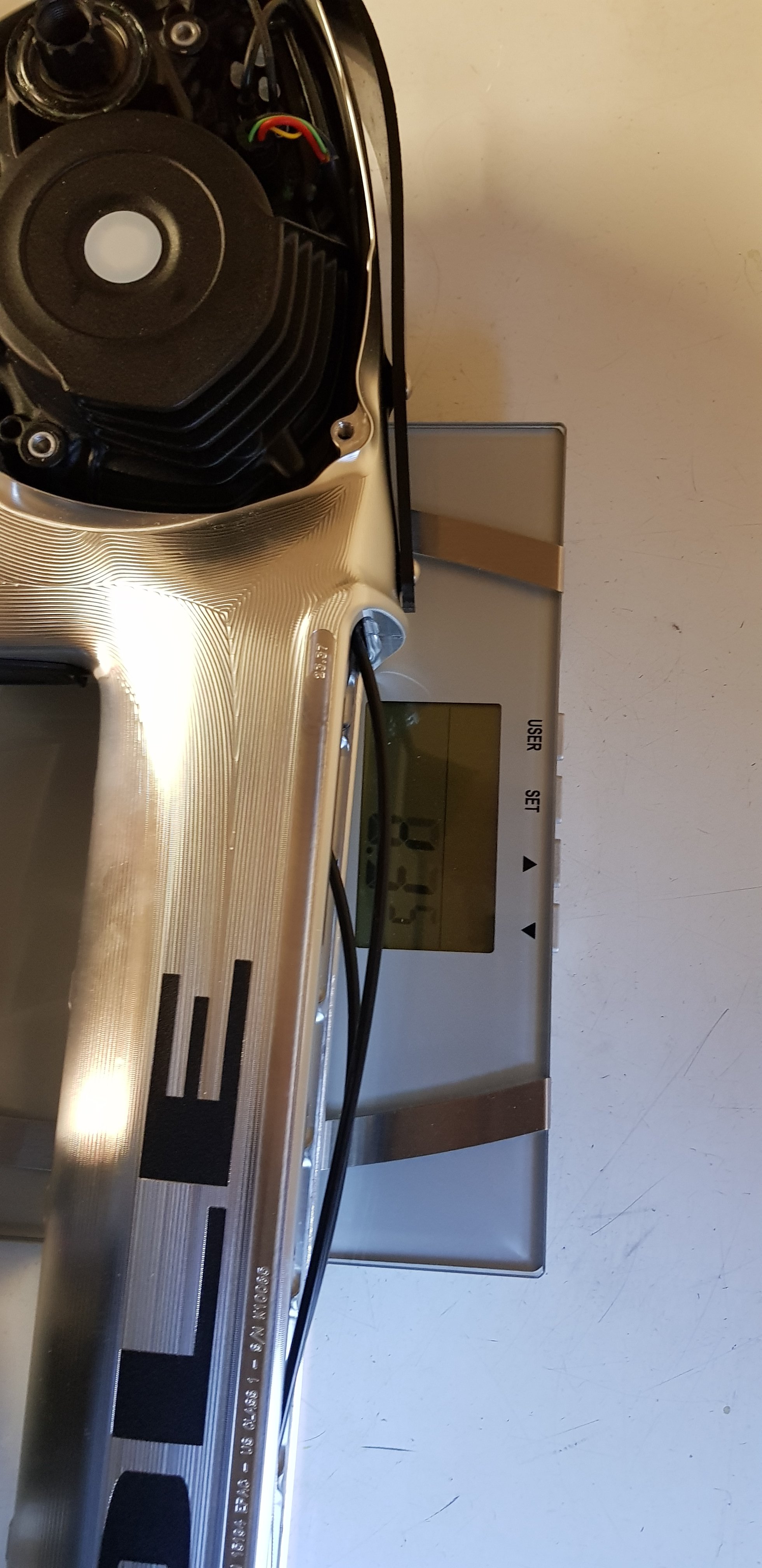

8.35 kg without battery, battery cover, motor case.
Has cables, and chainring.

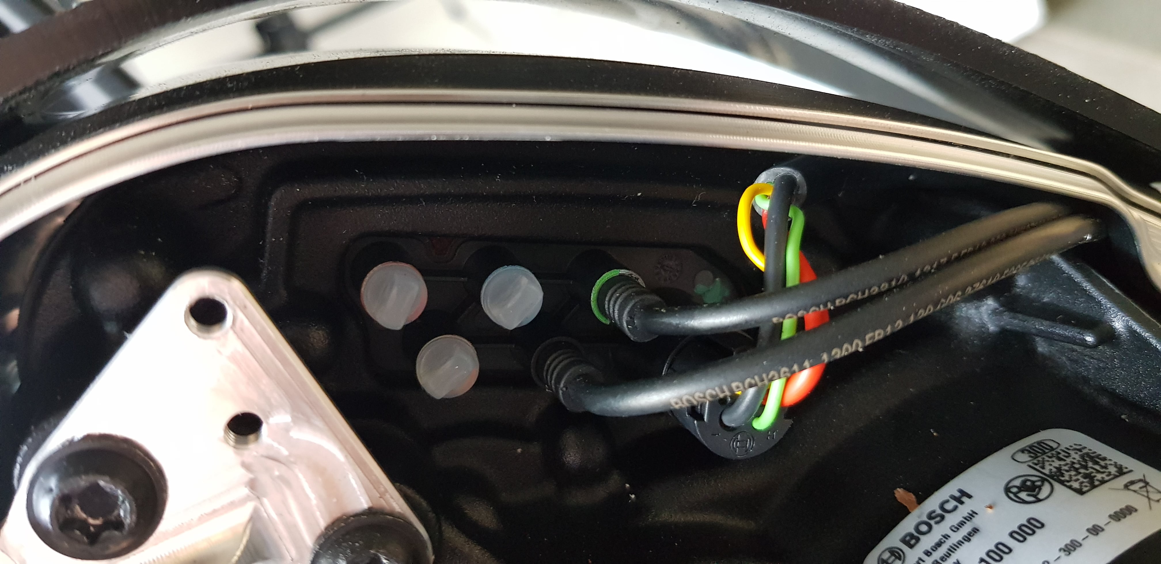

Team which plug does the speed sensor plug into?
Currently its in the green which I think is wrong. as the maget works and the cable works.... The cable has a red oring on it which makes me think its should be plugged into the red plug on the right?

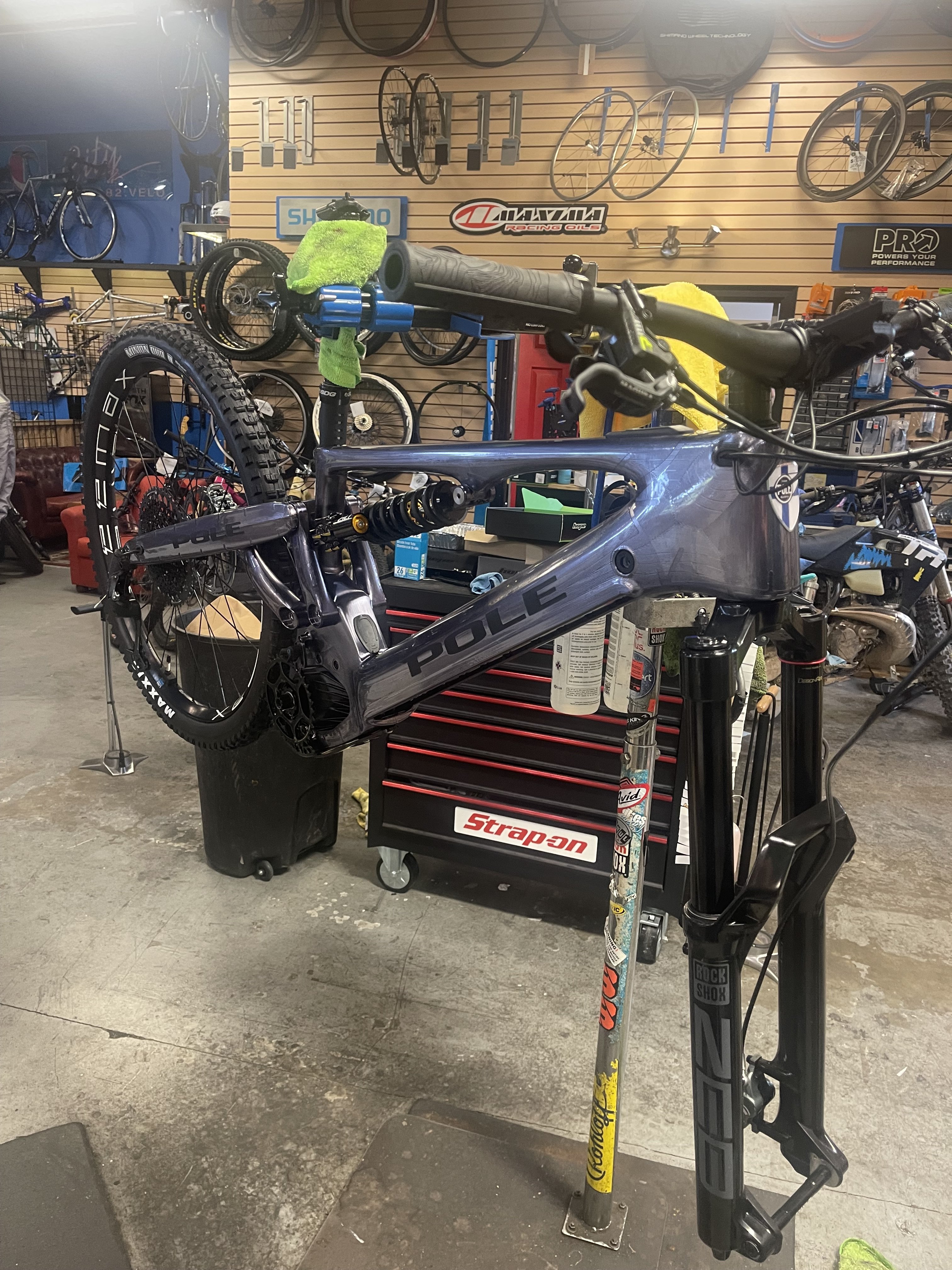

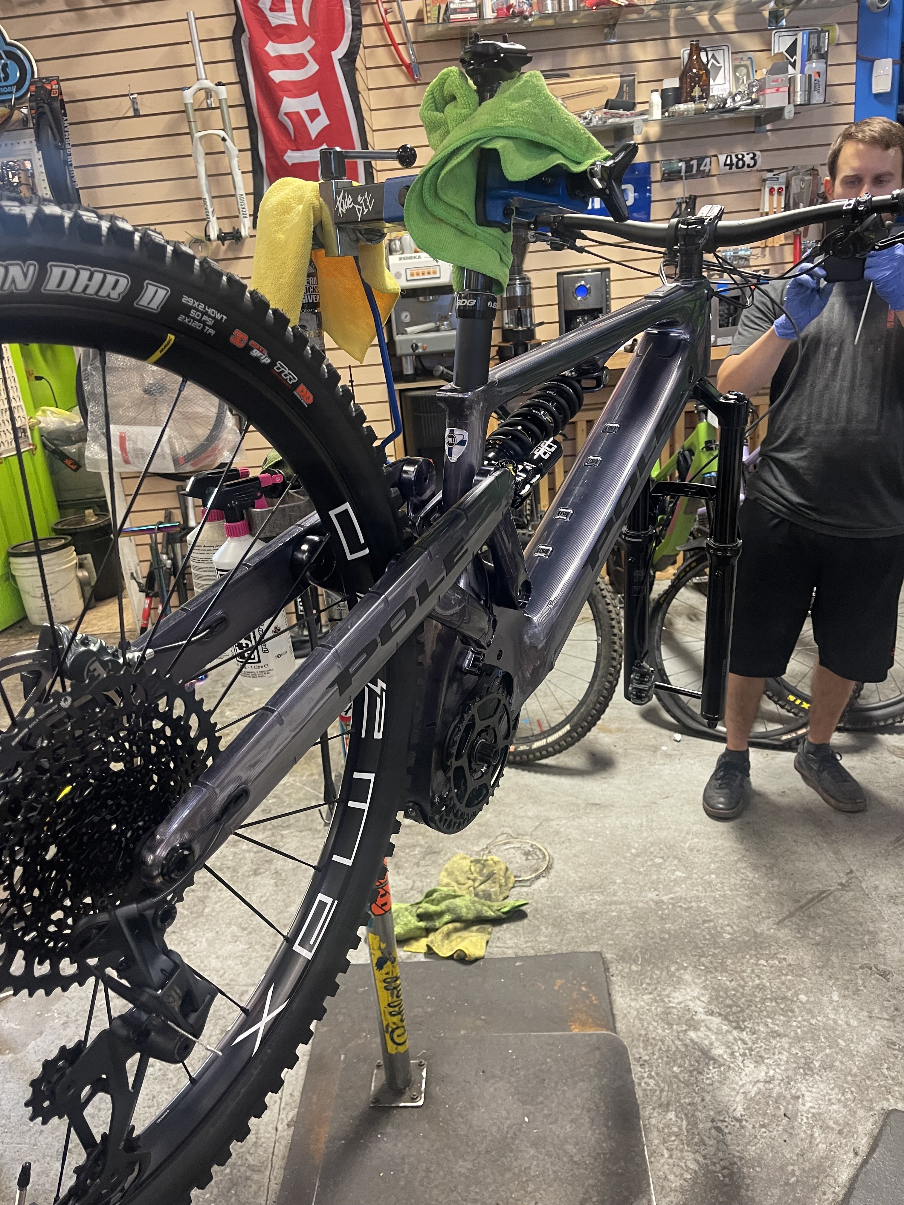

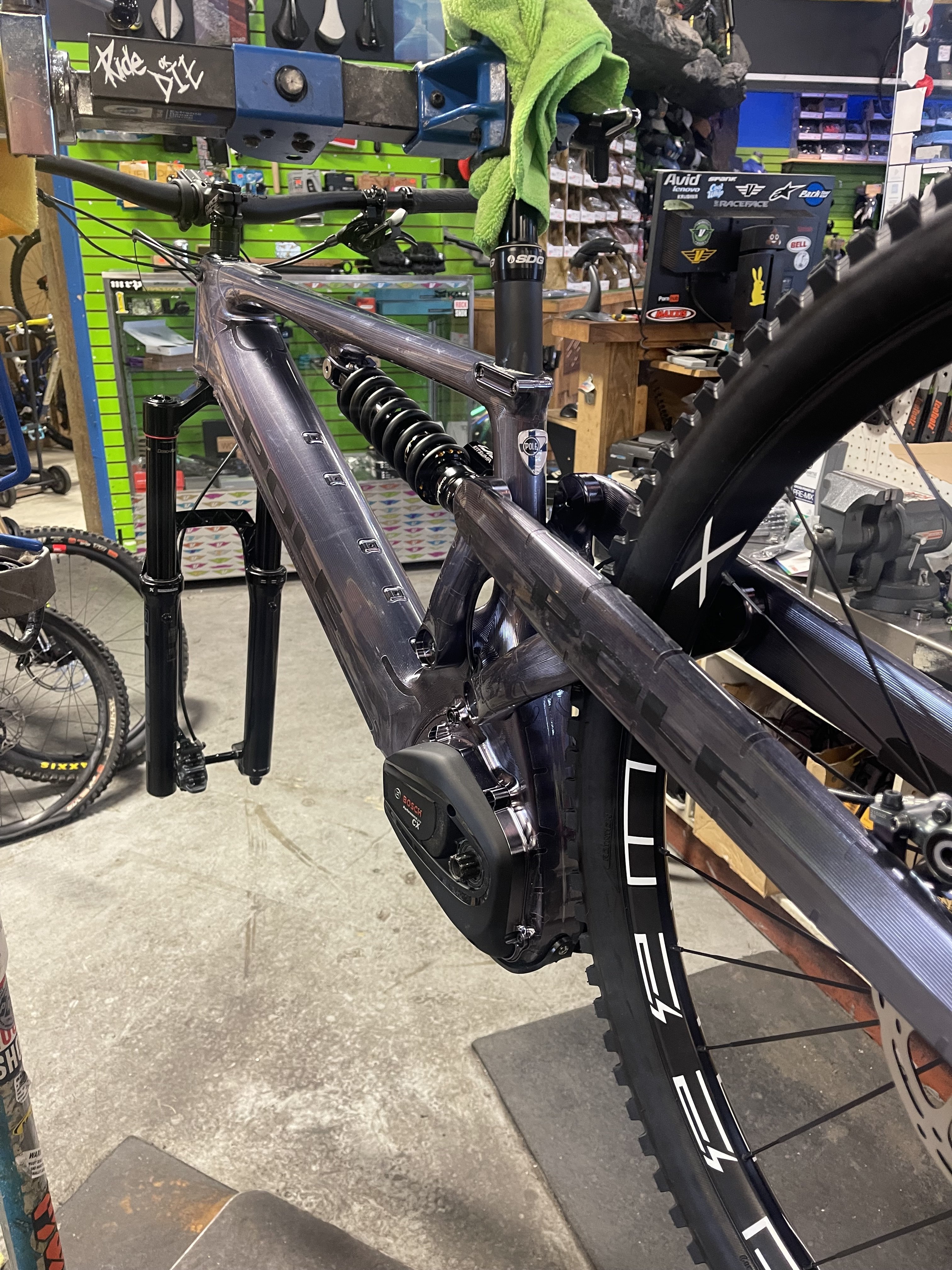

We started building the new K3 Voima at the shop I work at for my buddy that ordered one, overall very impressed with the build quality. A few little things that look odd for this expensive of a bike, you would think Pole would come up with a better way to secure the routed brake line rather than just using some black gorilla tape. You think maybe they could machine something into the down tube that could allow internally to secure cable ties to hold a brake line or dropper post or shift cables in place. I also didn't realize that they install the brand logos over the clear wrap, the logo above the top tube power button is already peeling off. And the battery was damaged in shipping, looks like due to poor packaging from Pole.
The Storm Grey looks great in person, I was thinking I would order the raw color when I go to order mine. But after seeing the grey in person I'm torn on what to order.....lol
You could argue that it stops any chance of the cable rattling around between tie points ?

It looks micky mouse to have crappy gorilla tape in there like that. I'm sure there's far better ways of going about it. Just seems funny to put a lot of effort into the quality of the bike to have something like that on the inside of the frame. I get it most people don't see it, but again it's the little things that really should set this bike apart from others and that was a miss in my opinion.
Should help you ..
It's green as it doubles as the Low power port when it's not used for the remote speed sensor.
Are you sure your motor is configured for the remote speed sensor and not the rim magnet ?
The green one is correct. Just make sure it’s in correctly and that none of the little tiny pins are bent.
