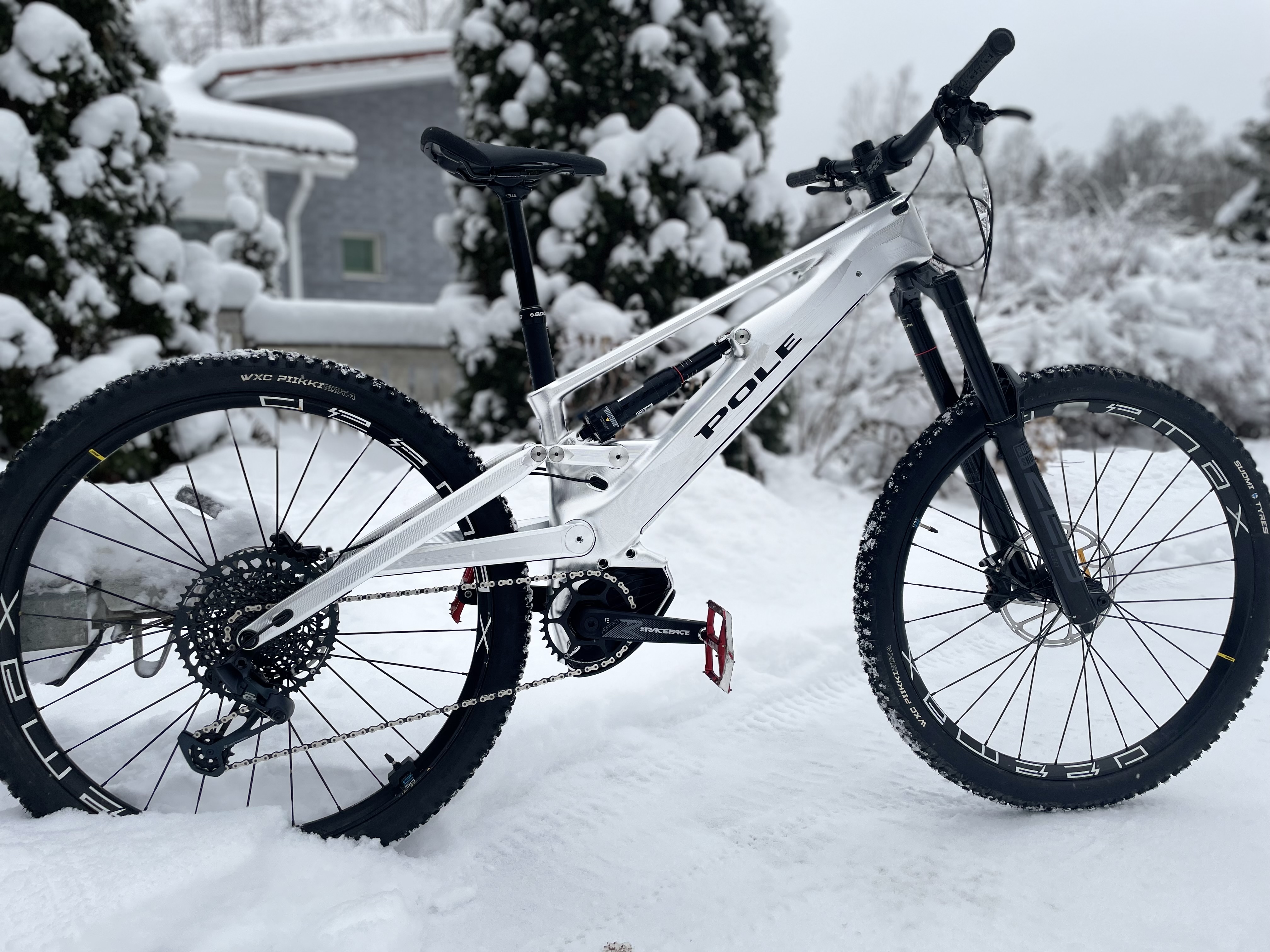

Sure, I can tell more about differences. Please know that I am not any professional and my plan is to just have fun :)
In Finland we currently have lots of snow and ice, so traction is a bit different than summertime even with the spikes. I have now riden only little bit over 100km, snowboarding is taking my time as well :)
My plan was to updrade Voima to Sonni. First I was looking for frameset, but I noticed that a difference to the basic conf Sonni was so small that there was no sense, so I ordered Sonni with deluxe ultimate, zeb select, sram gx etc.
I sold my Voima with basic conf and left Hope brakes, cane creek coil, Charger3 damper, sram asx etc. to my shelf waiting for bikepark opening. I also have extra 29" e-deemax set with spike tires.
About questions: I Need more riding and summertime for deeper analyse, but here is some thoughts. I have tried demo-Sonnin in the bike park as well so I have some ideas.
- Ride characteristics: Sonni is a bit smaller. I am 172cm and I used to have K1 Evolink before Voima, which felt a bit small for me as I am an old MX/Enduro rider. K2 Voima felt so much better, but now when Sonni in a bit smaller, it feels to be perfect for me.
Sonni is more agile, easier to wheelie (very important :)). 29" Sonni turns better than mullet Voima, but it might be size thing. Sonni feels a bit lighter as well.
- Suspension performance and tuning: I think rear link is more progressive. I have 190/200 conf and it goes so nice and smooth, but does not bottom in big jumps. I just tuned setup via trailhead. But as I told at beginning, winter is a bit different. Super deluxe ultimate have different setup than in Voima, but kitsuma coil should fit.
- Steering and lean-in: I think Sonni turns better with 29" rear wheel than mullet Voima. I have not riden mullet Sonni yet. Lean-in is difficult to say because of winter conditions.
- Climbing: Sonni climbs as well as all Pole's. If compared to Voima, I think Voima climb better (because it is longer), but I really can not feel the difference.
- During Demo session in the bike park as fall, I first took a Sonni with lower ricer with higher bar. I almost cancel my Sonni order, because my Voima felt so much better. Then I took another demo bike with similar conf as my Voima was (standard) and I was just smiling :)
- about battery: Someone might think it is annoying to remove battery every time when charging. Because of keyless removal, it is actually really good. You can easily remove the battery, put in in a charger and maintenance lighter bike.
More onformation will follow after more kilometers. Feel free to ask if any specific questions.

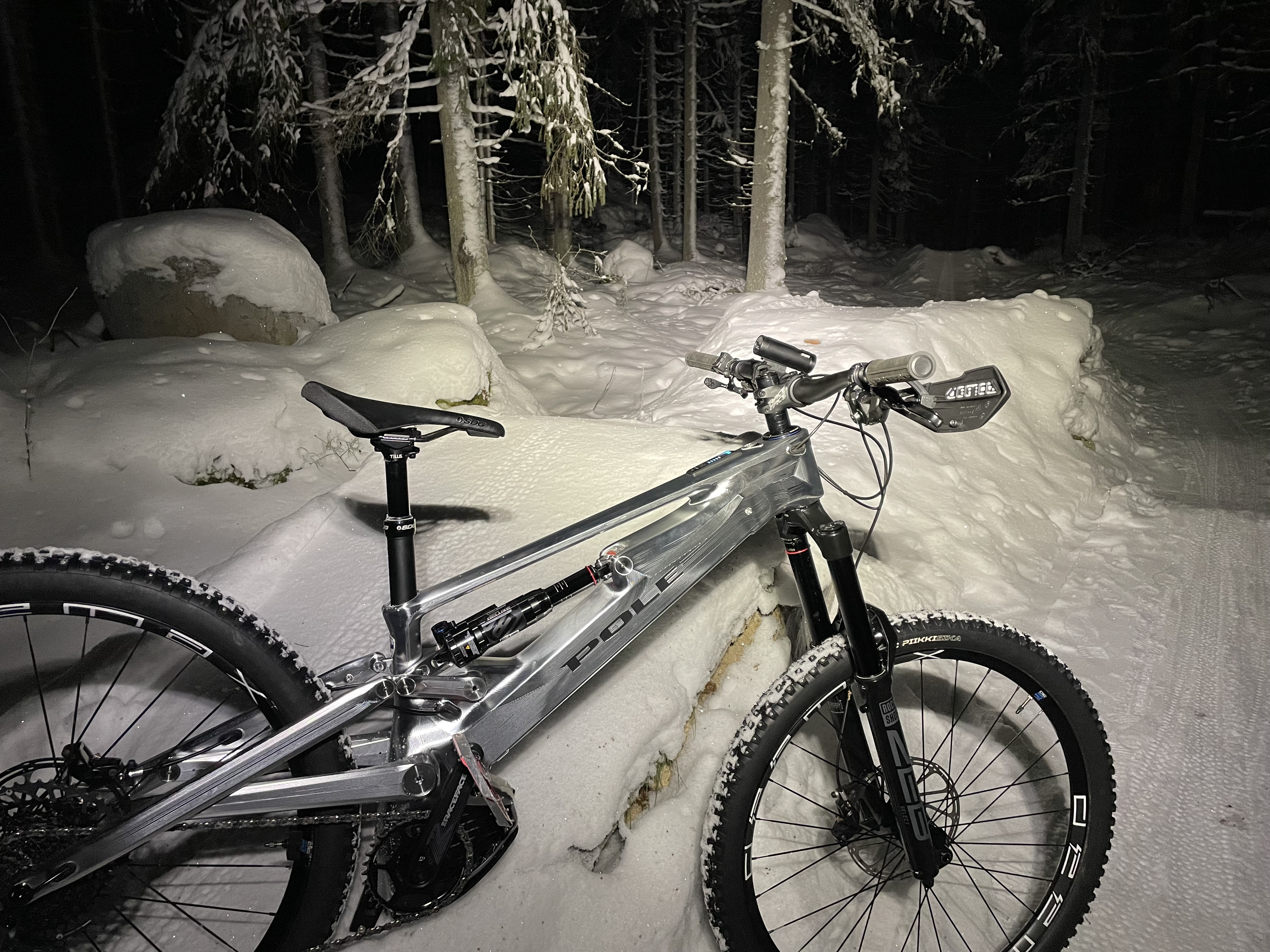

Only -6 celsius today 👍
Yesterday it was -26🥶
Bike is feeling better every time👌

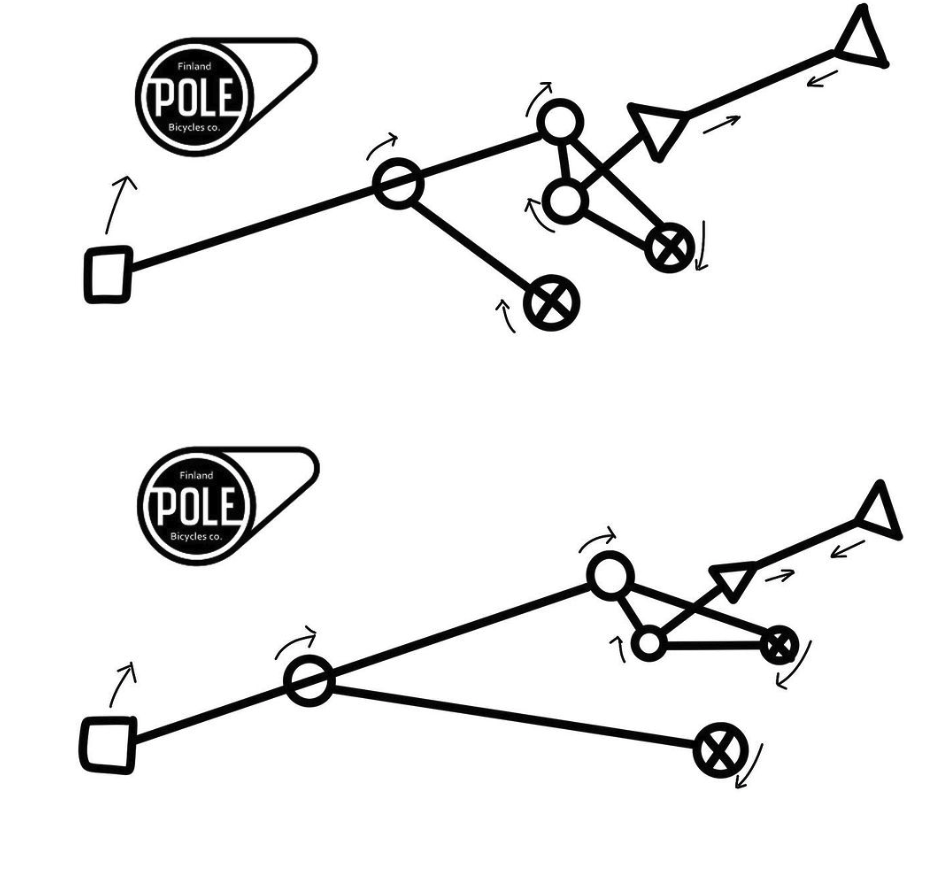

Found this interesting Instagram post that, as an aside of the subject matter, shows a free-body diagram of the Voima and Sonni suspensions. What's interesting is that core 4-bar characterics of each are effectively the same (pivot motions and directions are the same, albeit in different coordinates), so I guess Leo's assertion that the Sonni also sports a Sensei suspension can hold water. Of course, there are differences that I would like to understand, such as the swing-arm path, and faux idler-gear geometry where the upper bar is directly in line with the the top chain. That said, there is still a dearth of material regarding the Sonni suspension that deserves video update from Leo.

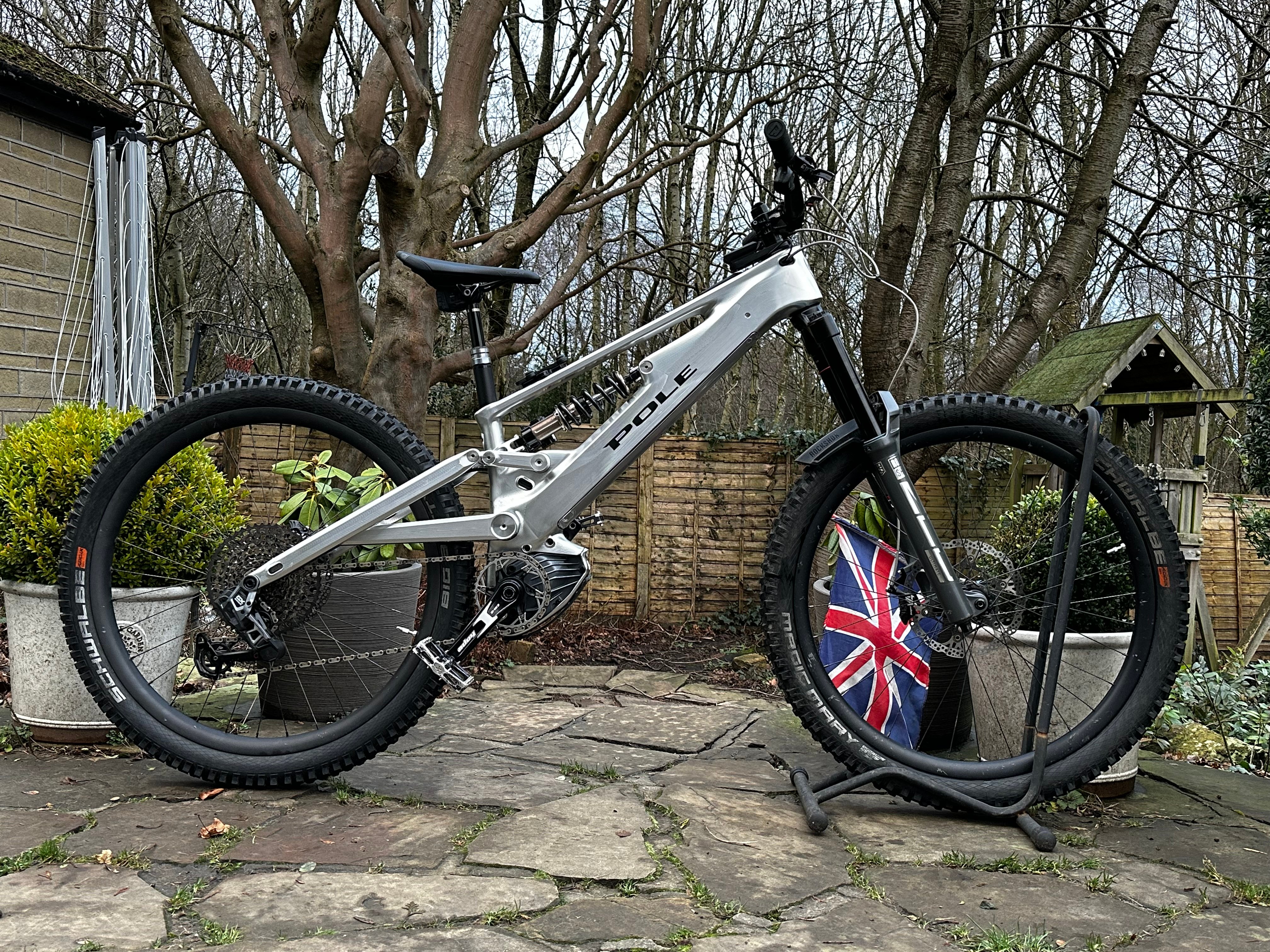

Had mine for a fortnight, it’s everything I’d hoped for. A bit more poppy and playful than the Voima. It’s ace

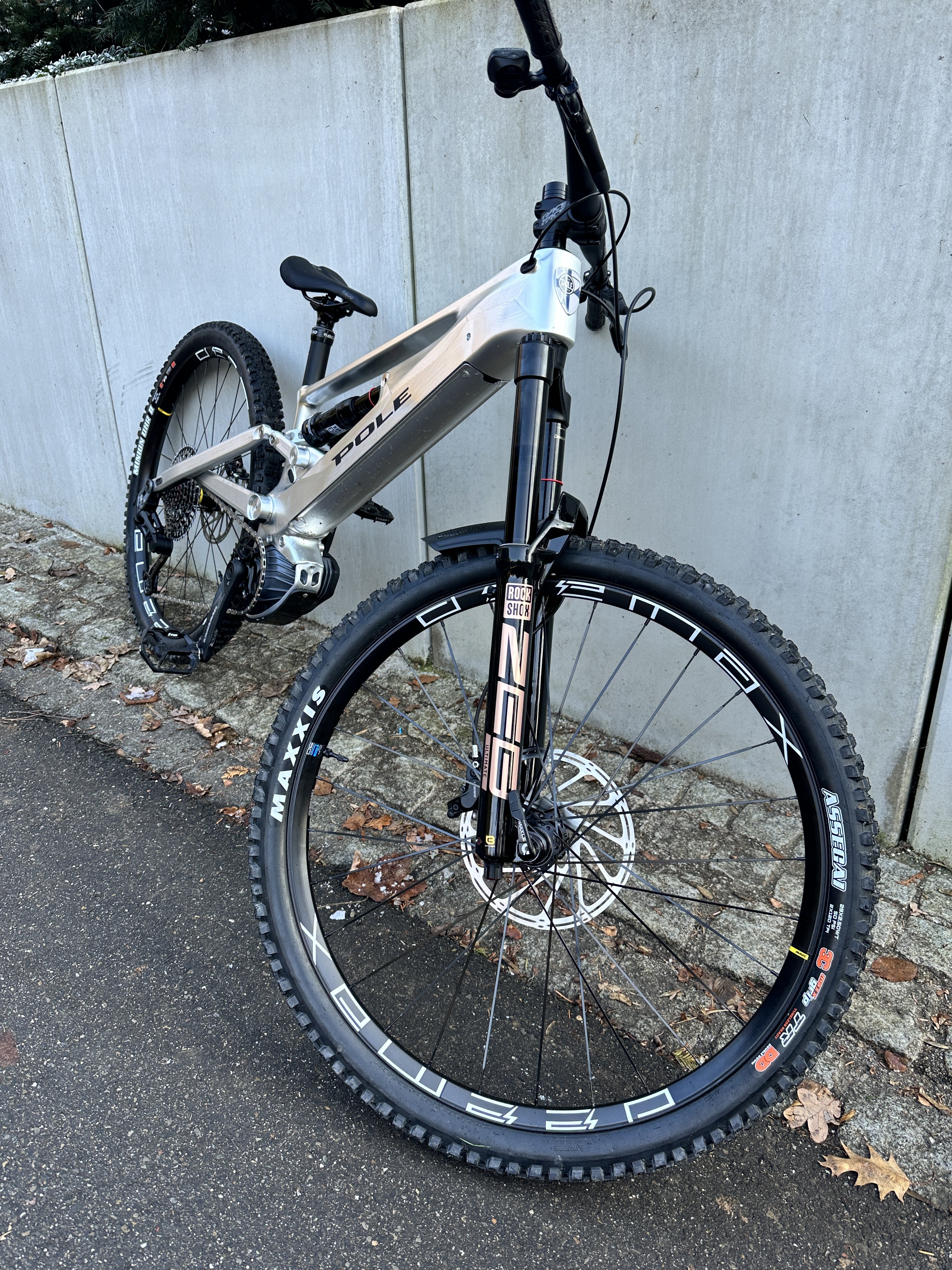

Excellent! What is your bike config? What shocks are you using? As the second fellow on the forum who came from a Voima, we would like some more details on the clear differences but nuances as well. Have you ridden the bikes on the same trails? Do you sense the bike a progression from the Voima or instead distinct from it. Have you tuned the suspension? Does feel like the Sensei suspension like the Voima or does it feel markedly different, etc.
Ive a EXT e-storia on the back and Zebs on the front. Both swapped over from my Voima. Suspension progression feels similar to the Voima, perhaps the Voima was a bit softer. The frame itself is stiffer than the Voima in a good way. Steering feels much more positive and engaging. The Voima was more forgiving, just point it and it glided through the chunk. Sonni is more playful and poppy, surprising for a 190x200mm bike. Sonni definitely has a slightly shorter reach than Voima in K2. I don’t mind the ‘dangling sack’ it’s unashamedly an e-bike, it’s not trying to hide, it’s showing off. The race motor has tons of torque, acceleration over the trails I’ve ridden before on Voima felt quicker. I LOVE IT, can’t wait to spend many more hours getting acquainted
Judging from the the subsequent picture you posted looks, like your setup is 29x29. Have you tried the bike in mullet config? The geometry of the Sonni seems to be dialed in for 27.5 rear, so saying that the bike is lively with 29x29, that's saying something.
I have mullet config for summer for my Sonni. I had already 29" wheelset with winter tires from my Voima time, so I use them in snow conditions. I had Voima with 29/29 confic and mullet. I have driven Sonni only with 29/29 conf because all demo bikes was so. Regarding Leo, Sonni works fine with both confs, no problem at all.
Voima was more agile with mullet conf, but Sonni was even more agile with 29 wheels. Im my case, need to wait until summer for Sonni mullet testing.
