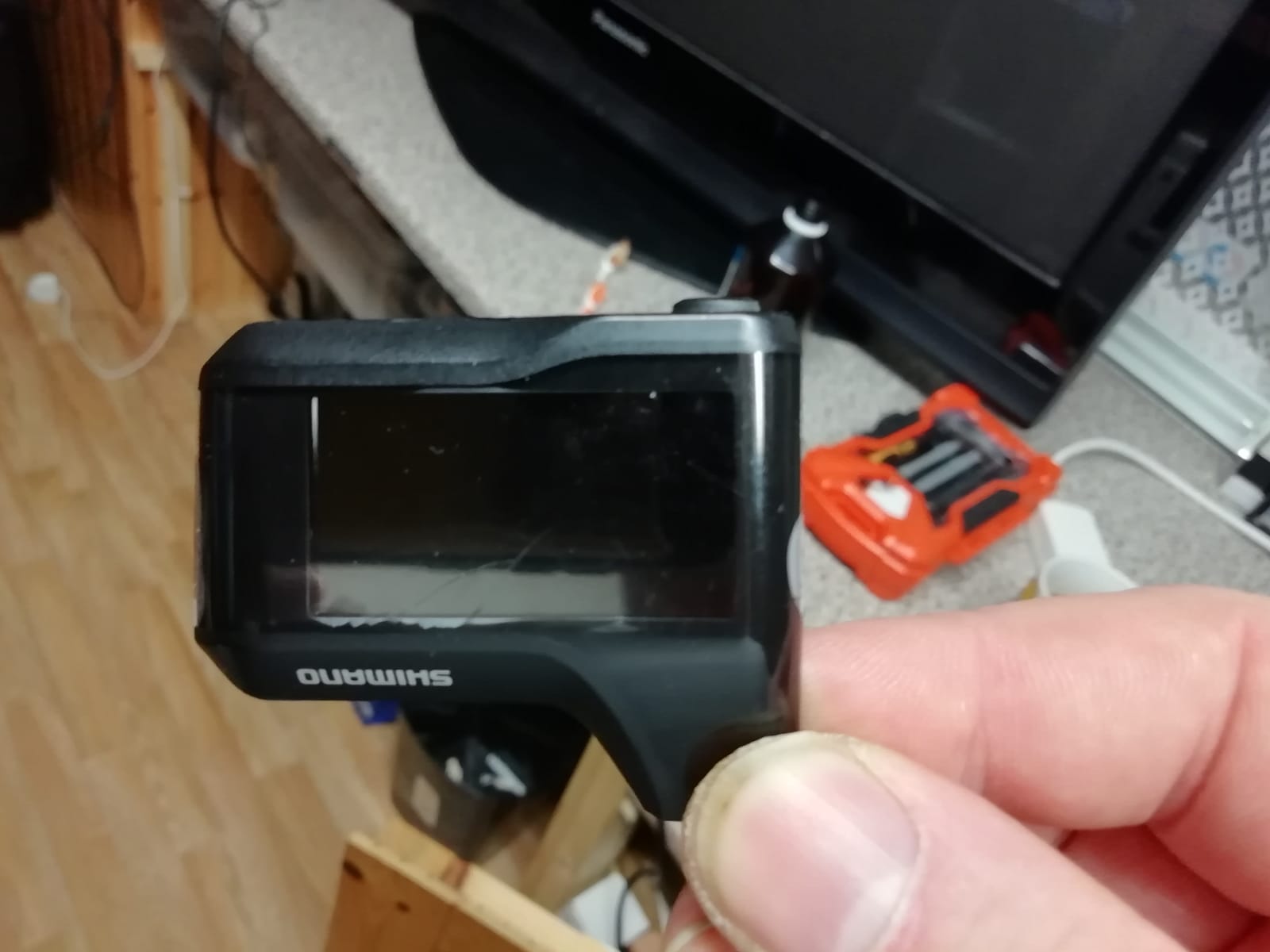

We have bypassed the connector, and soldered the wires directly. The frame battery comes on and stays on. There is 7.9volts going to the computer display on the handlebars, but it will not power up or activate. There is a small crack in the screen that has been there since I got the bike. We were hoping to find out if anyone's knows - does the sc-e8000 computer gets its power from its own internal battery? Or is it powered by the frame mounted battery. Many thanks again.

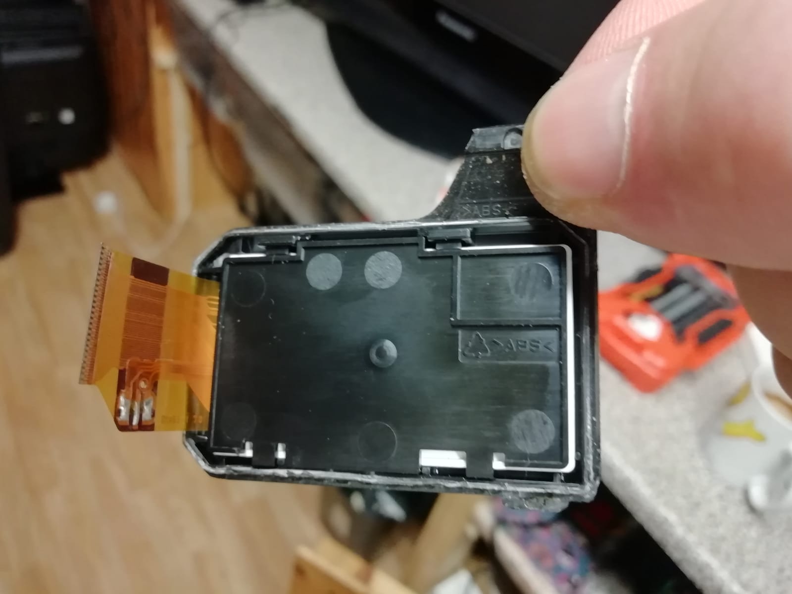

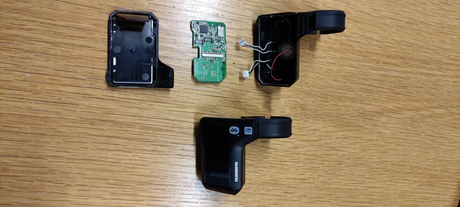

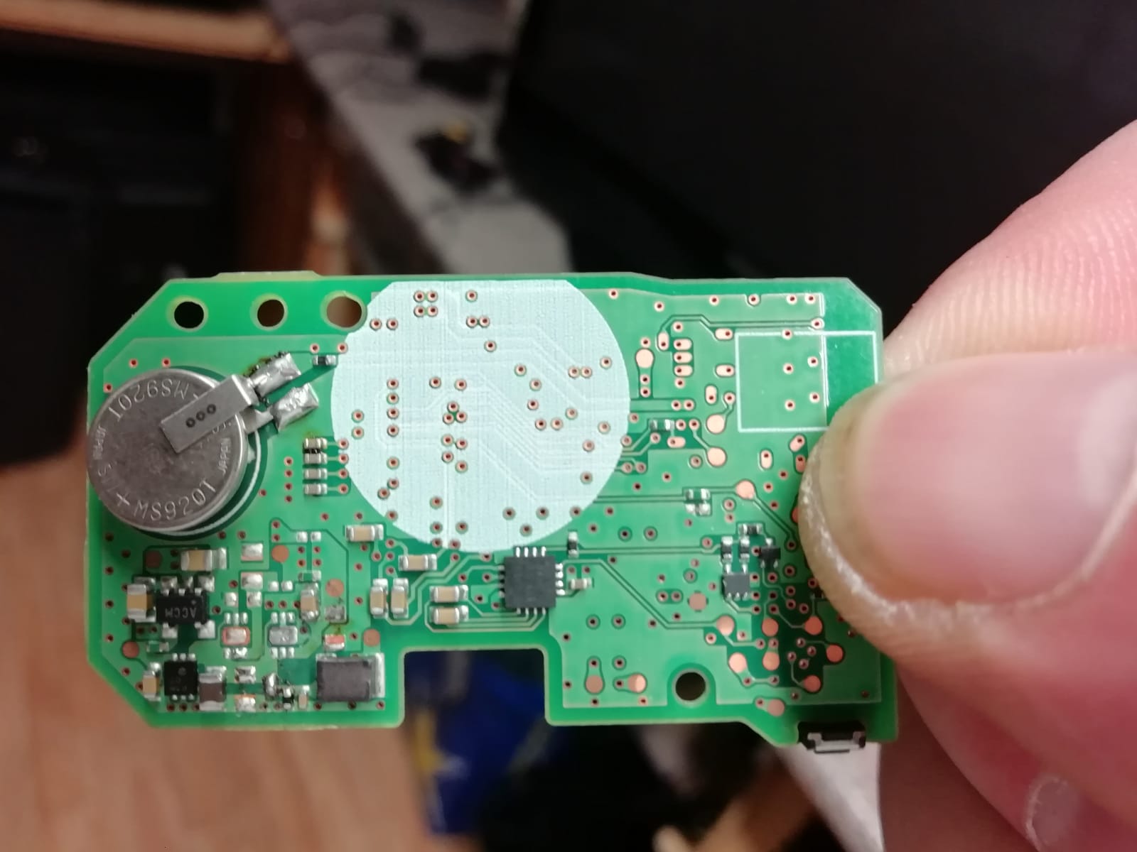

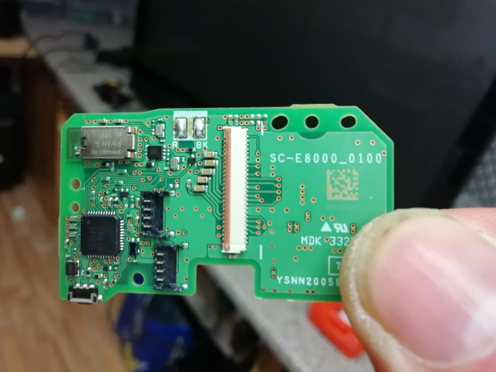

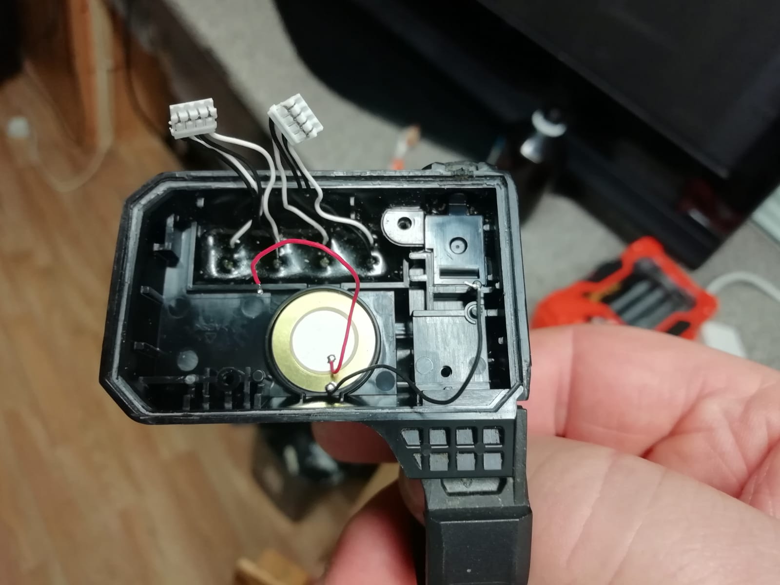

Computer opened and there was a CP open circuit that has been replaced. Computer powered from the port, the internal battery is just a backup. There are 3 little PSU's on the board and the one that supplies the microprocessor is short. May have got a surge from the connector. So now I need a new SC-E8000, who has one for sale???

Nice pictures
All kudos goes to Michael the Electrician who succeeded in opening a cracked display without causing further physical damage, and who also diagnosed the issue and took the photys(y)

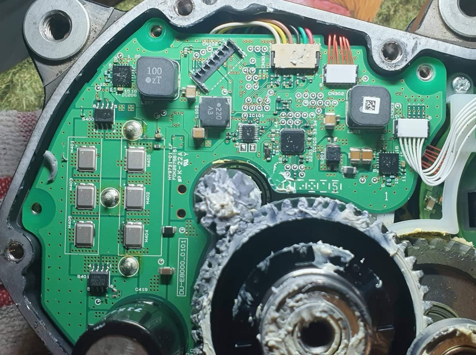

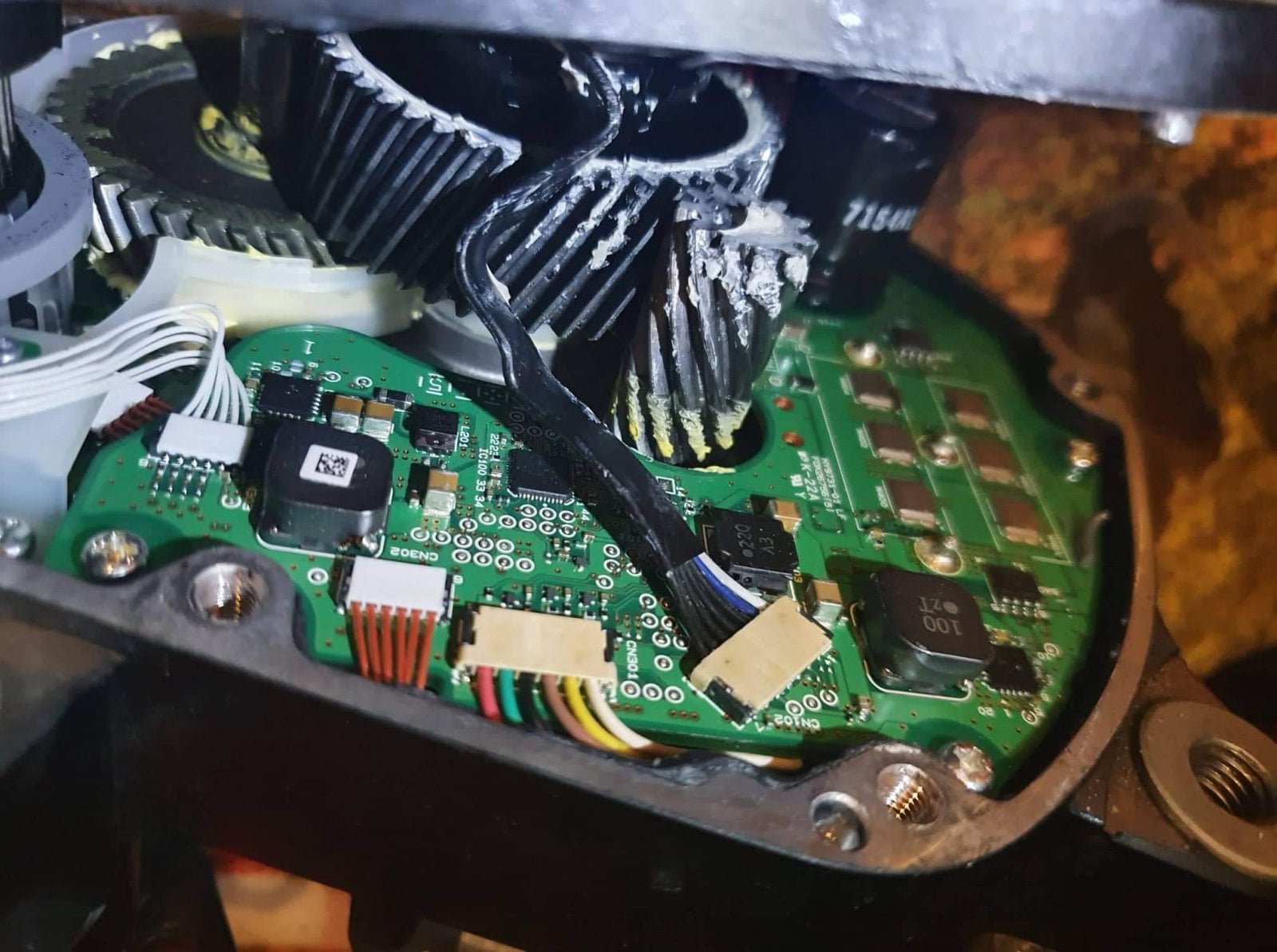

Our only avenue left to check is to open the motor and examine the electrical connections there. I removed the cranks and set about loosening all the torx screws around the motor on the battery lead connection side. Off course all but one one loosened for me, so now I have the added frustration of a screw head that may be rounded beyond opening. I am really starting to despair with this product, any help would be greatly appreciated as usual.

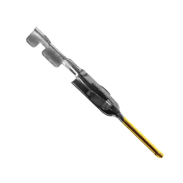

Ok so I got my new pins overnight from half way across Canada. For you that would be about 14 countries away. LOL. Anyways its a 26GAW not a 24GAW wire so even though my pin size was right my existing connection hole for the main part of the connector was to small. So I just drilled it out to about .002" undersize and it pressed in fine. I tapped the whole harness inside of the connector it will help keep those pins from pushing in. I crimped the wire after stripping it and also applied solder. I hooked it back up to the bike and viola bike is running again. So I will look up the right number tonight for all your guys plate connections now I know the right size. It read fine across the flats but it didn't account for the diagonal as the connector is rectangular after the pin. Which meant my part would have been fine had the original been a square but it was not. Regardless it still works well.
lastly I will use some q-tips and silicone and make a seal around the edge of the plate. I am going to source another connector plate for the motor and thread on connector for the battery harness. I just need the right size. Not only will it never come apart unless unscrewed but also it will never break a pin putting the battery harness back on the motor as God intended. Shame on Shimano for putting such a cheap as S&^t connector in a vital spot. Trust me I won't leave you all in the lurch I will get you the pin you can use now and the new connection later. I will have to read a lot of part numbers though to get what I want, but if you can solder the basics and have patience its easily doable.
Ho, ho, ho that sounds great -PLEASE tell me you too some photos of the process that you can post on here....
ART: A34239CT-ND MFG : TE Connectivity AMP Connectors (VA) / 5-104505-4 DESC: CONN PIN 22-26AWG CRIMP GOLD pin size is .027" (.66mm). Order your parts from DIGI KEY.
But you want one with a smaller body or you will have to drill out your pinhole on the plate mount to .078" in order for the body to fit proper. Like I said the wire is 26GAW and the body is roughly .037" x .044". That will help narrow your search. Owning a set of vernier sure helps to measure with.
Like I said I can get you the right number but they literally have thousands to choose from and it will take time to get the right one. Mine worked fine because I knew I could easily modify it to make it fit. I will look for you when I have time. When you order, order 10. They are .61 cents each. Better to have extra doing nothing than the one you wreck and no more to use. Putting everything back together was a giant pain in the butt. You can download a complete parts breakdown from Norco for every bolt and part and where they go to help guide you if you get lost. If you cannot find it then email Norco support and they will send you a PDF or your local Norco bike store can get it for you.

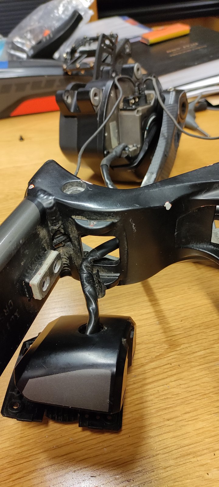

Make sure you have a heavy gauge wire and run it into the main body of the bike from the power button hole down the tube of the bike frame. You will then need to electrical tape the connector for the "power on" button to that cable and pull it out as your pushing the battery back in or it will not show up on the other end, and there is just enough cable to just make it to the top of the power buttonhole. (Thanks Shimano A-h&$@s) Use a set of needle-nose pliers to hold the connector while you remove the tape and plug in the power button connector right away in case it falls back inside. The power button cable MUST be tapped to the side of the battery that faces the top of the frame before insertion to keep it from binding up or slipping backward. tape to the top side ONLY. If you tape to the sides of the battery it will start to peel off and jam it up. There is literally no room for anything extra on the sides.
When sliding the battery back inside please make sure that the brake lines and cable that run inside the frame are not stacking on each other. There is just enough room under the battery for one cable high otherwise the battery will start to bind going in the tube. That is not good. Very hard to get out. As your nearing the 2 holes in the frame for the mount plate and bolts to secure the top side of the battery or the side nearest the top of the frame. Push slowly as it needs to line up to be exact and it's tough to move the battery around using the harness that comes off the end of the battery as it's the only way to move it as there is nothing else to grab. If the battery is not sliding in "STOP" pull it out and check everything to make sure it's all in there flat. DO NOT rubber tap the battery into the frame. If it gets stuck your SOL. I went to our service department and got 7 rubber o'rings @ .357" inside diameter with a 1/8" cross-section and placed them behind the battery mount plates around the plastic molding where the bolt zerqs are molded into each end of the battery frame. It fits perfectly. That way I create a crush seal between the battery and the plate so no water can get in via the bolt zerqs into the battery itself. I also spent time using electrical tape to wrap right up to the connectors on exposed wires. SHAME SHIMANO, SHAME.
When mounting the motor make sure the 2 connectors that go to the plug for charging the battery are off to one side each. Also make sure you plug in the computer connector and speed sensor connector FIRST as you won't be able once the motor is installed. Watch these cables closely as your moving the motor down, they seem to have about 10 extra feet to them that can get jammed under the motor and crushed. Mount the 2 front bolts into the frame and motor first and keep checking for binding and wiggle the wires to make sure you have them to the sides as to not crush them as you start to rotate the motor down for the to rear bolt holes. If that is OK then rotate the motor backwards into the 2 rear clamp hole position and bolt those up. Sometimes you have to use a rubber mallet to get this part down in the frame. JUST MAKE SURE the wires are moving freely before doing so. Once you have that done then the rest is simple.

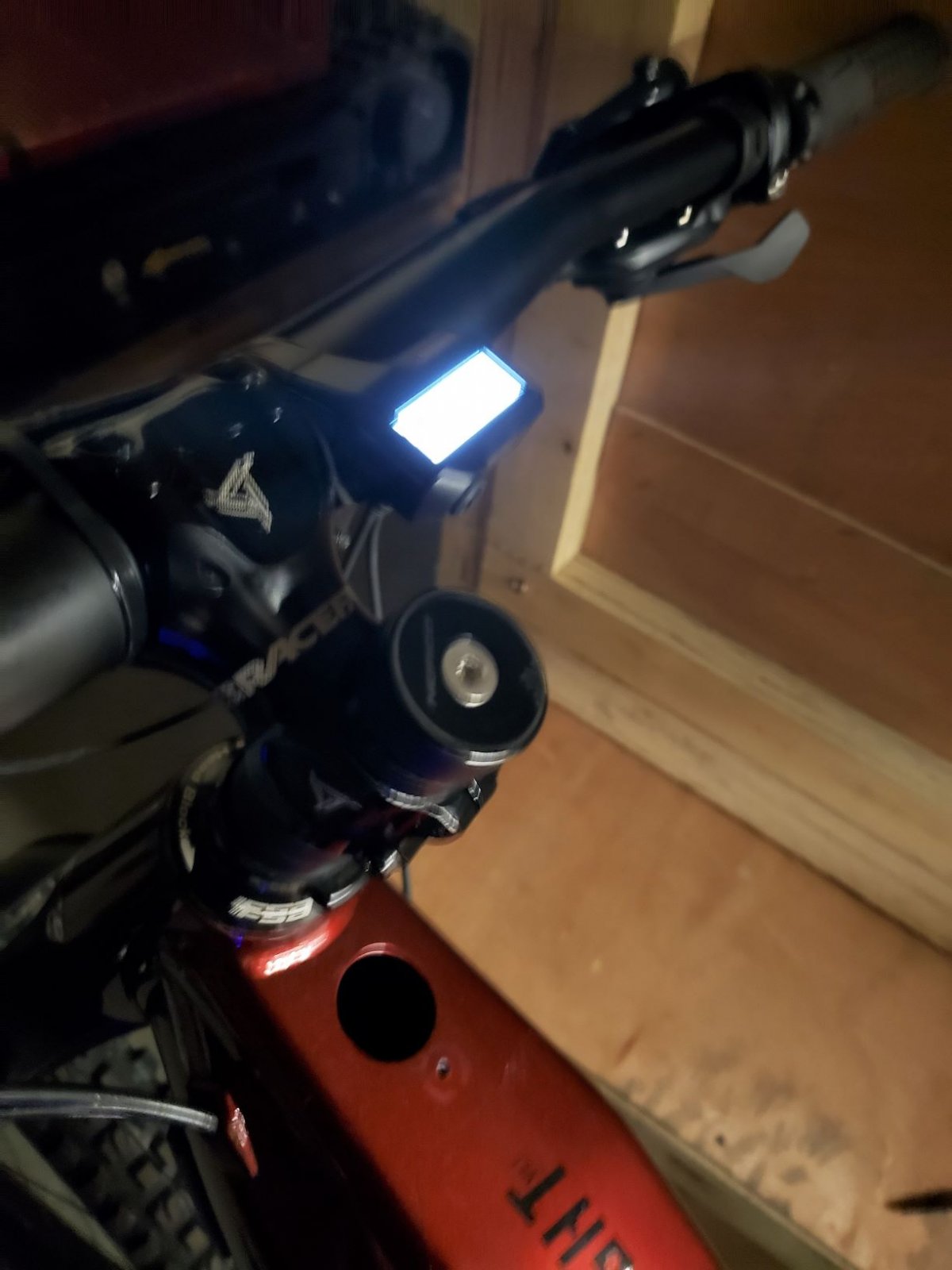

YOU SHOULD ALWAYS plug all connectors in with the motor and battery as well as the front computer connector and the rear speed sensor BEFORE BOLTING EVERYTHING BACKUP. If you have done it right the computer will kick on and stay on. Use E-connect on your phone to do a quick diagnosis to make sure all components are fine as it checks when you connect to it via Bluetooth. The rest is general bike knowledge.
Here is a pic with the computer on. This was me testing everything BEFORE REINSTALLING it all.

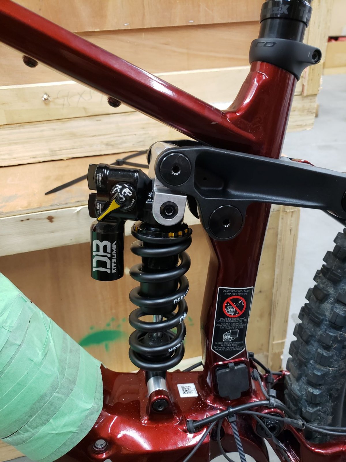

One last thing. I bought a Cane Creek DB Kitsuma coil. The Coil is 2.25 x 650lbs. NOW IT WILL NOT Install on your bike because it hits the frame with the existing trunnion. So I made a whole new set of bottom mount slide thru pins and a reverse trunnion to rotate the shock right side up. If you do not understand how this was made from the photo you won't be able to make one. You also need to grind in about a 1" diameter groove on front and back of trunnion that mounts to the top of shock side to clear weird mould extrusions. The grooves are at 45 deg right in the middle. MAN is this thing plush. Just showing you so you know it can be done, and you will get to have high and low speed compression adjustment as well as high and low speed rebound adjustment. PLUS your lockout is right at the top so easy to reach. Any machinist will look at this and know what I have done. I kept the existing top bolts and inside bearing slip sleeves to sit against the bearing races so there is no binding. And the bottom is just a pin rotation but with just the thru pin and I got rid of the slip on sleeve from the trunnion. The clearance is 1.875" side to side so I made them .93" long and stepped the OD down on each side to fit into the top of the shock to act as a bearing sleeve for the pin to pass thru. Make sure you have about a 1-2 degree max over rotation so the shock will always want to push backwards to the bike tube. This makes the double rotation points work as it cannot go back any further and pushes straight up and down on the shock. It will never rotate forward plus its tightened with loctite pretty tight. It isn't moving anywhere and downward force is straight down.
I had already ordered my shock so once it arrived we discovered it wouldnt fit and I fixed it. The offset on the existing trunion is 1.25" so if you ordered in a 215mm regular shock with pin pin connection you could buy the mount pins from Cane creek themselves as they have huge lists of mounts. You just need to know your bolt sizes and spacing needs. the top is 1.890" or 48mm and the bottom is 1.875" or 47.625mm so a 47.5mm would work fine. Rememeber if your going to go pin to pin which in my opinion should not interfere make sure you know your mount bolt sizes so you do not have to mod your frame in case for whatever reason you wanted to sell the bike with the old shock on it and keep the $1000 shock for yourself. (converted into Canadian pesos)

Michael has opened the motor and checked all the connections, everything is clean and seems in order. Why is the bike not turning on?
Battery is putting out 36volts, and the signal wire is bringing 7.9 volts to the new handlebar computer. What are we missing here?
