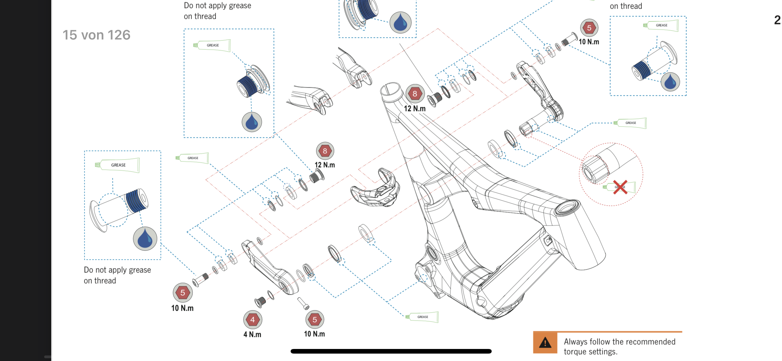

Part # 1: Orbea Rise - Upper Linkage Axle and Bearing Service
Thanks very much, followed your guide to do my 1st upper linkage service. The link to the video for frame bearing replacement, do you know if that tool fits the rise M series?
Cornish,
Pivot bearing press and extractor kits come with various adapters in which to "Push" the bearing out of the bore or "Press" the bearing into the bore. Some kits work much better than others. I've found that when it comes to pivot bearing tools, it's best to go good quality and not budget if possible.
In this message I will list several kits which will work on the Rise. I cannot name them all, but know there are many good quality bearing press and extraction tool kits available. I've included a Rise bearing chart so that you can insure the kit you purchase will work with the linkage/pivot bearings on the Rise.
I re-read the thread and there are two companies I've mentioned in the thread. They are "RRP", seen in the opening page video and "Session" farther down in the thread. I will explain their use but first allow me to go into a bit more detail in case others would like to know further on how to use a bearing press.
Bearing press and extractor kits come in various forms. There is the universal bearing press tool that can be used to install various types of bearings on a bicycle, i.e. pivot, bottom bracket, headset, and wheel hub bearings. Pictured is the Wheels Manufacturing, Press-7 tool which I have and occasionally use to press in wheel hub, bottom bracket and frame pivot bearings.
This tool can be used to insert pivot bearings in the Rise frame. Use the correct size shoulder on the adapter which corresponds with the inner diameter bearing bore. Place the pivot bearing on the adapter's shoulder. Insert the threaded rod through the adapters and bearings. Install the threaded T-handle on each end of the threaded rod. Insure the bearings are aligned correctly with each bore hole and are not going in crooked. Slowly tighten the handles. Insure the bearings are gong in straight. Keep turning the handles until the pivot bearings are fully inserted inside their bores.

Jene, my linkage would do the exact same thing. I would lubricate the pivot axles (Both upper and Lower and the creaking/clicking noise would eventually return after only a month or so.
I eventually realized the noise was cause by the linkage arms slipping on the upper pivot axle spline. Once the linkage arms loosened on the axle splines, free play and excessive "Pre-Load" would occur in the upper linkage assembly. The free play creates sloppiness in the rear end and allows the axle to shift side to side across the steel bearings. This creates the noise you are hearing.
Note: Correct linkage arm "Pre-Load" is critical on the Rise. This is the reason Orbea provides the purple "Pre-Load" tool with the bike when it is purchased. If the correct "Pre-Load" is not maintained, noise will occur and the rear end on the bike will become loose and sloppy.
The only way to stop the linkage arms from shifting on the upper pivot axle splines is to use a cylindrical retaining compound such as Loctite 638. The next time you take the linkage arms off of the upper pivot to set the correct pre-load, apply a small amount of Loctite 638 to the axle's splines and the splined linkage arm interface. This will eliminate the noise.
It looks like Orbea was aware of the issues with the upper pivot axle loosening up on the axle splines. From the picture, it looks like the 2023 model linkage arm assembly and axle have been redesigned and also feature a small tool carrier. From the picture, it also looks like Orbea may possibly be using seals on the upper pivot axle. I hope this is so.
It does make you wonder if it's possible to retro fit a 2022 model with the 2023 linkage arms and axle?
