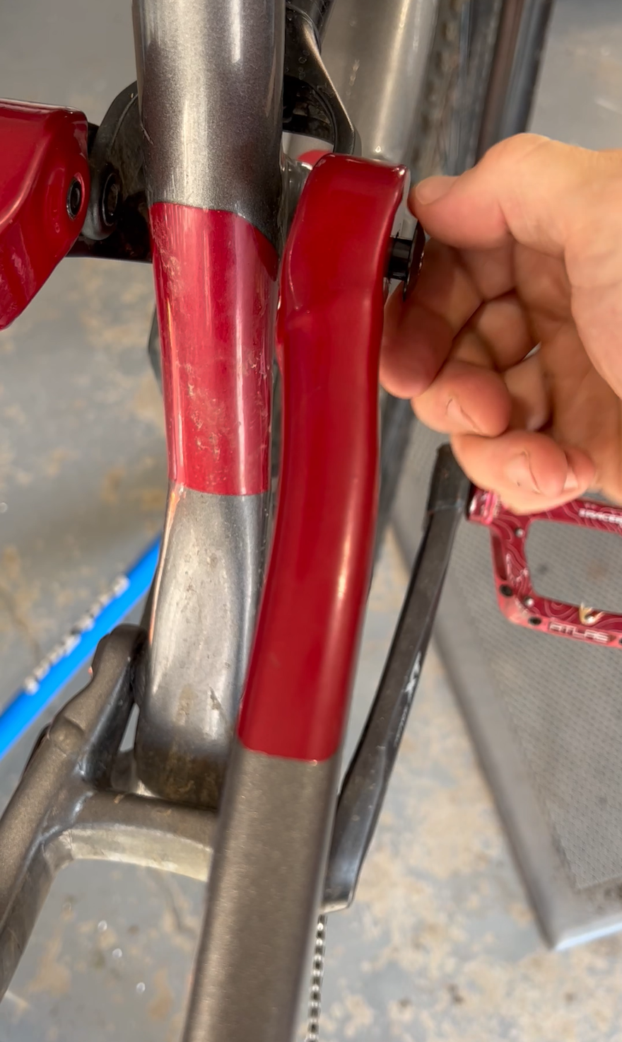

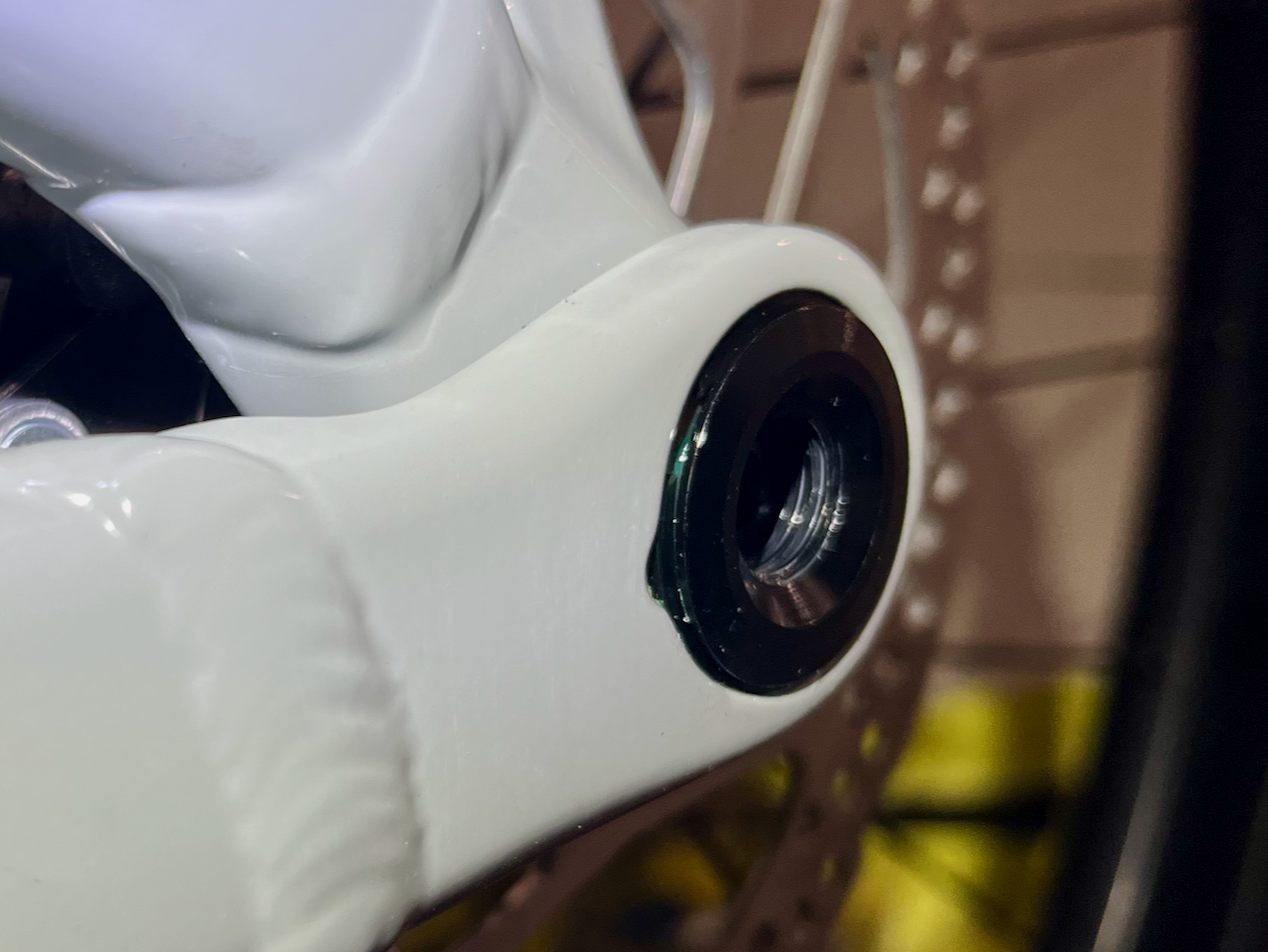

I'm happy you found the post useful. My experience with the paint damage around the upper and lower pivot axles was similar to your Rise. Orbea never sealed these areas or protected them. Because of this, small pebbles, dirt and sand can work into the these areas and damage the paint. I used to have a Yeti SB130 and it had a similar issue. Some manufacturers do a better job than others at providing frame protection.
I had not heard of Enduro, solid lube bearings, thank you for letting me know about them. I think they are an excellent suggestion, especially for those riding areas where a lot of moisture or a lot of dust exists. I owned my Rise for 18 months and it had 3,200 miles on it when I sold it to my brother. Before selling it, I replaced the linkage arm bearings for the first time. On the other hand, I replaced the two lower and two upper pivot axle bearings three times in 18 months of riding. I would definitely use Enduro Solid Lube bearings for the axle bearings.
Regarding the seal rings offered for use on the 2023 Rise. I have looked into their use on 2020/2022 Rises. I have not had the opportunity to look at a 2023 Rise out on the trails. If I can find one, I'll be able to know if it'll work.
Here's the issue I'm concerned about. The pivot axle diameter is the same on older Rises and the new 2023 Rise. This means the seal would slip over the older style pivot axle. What I'm concerned about is the clearance between the linkage arm and frame on the older models. As you've noted, the paint around the areas where the pivot bearings mount gets pretty chewed up. If we were to wedge a pivot axle seal between the linkage arm and frame, I would be worried this could cause paint damage from the seal rubbing on the frame and eventually lead to carbon fiber damage. I don't know this would actually happen, however it's a concern.
If somebody reading this has the new 2023 Rise. Please take some detailed pictures of the linkage arm assembly and upper pivot axle area and post them to this thread. I would appreciate it.

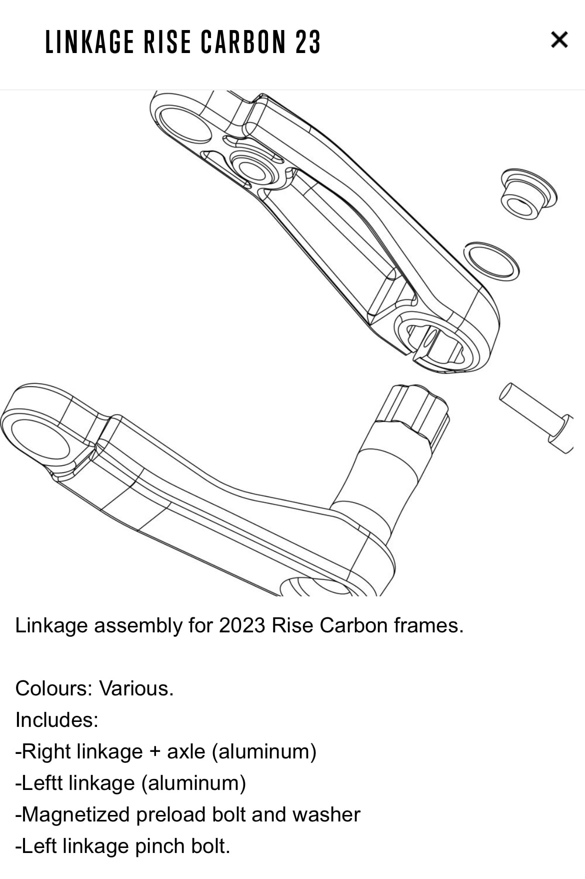

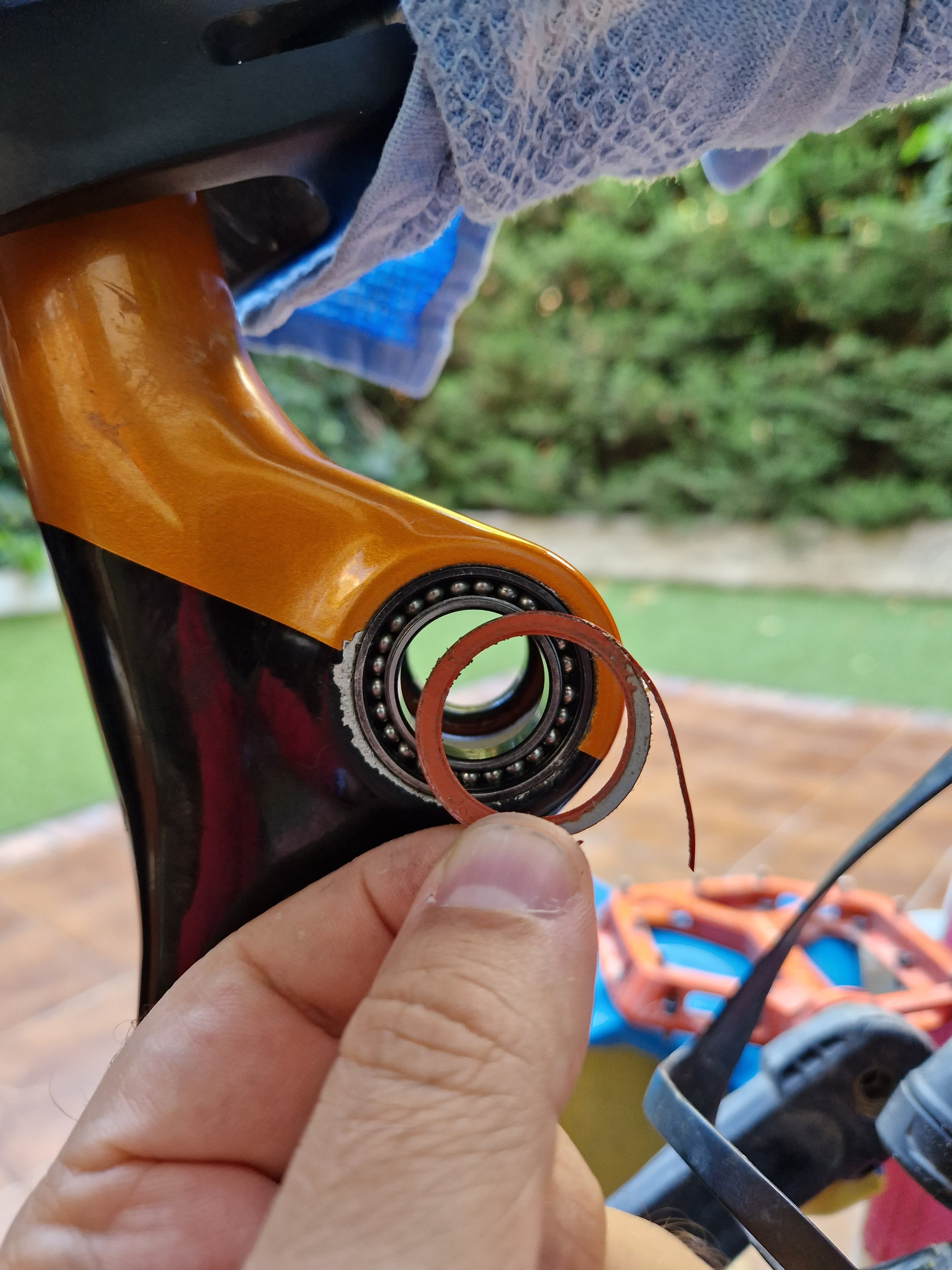

Hello again colleagues,
Thanks for taking the time to write such quality answers Rod!

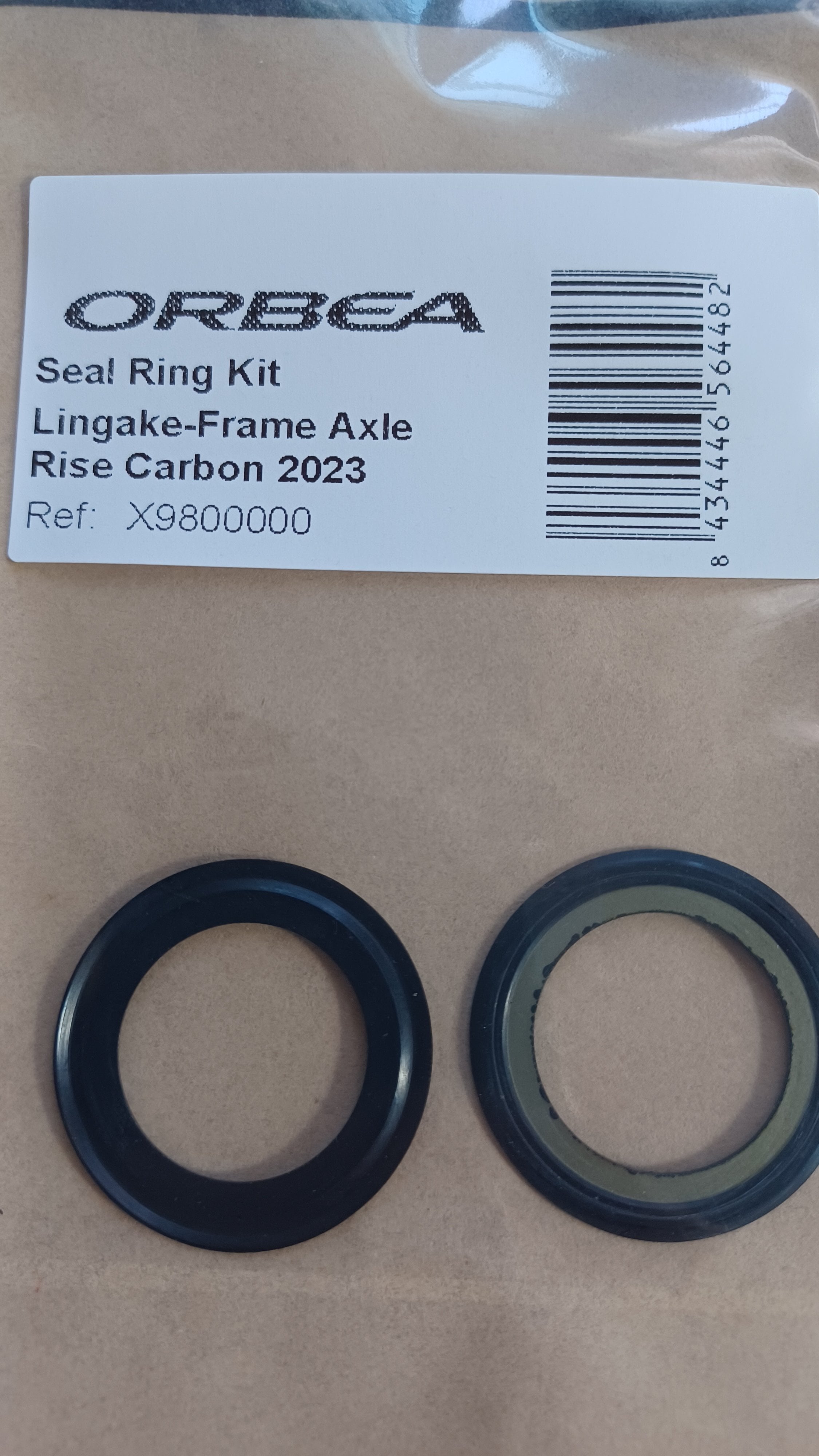

Regarging enduro bearings, I am not able to find the 6804 LLU MAX BO SL (solid lube) in my country yet.
On the seal ring kit, I decided to order the 2023 carbon kit. I will report back if it fits 2022 hydro model next time I inspect and clean my linkage-frame axle!
So far I have positive expectations since outer diameter is 30mm (hence it won't damage the paint in the frame, since it is just barely covering the bearing outer diameter, 32mm) and it seems quite thin (1mm maybe?, on each side of the axle).
In my view it will protect the red rubber bearing seal (precisely what I have seen to be one of the weak points in my bike).
Small pebbles and sand would eventually still be trapped between frame and linkage arm as without the new seals (hence still eroding the paint work). But bearings might have one additional extra layer of protection avoiding red rubber seal becoming damaged so easily.
I hope to confirm feasibility for 22 hydros of this initiative later!

I'm interested to hear how this fits. Pay attention to how much contact you get on the axle splines with the linkages. I'm not sure if 1 mm less will make much of a difference, bit it is still less contact. The bearings could do with more axle interface to start with.
I'm still keen to find out if the new linkages and axle fit the older models.

I've had another thought... how will this work for linkage spacing? The linkages have to connect to the yoke and the seat stays. I'm wondering if the different spacing will make this possible. 🤔
Has someone tryed to Retrofit this into a older H Model ?
For me it would be enough if the O-Rings would fit.

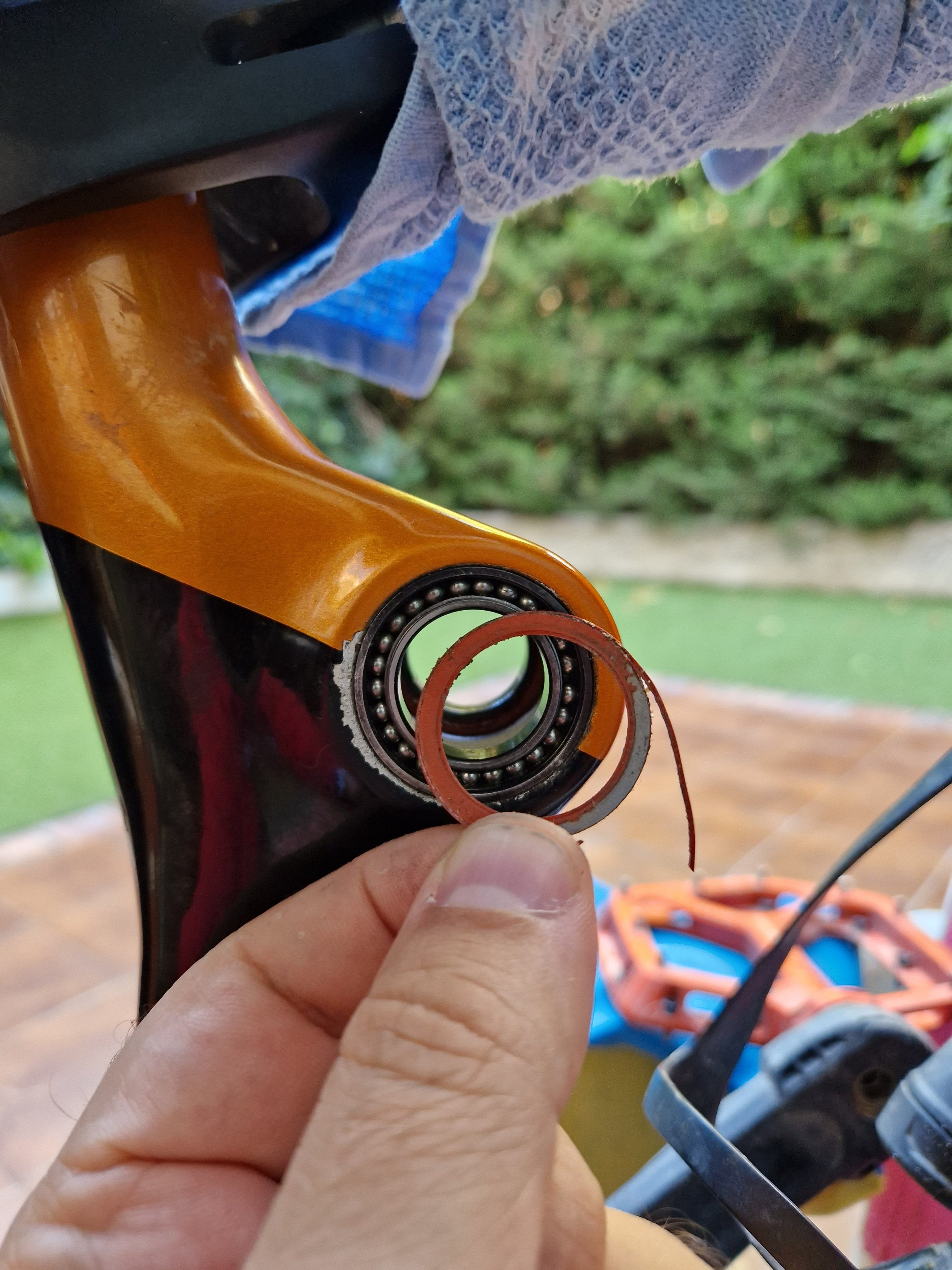

Last ride, had a hell of a rattle develop. Thought shock bushings at first but it was a definite rattle rather than a knocking.
Stripped it all down earlier in the week and found pretty much all the bearings needing either regreasing or replacing. Some of them notchy and some of them have noticeable play after regreasing everything.
Knocked out the upper linkage axle and cleaned everything up. It had been assembled dry (no grease or loctite).
I planned to use a retaining compound to tighten things up a bit but on reassembly, torqued to 15nM, the left hand rocker doesn't grip the axle even slightly. Can't preload anything as the axle just pulls out of the rocker.

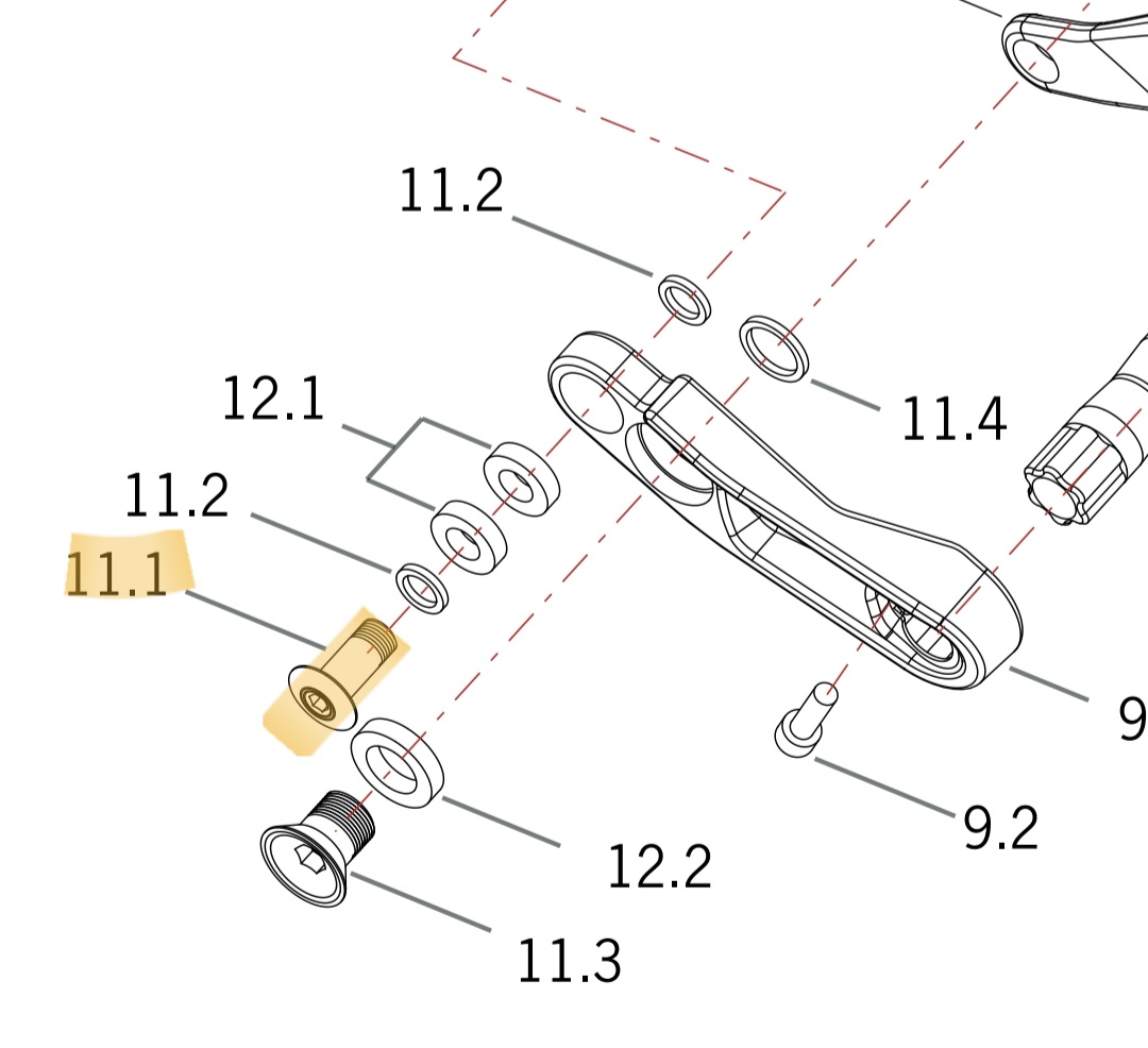

Has anyone that's been through bearing replacement or maintenance had issues getting the rear end back together?
Embarrassingly, I'm having a real hard time getting bt 11.1 back in.
It almost seems as though the seat stay section is twisted. If I assembly the linkage end first, it goes together easily but I can't get the seat stay/ chain stay aligned.
If I do the drop out end first, the linkage end doesn't seem to align properly. The spacers that sit wither side of the bearing are in the right place.
Is it bent? Or am I inept? Place your bets...

It can be a pain in the ass to get everything to line up. I had the same issue with my Rise. It seemed that the linkage on my Rise got a bit harder to line up as I piled miles on the bike. I know of other Rise owners such as Florida Dan who owns a Rise Hydro. Dan had issues with lining the linkage up and threading the hardware into place. Dan may be able to help you out.
Here's what I found:
1) It helps to disconnect the rear shock from the yoke and get the shock completely out of the way. This takes weight off the linkage arms while you try to align and assemble everything.
2) Do not fully tighten a linkage arm hardware bolt until all of the linkage arm bolts have been threaded into place.
3) Leave the lower portion of the seat stay and rear axle assemblies disconnected from each other. This will take pressure off of the upper part of the seat stays and make it easier to align and bolt them to the linkage arms. You want to avoid cross threading the nut built into the seat stay. If you do damage or cross thread the nut built into the top of the carbon fiber seat stay, it's going to cost you more than a few pounds to replace. The lower axle parts are relatively cheap to replace. If your going to damage anything, do it to the axle drop outs and not the upper seat stay.
4) I use a dab of extremely thick and tacky grease, i.e. wheel bearing grease or similar, to hold the linkage arm spacers in place. The thick grease will help keep the spacers in place when lowering the seat stay onto the linkage arm.
5) After lowering the seat stay over the spacers and onto the linkage arm, I use a long tapered punch to help push the spacers into alignment with the bore. I use a bright LED Flashlight which I shine into the bore to make sure everything is aligned. I will only insert the bolt into the bore and attempt to thread into place, after making sure everything is aligned. The goal here is to avoid cross threading and damaging the seat stay.
Note: When my Rise was new, I didn't have any alignment issues and everything went together smoothly. However, by the time I reached 3,200 miles - 5,100 Km, it was taking a bit more effort to get everything to align and thread together. My guess is that the seat stays or linkage is developing play, distorting, warping, chose your word, and alignment isn't as precise as when new.

I really struggled with this. I thought I had stripped the front of the bolt so that I could’t get the thread started. Rod was kind enough to send me a couple of extra bolts he had onhand, and I also ordered the kit from Orbea.
In the end, after literally hours of struggling with it, I found I could just barely get the bolt threaded by bracing the chain stay against my body, and twisting the rear end of the bike by putting opposite pressure on the seat tube.
My issue was the non drive side, so it was body against chain stay, right hand on the top of the seat tube, thread bolt with left hand.
And then I discovered I had left the shock assembly above the linkage arms, so I had to take it all apart again!!! I don’t look forward to having to service these linkages…
Exact same issue on the non-drive side seat stay on my rise from new. I've found I have to twist the top of the stay inward to get the bolt to align. It frustrated the shit out of me the first time. Now I just treat it as a part of the service.

I managed to get it done last night after Rod also mentioned that it's a bit of a pig to get back together.
I had tried bending and twisting section of the frame but gave yo because it was starting G to damage the threads.
In the end, I took the whole linkage apart and started from scratch.
I fitted the left hand linkage and the linkage axle first. Then got the linkage end of the seat stay bolted up. Then the non drive side of the rear axle assembly (it's a ball ache to get the notch if the threaded insert to align with the lug on the seat stay. I ended up deliberately misaligning it and winding the rear axle in from the outside of the insert) This let me then rotate the insert on the bearing until the seat stay popped on).
Next, I fitted the right hand linkage arm on the pivot axle, set the preload and torqued the pinch bolt.
Next up, bolted up the drive side seat stay to the right hand linkage arm. Followed by the derailleur hanger and axle assembly on the drive side.
Once the rear triangle was loosely together, I bolted up the shock yoke and went over all the bolts for final tightening.
Massive pain in the butt.
My solution: loosened up the rear axle, shock extender bolts on both sides, and front shock bolt. This gave me enough play in the rear triangle and linkages that applying significant force on the seat stay hex while rotating caused it to align the bolt threads with the threads in the end of the seatstay. What a PITA.

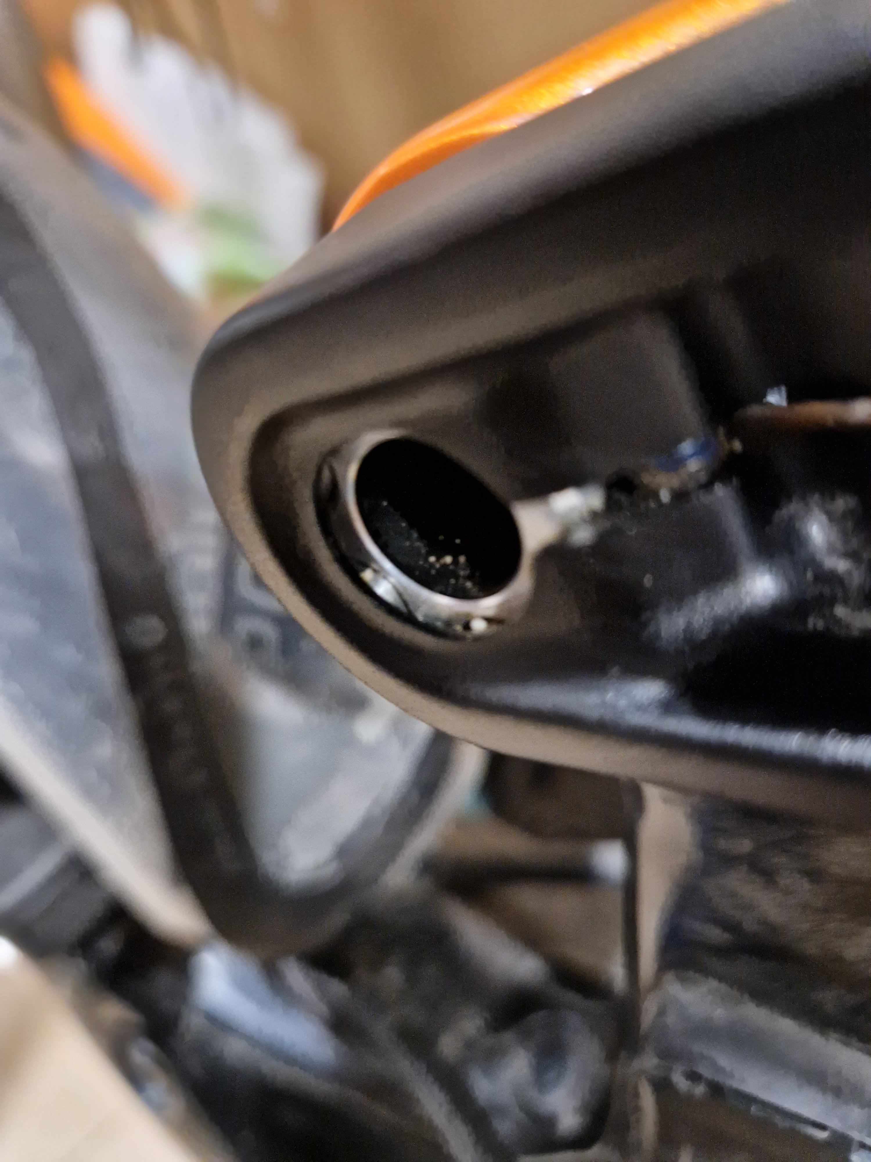

Hi Murphius, I think i'm running into the same issue. I'm trying to disassemble my bike so that I can clean then apply fresh grease to all the bearings, per Rob's 2 part guide. I did this 6 months ago to solve a creaking issue that just returned this week. I was in the process of taking off the Seat Stay, and the bolt on the drive side is stuck spinning. It's completely out of the treaded side of the seat stay but something is preventing me from pulling it out. I suspect one of the washers (SEE picture) dropped down into the threads but no matter what I try I can't seem to get the bolt back in or remove it. I am hoping others have solutions because my nearest dealer is an hours drive from here and this shouldn't be this difficult!
Much appreciated,
Cheers

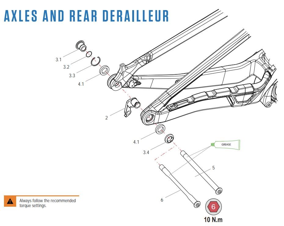

Ryno,
I had this happen on several occasions. You are correct, the spacer is catching on the threads. You will need to relieve pressure off of the seat stay in order to remove the bolt. To do this, you will need to do the following:
1) Remove the rear shock from the shock yoke. Wrap the shock in a rag when removing it. This will prevent it from chipping the paint should it drop down and hit the frame.
2) Remove the rear wheel.
3) Remove the rear axle drop out hardware and fully release both the right and left seat stays from the chain stays.
To remove the right, derailleur side, you need to pull out on the black castellated plastic retainer (Number 3.4 in the diagram) and turn it. This will release the derailleur hanger and the seat stay. The black plastic retainer may be stiff to turn. Do not use pliers to turn it. This will scratch and damage the retainer. Instead, hit the retainer with a shot of WD-40 and use a rag to grip the retainer to pull and turn.
The left, non-drive side (Number 3.1 in the diagram) is held in place with an "O" Ring located on the shoulder of 3.1. The "O" Ring presses into place and and holds the chain stay and seat stay together. To separate the seat stay from the chain stay, simply hold the chain stay in one hand and smack the seat stay in the opposite direction, with the palm of your hand. This will drive the two apart and the seat stay will separate from the chain stay.
NOTE: The left side bolting hardware (Number 3.1 in the diagram), has a notch on the bolt which insets into a notched indentation on the stay. When you reassemble the left side seat and chain stays, it's important that you align the notch on 3.1 with the notched indentation on the stay. if the notches are not aligned, you will have difficulty joining the two stays together and when you tighten the rear axle, it will cause damage to the stay. The purpose of the notch is to prevent the hardware from turning when you tighten the rear axle.
Doing the above will release all seat stay tension and allow you to manipulate the seat stay so you can remove the bolt.

Thanks for the very detailed response. After I posted my question earlier today with a fresh coffee in me, I tried what you just explained. I removed the rear wheel, the derailleur, the rear axl drop out hardware, and removed the rear shock. I was able to freely move the seat stays hoping this would allow me to relieve the pressure and get the bolt out, or at least back in so I can ride it, unfortunately this is not the case, It will not budge, I can't get it back into the treaded side of the seat stay either. I am thinking these bolts are aluminum and very soft and it's possible when I was trying to remove it the washer/spacer started striping the treads? It's really bizarre how it just freely spins but I can't remove it or put it back in. I also tried some of Florida Dan discribed where he pulled back in the seat post while applying pressure on the seat stay. This really shouldn't be this complicated :)
On a side note, now that I have the shock removed and the only parts of the linkage that is still together is the seat stays and the axl, I can clearly hear the creak is coming from the linkage axl, likely the splines, but unfortunately I can't get the bike apart or together now.

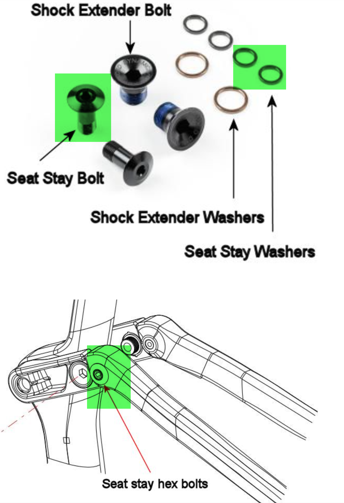

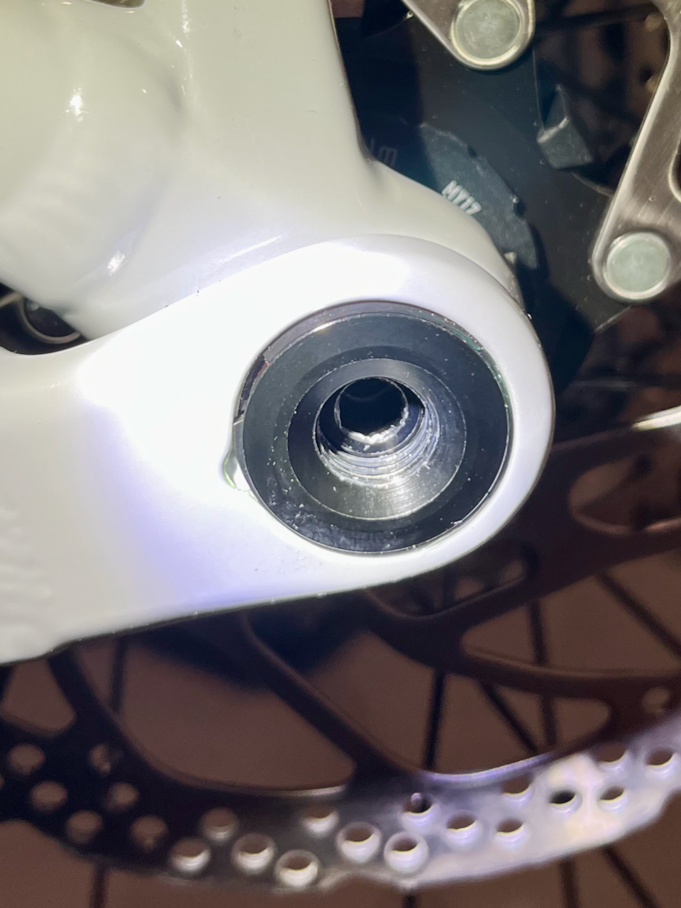

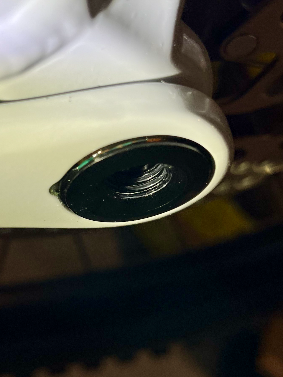

I heard vile rumors that Canadians are hard on their Orbea’s. I didn’t believe the rumors until now…
Well, I’m at a loss on this one. The linkage hardware bolts are soft aluminum. It really doesn’t take much to jack them up or deform them. Ask me how I know. Fortunately, you can buy a new set from Orbea. The down side is, it’ll take two to three weeks to get the parts. That’s been my experience for shipping to the USA.
I have some spare hardware which I’d be happy to send you, but unfortunately I’m in the process of remodeling my garage. I have all my bike parts buried in boxes at the back of a storage pod and I can’t get to anything right now. Maybe another subscriber reading this thread has a spare bolt and spacer they can send you asap?

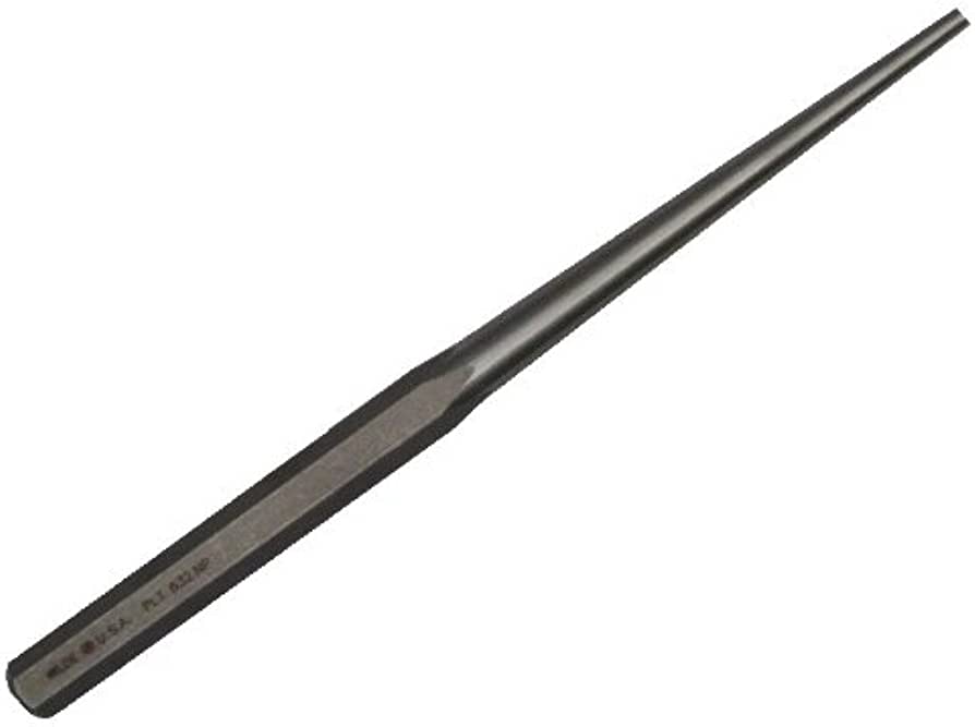

I think I would take a small magnet like the small ones mounted on the handle of small screwdrivers. I would see if I could get the magnet attached to the metal spacer and jiggle the spacer around enough to allow the bolt to slide out. If that didn’t work, I would take a long tapered drift punch and place it against the backside of the bolt. I would lightly tap the punch to see if this will free up the bolt enough to drive it out. It’s possible some blue thread locker or maybe a piece of galled up thread is preventing the bolt from extracting.
I would not try to re-thread the bolt back into the seat stay. Bolts are cheap, a stripped out chain stay is not.
Please keep me informed on what you come up with. You won’t be the last person to encounter this problem and it will help somebody else out when it happens to them.

Hello Risers:
Last Sat I finally found some time for my second maintenance on the linkage to inspect, regrease and tighten it.
First, let me show what small pebbles did in 3000km:
As you can see, paint in the frame is sanded, the bearing seal was ruined, and the bearing was totally dry.
I could only find a non-black oxide version of the bearing, and decided to keep existing one in the frame, but cleaned and regreased balls, replacing seal with a new one.
Finally I decided to mount the Carbon 23 ring seals to protect bearings.
+1mm separation between axle and linkage on each side seemed to work in the first 50km ride on Sunday.

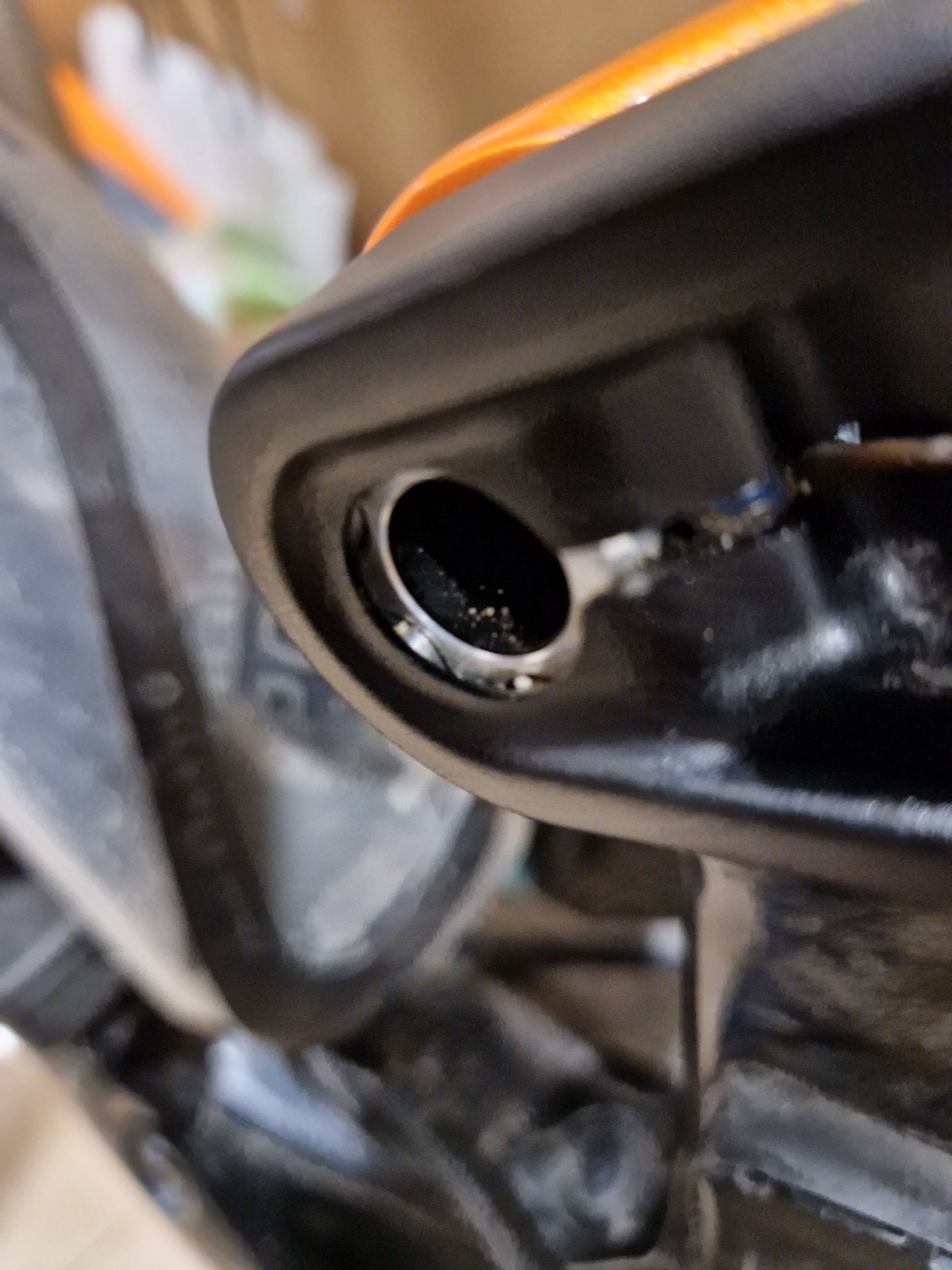

Now I'm a bit worried about the left chainstay / seatstay joint "bolt". There is a gap between the bolt and the chainstay, and the axle does not engage all the threads inside the bolt. I do not remember if that was the case before my intervention there. On the other hand, the axle seems to be seated properly on the right side. And the notch on the bolt is aligned properly with the seatstay.
How does it look on your bikes?
Disconnecting the chainstay and seatstay at the rear axle helped. They are definitely an issue with holes alignment / general geometry in the seatstay. It could be connected at both ends only with some torque applied. Applying this torque is easier at the chainstay / seatstay joint, so it should go last.
View attachment 133758View attachment 133759View attachment 133760
I'd love to tell you how line looks but I haven't seen it for weeks while it goes through the warranty process for a new motor.
I'm not convinced that's fully seated though. The little o ring on the bolt makes it a bugger to get in properly. The keyway makes it difficult enough but then just to make it that little bit harder, you've got to get the o ring seated into a groove...
To be fair, mines black so maybe the gap is there and isn't so noticeable but I'm pretty sure mine goes in flush to the seatstay.

N16BS,
The non-drive side (left) rear axle nut has an indentation and a small rubber "O" ring mounted on the shoulder of the axle nut.
The rear axle nut must be aligned with a small nub that is machined into the seat stay on alloy and carbon models. It's been a while since I've worked on the rear axle nut area on a Rise, but I believe the nub is on the seat stay. I may be wrong.
The purpose of the indentation on the axle nut and the seat stay nub is to lock the axle nut in place and prevent the axle nut from spinning when you tighten up the axle.
The axle nut indentation and the nub must be in alignment when you tighten up your axle. It's very easy for the two to fall out of alignment. This is especially so when working on the rear linkage and you separate the chain stay from the seat stay.
If the indentation in the axle nut and the nub are not in alignment and you tighten up the rear axle, you are essentially forcing the axle nut into the chain stay and past the nub. This will either buggering up or sheer off the nub. The misalignment will also cause the gap issue which you speak of.
The rubber "O" ring mounted on the axle nut is used to create a friction fit when the axle nut is inserted into the chain stay bearing. The "O" ring holds both the chain and seat stays together due to the friction. The "O" ring also keeps tension on the axle nut and tends to prevent the axle nut from rotating and throwing the indentation out of alignment with the nub.
As a side note, the small thin rubber "O" ring will begin to flatten out with time. This causes a loss of friction and the axle nut will easily pop out of position. This will also allow the chain stay and seat stay to separate. You'll know the "O" ring has begun to flatten out if you find that when you remove the rear axle and wheel, the chain stay and seat stay separate from each other. Yes....it's a mickey mouse set up...nothing against mickey mouse...jus sayin...
P.S. I have yet to disassemble a chain stay and seat stay assembly on a Rise and find the rear axle bearing is spinning smoothly. The rear axle bearings on the Rise are very thin. When the bearing is compressed/inserted into the chain stay bearing bore, it will warp the bearing and cause it to feel notchy and not spin freely. Unless the rear axle bearings are totally rusted out and frozen solid, I won't replace them. It's one of those things you learn to live with on the Rise.
I hope this helps with your situation,
Be safe,
Rod
