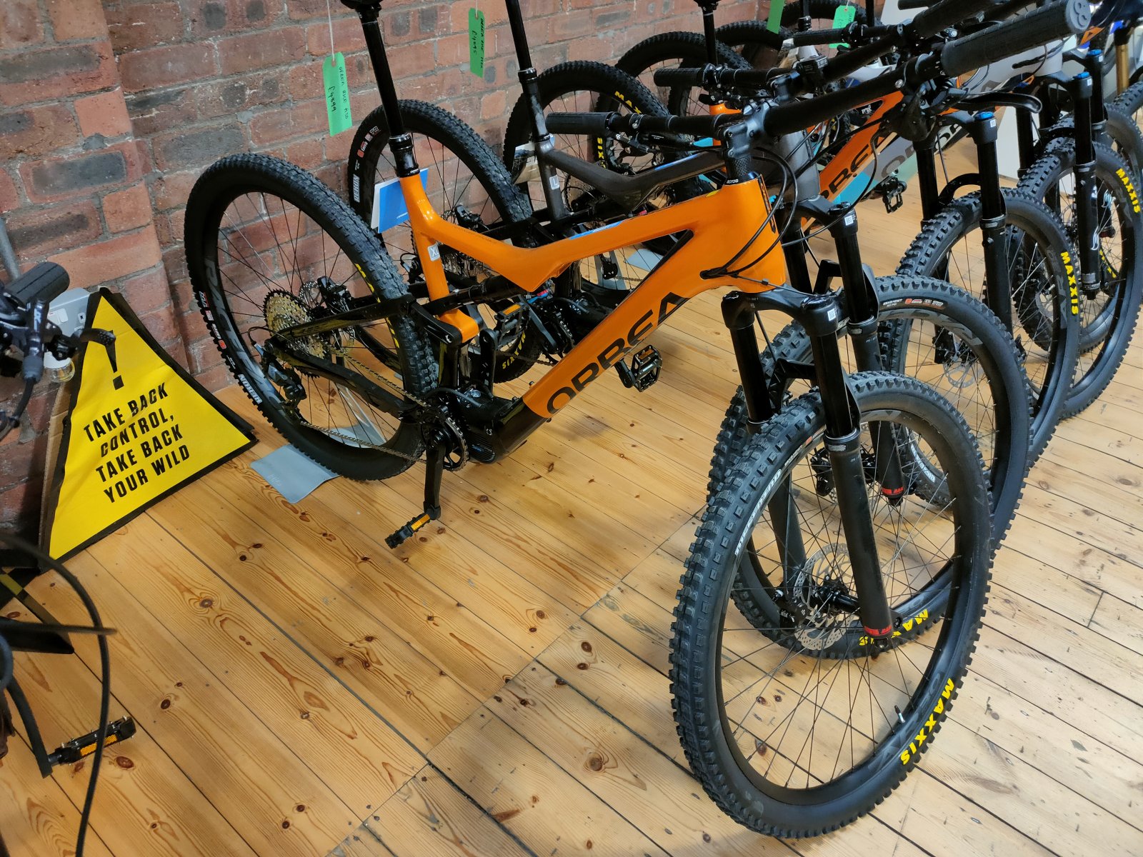

Here are the L (grey) and the XL (orange) side by side with the saddle about the right height for me.... The reach on the XL felt pretty comfortable too and the taller headtube.......
