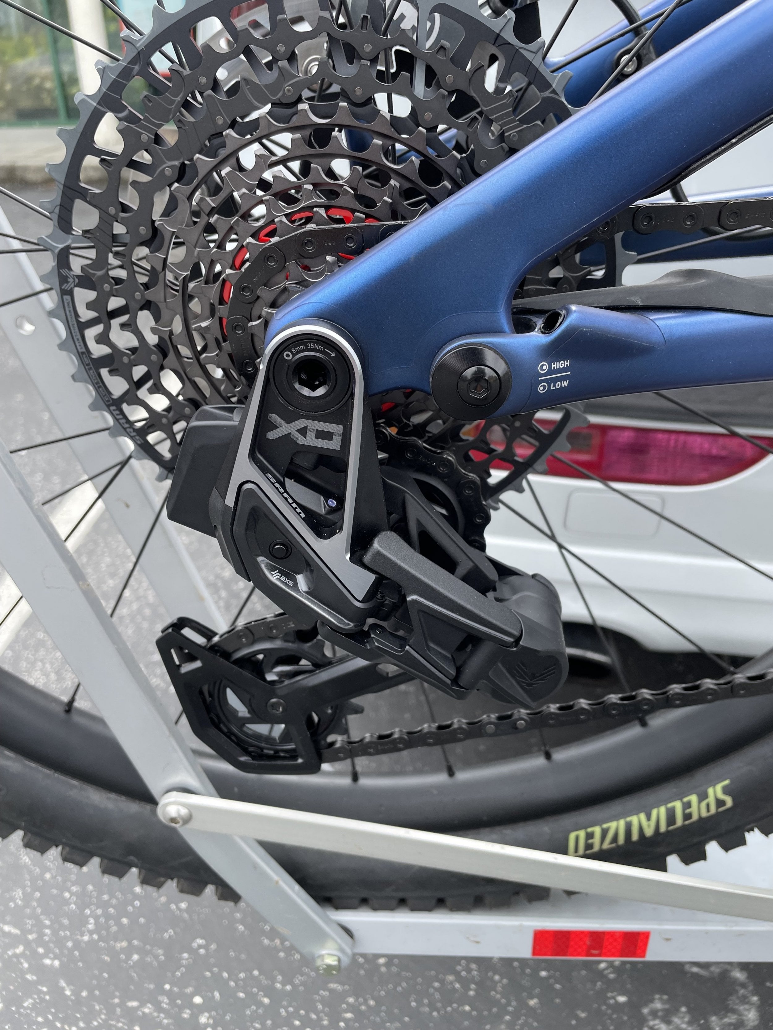

Put the new Transmission on my Levo. Can't tell you how nice it is. Ok Orbea, what's not to like? Seriously, it's really nice and super quiet. Biggest thing I notice is the solid shifting, and if it holds true that the hardware will hold up to abuse, then why would anyone not go with this set up when buying a new bike? That is if you are going wireless and spending the money. Not for everyone, but in CA we can ride year round. Not sure if this would hold true for the 6 month rider in snow climates.
I will be doing som tests with the XX cassette with T Type chain and GX AXS derailleur. Altough the new XX derailleur cant be mounted on the Rise the Cassette and T Type chain can. The chain is backwards compatible with the eagle systems. The cassette however can only be used with new T Type chain. The feature of shifting under load is not in the derailleur it is actually in the cassette. Its made in a way that the chain only derails on a specific point. So although we cant get the new derailleur installed Im going to test the cassette, T Type chain and GX AXS derailleur and post results. I already checked and the chain runs perfectly on the E thirteen chainring.

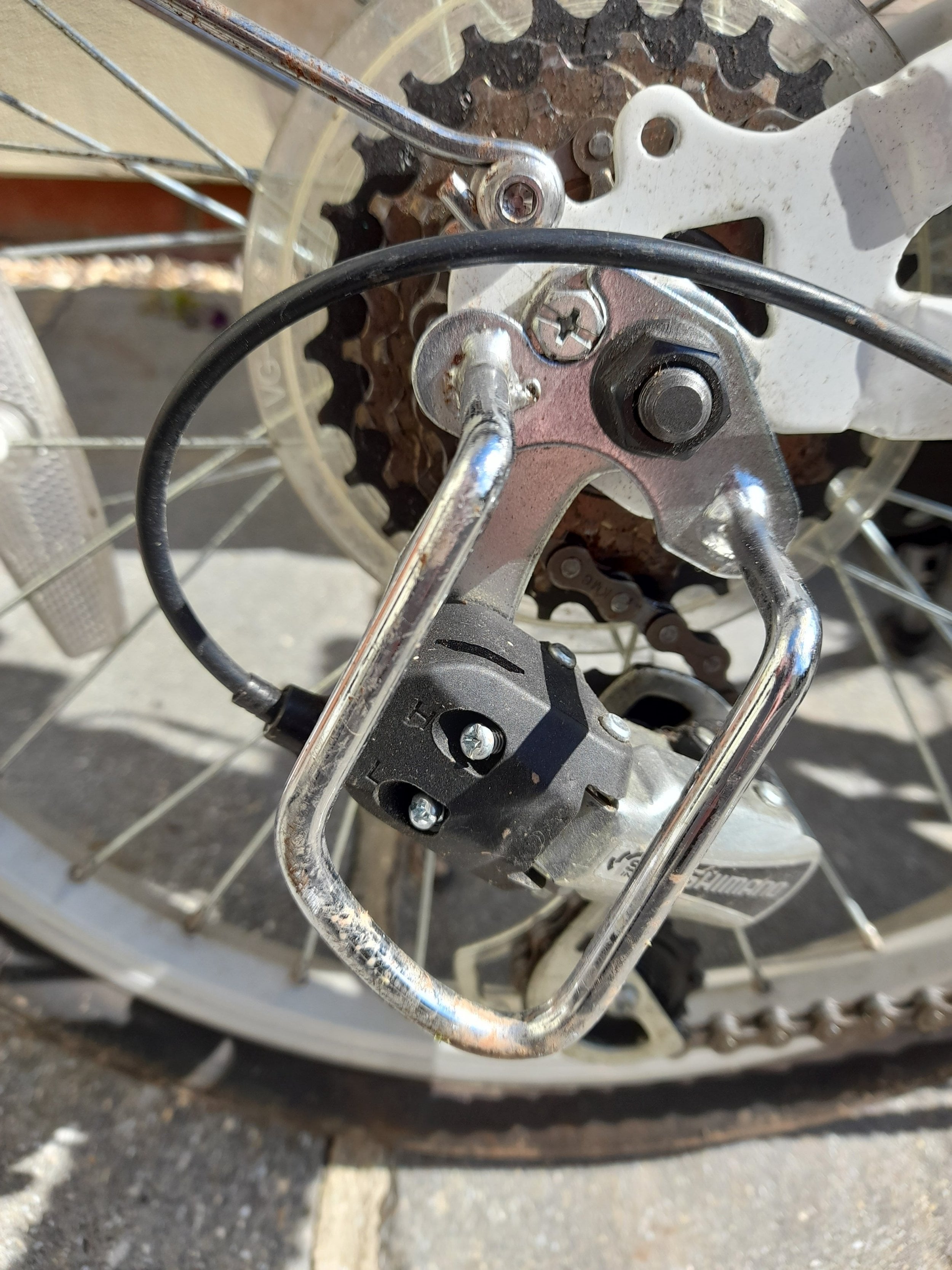

Well you can use this new invention to protect your derailleur ..........much cheaper as well! :ROFLMAO:
😅 Luckily (knock on wood) I have never had a derailleur or hanger bent. Where I do find a benefit is in being able to shift under full power on an Ebike. I have the Rise unlocked to full power and boy do chains hate when I shift under power... 🤣

just to be clear, the Rise will run conventional SRAM transmissions perfectly well, it just wont run the new T type, the existing XX, X0, GX systems do not use UDH so work perfectly. I have XX AXS transmission on my rise and its perfect and fits as you would expect on any bike.
Yes the old AXS Systems work, GX non T-type, X01 and XX1. The doubt here was if the new T-type Cassette and chain could be fitted to the rise to have the shifting under load advantage. In short yes it can be done and works using the old derailleur.
