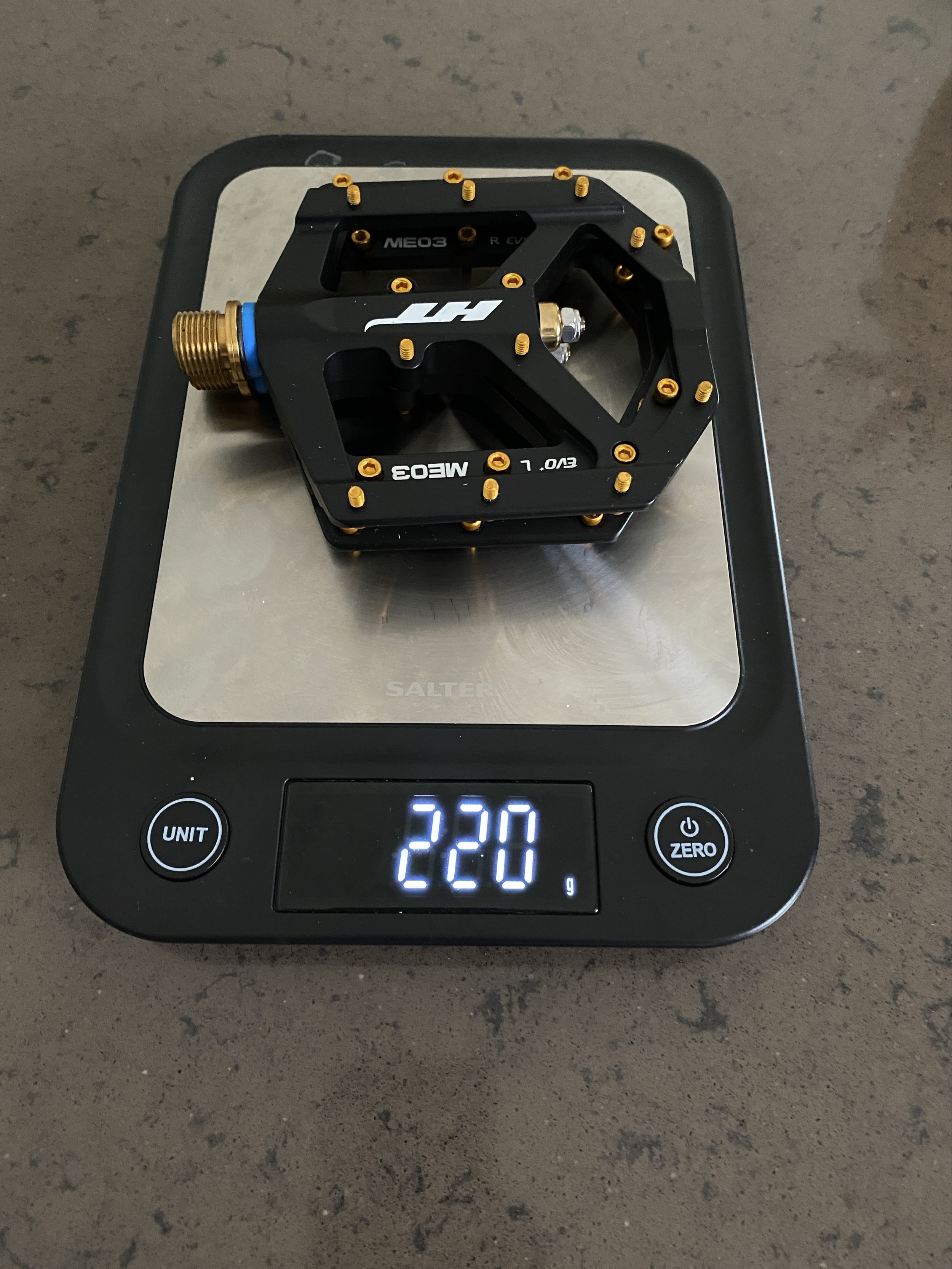

Thinner grips, switch to good composite pedals, experiment with lighter casing tires (if you're serious), good carbon wheel set, titanium bolts, etc. RockShox is lighter than Fox but you already have a Zeb.

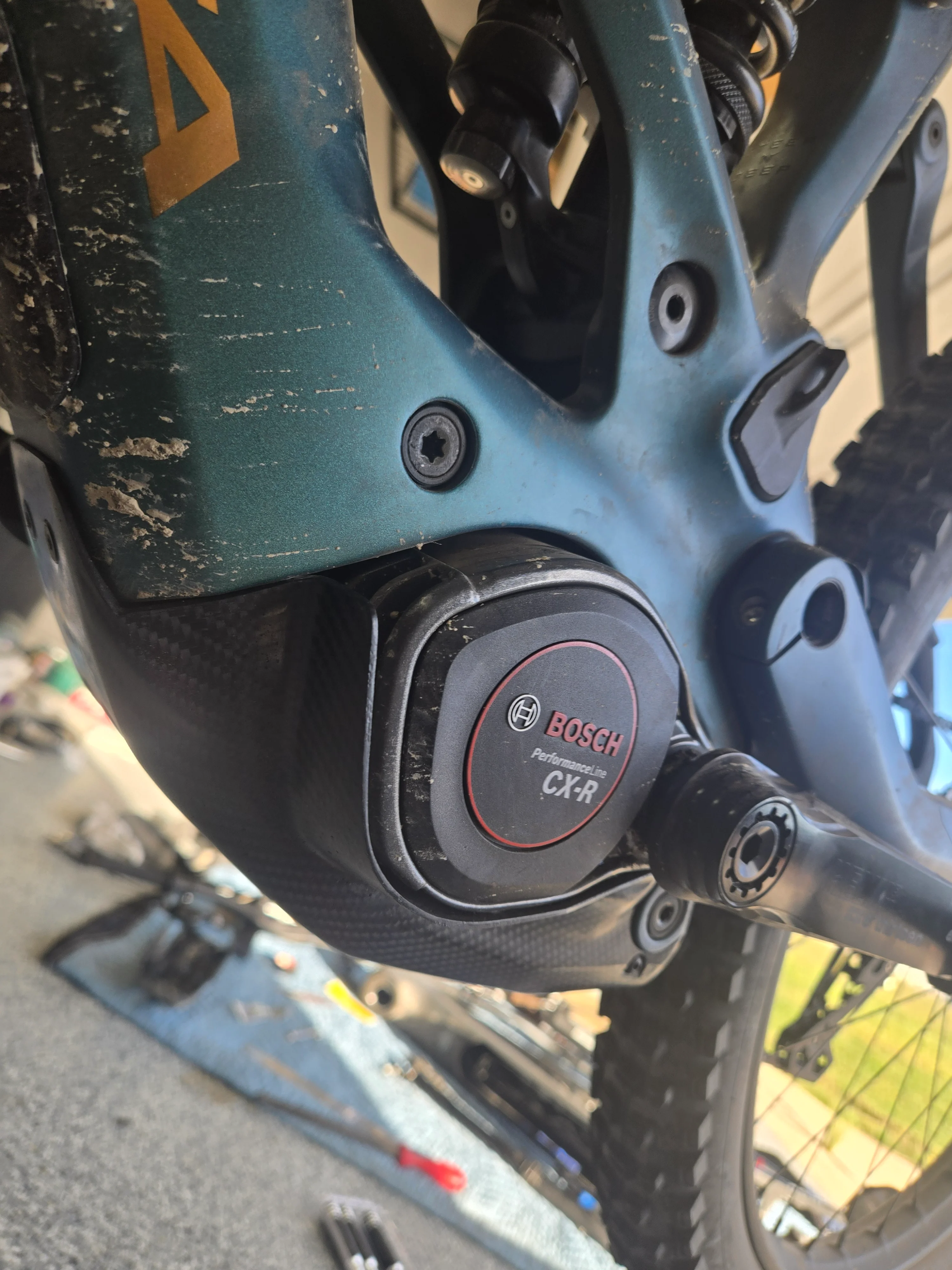

Here's one for Plums.
Wolfcarbon Bosch bash plate saves 46 grams.
My L Wild with dual coil, dual DH rims, dual DH tires, electric shifting & 200mm electronic dropper, pedals and sealant with 600wh battery is now at 48.6#s/ 22kgs.
Plums, you need to send me those Ti motor mounts. Add those and remove my sag indicator, slap some Ti hardware on it and I'll be under 48#s for sure.

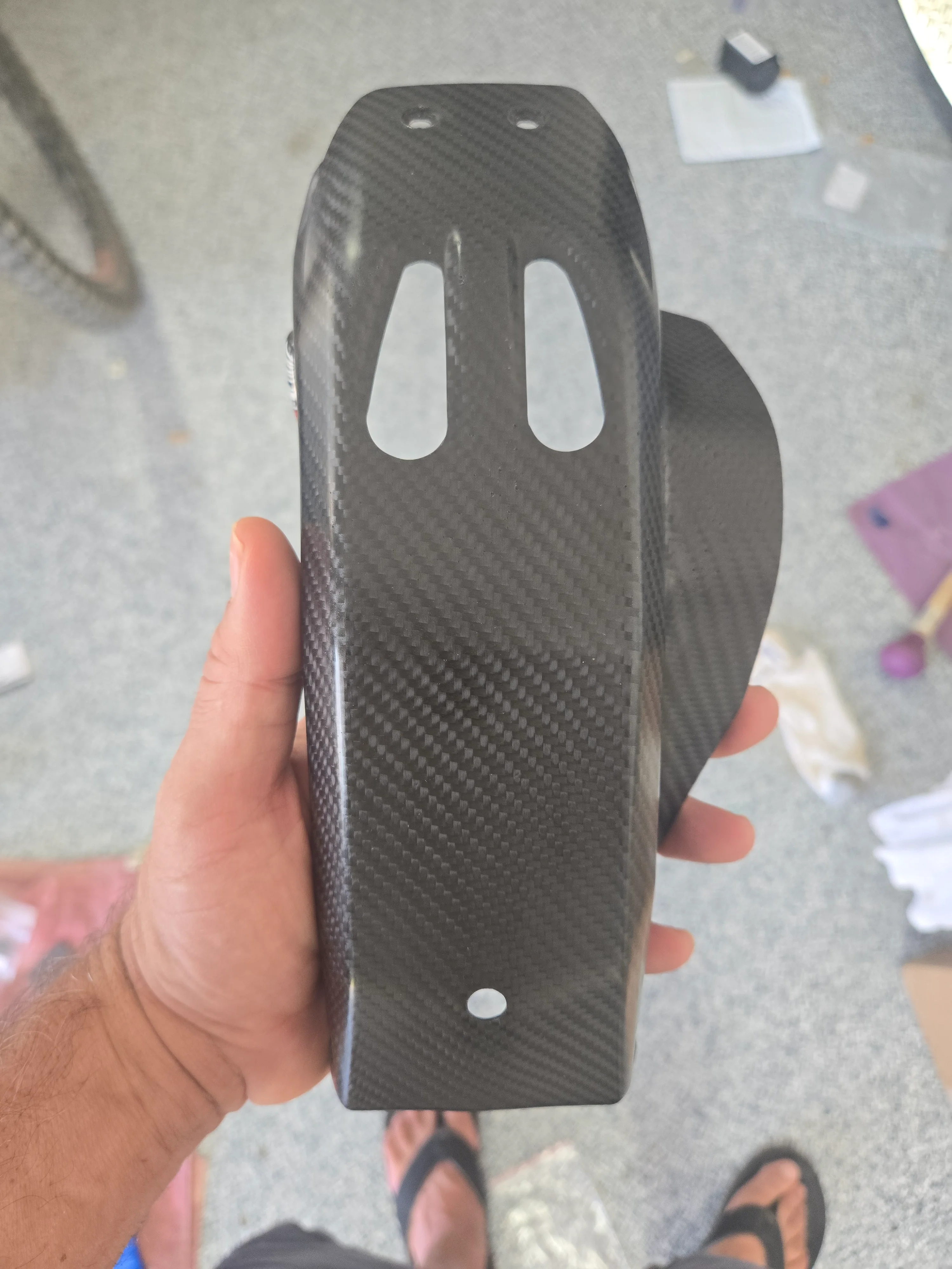

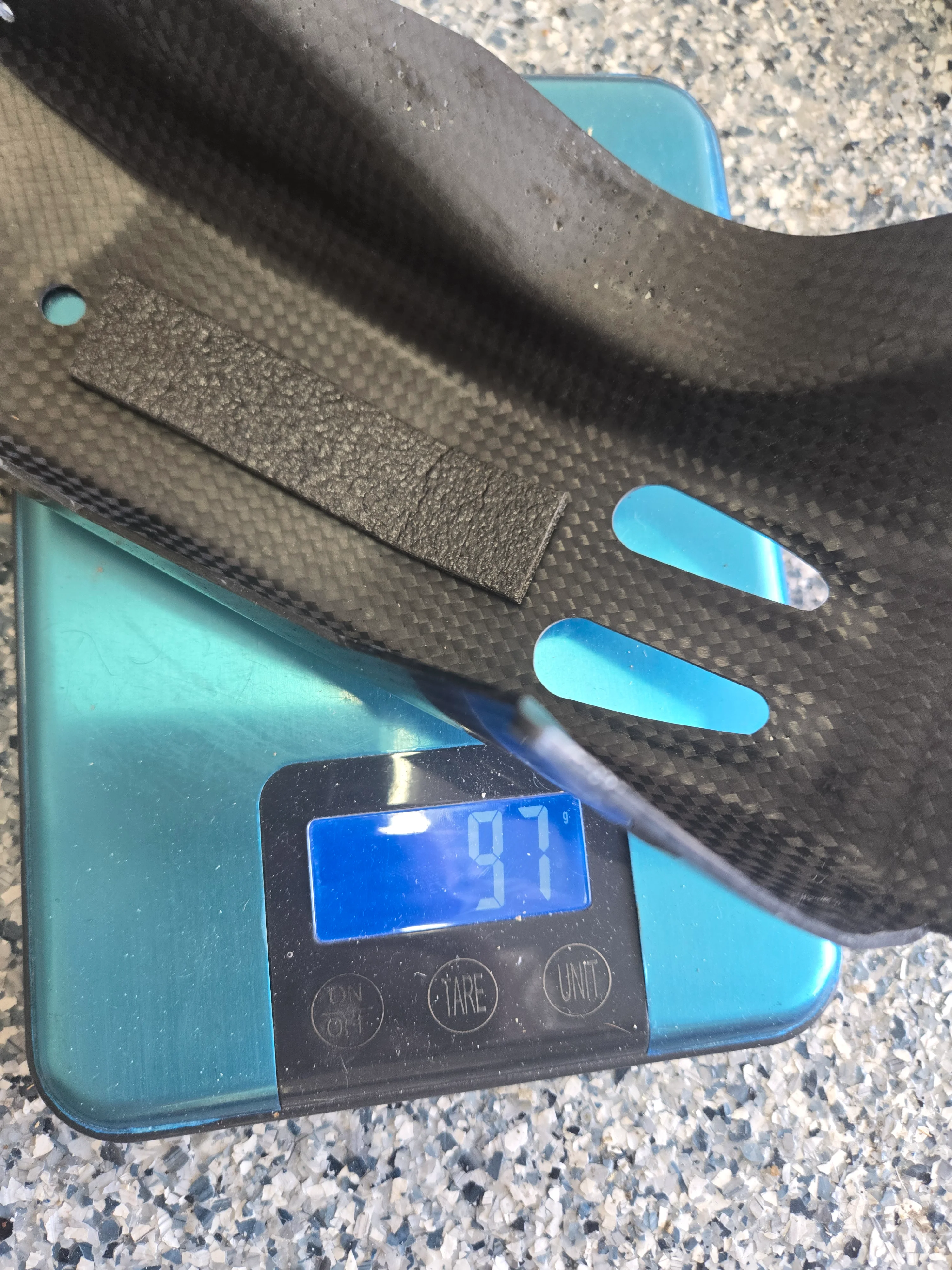

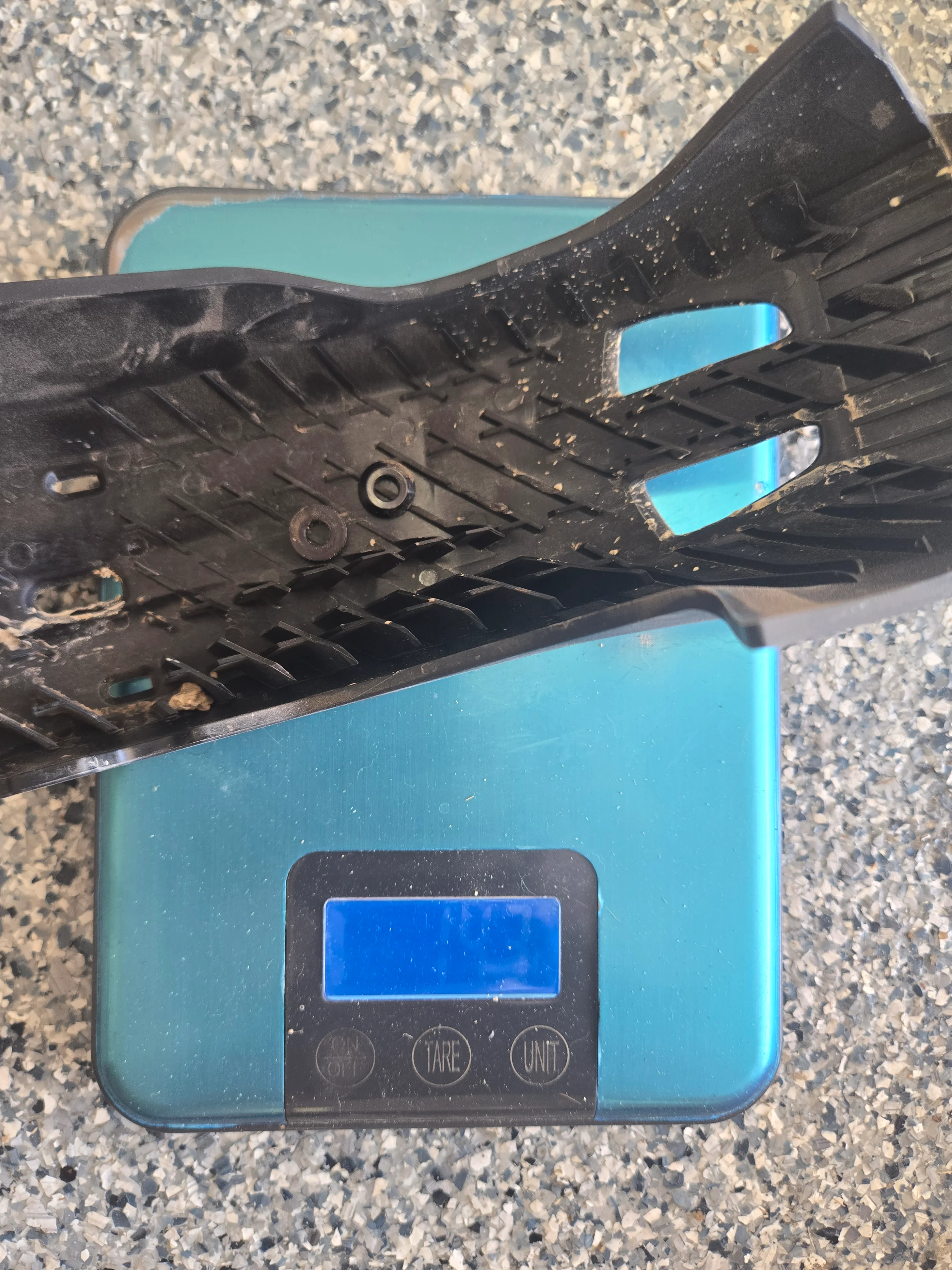

View attachment 181101View attachment 181102View attachment 181103View attachment 181104
Cools a bit on the light side for a bash guard. I would also like to see a carbon/kevlar bash. Carbon its self is not the ideal material.
PS I haven't changed mine out from the plastic. I spend too much time bashing it to consider a carbon one and i cannot be farked making more own carbon/kevlar one.
I bought it hoping it would be stronger than stock and thick like the MX ones. It's not thicker, maybe it's stronger? But it's here so I mounted it, guess we'll see.

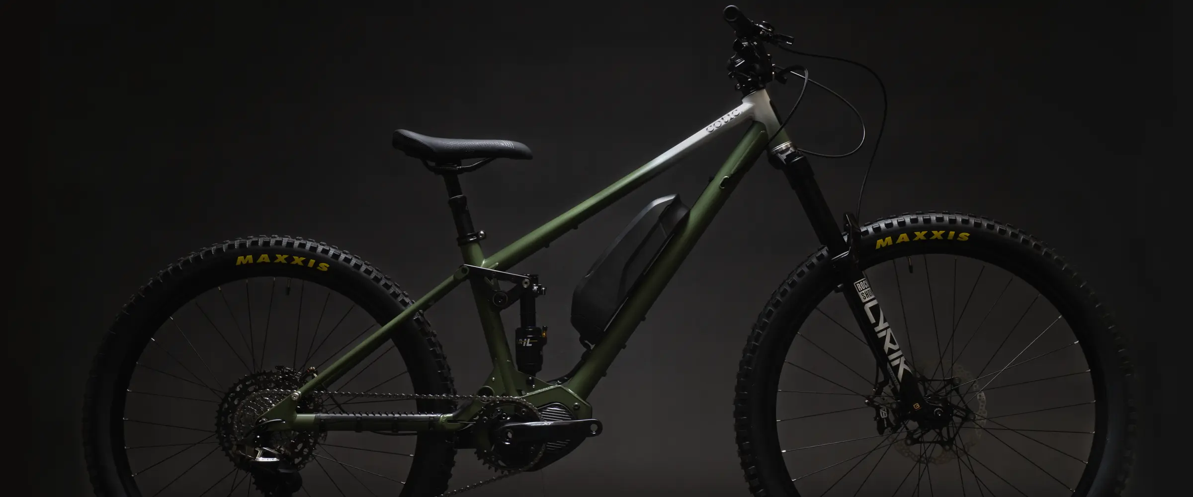

Before I rant on about weight weenie parts. I refuse to compromise performance.
As an example, If a heavier coil shock is what's required, that's what i'll use.
What I am interested in is all your weight weenie hacks that dont compromise performance... or increase performance.
So far my weight weenie hacks consist of the following
Light weight carbon frame with different battery options. That's probably the best hack.
PS I'm not interested in mid power bikes.
400wh battery, Saves 1kg from 600wh and 2kg from 800wh
Bontrager RSL one piece handle bar/stem Saves 200 grams from bar/stem combo's
Enve Foundation wheelset. Saves around 300 grams from a equivalent alloy wheel set. Plus these wheels are super freaken strong. They take a beating so its also a performance upgrade too.
That's about it for weight reductions bits, The rest is standard.
I'm about to dive into titanium bolts. Probably can save another 100 grams on bolts.
The front chainring is steel so i can save another 100grams there.
I need to start looking at seats too, maybe lighter pedals.
Then long term i plan on designing and 3d printing some TI cranks.
Current bike weight with 400wh inc pedals is 21.8kg.
I'd be delighted it i could get that around the 21kg mark
To answer the question that inevitably will be asked. "why bother reducing weight on an already heavy e-bike"
The answer is the lighter it is, the more playful it is and the more it feels like an mtb.
