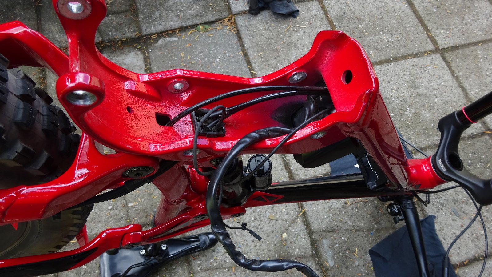

This weekend I took some time to work on the Merida.
Since I changed the XT to a gripshifter the cable was a little too short. But to get to the internal cables you have to take the motor off... :rolleyes: (I do like simple bikes, with simple solutions like external cables ;)).

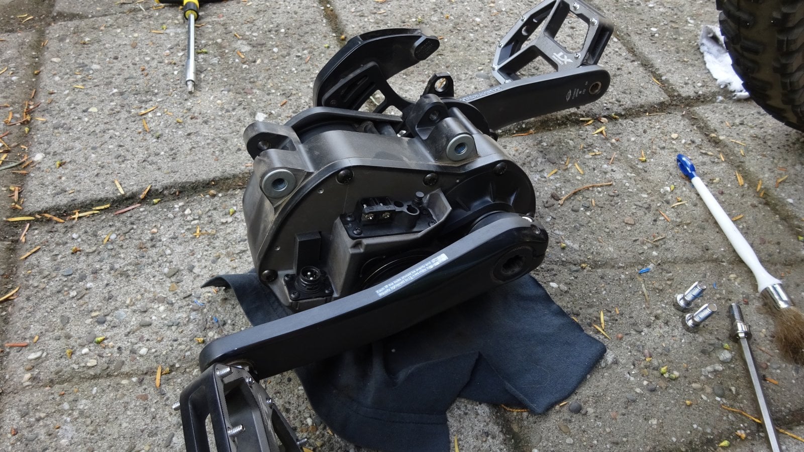

And the motor removed...

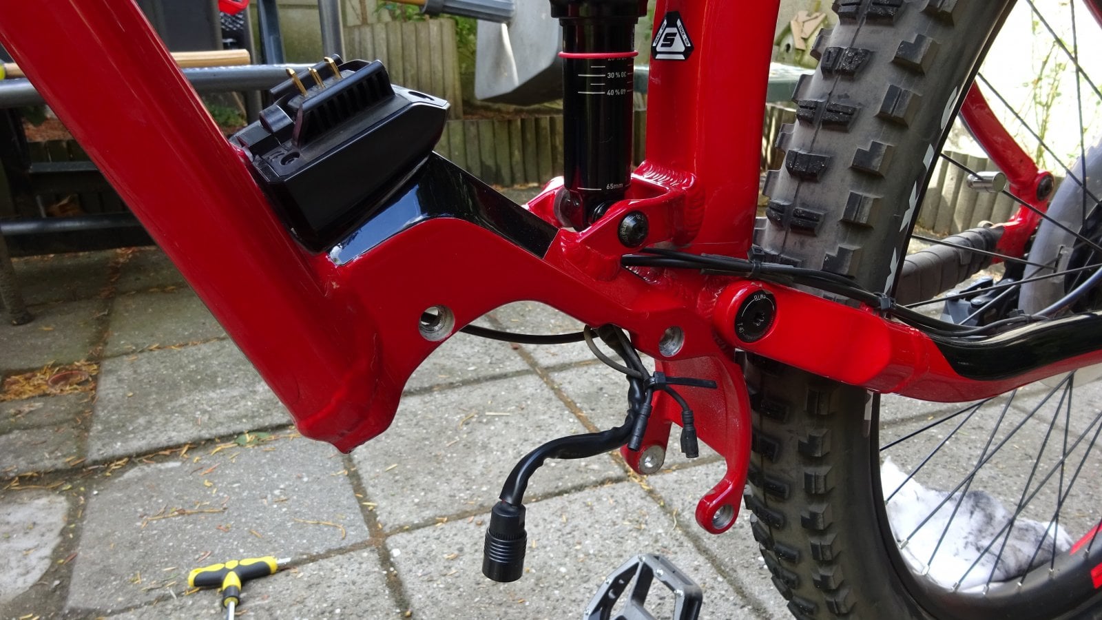

I was surprised to see how little protection there is against dust or mud. The little plastic cover doesn't do very much, after only three rides (all in dry & dusty conditions) there already was a lot of dust on the electric connections.
After changing the cable (and putting the motor back on...) I also swapped the Minion on the rear for a Rekon and set up the tires tubeless. Oh, and in the proces ofcourse removed the ugly plastic disc :cool:
Hi, thanks for the clear photos.
After making a botch up replacing my dropper post it looks like I will have to install a completely new cable. The old one got snagged and came apart when trying to pull through as a draw wire.
Was it much of a job to remove the motor?
Not really, you'll be spending more time on the parts you have to remove to get the motor out ;)
I f I remember correctly I first removed the chain. Then loosen the chainguide a bit so you can rotate it out of the way (I think I took the outer half off as well). Remove the chainring and the electronic cables.
Getting the motor out is actually nothing more then loosening the six bolts, but you can't reach the middle one on the driveside without removing the chainring and loosening the chainguide.

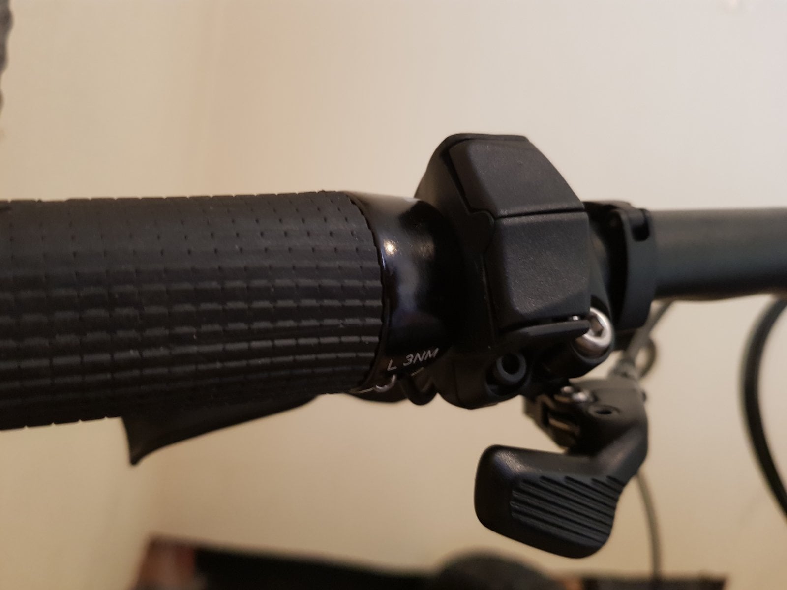

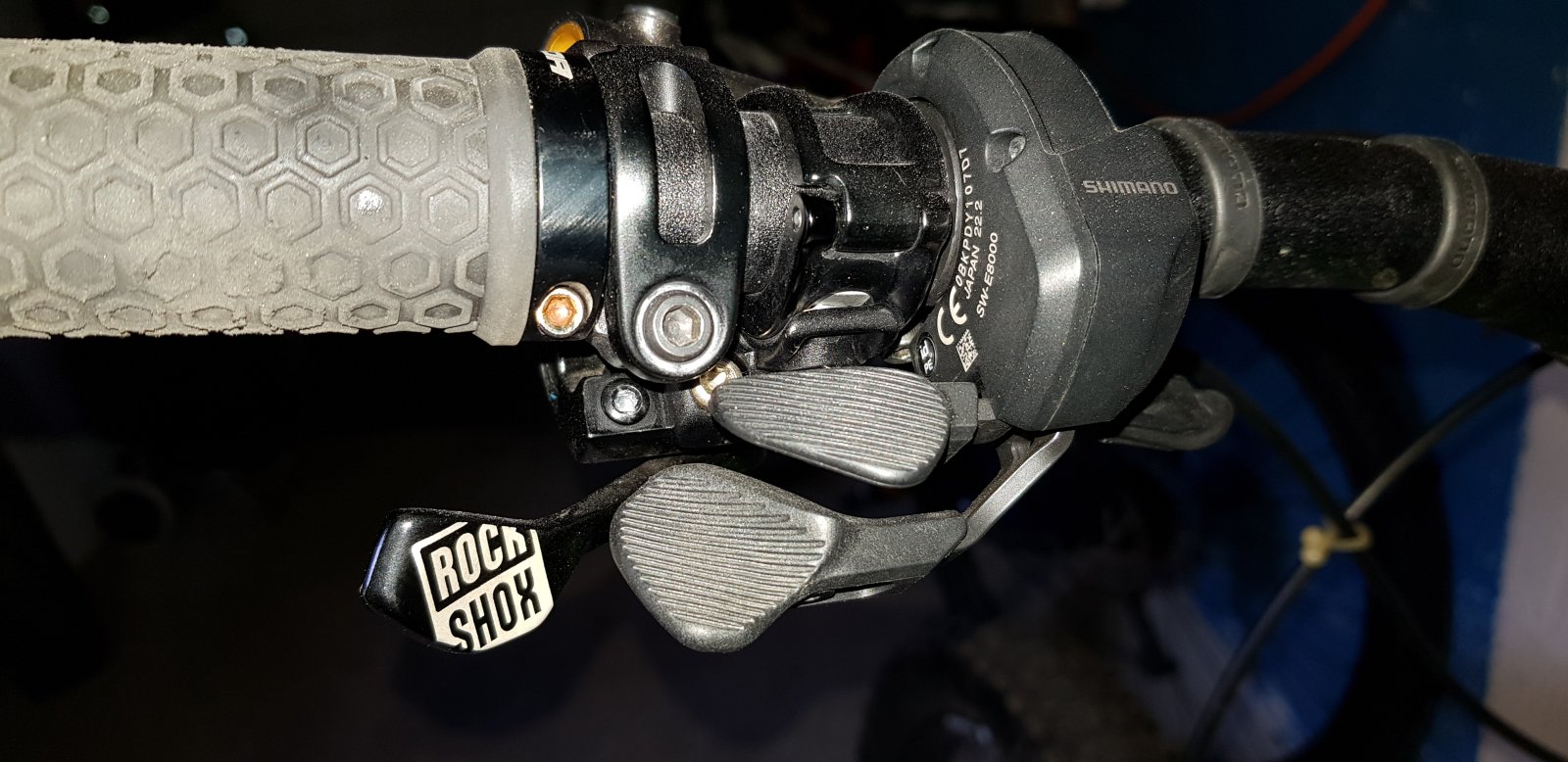

What are the options for changing the dropper post lever? It doesn't look like there is any space for a lever so do i change the mode shifters to something else so there is space?
Have you actually read the thread? ;)
The answer is in post 152 on this page.
Argh sorry i read the thread a while back and didn't flick back. I saw Basy's posts on page 2 now and i just ordered the E6000 controller...... and then i see Bob's picture above and it seems one can fit.
I think the E6000 controller setup is probably more ideal due to my limited movement in the wrist and leaves more space to position the dropper lever where i can reach it quickly without pain.
Next will be to switch out the dropper from my remedy 8 and slap it on the Merida.
You can get anything to fit if you move the shifter far enough down the bars. The new E7000 shifters should be coming out very shortly. I'll be getting one I think as they look a little better and more ergonomic.

The E7000 controller looks similar to the controller on the Giant Trance ebike where its more on top of the bars.
Im not to sure about having the buttons on top as my last whopping downhill crash destroyed everything on top of the bars. Not something id want to repeat but i like the E6000 buttons facing towards me as they will be pretty safe in a crash.
I was just at the shop chatting to them about switching my saddle over and was looking at the Giant setup. i definitely have some concern on the control unit they use being so vulnerable. Or at least it would be in my hands as i ride hard and crash hard lol.

I haven't seen the giant one actually.. But the e7000 looks pretty nice and refined. Why don't you just not crash? Lol
You can place the E6000 and 7000 controllers where you want in terms of rotating them on the bar
