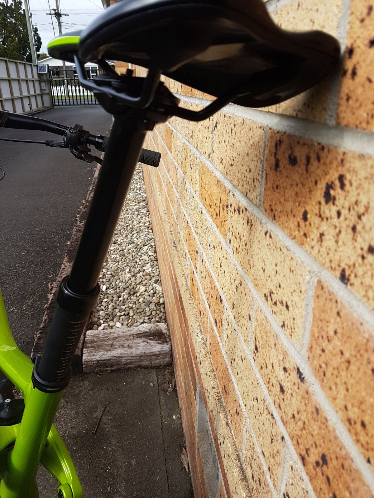

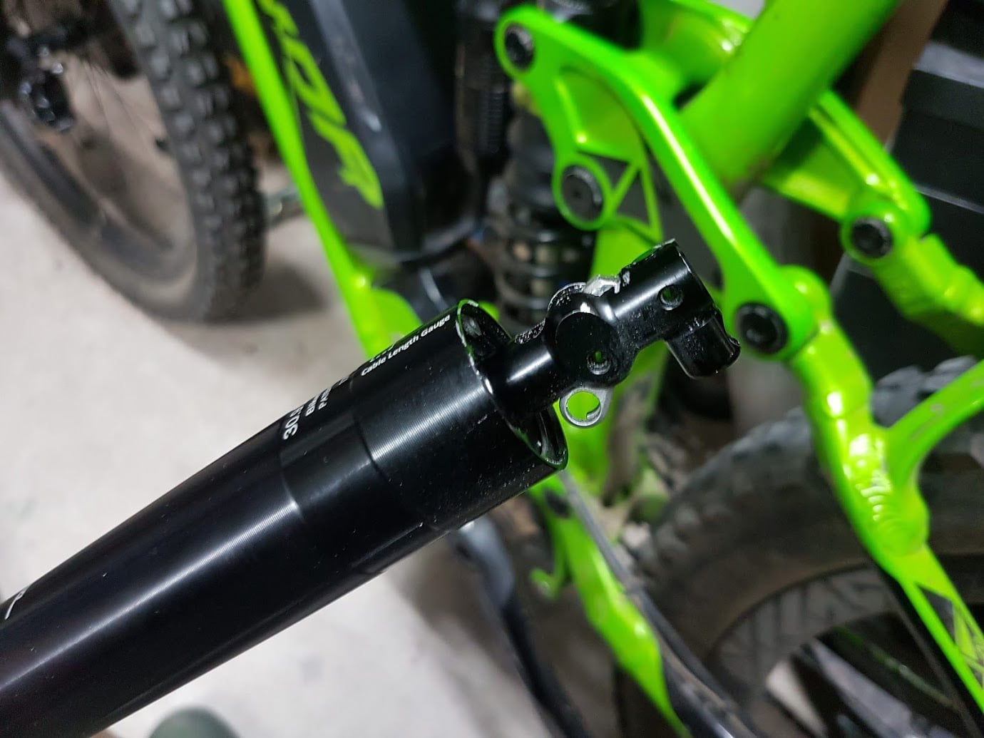

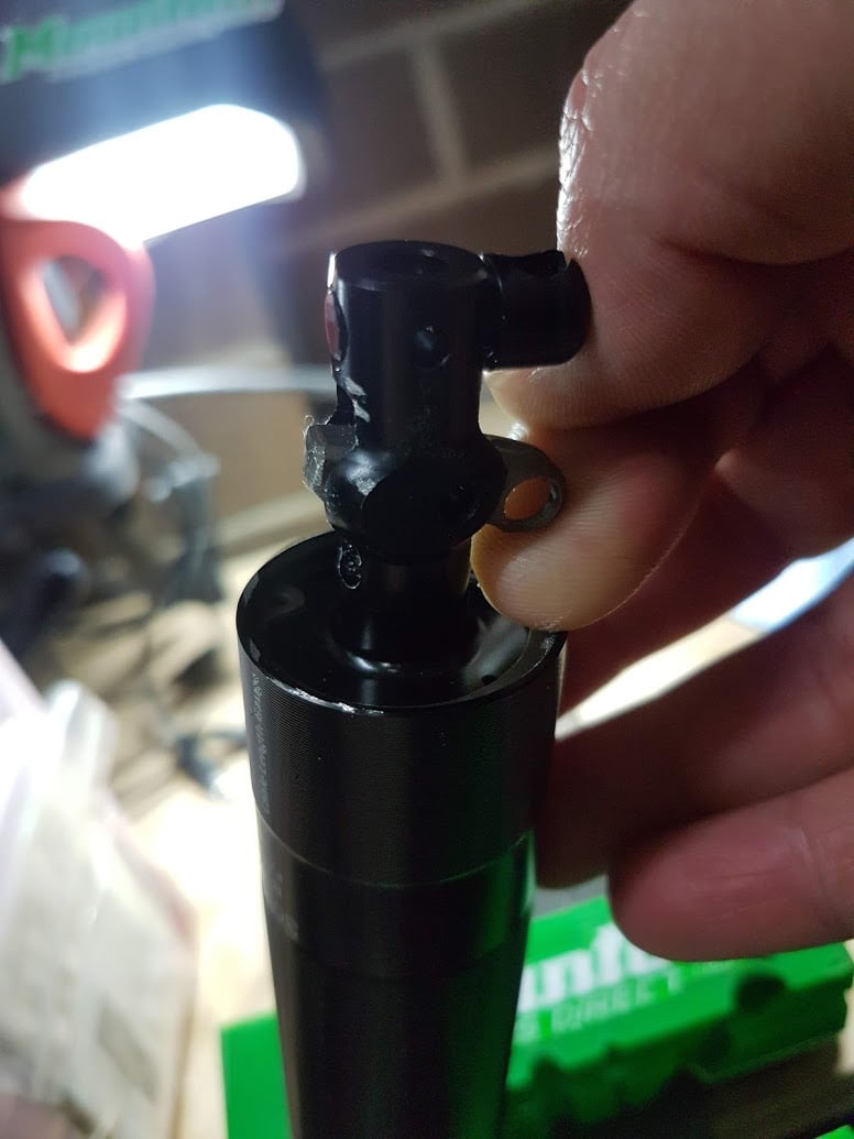

I got rid of my OneUp (didn't like it) and wanted to go back to my Revive.. BUT.. I was annoyed with how the Bike Yoke's actuator hit the inside of the seat tube when slammed (see picture).
So.. I simply hacked the tip off of the lever/mechanism with an angle grinder and hacksaw. I still can't slam the post to the collar but at least it still functions when inserted to it's maximum. Winning :cool:

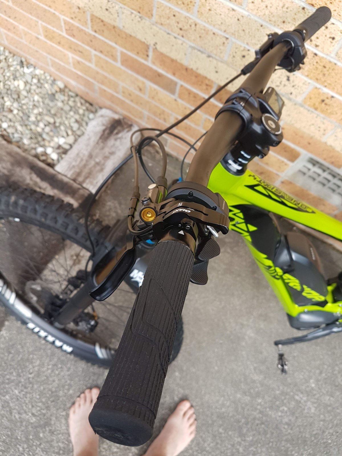

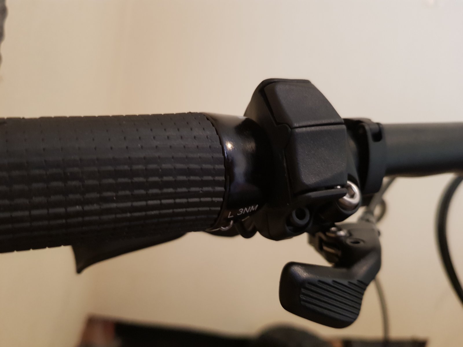

I ended up buying a cheap giant dropper with a mechanical switch etc: Contact Switch Seatpost - Giant Bicycles | New Zealand
Pretty happy with it so far. It has a 2 year warranty, doesn't freak out when being lifted (i've been lifting my bike by the seat for years so it is hard for me not to do this) and at half the price of the next decent option... figure I'm on a win.

I like the look of that 2X switch, can’t track one down in NZ.
Does it work well.
Does it work well.
Yeah, surprisingly well. I could tidy the cable crimp underneath a bit perhaps...but that would be fussy. It's 100 times better than the reverb push hydraulic thingy!
