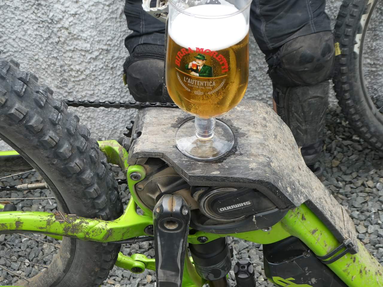

Has anyone bought a motor guard ? I am looking for one but can't seem to find
Make one yourself? This bloke does..
I just ordered some thick-ish Mastic Rubber tape "scotch 2228" and will see what I can do with it. Supposedly, it's decent enough to make crank boots out of.

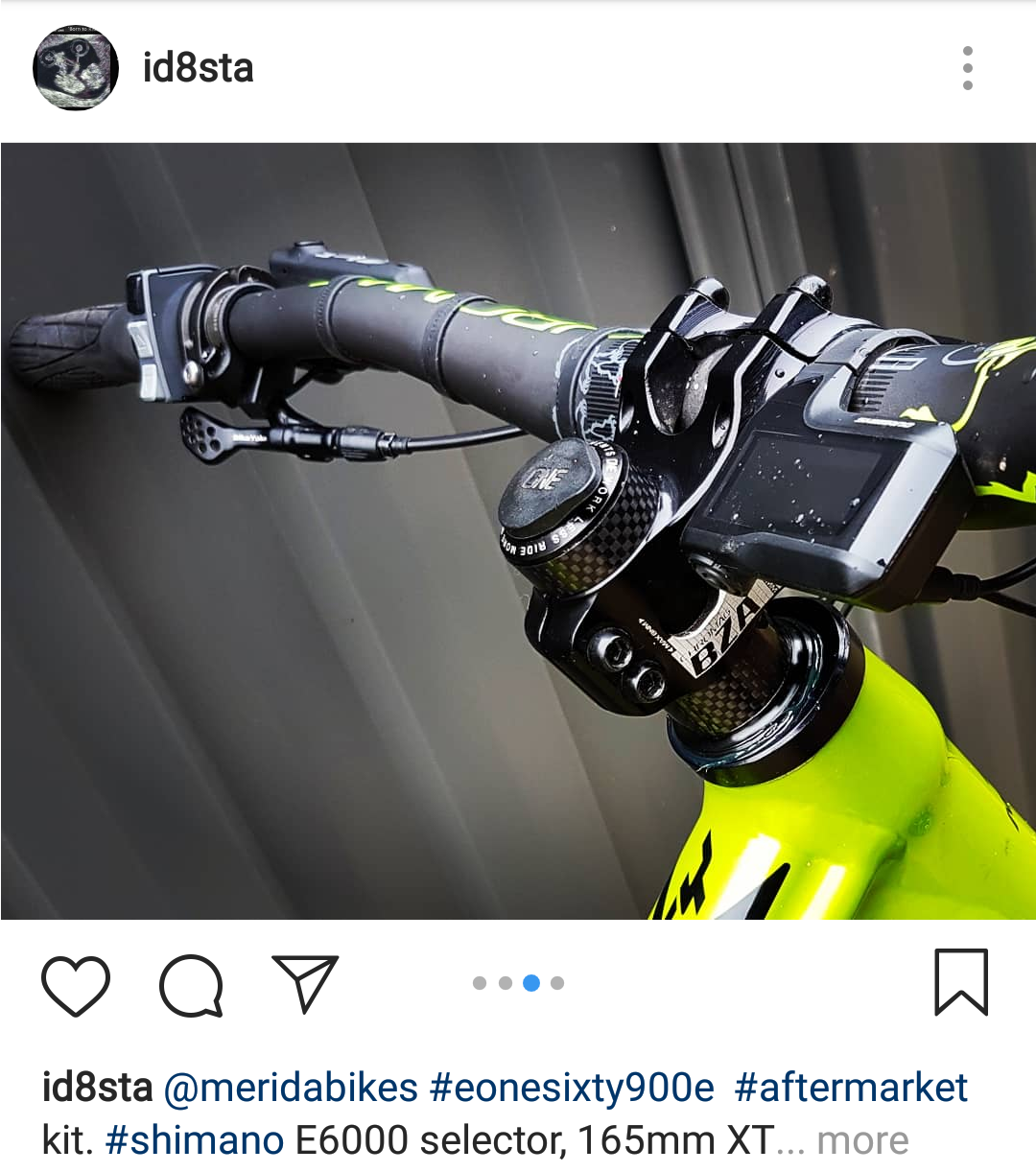

May I ask what you used as a replacement mode selector? The stock Shimano selector doesn't really work well with an under bar mounted dropper-remote (which I prefer).

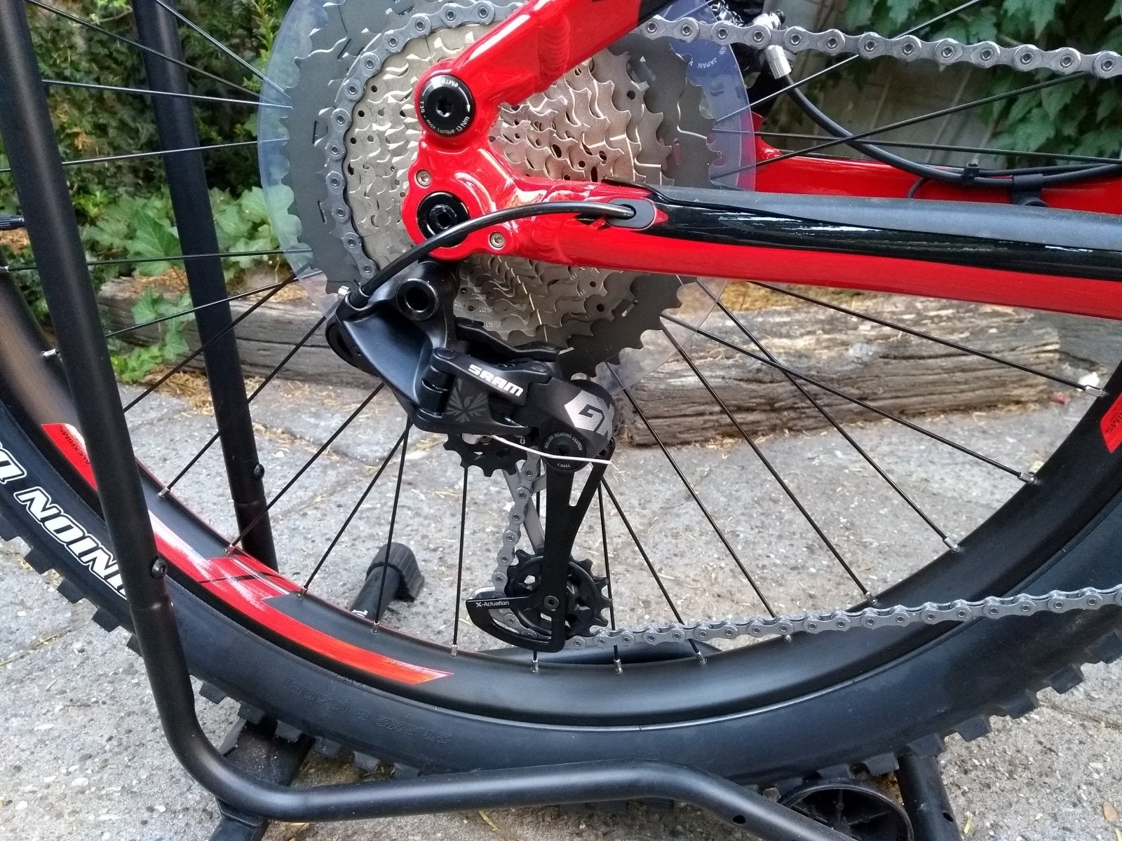

I'm currently waiting on my E-Sixtyone 900 and already have some minor updates planned. The XT shifter and rear mech are going to be replaced with Sram GX gripshift, and the brake calipers with the XT four pot version.

You just unplug the old E8000 one and plug in the new E6000
It's not very thick, less than 2mm. It works very well as a chainstay protector but it will not help much for your use.

I don't like the mode shifters and will be switching to e6000 or e7000 mode switchers.

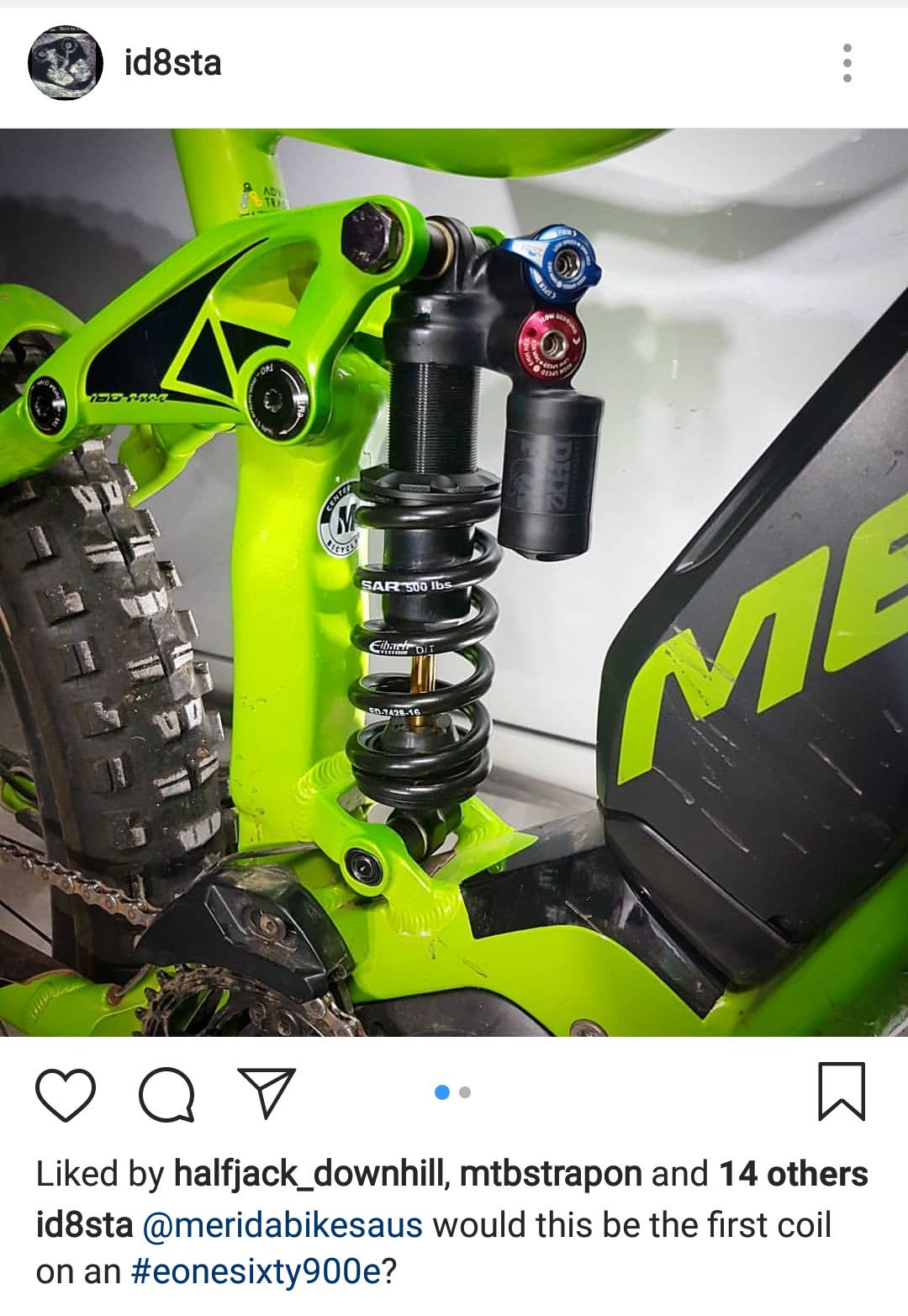

The third negative is the linkage rocker design as it's a little hard to fit a coil shock without the spring hitting the seat tube AND fitting a non-metric shock in there. I made it work but it's definitely not easy.

Love mine almost as is. Fantastic bike. Just will change to a shorter crank and E7000 controller switches when they become available so the seat dropper control can be better located.
You can still put a reverb dropper with thumb shift on a standard bike, just move the left hand mode shifter inboard. I'm waiting for the 7000 button mode shifter.

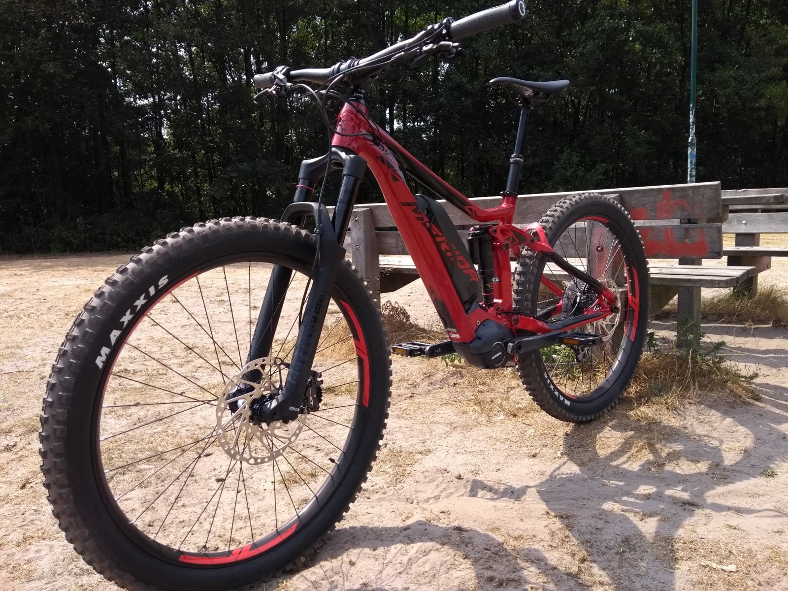

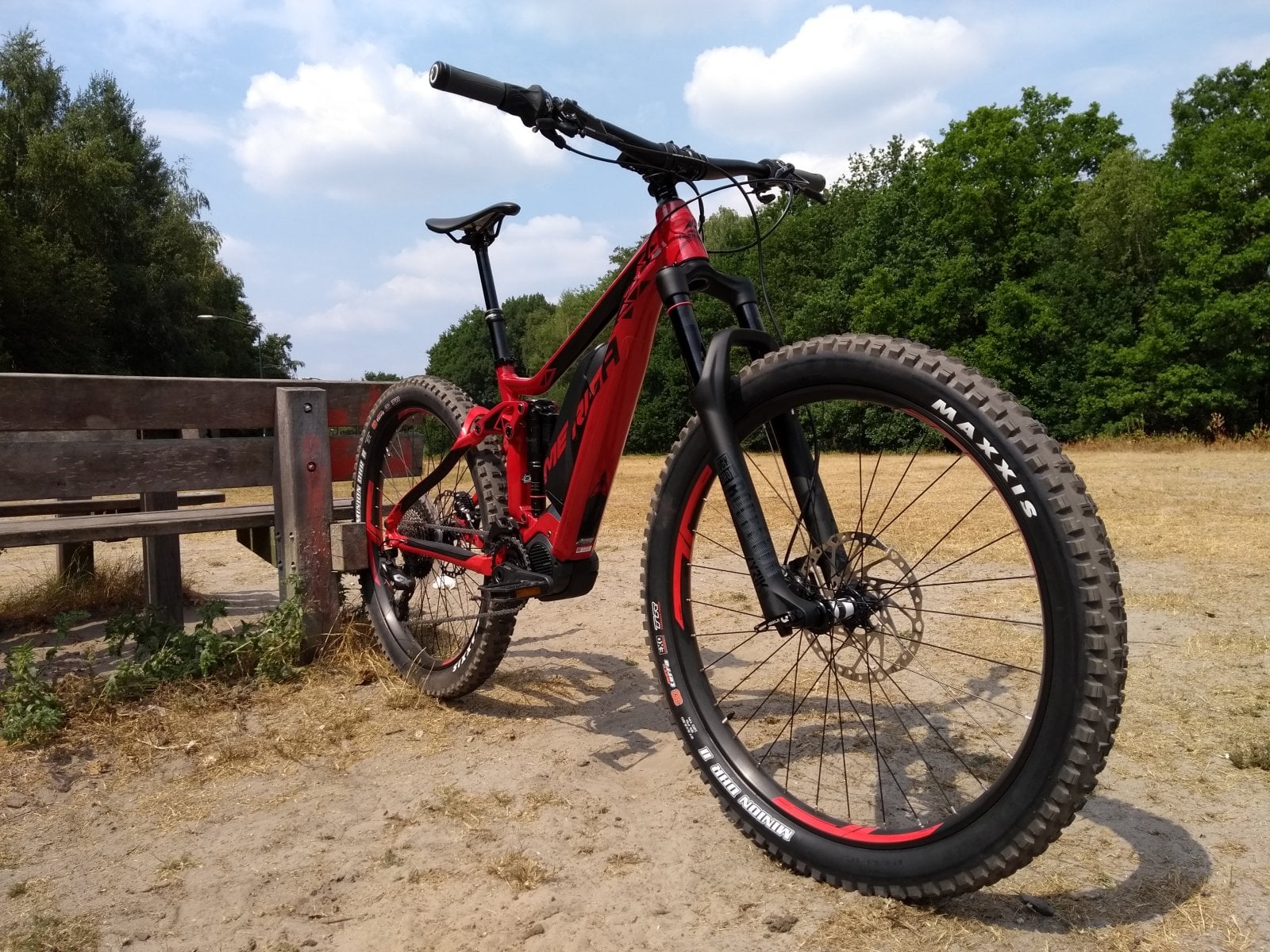

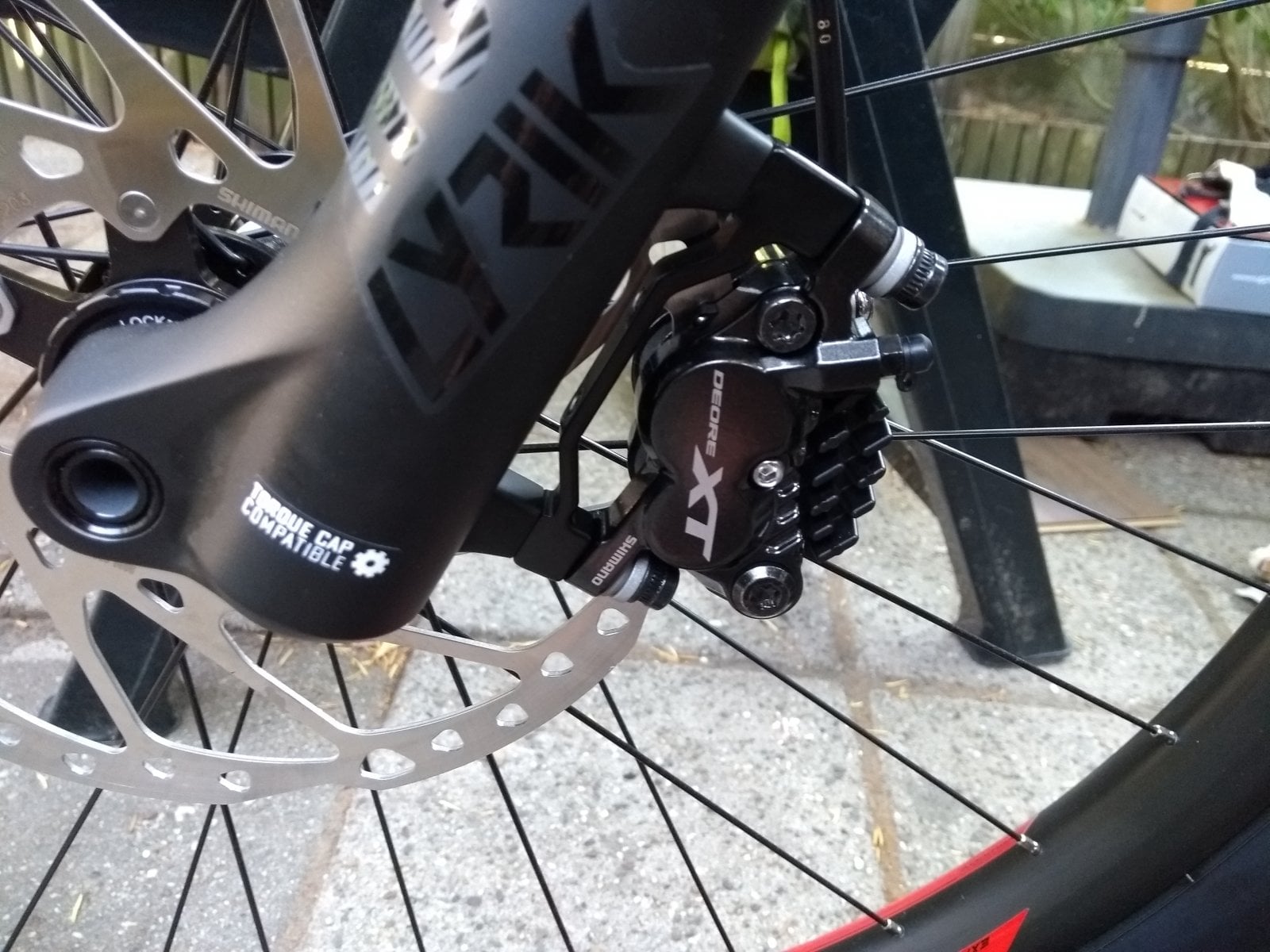

Got my 900 (size S) last week and did some changes/upgrades before the first ride.
Changed the shifting to gripshift (and a Sram derailleur ofcourse) because my thumb doesn't like triggers. And I switched the XT calipers for the new four-pot calipers.
I also switched the hoses from left to right vice versa, so now the front brake is on the right hand side (in Europe bikes are setup with the front brake on the left hand side). Because the hose enters the frame on the left side the routing is not ideal now, maybe I'll change that some day but I think that needs removing the motor... :(
Cable end cap coming soon ;)
Yesterday I did a short first testride and I'm sure I'm going to have a lot of fun with this bike...
Ofcourse the extra weight takes some getting used to, but the bike feels very well balanced. Did some small jumps, tight turns and it handles lighter than you'd expect.
I'm already getting the feel for the way the motor kicks in, looking forward to getting the bike on some "real trails" (which unfortunately are not very close to my house). Next step is finetuning the suspension, experimenting with tire pressure and putting on XT pedals (on the pics are the plastic ones that came with the bike).
And as a bonus, the Merida really is a pretty bike...
