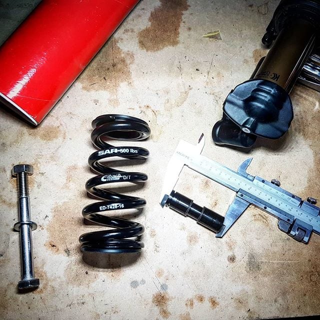

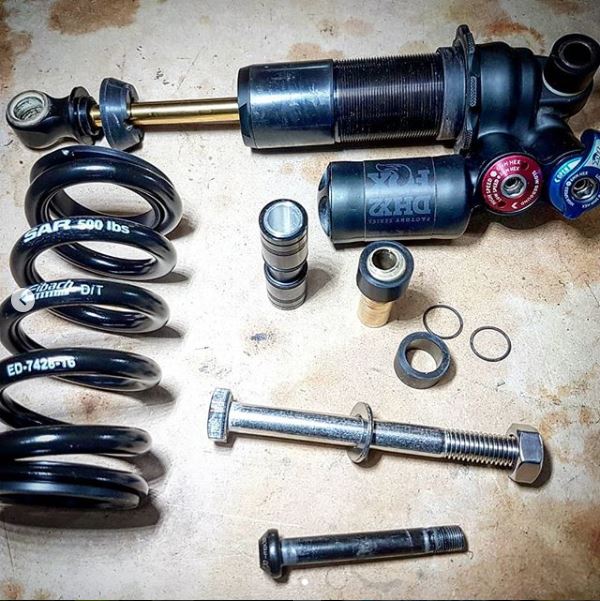

It's metric 205x65 with upper Trunnion mount and 40x8 lower. I use an offset bushing on the lower to fit the Jade though.. because it's pointing end of the piggy back nearly touches the top tube (doesn't but close).
You can fit a regular 8.5x2.5 in there though. I did it before the Jade with a DHX2 but there was a bit of mucking around (see insta below).
OK thanks.
But for Trunnion mount what's the hardware width ? (I never had Trunnion shocks...)
10x54mm
