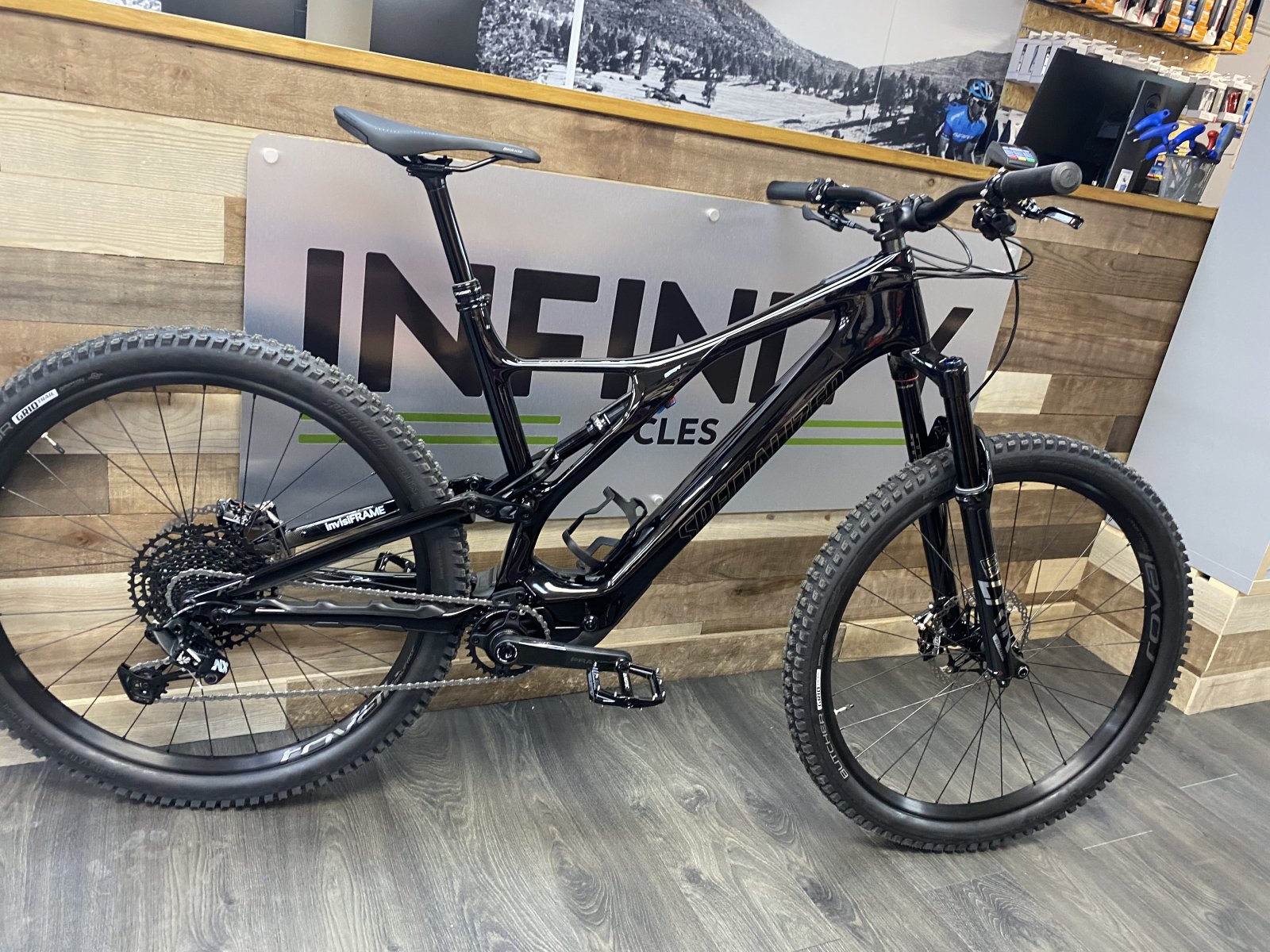

I’m back on an eeb. After hating them due to my problematic FF levo, I’ve gone full circle ish and picked up my SL today. Few more upgrades to come but many thanks to infinity cycles in Durham for sorting everything out. My mega tower may become a clothes horse lol
Mate your gonna love it. Perfect bike for you I think..Get a range extender and your Golden all day for any ride with FF bikes..
